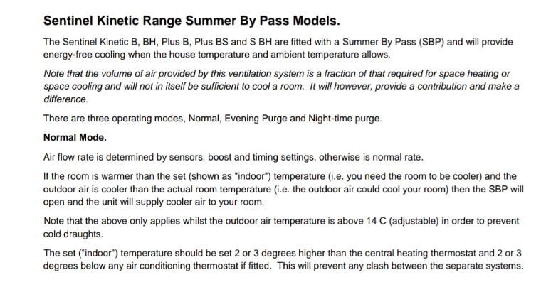

JFDIY Posted April 24, 2020 Posted April 24, 2020 (edited) @JamesP Bypass only opened when extract air is above the 'indoor temp' set-point, as far as I know it doesn't relate to outside temperature. Other than if the outside is too cold (based on your 'outdoor temp' set-point) Hope this extract from manual helps. Edited April 24, 2020 by JFDIY 1

phatboy Posted September 29, 2020 Posted September 29, 2020 I am in a high humidity area too (1km to the sea), and I had to set the humidity sensor way up to 84%... it still always kicks in for showers, but less so for kettle boiling and general 'moist' air. Fairly sure the installation manual says set the internal temp to about 4 degrees C higher than you would actually want it to be, to make the summer bypass behave.
