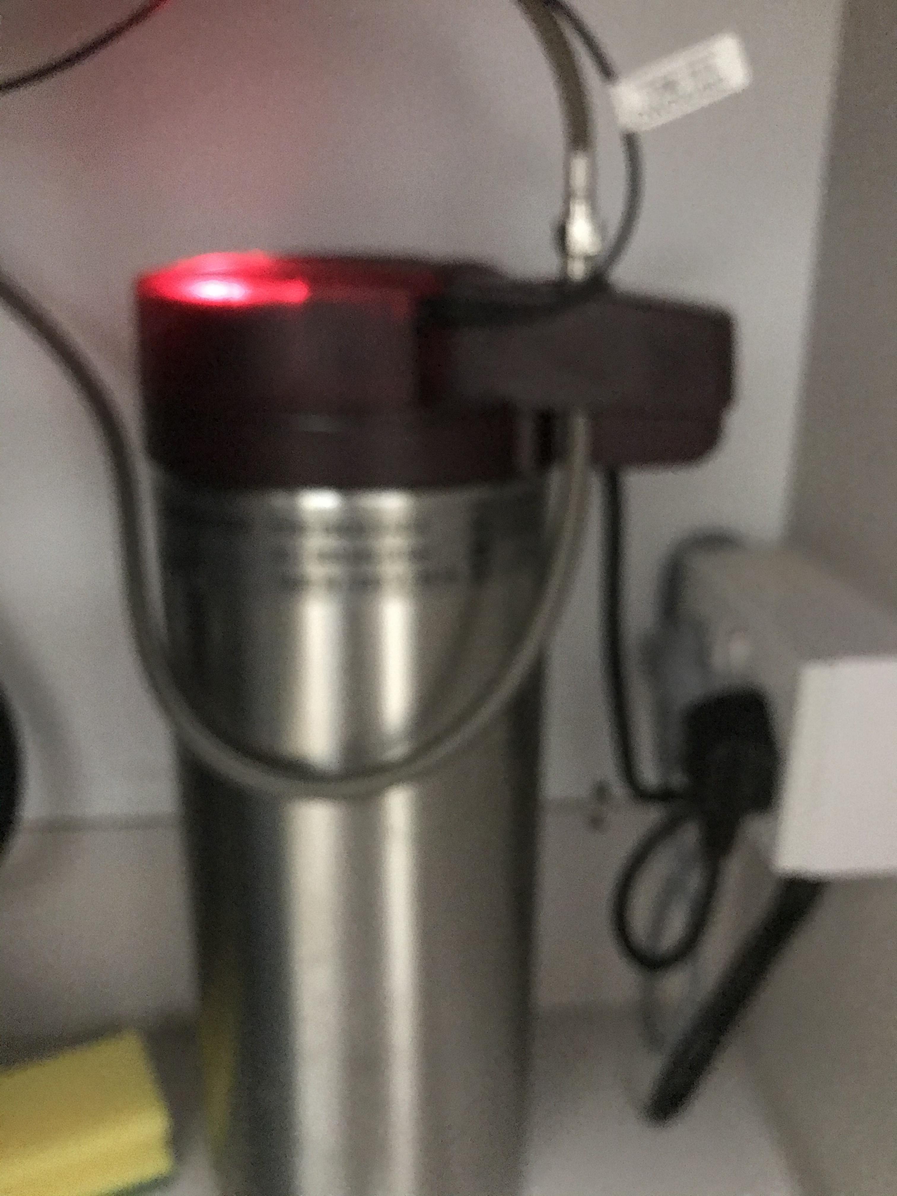

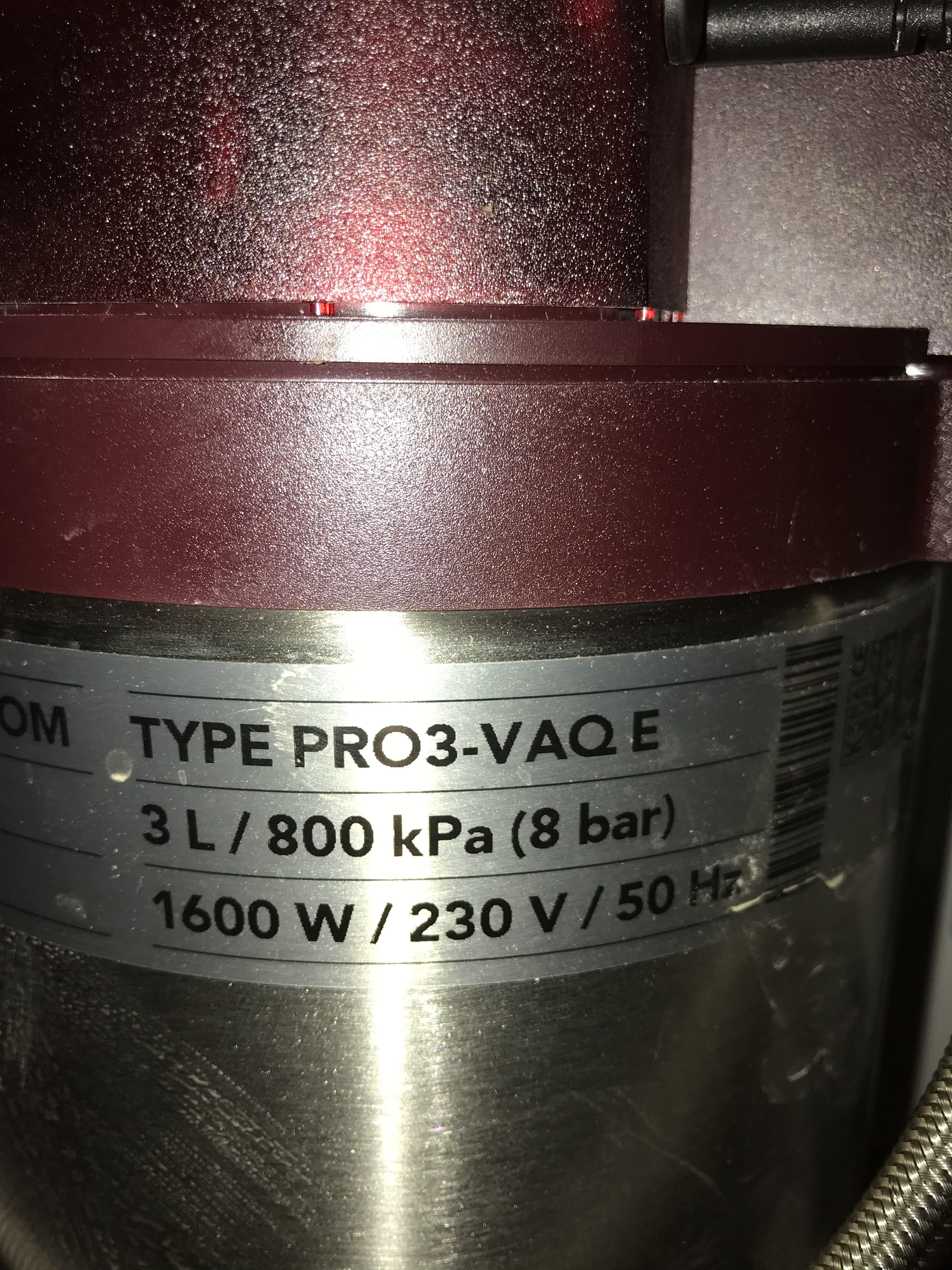

nod Posted April 16, 2020 Share Posted April 16, 2020 We’ve a quooker been in about 18 months Model pictured A couple of times recently about a week apart I’ve come home and found the illuminated ring around the tap flashing When I’ve switched it in boiling water mode there’s just slow warm water that quickly turns cold I press the reset on the tank and after about 20 minutes all works as normal While it’s still under warrantee Is there anything I can do Is it a sign the filter needs swapping Link to comment Share on other sites More sharing options...
Barney12 Posted April 16, 2020 Share Posted April 16, 2020 (edited) I had exactly the same fault. I called the service line and they said the issue can be caused by a build up of scale. I pointed out that I lived in a very soft water area and she said well we can send an engineer but if it’s scale we will charge you (a fixed fee of £150 IIRC). At the time I was really busy and didn’t have time to get a service engineer visit into my diary and as the fault was intermittent left it. Fast forward a few weeks and the fault became permanent. I called them again and they sent an engineer next day. The control board had failed which was replaced under warranty. He also changed the filters at the same time which as I had suspected were perfectly clean. edit: I have exactly the same model. Edited April 16, 2020 by Barney12 2 Link to comment Share on other sites More sharing options...
nod Posted April 16, 2020 Author Share Posted April 16, 2020 Great help Barney Thanks Link to comment Share on other sites More sharing options...
jack Posted April 16, 2020 Share Posted April 16, 2020 Their service department is good. I had this same problem just out of warranty and they came out and fixed it for free (with the same threats about charges if it was scale). Link to comment Share on other sites More sharing options...
