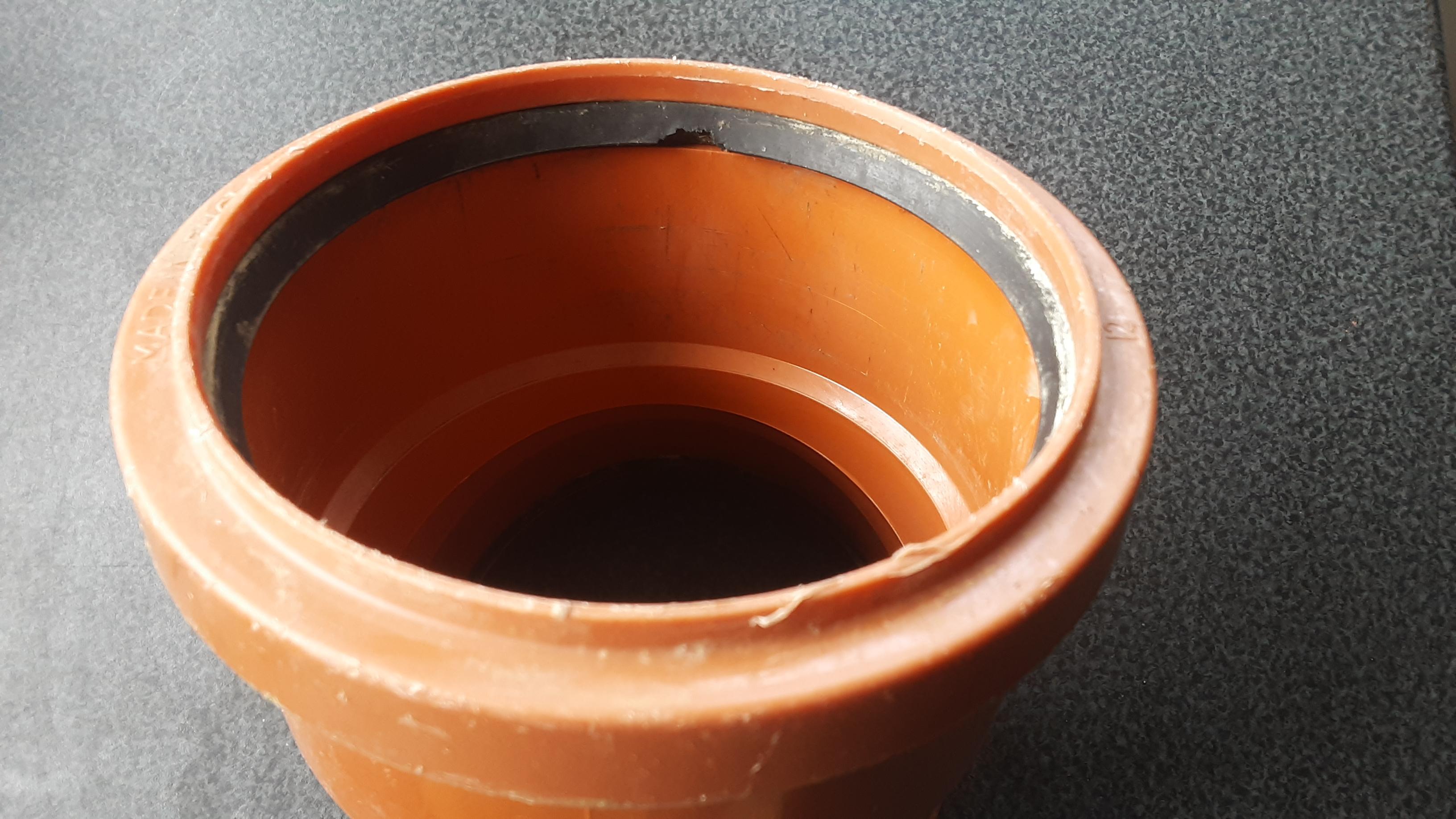

Russell griffiths Posted April 18, 2020 Posted April 18, 2020 (edited) Pull the rubber out of another (same make) and swap them over. As Tommy Cooper said JUST LIKE THAT. Get a warm bucket of soapy water and get some of that dusty crud from around the rubber, clean the groove before inserting new cleaned rubber. Edited April 18, 2020 by Russell griffiths 1 1
ToughButterCup Posted April 18, 2020 Author Posted April 18, 2020 .. ahhh bloody 'ell: didn't know you could do that..... I've beeb given a couple of couplers (as it were) with one seal missing. Now I know why!

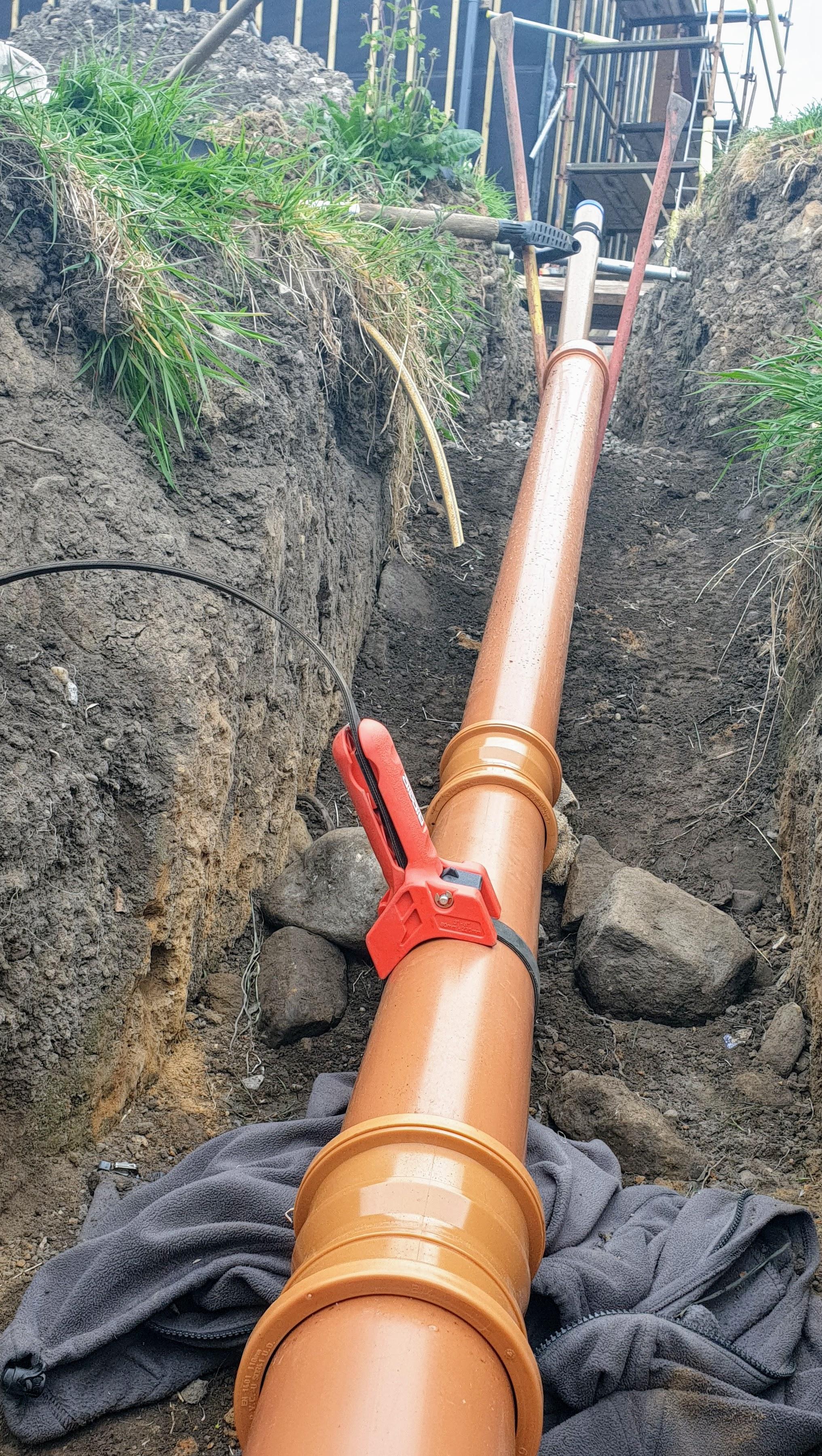

ToughButterCup Posted May 18, 2020 Author Posted May 18, 2020 On 16/04/2020 at 13:25, Construction Channel said: Also little tip for fitting pipes in a trench is to get the end into the socket loose (plenty of lube) then bang a couple of road pins (bits of rebar) in either side of it tilted out slightly. .... How right was Ed ( @Construction Channel) ? I had to resort to this to keep the bloody pipe still. It was like grabbing hold of a Turkish wrestler..... Those pipe / oil filter grabbers (that red one is magnetic) is worth it's weight in gold to me - 8 fingers in total, 6 that work. I used two crowbars instead of road pins. Thanks Ed. Ian
PeterW Posted May 18, 2020 Posted May 18, 2020 Make sure you put concrete mass fill around the changes in direction and especially the last bend into the tank
ToughButterCup Posted May 18, 2020 Author Posted May 18, 2020 1 minute ago, PeterW said: Make sure you put concrete mass fill around the changes in direction and especially the last bend into the tank Whooooo Hoooooo, thanks sooooooooooooooooooooooooo much. ? Digger's just arrived and the pipe would have been under 200 mm of pipe bedding by 2:00 today.
Ian Posted May 18, 2020 Posted May 18, 2020 20 minutes ago, AnonymousBosch said: Erm, what's concrete mass fill ?? a sh!t load of concrete poured into a hole 1
Construction Channel Posted May 18, 2020 Posted May 18, 2020 1 hour ago, AnonymousBosch said: How right was Ed ( @Construction Channel) ? I had to resort to this to keep the bloody pipe still. It was like grabbing hold of a Turkish wrestler..... Those pipe / oil filter grabbers (that red one is magnetic) is worth it's weight in gold to me - 8 fingers in total, 6 that work. I used two crowbars instead of road pins. Thanks Ed. Ian Iv played this game before. 1
ToughButterCup Posted May 18, 2020 Author Posted May 18, 2020 1 hour ago, PeterW said: Make sure you put concrete mass fill around the changes in direction and especially the last bend into the tank Just put a shutter (say) a meter either side of the bit that changes direction, mix some 3:2:1 concrete and plonk it in then?
