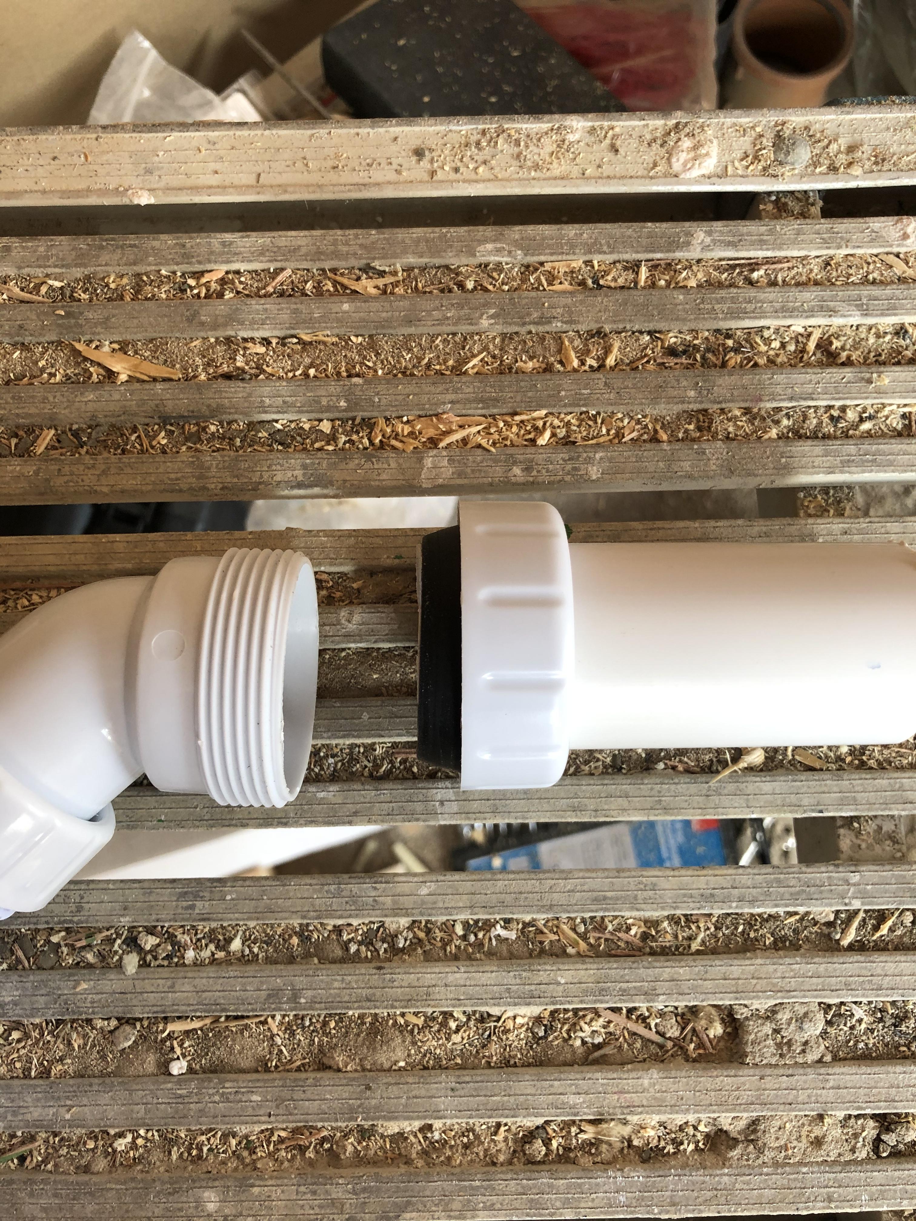

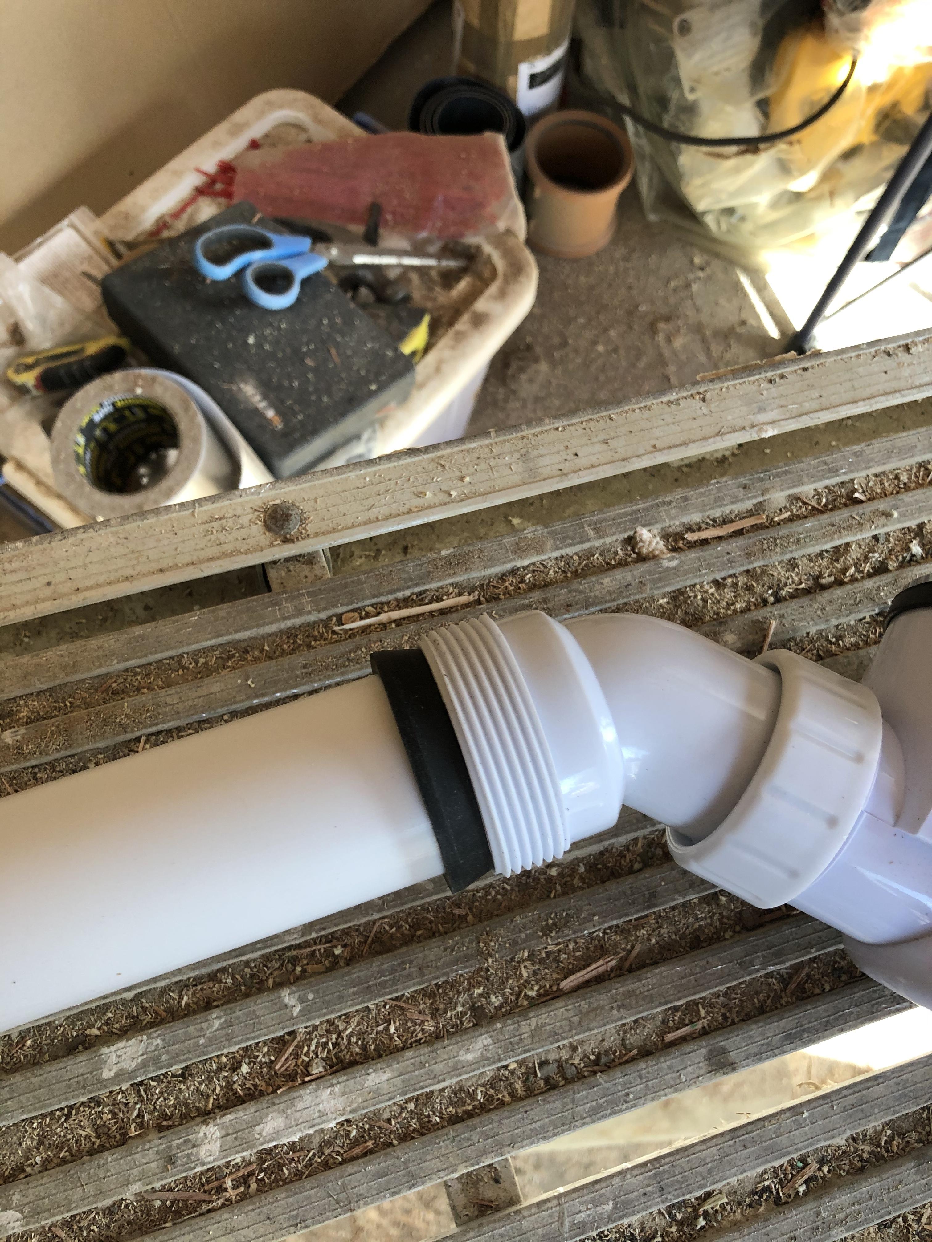

Pocster Posted April 11, 2020 Author Posted April 11, 2020 On 10/04/2020 at 16:57, Temp said: Sorry yes I just mean you connect up the pipes before paying the tray. Mine needed a 45 degree bend and short length of pipe (which I did in solvent weld) plus the 45 degree bend that came with the trap (which was a compression fitting). Expand Still don’t like the supplied tee . With no pipe in it the rubber washer sits fine . Around the pipe it won’t actually screw in . Just doesn’t seem right . Will stick up some photos soon .

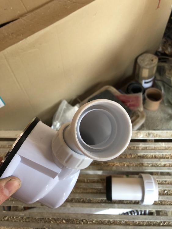

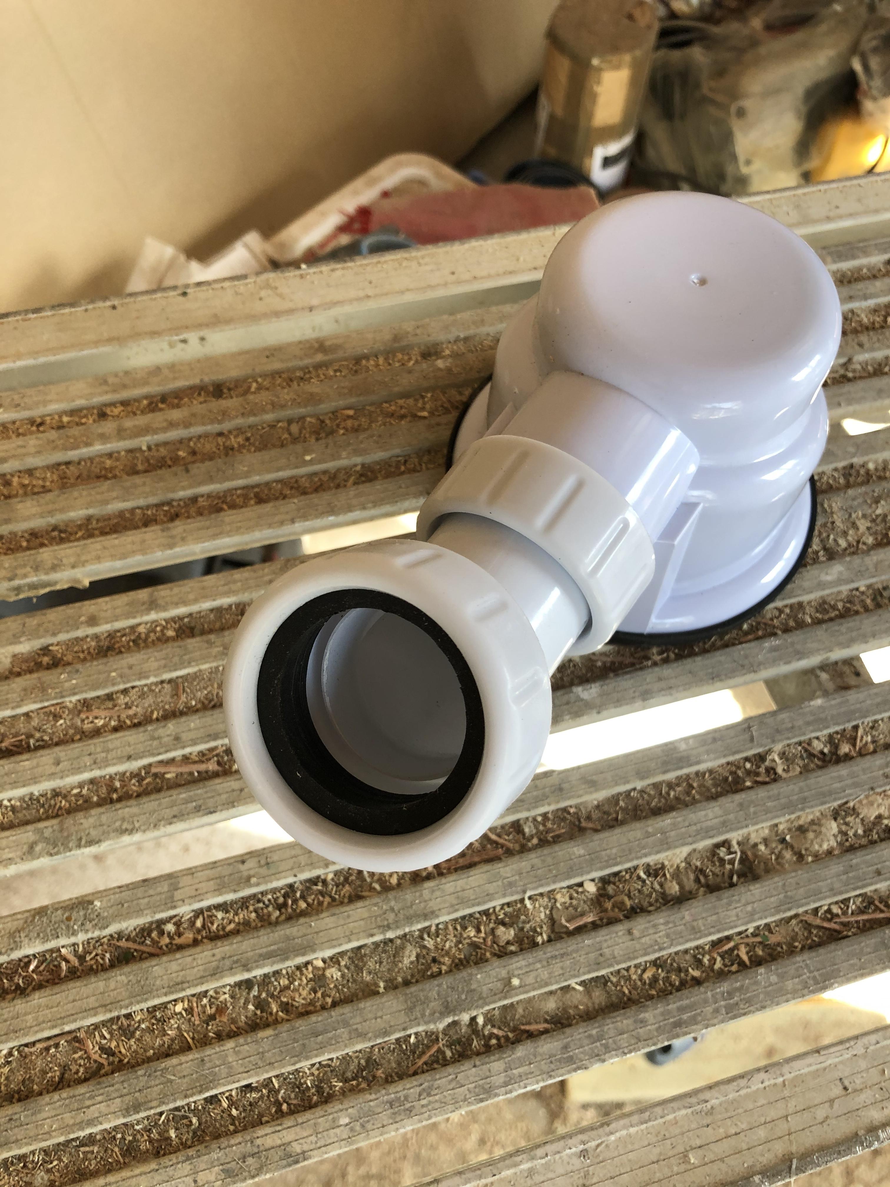

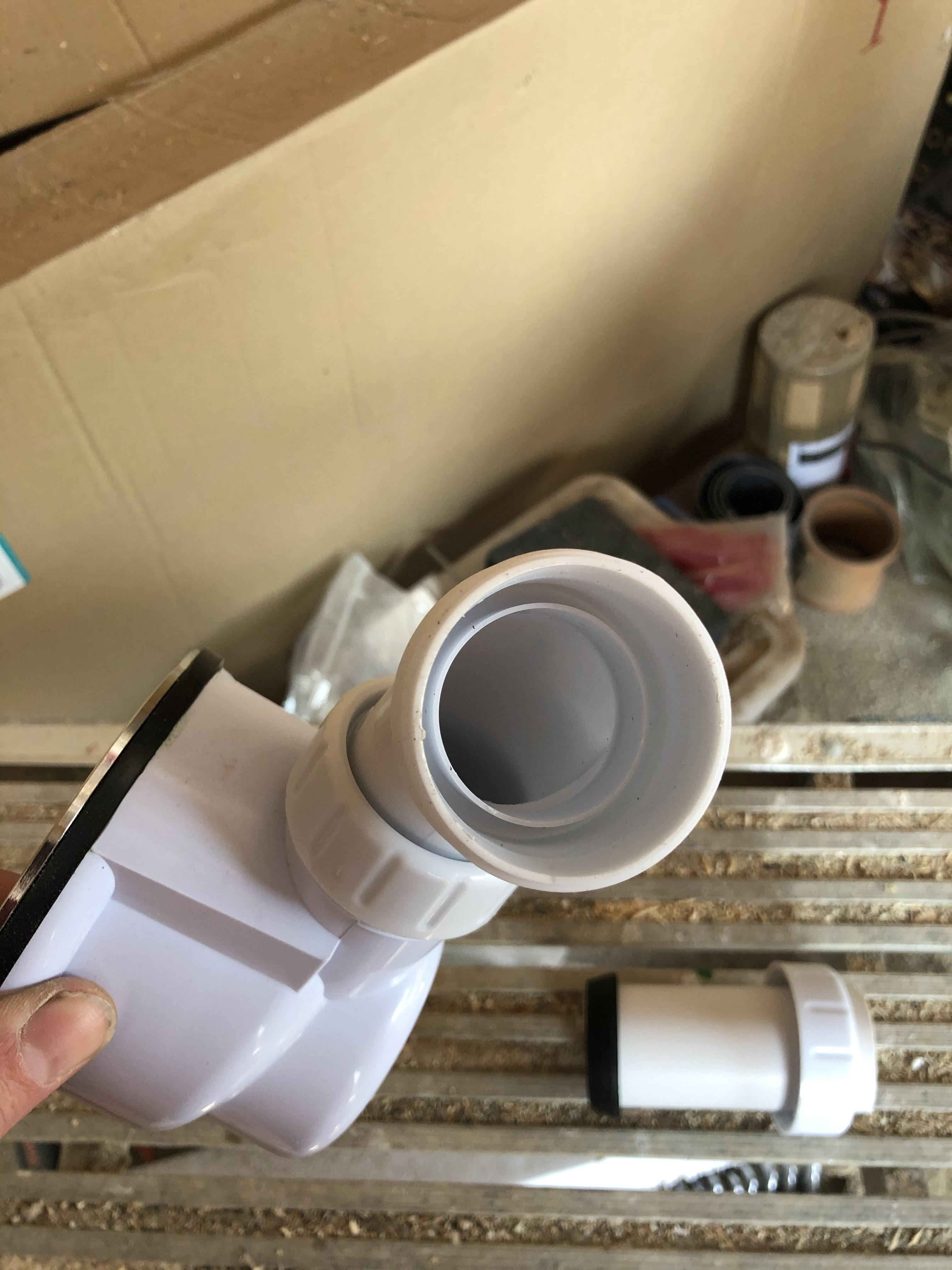

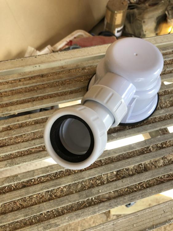

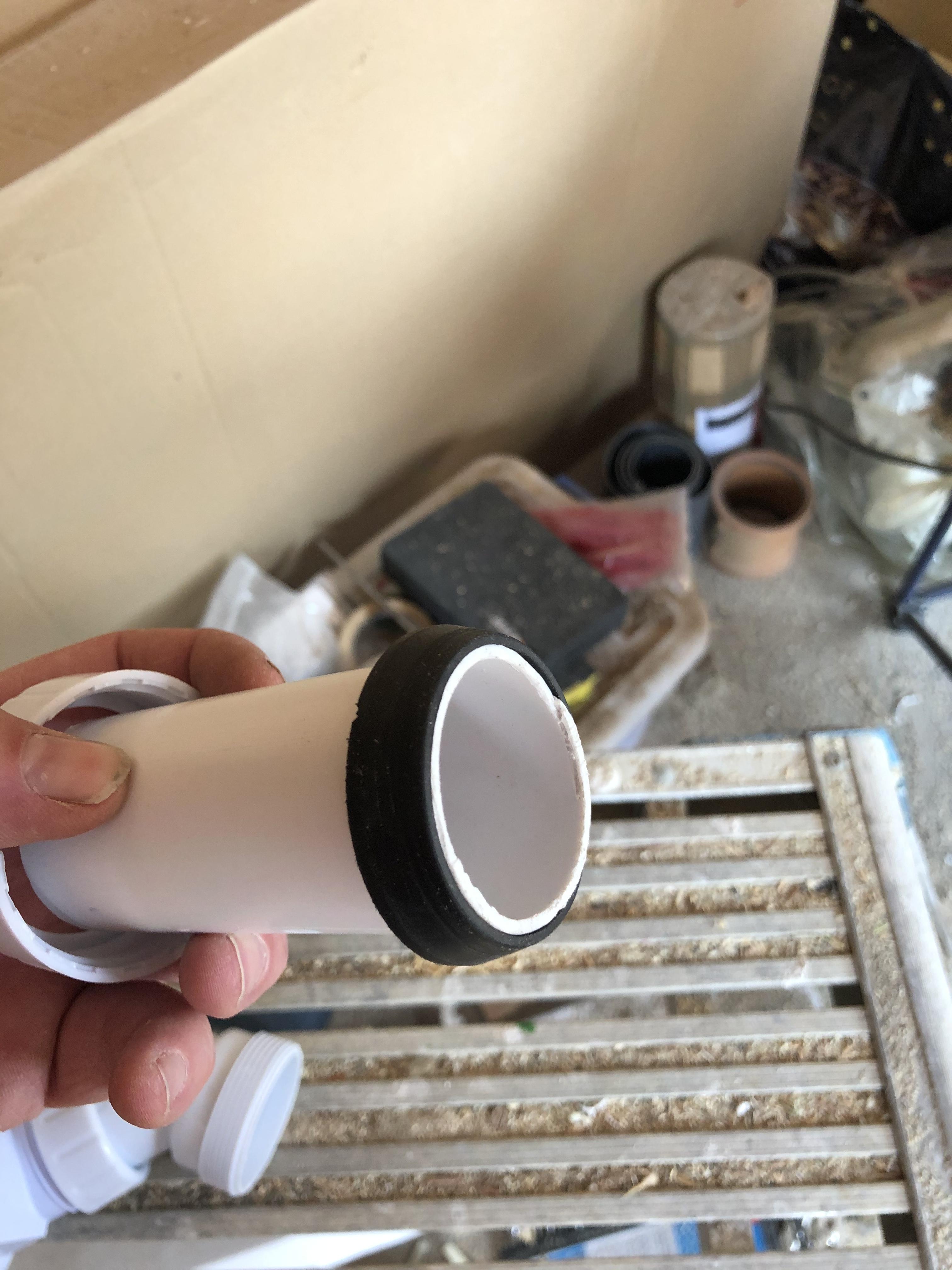

Pocster Posted April 14, 2020 Author Posted April 14, 2020 Here are the photos As you can see rubber ring in fitting no problem . Around pipe - it’s just not going to fit - this can’t be right can it ? ( pipe is 42mm )
joe90 Posted April 14, 2020 Posted April 14, 2020 (edited) Is it solvent weld pipe ? If I remember solvent weld pipe is a little bigger than compression, also make sure pipe is fully inserted into socket , then push rubber into socket with some silicone lube. This is a problem with mixing compression with weld fittings (but they should go in.) just found this. An example: A 40mm push-fit pipe has a 40-41mm external diameter but a 40mm solvent pipe has a 43mm external diameter. The difference between the two means they aren’t directly compatible Edited April 14, 2020 by joe90 1 1
Pocster Posted April 14, 2020 Author Posted April 14, 2020 On 14/04/2020 at 09:22, joe90 said: Is it solvent weld pipe ? If I remember solvent weld pipe is a little bigger than compression, also make sure pipe is fully inserted into socket , then push rubber into socket with some silicone lube. This is a problem with mixing compression with weld fittings (but they should go in.) just found this. An example: A 40mm push-fit pipe has a 40-41mm external diameter but a 40mm solvent pipe has a 43mm external diameter. The difference between the two means they aren’t directly compatible Expand Yes . The pipe I’m using as an example is solvent weld . I’ll try and get a push fit pipe ; as a small diameter . Assuming that works still want to ‘convert’ as soon as I can go solvent weld . Presumably I’ll need some form of compression joint that will take 40mm and 43mm ? I.e compression pipe in , solvent weld pipe out .

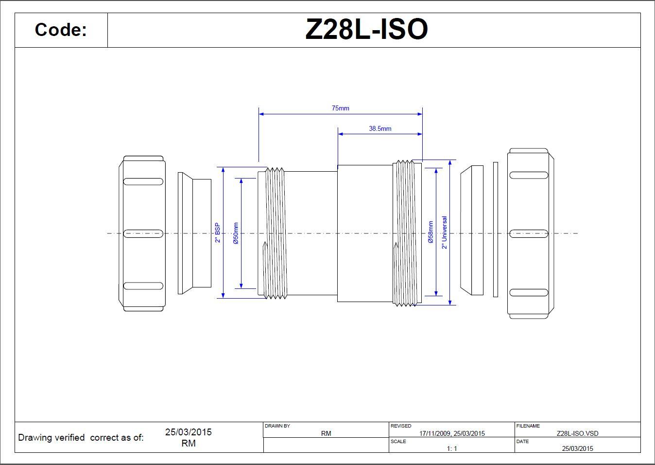

Onoff Posted April 14, 2020 Posted April 14, 2020 Probably no help at all this..... My Geberit wall drain (the silver thing on the left) had a 50mm outside dia pipe coming out the side. MDPE I believe, same stuff as their flush pipes. (Yet to be shortened in the photo). My black, "2 inch" solvent weld pipe on the right had an outside diameter of nom 56mm. The white coupler in the middle is a McAlpine Multifit one. They do various ones to cater for "BSP" one end / "European" the other. Think it was @ProDave had loads fof grief when "50mm" wasn't 50mm or something like that. Can be a bit of a minefield. https://mcalpineplumbing.com/plastic-chrome-fittings/multifit-waste-fittings/s28l-isoc-multifit-straight-connector-multifit-x-european-pipe-size There's tecnical drawings on that McAlpine link above. This is the one for mine: 1
ProDave Posted April 14, 2020 Posted April 14, 2020 It was me that bought a 110mm to "50mm" adaptor from ebay. When I got it I found my "50mm" solvent weld pipe (which is actually about 56mm) would not fit, not even remotely close. I then found the fitting was made to take pipe that was 50mm outside diameter, and I never did find any UK pipe that was actually 50mm diameter. The ebay seller got shirty when I left negative feedback saying "This does not fit any UK size pipe and should not be on sale in the UK. Avoid" 2
joe90 Posted April 14, 2020 Posted April 14, 2020 (edited) @pocster I think this is what you need. https://www.bes.co.uk/polypipe-universal-40-mm-white-to-solvent-socket-abs-11142?ref=gs&photo=true&gclid=CjwKCAjwvtX0BRAFEiwAGWJyZOkfNqHDOsCN8hUBkVPfApVCdqPiG2oDvHGSJ-VeoqKinkvk_4IGExoCm88QAvD_BwE Edited April 14, 2020 by joe90 1
Pocster Posted April 14, 2020 Author Posted April 14, 2020 On 14/04/2020 at 13:28, joe90 said: @pocster I think this is what you need. https://www.bes.co.uk/polypipe-universal-40-mm-white-to-solvent-socket-abs-11142?ref=gs&photo=true&gclid=CjwKCAjwvtX0BRAFEiwAGWJyZOkfNqHDOsCN8hUBkVPfApVCdqPiG2oDvHGSJ-VeoqKinkvk_4IGExoCm88QAvD_BwE Expand Awesome ! Will order one ?
