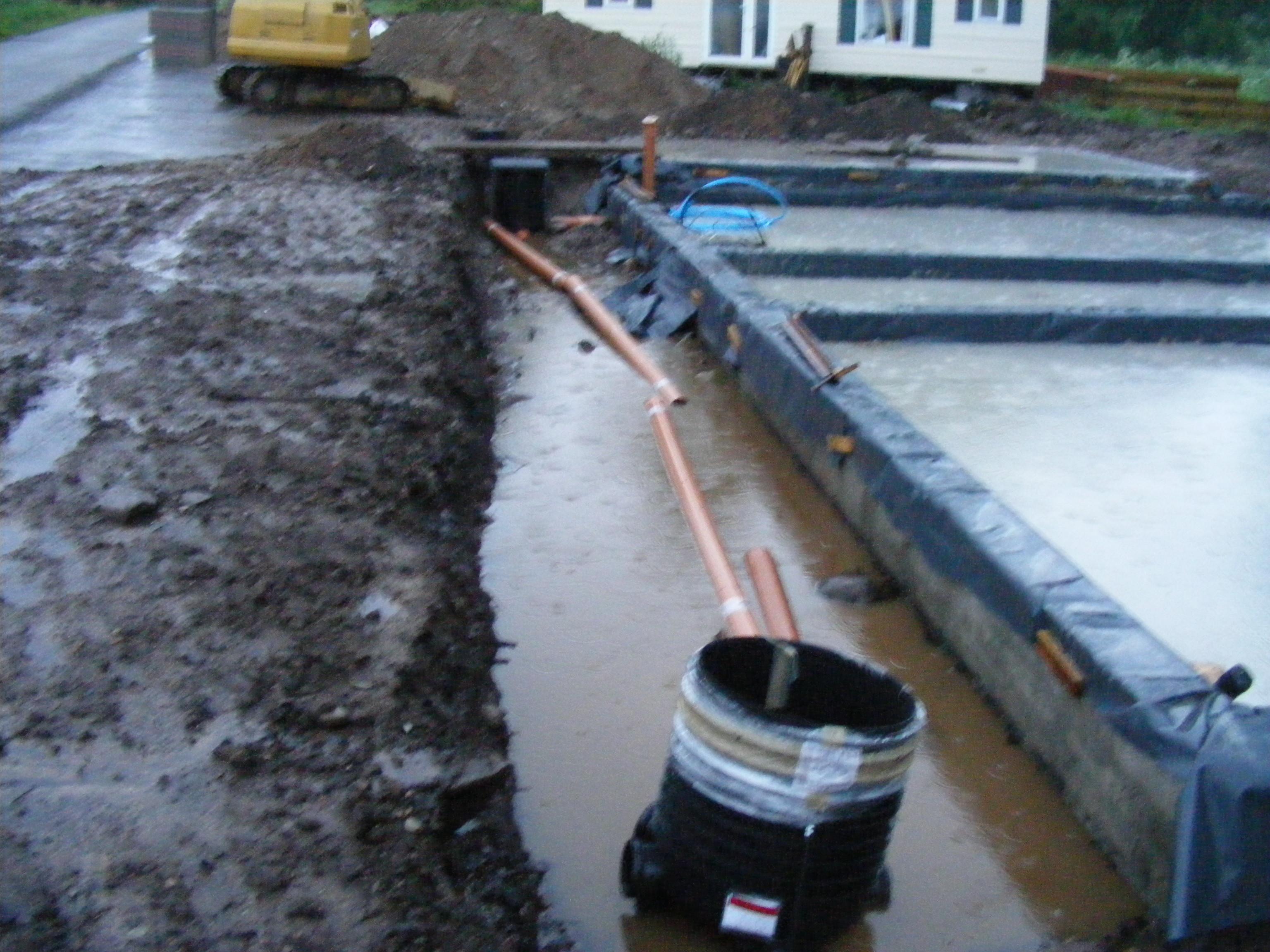

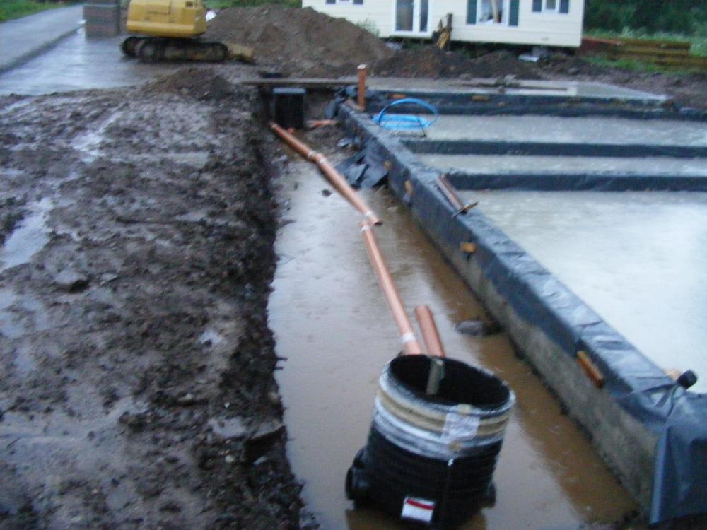

ProDave Posted April 1, 2020 Posted April 1, 2020 Make SURE the trench cannot fill with water. Empty pipes FLOAT. Ask me how I know 2
Mike Posted April 1, 2020 Posted April 1, 2020 On 01/04/2020 at 12:25, ProDave said: Empty pipes FLOAT. Expand Great picture! Another reason to use clay pipes...
