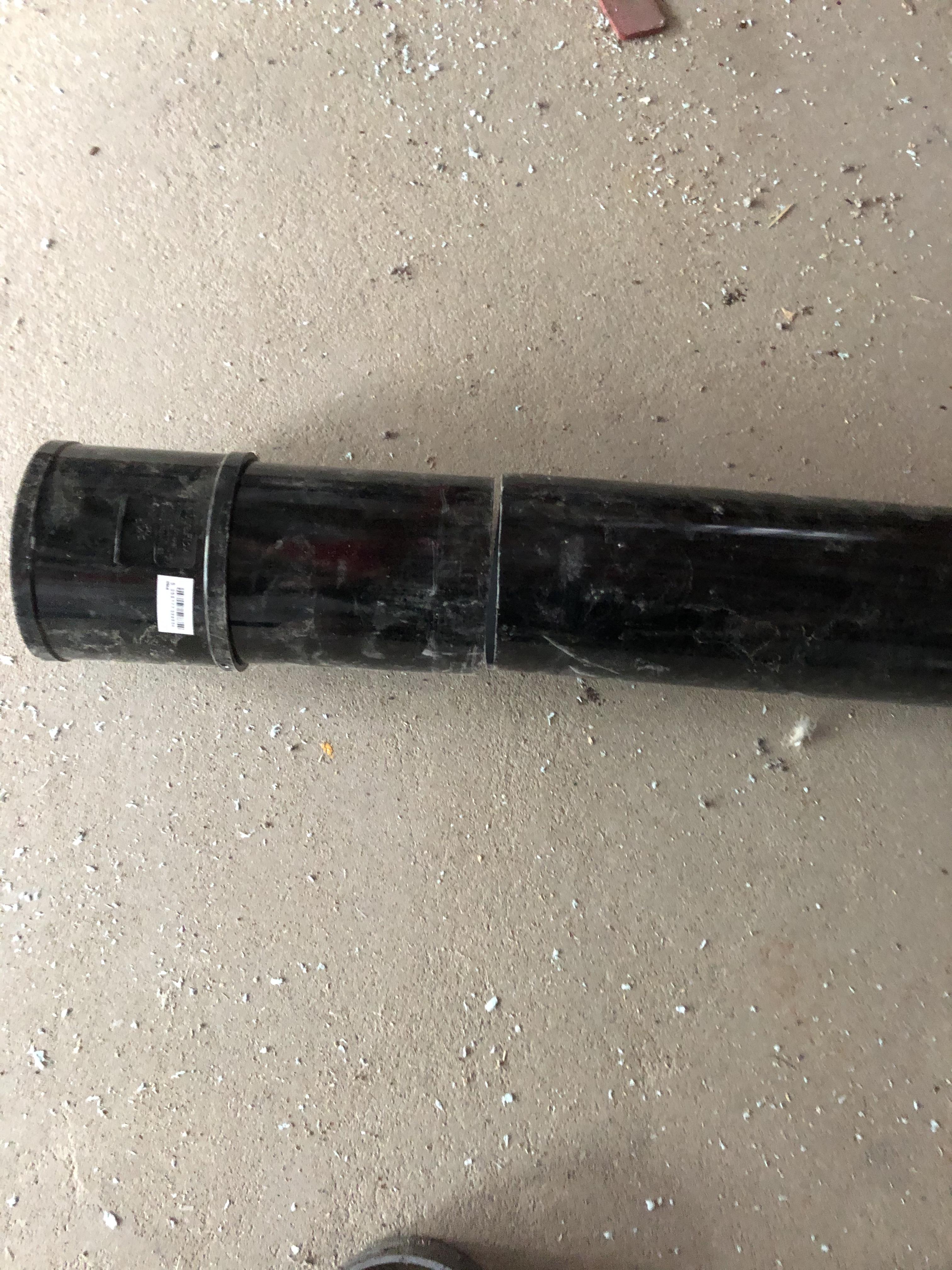

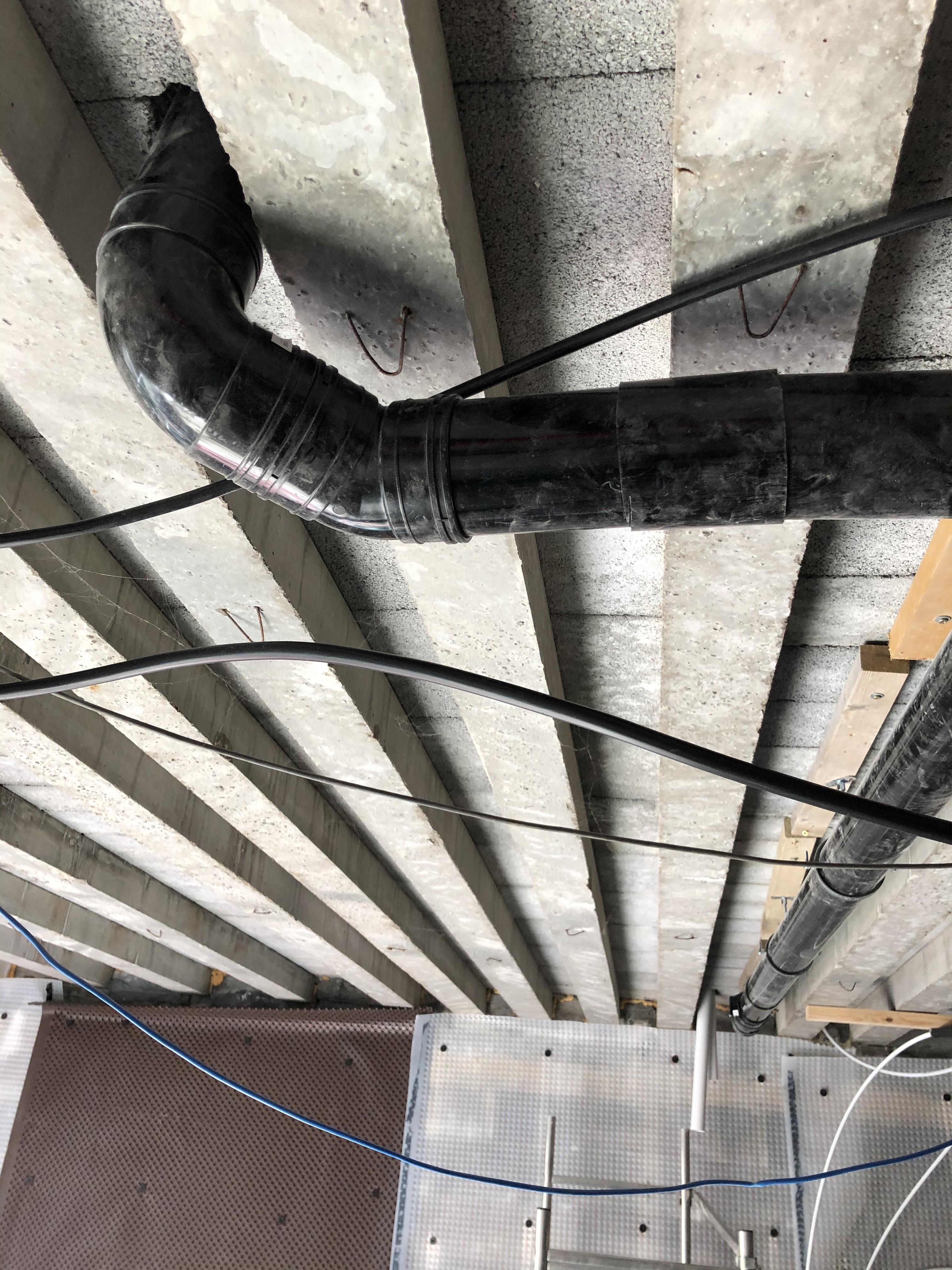

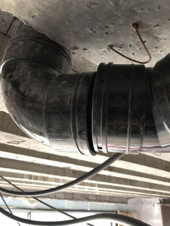

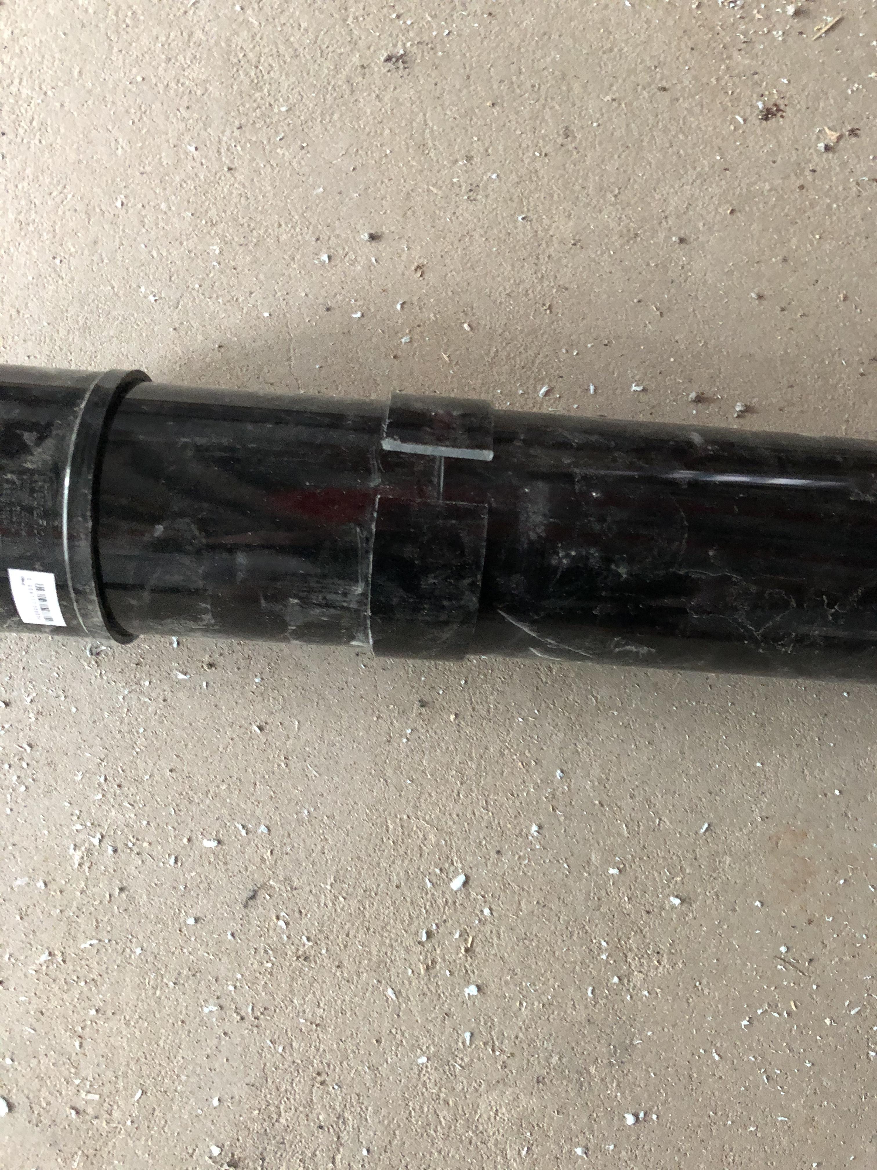

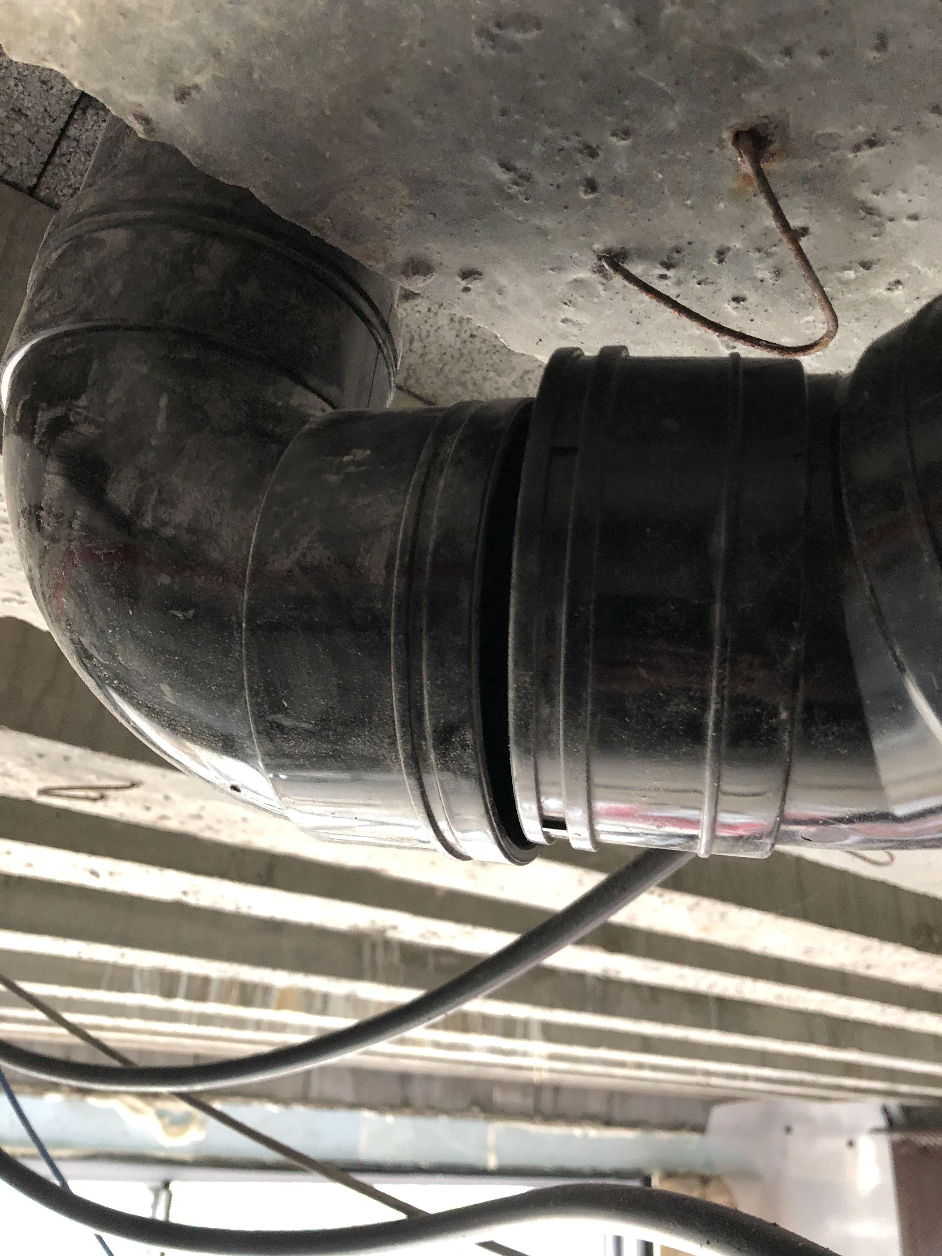

Pocster Posted March 30, 2020 Author Share Posted March 30, 2020 Hmmmmm , I thought this joint would be the easy one ! As you can see I can get pretty close to a line up . But there’s no way I can insert / glue as I go - just not enough play . Taking @MikeSharp01 idea is this concept acceptable ? . Obviously I’d cut a longer overlay section . This then avoids the problem of pushing joint into joint . Link to comment Share on other sites More sharing options...
Pocster Posted March 30, 2020 Author Share Posted March 30, 2020 I’ve actually got a coupler I could cut to do this. Not sure it would be flexible enough to go around the pipe . Could cut a ‘chunk’ out of it to make it fit , even glue the cut bit back in aswell . This all a big no no ??!? Link to comment Share on other sites More sharing options...

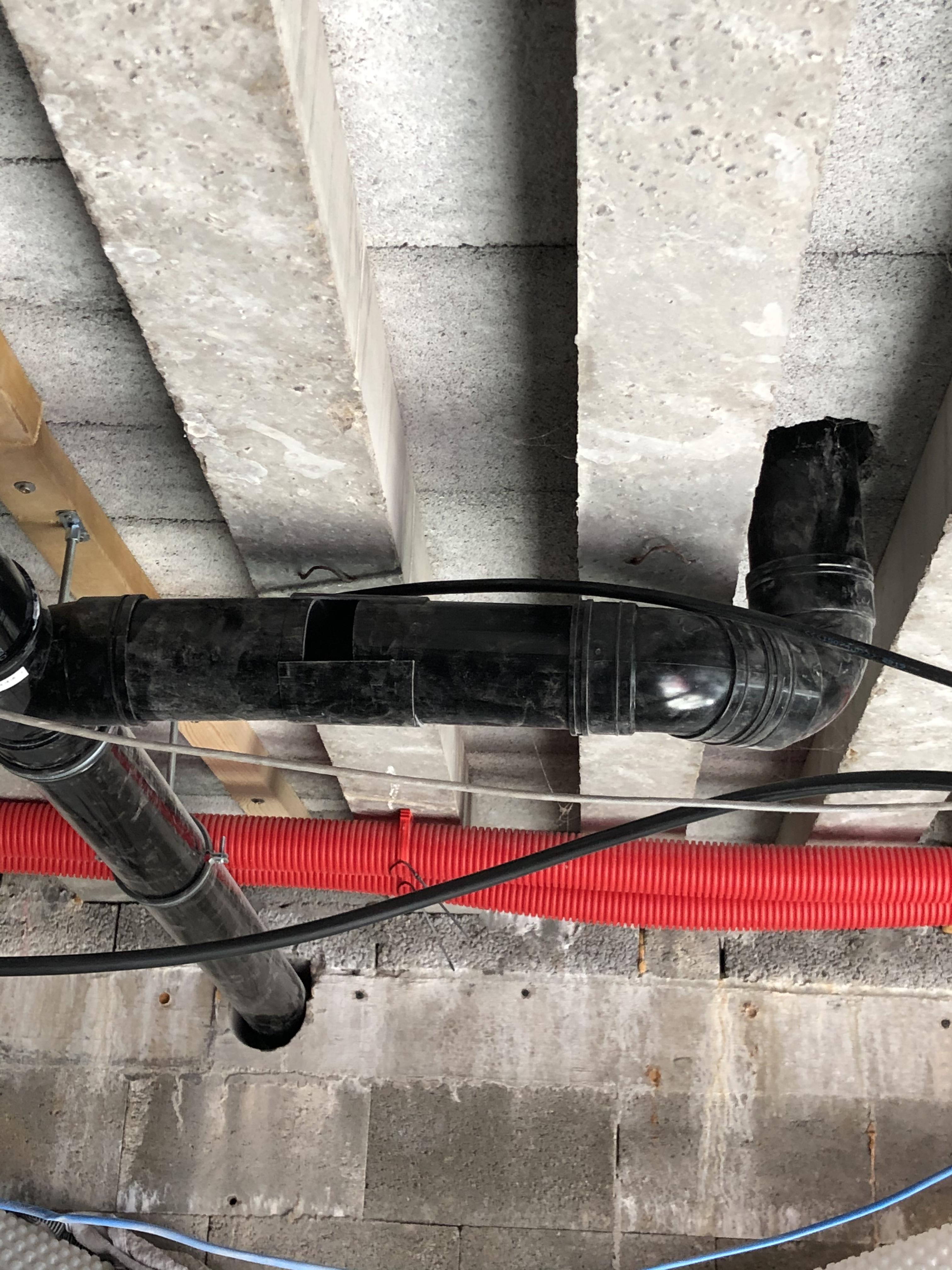

ProDave Posted March 30, 2020 Share Posted March 30, 2020 Am I missing something? What you want is a slip coupling in that straight section, so you assemble the two ends then join together with a slip coupling. I would use a push fit slip (not even sure you can get a solvent weld slip coupling) 1 Link to comment Share on other sites More sharing options...
MikeSharp01 Posted March 30, 2020 Share Posted March 30, 2020 33 minutes ago, pocster said: Taking @MikeSharp01 idea is this concept acceptable ? . Obviously I’d cut a longer overlay section . You wold need to make a section that filled the piston ring cut otherwise you would have a hole. My idea was really to seal around the face of joint if there was a leak though a previous glue job. 1 Link to comment Share on other sites More sharing options...
Pocster Posted March 30, 2020 Author Share Posted March 30, 2020 3 minutes ago, ProDave said: Am I missing something? What you want is a slip coupling in that straight section, so you assemble the two ends then join together with a slip coupling. I would use a push fit slip (not even sure you can get a solvent weld slip coupling) Probably I’m missing something ! So a slip coupling slides over one pipe and then slides down over the join ? Not heard of one because of course they don’t exist in weld world . Is a weld not better in these circumstances even if it’s a cut ? Link to comment Share on other sites More sharing options...
Pocster Posted March 30, 2020 Author Share Posted March 30, 2020 @ProDave this yeah ? https://www.jtmplumbing.co.uk/pipe-fittings-c433/jtm-above-ground-soil-fittings-c741/jtm-double-socket-slip-coupler-p23366/s39677?utm_source=google&utm_medium=cpc&utm_term=jtm-grey-ds-slip-coupler-110mm-grey-ds-slip-coupler-110mm-grey-ds-slip-coupler-110mm-splg0019&utm_campaign=product%2Blisting%2Bads&cid=GBP&gclid=EAIaIQobChMIpK_n_vrB6AIVCbTtCh1-CApNEAQYASABEgK5EvD_BwE Just tried it for proof of concept . And yes the pipes are too far apart - just wanted too see if the theory worked . But yes could marry them up with a slip coupling . Link to comment Share on other sites More sharing options...
Pocster Posted March 30, 2020 Author Share Posted March 30, 2020 8 minutes ago, MikeSharp01 said: You wold need to make a section that filled the piston ring cut otherwise you would have a hole. My idea was really to seal around the face of joint if there was a leak though a previous glue job. Yeah I know . I just took inspiration ( madness ) from your suggestion ? Link to comment Share on other sites More sharing options...
ProDave Posted March 30, 2020 Share Posted March 30, 2020 Yes that is the coupling. Chamfer BOTH ends of the pipe really well, use plenty of lubricant, slide the slip coupling onto one pipe all the way over, offer the 2 pipes up and then slide it back. Don't forget to mark the pipe so you know how far to slide it back. And just to say it again a really good chamfer and plenty of lube. 1 Link to comment Share on other sites More sharing options...
Pocster Posted March 30, 2020 Author Share Posted March 30, 2020 3 minutes ago, ProDave said: Yes that is the coupling. Chamfer BOTH ends of the pipe really well, use plenty of lubricant, slide the slip coupling onto one pipe all the way over, offer the 2 pipes up and then slide it back. Don't forget to mark the pipe so you know how far to slide it back. And just to say it again a really good chamfer and plenty of lube. The only thing that worries me is that as the pipes don’t line up precisely then will not go into the coupler dead straight . The coupler will be the point at which the pipes ‘bend’ as it were . Does a coupler allow for this ? I.e a certain degree of non straightness for the pipes entering ? ( basically no leak ) Link to comment Share on other sites More sharing options...
scottishjohn Posted March 30, 2020 Share Posted March 30, 2020 not saying don,t use a coupler,probably fine --but if worried about seal -use that along with tigerseal when it comes maybe? 1 Link to comment Share on other sites More sharing options...
Pocster Posted March 30, 2020 Author Share Posted March 30, 2020 (edited) 5 minutes ago, scottishjohn said: not saying don,t use a coupler,probably fine --but if worried about seal -use that along with tigerseal when it comes maybe? Yeah . Could do . Slide push fit coupler up . Tiger seal both pipe ends . Then coupler down . Belts n braces approach preferred ! ?? Edited March 30, 2020 by pocster Link to comment Share on other sites More sharing options...
MikeSharp01 Posted March 30, 2020 Share Posted March 30, 2020 If one slip coupler not long enough then use two with a length of pipe between 1 Link to comment Share on other sites More sharing options...

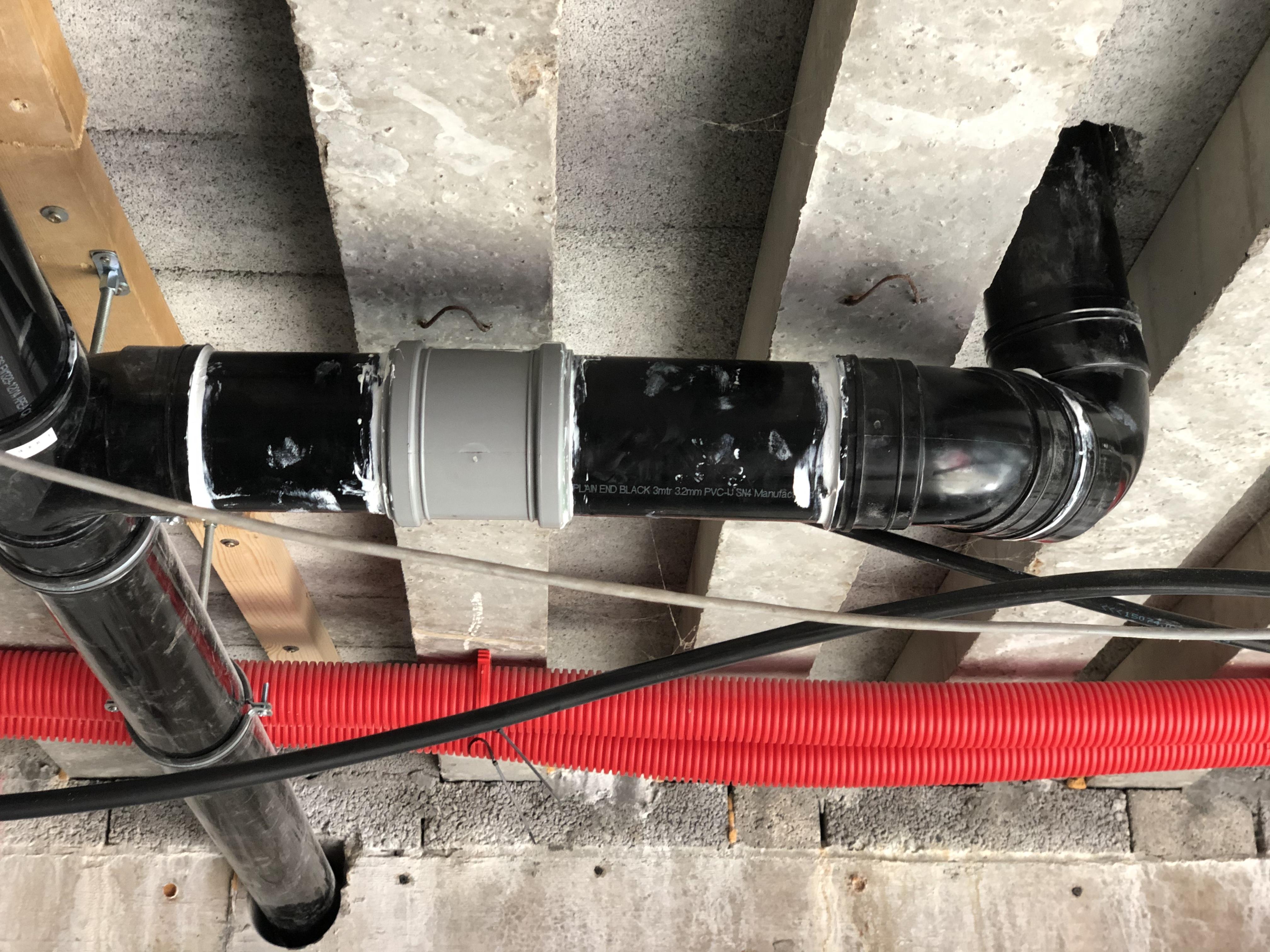

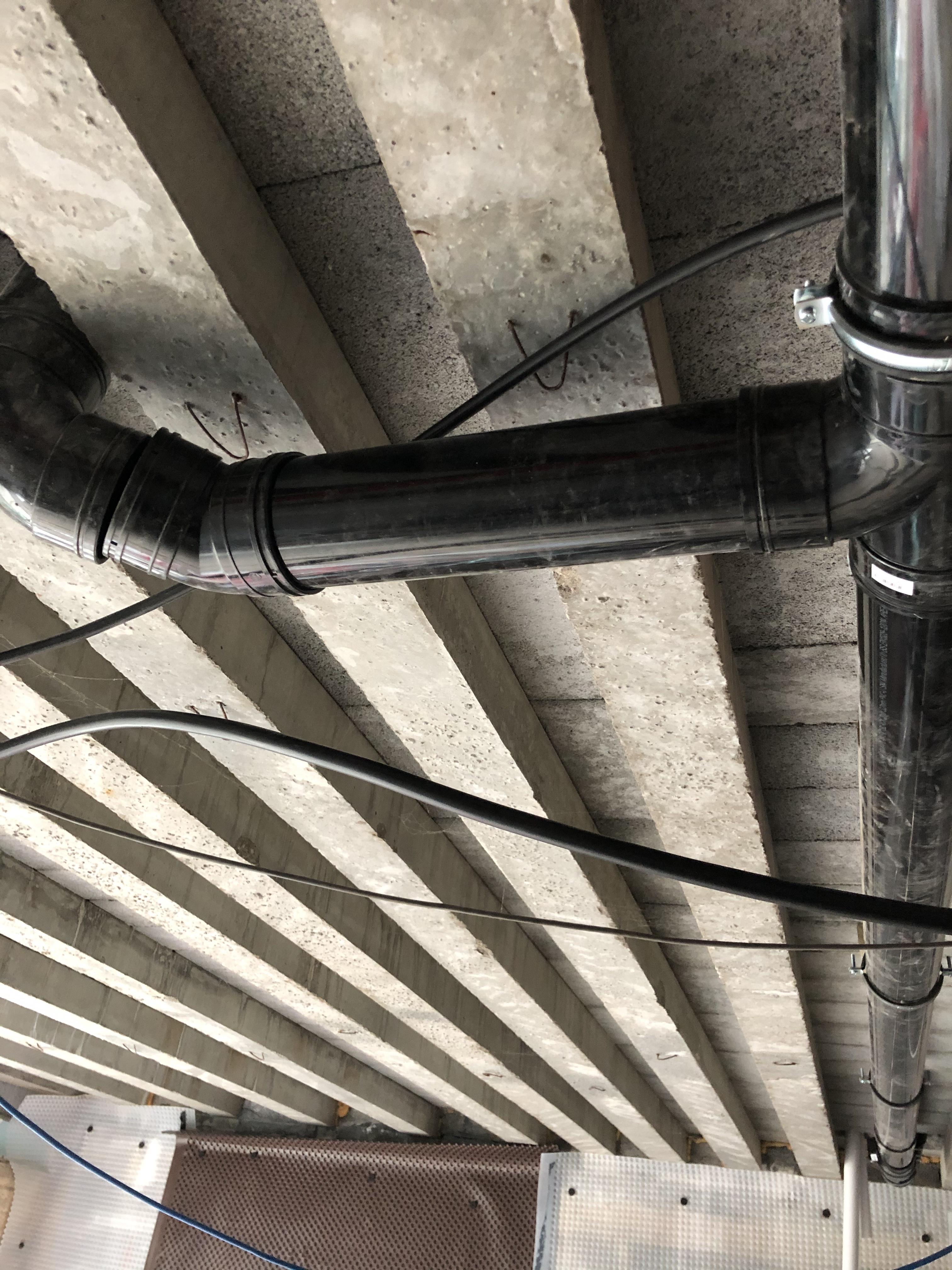

Pocster Posted April 2, 2020 Author Share Posted April 2, 2020 Not pretty but done. Not confident - getting the slip coupler fully across is impossible no matter how chamfered and lube. I will leave it a few days to dry . Then I’ll run water down that pan . If that’s ok I’ll block the drain and fill the entire pipe . If it fails I’ll cut the coupler out and weld it - easier to position , no sliding !! It was a good workout though !! Link to comment Share on other sites More sharing options...
scottishjohn Posted April 2, 2020 Share Posted April 2, 2020 hope you cleaned all the silicone gel off before using the tigerseal --if it leaks it will be because the surface was not clean ,notihng else that stuff sticks like sxxt to a blanket Link to comment Share on other sites More sharing options...
Carrerahill Posted April 2, 2020 Share Posted April 2, 2020 (edited) 18 minutes ago, pocster said: Not pretty but done. Not confident - getting the slip coupler fully across is impossible no matter how chamfered and lube. I will leave it a few days to dry . Then I’ll run water down that pan . If that’s ok I’ll block the drain and fill the entire pipe . If it fails I’ll cut the coupler out and weld it - easier to position , no sliding !! It was a good workout though !! Is there no support on the RHS as the vertical take a bend to the horizontal? If not, I would get one on to the bend as it changes or the force and weight of the water will probably eventually push that joint down. Edited April 2, 2020 by Carrerahill Link to comment Share on other sites More sharing options...
Pocster Posted April 2, 2020 Author Share Posted April 2, 2020 9 minutes ago, Carrerahill said: Is there no support on the RHS as the vertical take a bend to the horizontal? If not, I would get one on to the bend as it changes or the force and weight of the water will probably eventually push that joint down. Yeah I already planned to add a joint later 1 Link to comment Share on other sites More sharing options...
Pocster Posted April 2, 2020 Author Share Posted April 2, 2020 (edited) 26 minutes ago, scottishjohn said: hope you cleaned all the silicone gel off before using the tigerseal --if it leaks it will be because the surface was not clean ,notihng else that stuff sticks like sxxt to a blanket Yeah . It was tricky ! I need lube to get it on but also need it dry for the tiger seal . Hence why I’m not convinced in this situation it will work . Soon find out . Otherwise a weld as it requires no lube , no sliding , definitely easier . No biggie to cut it out if no good - worth a shot . Edited April 2, 2020 by pocster Link to comment Share on other sites More sharing options...

scottishjohn Posted April 2, 2020 Share Posted April 2, 2020 1 hour ago, pocster said: Yeah . It was tricky ! I need lube to get it on but also need it dry for the tiger seal . Hence why I’m not convinced in this situation it will work . Soon find out . Otherwise a weld as it requires no lube , no sliding , definitely easier . No biggie to cut it out if no good - worth a shot . I would have jusat used the tigerseal as the lubricant and sealer all in one go -not just applied a bead to outer edge as you seem to have done as long as it works 1 Link to comment Share on other sites More sharing options...
Pocster Posted April 2, 2020 Author Share Posted April 2, 2020 43 minutes ago, scottishjohn said: I would have jusat used the tigerseal as the lubricant and sealer all in one go -not just applied a bead to outer edge as you seem to have done as long as it works Maybe . It is a push fit coupler so in theory needs no gluing . I needed the lube to get that bugger on ! Link to comment Share on other sites More sharing options...
