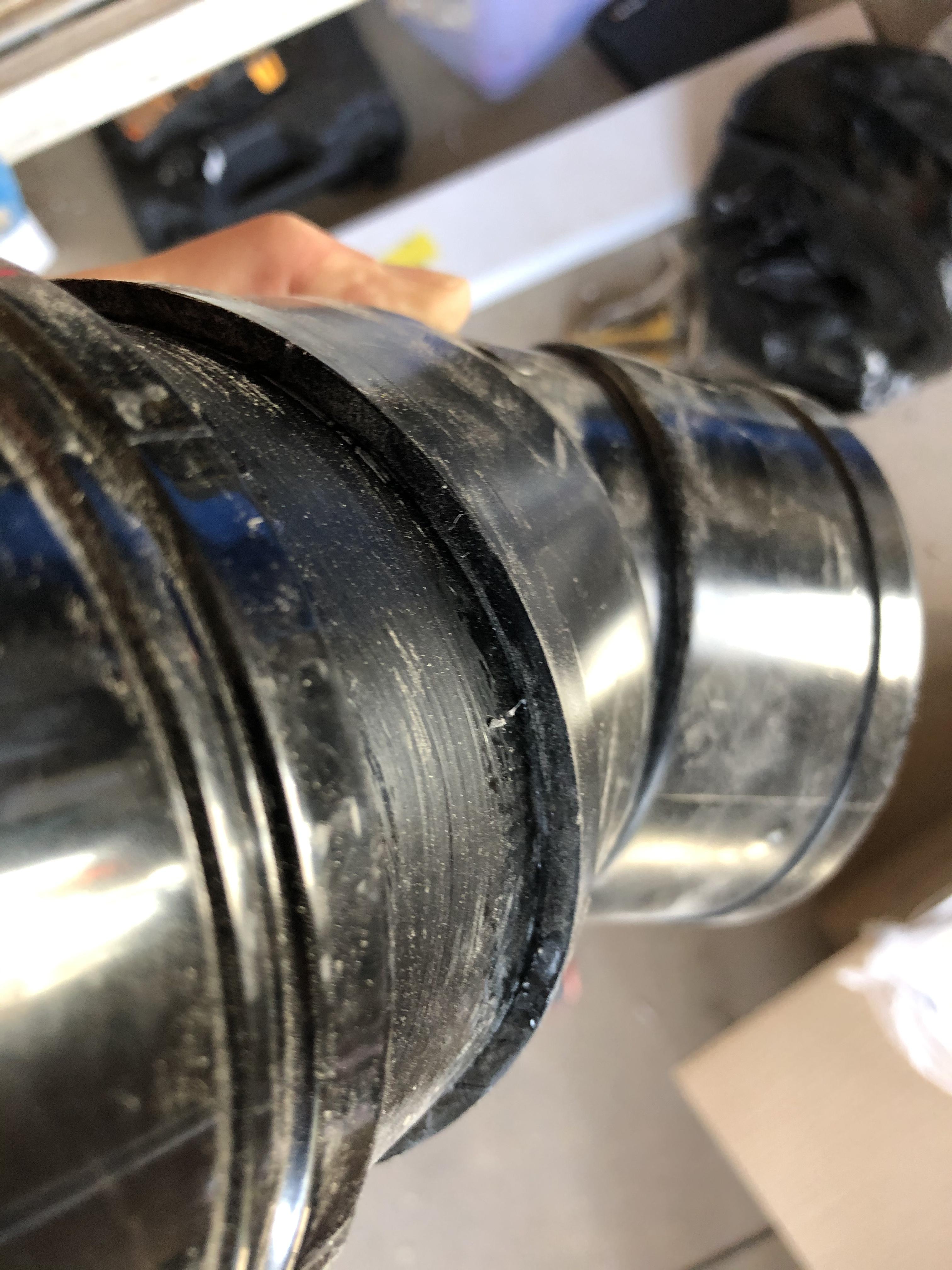

Pocster Posted March 25, 2020 Author Share Posted March 25, 2020 It was the right call . This joint ( probably less than a mm gap ) I can see daylight . Doesn’t show in the photo but it’s there . I need to construct a way where I can piece by piece assemble and glue with less time constraint v2 Link to comment Share on other sites More sharing options...
Pocster Posted March 25, 2020 Author Share Posted March 25, 2020 STOP F ‘ing laughing EVERYONE ! Link to comment Share on other sites More sharing options...
scottishjohn Posted March 25, 2020 Share Posted March 25, 2020 (edited) 2 minutes ago, pocster said: STOP F ‘ing laughing EVERYONE ! use sixflex or tiger seal --that will take an hour or so to stick firm and up to 24 hrs to be solid --depending on thickness--stuff they stick windscreens in with Edited March 25, 2020 by scottishjohn 1 Link to comment Share on other sites More sharing options...
Pocster Posted March 25, 2020 Author Share Posted March 25, 2020 8 minutes ago, scottishjohn said: use sixflex or tiger seal --that will take an hour or so to stick firm and up to 24 hrs to be solid --depending on thickness--stuff they stick windscreens in with Yeah ? I was using the usual flo plast stuff Link to comment Share on other sites More sharing options...
Pocster Posted March 25, 2020 Author Share Posted March 25, 2020 10 minutes ago, scottishjohn said: use sixflex or tiger seal --that will take an hour or so to stick firm and up to 24 hrs to be solid --depending on thickness--stuff they stick windscreens in with Ordered a tube of tiger seal . Anything more than 30 seconds would be good . I just used what plumbing website had . If this is just as good but gives time then that is mega helpful ! ? Link to comment Share on other sites More sharing options...

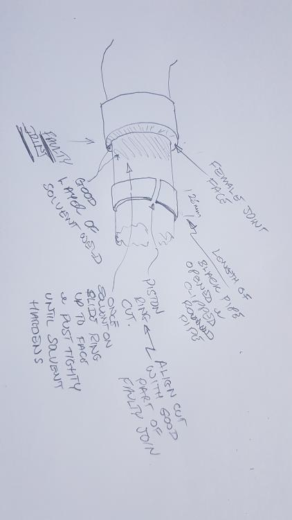

MikeSharp01 Posted March 25, 2020 Share Posted March 25, 2020 Not sure if this is mentioned but it has raced to so00000 long that I am not sure I have the -.... anyway. My solution would be cut a 25mm length of the black pipe, create a cut in the ring (piston ring style) clean up the surfaces with care and spring it over the offending section align the cut with a good bit of the join. Put the solvent cement 25mm along and around the pipe and around the whole face of the female joint that is the problem. Slide the ring up to the face and push hard while the solvent does its work, that should seal it. Link to comment Share on other sites More sharing options...

Pocster Posted March 25, 2020 Author Share Posted March 25, 2020 1 hour ago, ProDave said: A lesson from this thread for the novice might be forget solvent weld and use push fit where you can. No time limit, plenty of time to do each joint one at a time, and if you have a space issue, a slip coupling is your friend. Wanted solvent weld . Now I have some tiger sealant on the way that will buy me time . Solvent weld I still think is exactly what’s needed for this situation Link to comment Share on other sites More sharing options...
Pocster Posted March 25, 2020 Author Share Posted March 25, 2020 1 hour ago, MikeSharp01 said: Not sure if this is mentioned but it has raced to so00000 long that I am not sure I have the -.... anyway. My solution would be cut a 25mm length of the black pipe, create a cut in the ring (piston ring style) clean up the surfaces with care and spring it over the offending section align the cut with a good bit of the join. Put the solvent cement 25mm along and around the pipe and around the whole face of the female joint that is the problem. Slide the ring up to the face and push hard while the solvent does its work, that should seal it. I’ve read this a few times . Not sure I get what you are suggesting - sorry . Link to comment Share on other sites More sharing options...
MikeSharp01 Posted March 25, 2020 Share Posted March 25, 2020 Hope pic helps 1 Link to comment Share on other sites More sharing options...
Pocster Posted March 25, 2020 Author Share Posted March 25, 2020 17 minutes ago, MikeSharp01 said: Hope pic helps Very helpful appreciated! Link to comment Share on other sites More sharing options...
