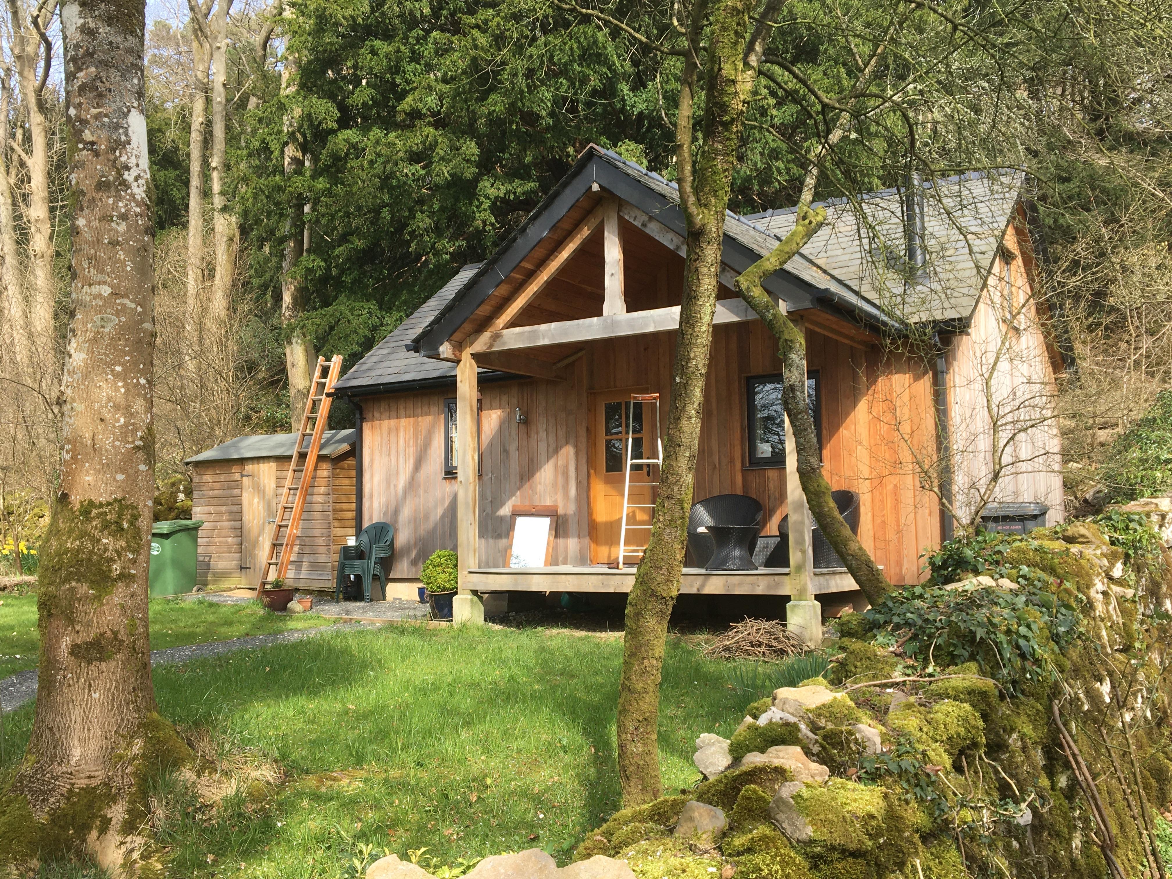

Triassic Posted March 23, 2020 Share Posted March 23, 2020 (edited) how about something like this. Built using new timber and 120mm of insulation in the walls and roof. 50m2, lounge/kitchen, double bedroom, shower room and storage space over bedroom. Total cost £30k. If you use secondhand free stuff you could probably do it for half that price. ps local builders merchant are closing tonight and no online ordering or delivery to site. Edited March 23, 2020 by Triassic Link to comment Share on other sites More sharing options...
