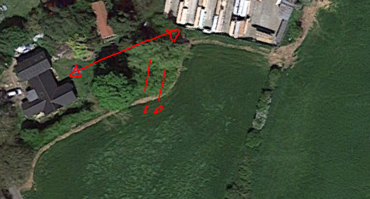

oranjeboom Posted April 13, 2020 Share Posted April 13, 2020 Thanks @Ferdinand - indeed, that's down to £2.30/m now! Delivery is certainly pushing the price up by £100 but I have no choice. The annoying thing is that I have a bloody timber yard at the back of my garden - within arms length. But of course it is shut. Link to comment Share on other sites More sharing options...
