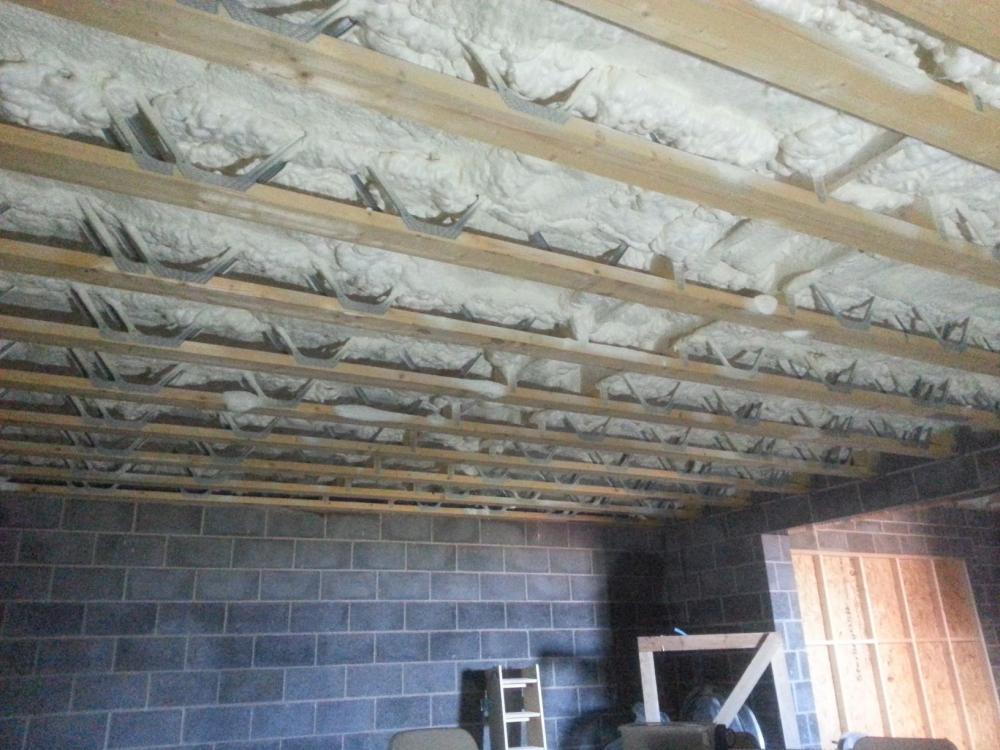

readiescards Posted March 27, 2017 Author Share Posted March 27, 2017 On 25/03/2017 at 09:53, Alexphd1 said: @readiescards i know you still have to plaster board etc but have you noticed a sound reduction from upstairs with the spray foam in the posi-joists? I can't directly answer that question as the whole spray foam was installed at the same time and sound proofness of the whole house improved substantially - reducing the sound of the wind and rain outside and softening the internal echos. Much better. Last bit of posijoist installation goes in mid-April and I'm hoping for a reduction of interfloor sound transmission but given there is not much noise around at the moment it will be hard to gauge the amount. Link to comment Share on other sites More sharing options...

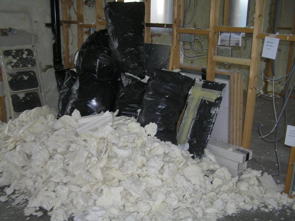

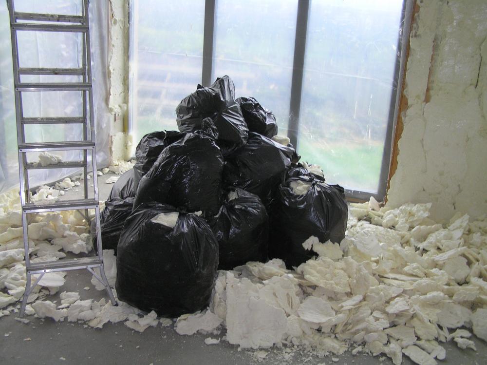

readiescards Posted April 11, 2017 Author Share Posted April 11, 2017 Got rid of my offcuts :-) Offered it for free on Facebook and guy came and the bags away to use for stuffing targets for shooting practice. Ideal use I reckon. Though going to be a big mess to tidy up I think. Link to comment Share on other sites More sharing options...

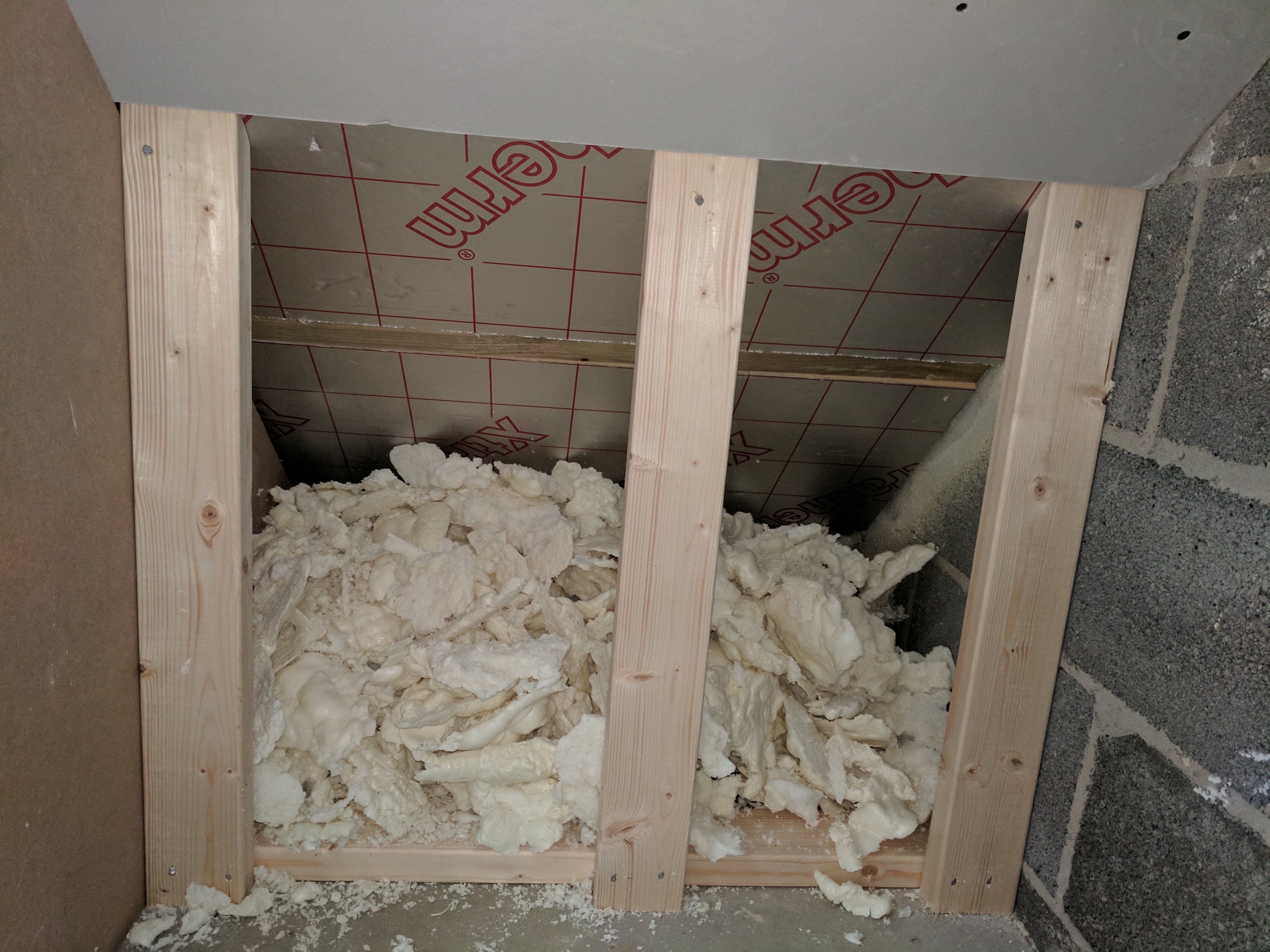

readiescards Posted October 10, 2017 Author Share Posted October 10, 2017 Found another place to 'lose' some of the foam off cuts - in the eaves of my office room. (Also have dumped a lot of PIR foam off cuts in there too) Link to comment Share on other sites More sharing options...
Nickfromwales Posted October 10, 2017 Share Posted October 10, 2017 Don't ever lose a hamster in the house mate, it'll be years before it resurfaces 1 1 Link to comment Share on other sites More sharing options...

JohnMo Posted January 26, 2023 Share Posted January 26, 2023 On 22/01/2023 at 08:42, readiescards said: 5 years on, my thoughts are that spray foam insulation is expensive and fairly ineffective as an insulation product (maybe a side effect of it's breathability) I would not encourage anyone to use it. We have a roof over 240m2 all vaulted and have 350mm of icycrene spray foam, behind an airtight vapour control layer. Heat loss is pretty much as predicted. Agree it is expensive, but compared to spending weeks doing insulation and ripping my hands apart stuffing between the metal webs of posi rafters - a bargain, job done in two days. Link to comment Share on other sites More sharing options...
