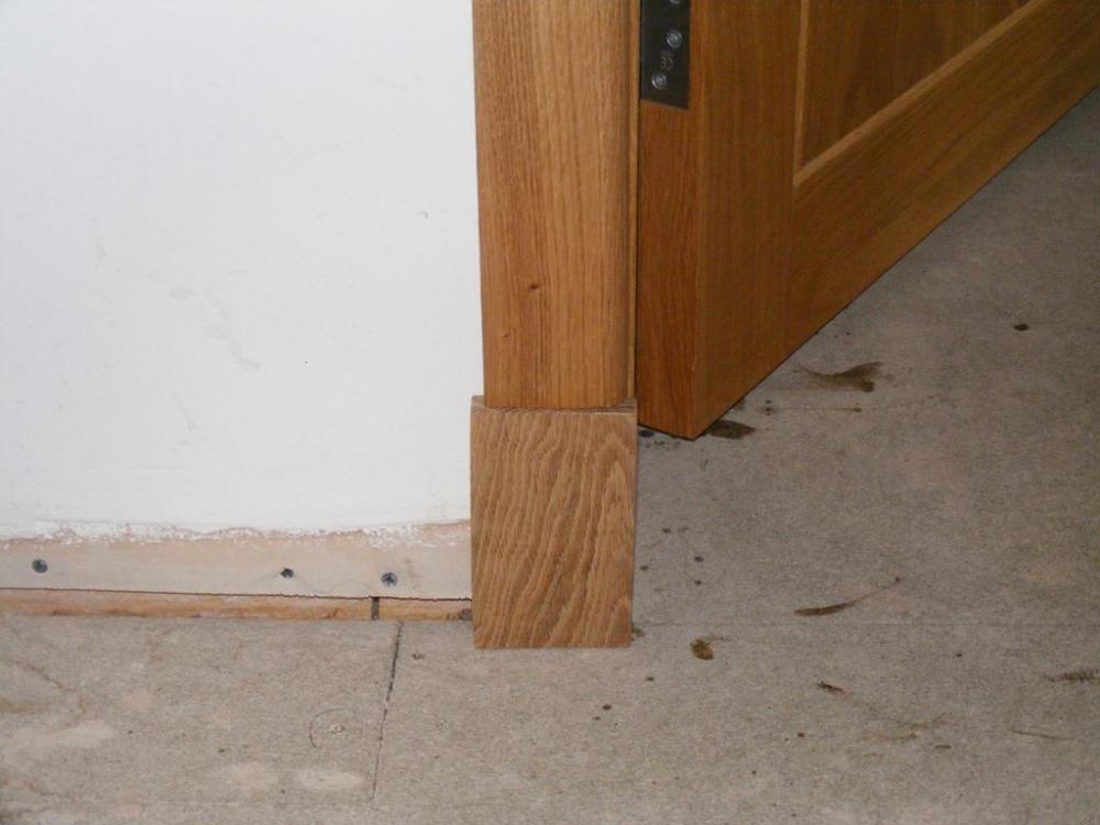

ProDave Posted March 21, 2020 Share Posted March 21, 2020 As a background activity, I am getting ready to fit the architrave and skirtings. I have started by buying a couple of lengths of oak veneered architrave and skirting from Howdens. No 1 discovery. Take one Howdens stock length of oak veneered architrace and cut the architrave for one side of a door, and the "offcut" is just a little bit too short to do the other side of the door. This is going to make it very wasteful. Now I sometimes see joiner putting a little square / rectangle joining "block" at the bottom of the architrave to join it to the skirting. As always, trying to search for those, does anyone know the proper name for it? In our case it would need to be a rectangle to join 70mm architrave to 120mm skirting, solid oak, or oak veneer covering ALL edges. If I can find some of those, then that shortens the required length of architrave so you would then get 2 out of each length with very little waste. Next question is finish. I want to pre finish them and then glue them on, I don't want to be finishing in place and cutting in all the edges and I don't want to mess about filling nail holes. So this method means the finish will have to be thoroughly dry as some clamping in place will be needed while the adhesive dries. I have coated two samples. One with Osmo oil which gives a nice finish but takes an age to dry. The other with a clear satin varnish that will dry a lot quicker. So far the clear varnish does not bring out the wood colour as well as the osmo oil. Link to comment Share on other sites More sharing options...

ProDave Posted March 21, 2020 Author Share Posted March 21, 2020 39 minutes ago, Oz07 said: Skirting block Any idea who might sell them? It seems howdens don't Link to comment Share on other sites More sharing options...

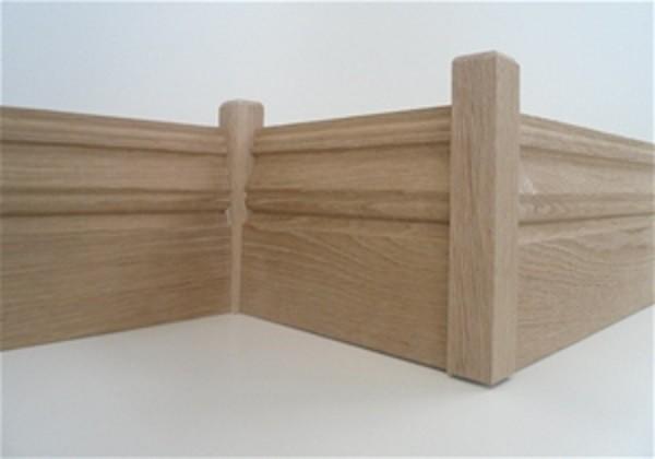

Hobbiniho Posted March 21, 2020 Share Posted March 21, 2020 yeh as said they are called skirting blocks, usually just made from solid wood to whatever size required, what profile is your skirting? as it is possible to get fancy designs etc but these are usually MDF for painting, if you have a fancy profile like ogee or lambstongue etc then it may be worth considering corner blocks aswell, this will make fitting the skirtings a lot easier. i personally used osmo oil on all my finishings (solid oak) and nailed them on the plus side about finishing them first is it is very easy to remove any excess filler from the nail holes Link to comment Share on other sites More sharing options...
ProDave Posted March 21, 2020 Author Share Posted March 21, 2020 Skirtings are plain pencil edge oak veneeered mdf and 15mm thick. So I guess these skirting blocks need to be slightly thicker, sat 20mm, and probably about 80mm by 130mm Link to comment Share on other sites More sharing options...

Hobbiniho Posted March 21, 2020 Share Posted March 21, 2020 i would go 80x125 this means the gap between the edge of the block and the edge of architrave is 5mm and edge of skirting and edge of block is 5mm, as you would want the architrave centred on the block or it will look wrong Link to comment Share on other sites More sharing options...
ProDave Posted March 21, 2020 Author Share Posted March 21, 2020 It's starting to look like I just need a length of 80mm by 20mm solid planed oak, and cut it to length to make my own blocks. That will probably work out cheapest. They seem to be coming in at about £5 each ready made and that's before I can even find one that's the right size, Link to comment Share on other sites More sharing options...

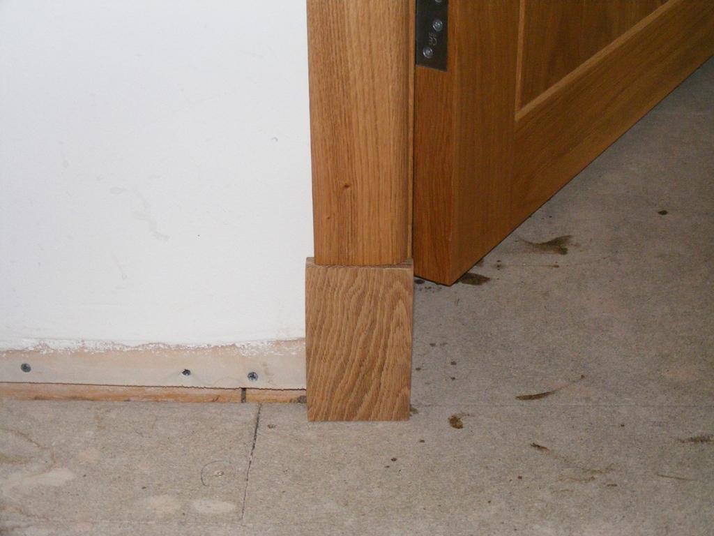

ProDave Posted March 23, 2020 Author Share Posted March 23, 2020 So I got a length of American White Oak from the merchant today. All they had that was close was 95mm wide so I had to cut the width down to 80mm (it looked silly at 95mm) One stock length of Howdens architrave will do a full length down to the floor and a shorter length with a corner block. So a decision has been taken not to use a corner block inside the bedrooms, just on the landing, and both sides of the downstairs doors. the length of timber I bought will make 17 corner blocks at a cost of £1.30 each. Link to comment Share on other sites More sharing options...
Mr Punter Posted March 23, 2020 Share Posted March 23, 2020 Be good to see it with the skirting as well. I am sure you have looked at floor finishes and whether they will go up to or under? Link to comment Share on other sites More sharing options...
ProDave Posted March 23, 2020 Author Share Posted March 23, 2020 I haven't cut any skirting to length yet so can't try it. Carpets upstairs might go under (I like that but most professional carpet fitters don't) Oak or slate floor downstairs. Link to comment Share on other sites More sharing options...
