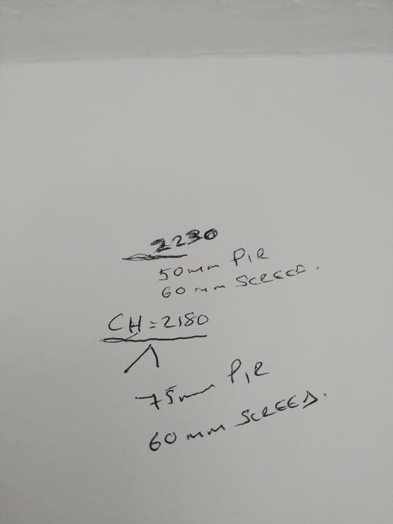

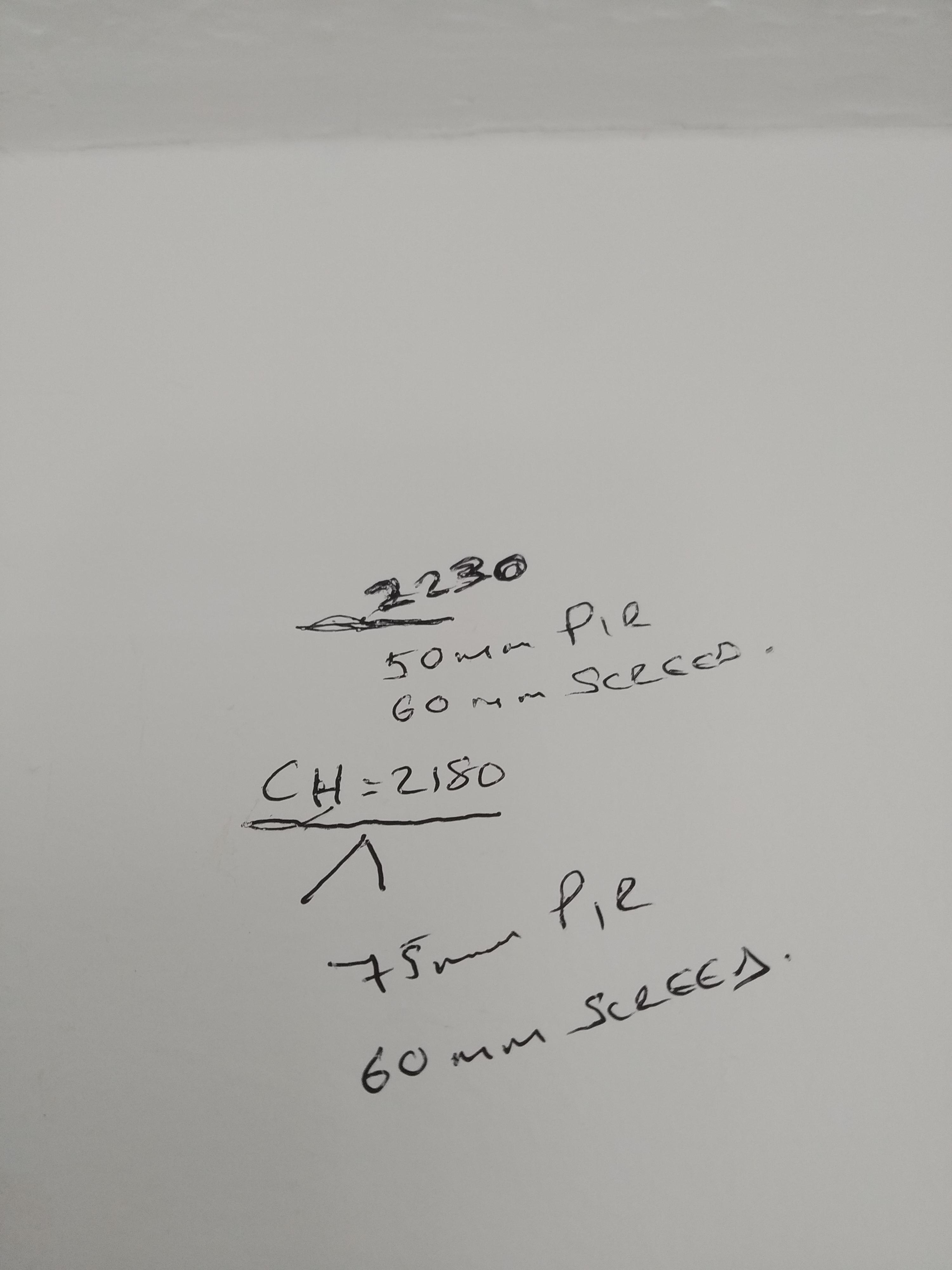

canalsiderenovation Posted March 16, 2020 Posted March 16, 2020 For our existing floor and wall space of our bungalow we have made it clear to our architect and builders we want to improve the insulation as we will have wet UFH fitted with our ASHP. We are lucky in that we have higher than normal ceiling space in our existing bungalow (though it varies as our current layout is a bit like two bungalows so one is different than the other) and we will need super flat flooring for the gluedown LVT. The builder was talking about 50mm or 75mm - anyone interpret these scribbles so I can get some idea of what he is talking about (still waiting for his quote yet) and which would be better? We will also have wall insulation added and our windows will be triple glazed.
PeterW Posted March 16, 2020 Posted March 16, 2020 That’s very thin. What is the proposed floor finish ..? You could go 100mm insulation with one of the thin UFH board systems like the one from Wunda at 22mm on top, so your less than the 135mm and substantially better heat retention with a smaller loss of heat store from a screed. 1
Temp Posted March 16, 2020 Posted March 16, 2020 +1 We have a mixture but in some rooms we have 80mm PIR insulation and about 60mm screed with UFH. Wish we had more insulation. Our favourite rooms have 21mm engineered oak flooring on battens with PIR between and no screed. The top layer of PIR has foiled covered grooves for the pipes that spread the heat. A system like that would allow a greater depth of insulation. 1
canalsiderenovation Posted March 16, 2020 Author Posted March 16, 2020 (edited) 42 minutes ago, PeterW said: That’s very thin. What is the proposed floor finish ..? You could go 100mm insulation with one of the thin UFH board systems like the one from Wunda at 22mm on top, so your less than the 135mm and substantially better heat retention with a smaller loss of heat store from a screed. I'm a bit ignorant. Note that these measurements are only in relation to insulating our existing. The extension is bigger than our existing so this will be in line with building regs (I never thought to clarify what this will be as I was more worried on our existing). Our existing is a concrete pad (bunglow built in late 70s). We are having a gluedown LVT if that's what you mean. Edited March 16, 2020 by canalsiderenovation
Ferdinand Posted March 16, 2020 Posted March 16, 2020 That's not enough imo. My downstairs has about 80mm PIR or so ( extensive extend and reno of a bungalow, done in 2008),and I would far prefer it to be 125 or 150mm, since the ufh struggles. Peter's idea is probably a good one. Ferdinand 1
canalsiderenovation Posted March 16, 2020 Author Posted March 16, 2020 13 minutes ago, Ferdinand said: That's not enough imo. My downstairs has about 80mm PIR or so ( extensive extend and reno of a bungalow, done in 2008),and I would far prefer it to be 125 or 150mm, since the ufh struggles. Peter's idea is probably a good one. Ferdinand Thanks @PeterW it will be something to take forward with the builder. Having had no heating for 5 months now being warm and low heating bills is a priority, I'm so nesh.
canalsiderenovation Posted March 16, 2020 Author Posted March 16, 2020 11 minutes ago, MikeGrahamT21 said: Can you dig out the existing concrete? Yes but due to cost we would prefer not to, especially as our ceiling height isn't an issue and all doors, skirting plaster etc being replaced....

canalsiderenovation Posted March 16, 2020 Author Posted March 16, 2020 1 hour ago, PeterW said: That’s very thin. What is the proposed floor finish ..? You could go 100mm insulation with one of the thin UFH board systems like the one from Wunda at 22mm on top, so your less than the 135mm and substantially better heat retention with a smaller loss of heat store from a screed. @PeterW can you post links of what you mean so I can get my head around it. I just want to understand it before I try and communicate to the builder what I mean.....

canalsiderenovation Posted March 16, 2020 Author Posted March 16, 2020 18 minutes ago, PeterW said: Have a look at this video for LVT These are the boards https://www.wundatrade.co.uk/product-category/home/overfloor-retro-fit-solutions/wundatherm-underfloor-heating-boards/ Thanks very much for this. A minimum of 100mm insulation is what I'm going to communicate to the builder/architects for the existing....
