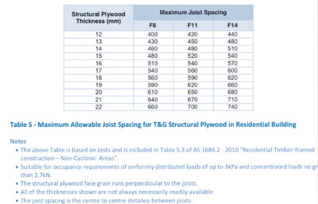

PeterW Posted November 21, 2016 Posted November 21, 2016 Ok - from the Australian building codes (useful for stuff like the actual strengths and spans of far eastern ply ....) then you get this : I would suggest that a normal person reading that would say you won't have an issue with 12mm ply (with 5 plies) but that would need an SE to confirm - just did the deflection calc and 12mm is the square root of naff all at normal domestic loading. If you were really worried then taking Nicks idea you could glue and screw thickening ribs down the middle of each panel / joist pair before you glued and screwed the panel to the joists.
ProDave Posted November 21, 2016 Author Posted November 21, 2016 On that basis I think I will go with 12mm ply, providing I can find some that has a decent surface finish.
