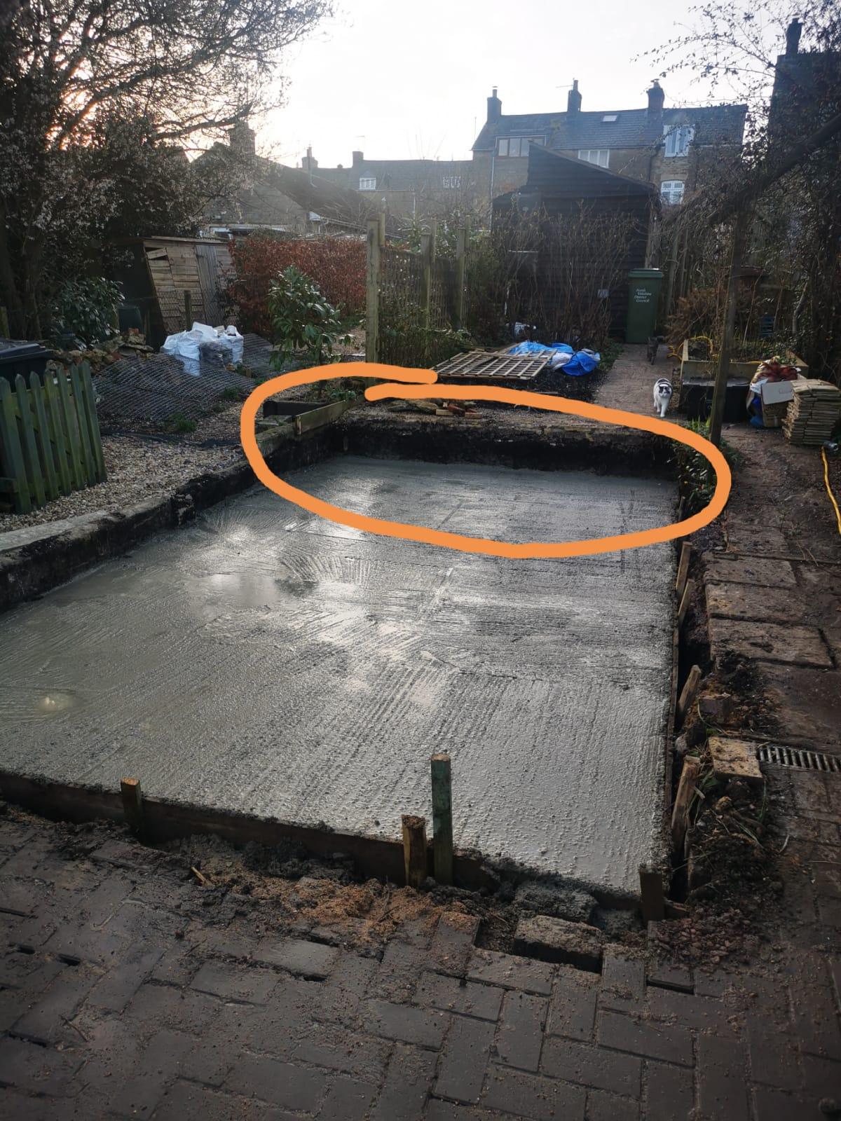

rpuddle Posted March 12, 2020 Share Posted March 12, 2020 I've just built a timber garage on my concrete base that was dug out of the soil at the bottom of our garden. The level of the garage is below the soil at the back end and water appears to be seeping through the soil, onto the concrete and into the back wall of the garage (I've circled the bank of soil on the image attached). I'm just wondering the best way to stop water coming through that far bank? Wall of bricks / concrete? Or is there a better way of doing this? Thanks Link to comment Share on other sites More sharing options...
Roundtuit Posted March 12, 2020 Share Posted March 12, 2020 Dig it out and put a French drain in? Link to comment Share on other sites More sharing options...
Onoff Posted March 12, 2020 Share Posted March 12, 2020 (edited) Probably you need to look at digging out behind and maybe the sides and making a French drain. If considered beforehand then perhaps waterproof concrete upstand off of the slab but it really needs to be homogenous or you're getting into water bar territory. Then there's membranes. You're getting into the realms of underground houses. Edited March 12, 2020 by Onoff Link to comment Share on other sites More sharing options...

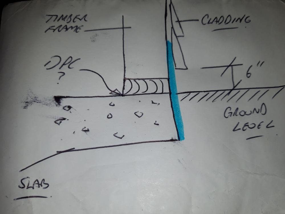

Onoff Posted March 12, 2020 Share Posted March 12, 2020 You might even need a continuous waterproof strip around 3 sides that sits 6" above ground level and projects down the sides of the main slab. Needless to say any cladding should be 6" above ground. Got any pictures? Link to comment Share on other sites More sharing options...
Ferdinand Posted March 13, 2020 Share Posted March 13, 2020 (edited) Yep - you need the garage to be above the ground, which means lowering the ground level immediately around the garage, or at least the part where the seep is occurring. TBH I would also be concerned about the two sides - though "lowering the level" may just be for say 20-30cm next to the wall, putting in some sort of channel, and maybe part filling with gravel. That is a variation on the French Drain option. Alternatively you tank it, which (put unkindly) is relying on a big waterproof plaster if done afterwards. Ferdinand Edited March 13, 2020 by Ferdinand Link to comment Share on other sites More sharing options...
scottishjohn Posted March 13, 2020 Share Posted March 13, 2020 (edited) I don,t see any easy way with the floor level below ground level --too late now but the slab should have been above ground level you could i suppose use blocks to jack up garage all round -then throw some plastic sheet in and just make your floor higher --that would be best solution -probably don,t even need to cement blocks if you going to fill with concrete--and don,t forget to put a run on floor to wards the doors If you work out the other proper soutions I think you will find what I suggest as alot cheaper than trying to tank or lay franch drains ,which need to connect to somethinbg lower -like main drains Edited March 13, 2020 by scottishjohn Link to comment Share on other sites More sharing options...

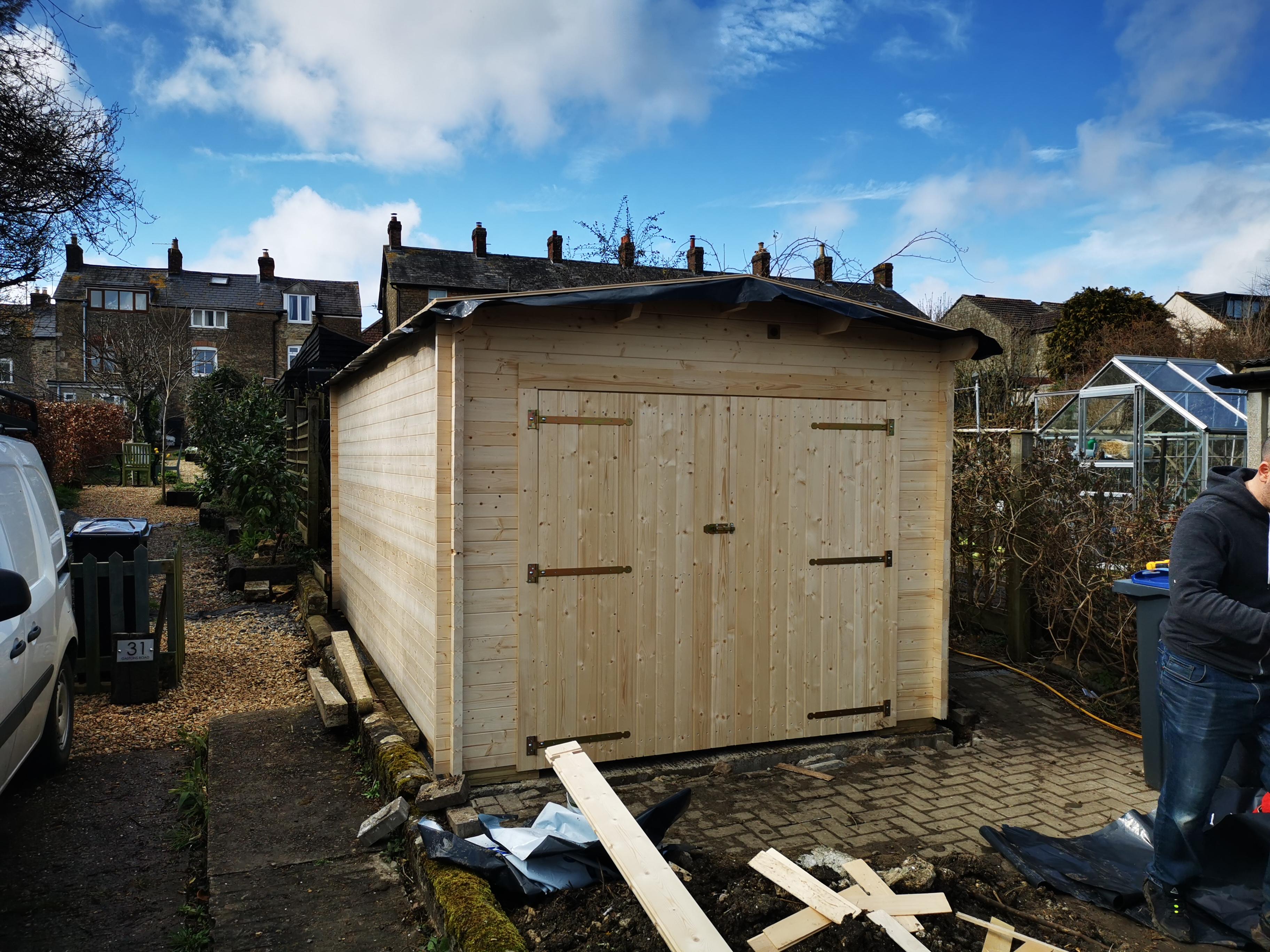

rpuddle Posted March 13, 2020 Author Share Posted March 13, 2020 There doesn't appear to be a DPM under the slab, although the builder told me there would be! Don't even ask about the story behind the slab, and it's finish..... On the left hand side (against the dividing wall) we've used a circular saw to cut away an area for the water to drain to and then run to the front of the garage, and the front and right hand side have gaps for the water to drain way, but the back has no such option. There is a DPM between the slab and the timber but the back of the garage there is not a lot of space (probably 35cm) so I'm not sure what my options are now. Don't think there is space to dig out the concrete at the back. May have to cut away the earth bank and push things further back from there? Link to comment Share on other sites More sharing options...
Carrerahill Posted March 13, 2020 Share Posted March 13, 2020 (edited) 12 hours ago, rpuddle said: I've just built a timber garage on my concrete base that was dug out of the soil at the bottom of our garden. The level of the garage is below the soil at the back end and water appears to be seeping through the soil, onto the concrete and into the back wall of the garage (I've circled the bank of soil on the image attached). I'm just wondering the best way to stop water coming through that far bank? Wall of bricks / concrete? Or is there a better way of doing this? Thanks You really need to lower the level of the ground at the back, simply that is the only real "long term" solution. A french drain will work but that requires dropping the level of the ground and back filling with washed gravel, which will still sit against the garage, so it's a sort of half solution really. If you don't want to drop the level then excavate down the back of the slab, pour a foundation with a seperation gap from the garage slab and build a small retaining wall, back-fill the high side with washed gravel then make up your ground level to the wall, leave a gap down the back of the garage. This will keep the water back and leave a nice ventilation gap so the timber can breath. Ideally this section would have been built in block/poured concrete and waterproofed. Edited March 13, 2020 by Carrerahill Spelling 1 Link to comment Share on other sites More sharing options...
epsilonGreedy Posted March 13, 2020 Share Posted March 13, 2020 The OP needs to either fight gravity or use gravity. In my experience rainfall prefers to wriggle horizontally over the surface of the ground by following a gradient. To solve the garage problem I would dig a drainage trench around the external perimeter of the garage and then channel the water off somewhere. Water will find its way through any untanked masonry defences. Link to comment Share on other sites More sharing options...

Onoff Posted March 13, 2020 Share Posted March 13, 2020 (edited) How is the garage clad? If say horizontal boards you could drop in a 3 sided edpm or similar waterproof membrane. Btw, if your slab has no dpm is the timber frame sat straight on the potentially damp concrete or is there a dpc under the sole plate? Depends to some extent how free draining the ground is... Edited March 13, 2020 by Onoff Link to comment Share on other sites More sharing options...

rpuddle Posted March 13, 2020 Author Share Posted March 13, 2020 Wouldn't say pissing in. I'd say seeping at the moment! Either way, the whole thing has been a botch job, but time was against us as I had to get the thing built as the garage I rent was being emptied! It was a case of build now, worry later. Not the greatest moto but I'm working with it! I think it's time to get the hammer and chisel and start creating a runoff at the back of the slab.... Link to comment Share on other sites More sharing options...
