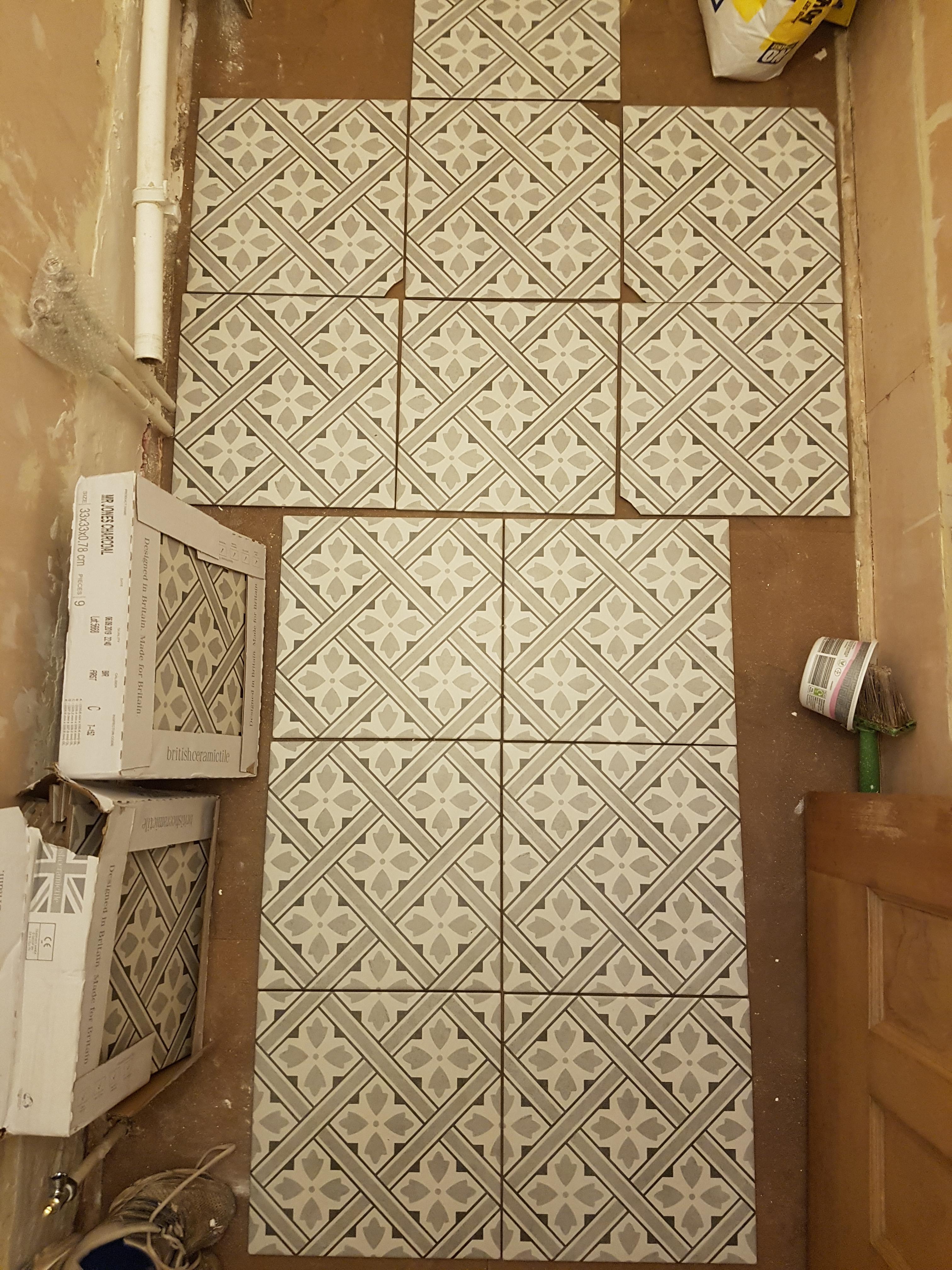

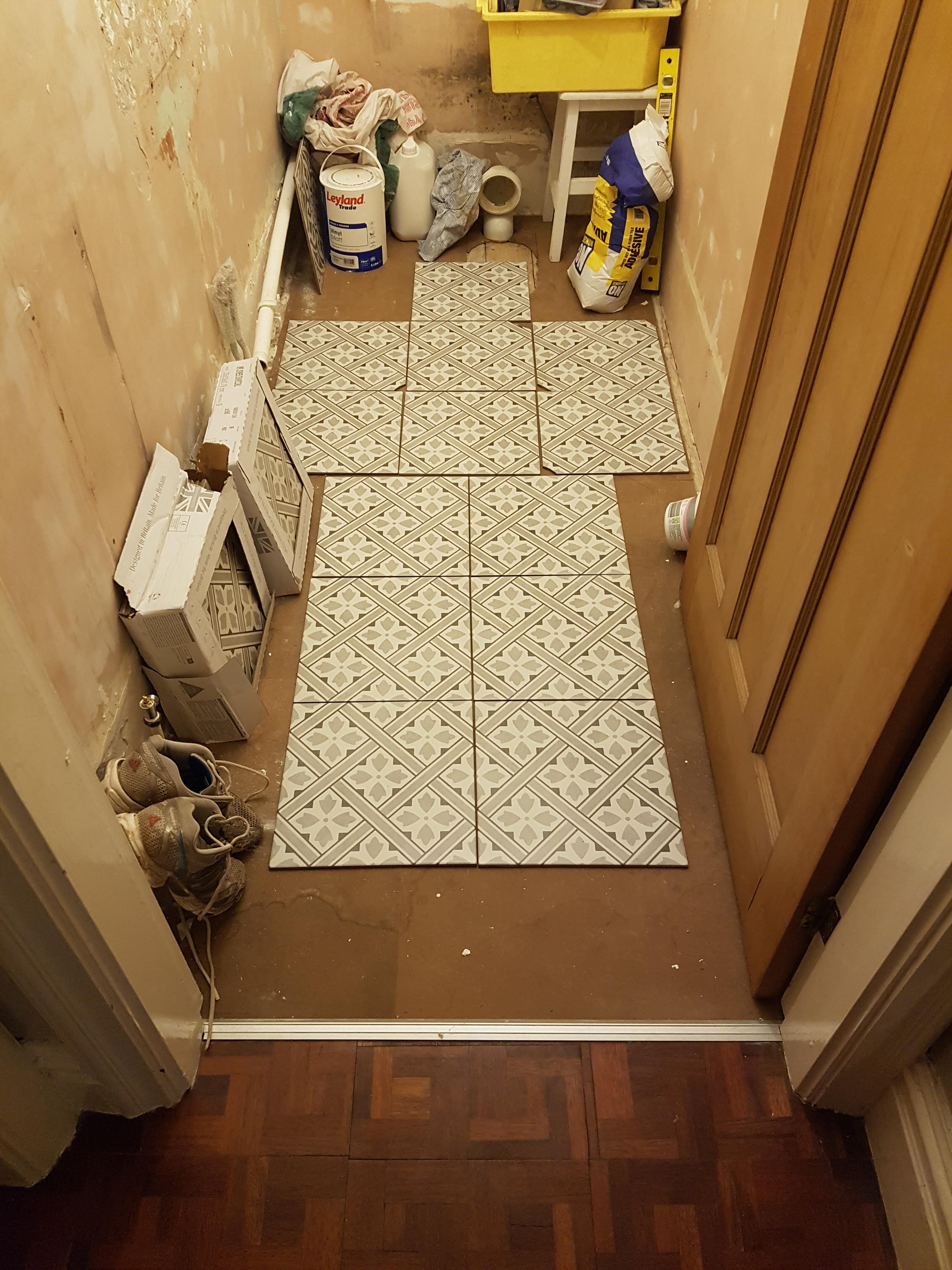

Moonshine Posted March 11, 2020 Share Posted March 11, 2020 (edited) About to lay tiles in a narrow WC, and not sure about the layout. One has center line in the middle other has a whole tile, as below I have a preference, but interested in others thoughts. Not helped as the WC is slightly off center Edited March 11, 2020 by Moonshine Link to comment Share on other sites More sharing options...
Big Jimbo Posted March 11, 2020 Share Posted March 11, 2020 Near the door end for me. Either that or diamond Link to comment Share on other sites More sharing options...
Simplysimon Posted March 11, 2020 Share Posted March 11, 2020 would say it needs to be centre line due to width and cuts, diamond or staggered due to pan may help Link to comment Share on other sites More sharing options...
Moonshine Posted March 12, 2020 Author Share Posted March 12, 2020 12 hours ago, Big Jimbo said: Either that or diamond We tried the diamond and it didn't look quiet right, almost making the room seem narrower. The centre line in the middle of the room was my preference, with larger cut tiles to the sides, rather than the narrow strips or tile near the wall. Link to comment Share on other sites More sharing options...
Ferdinand Posted March 12, 2020 Share Posted March 12, 2020 (edited) Diamond would be negated imo by the diamond pattern already on the tiles. Extra work for nowt. The smaller diamond pattern makes it look like smaller tiles laid straight. I would go with the line down the middle because this has no risk of a need to cut slivers at the skirting - which would look messy. Is it feasible to offset the loo to the centre line using a flexi connection? But you will need to watch the tiler(s), or you will come back to find them playing hopscotch ?. Edited March 12, 2020 by Ferdinand Link to comment Share on other sites More sharing options...
ProDave Posted March 12, 2020 Share Posted March 12, 2020 Down the centre is very wasteful. EVERY edge tile will be just a bit over half a tile leaving you an offcut just a bit under half a tile, with nowhere to use it. Centred on the WC would be much more efficient. Just a sliver cut off the right hand side (and with luck enough to reach into the door recess) and the other side will need less than half a tile so each full tile will do 2 cuts. That side looks like it has the basin anyway, so centred on the WC puts it pretty much centred on the walkway. Link to comment Share on other sites More sharing options...
joe90 Posted March 12, 2020 Share Posted March 12, 2020 Like @Big Jimbo fir me, nearest the door even with the wastage. (The off centre toilet would annoy me and my OCD). Link to comment Share on other sites More sharing options...

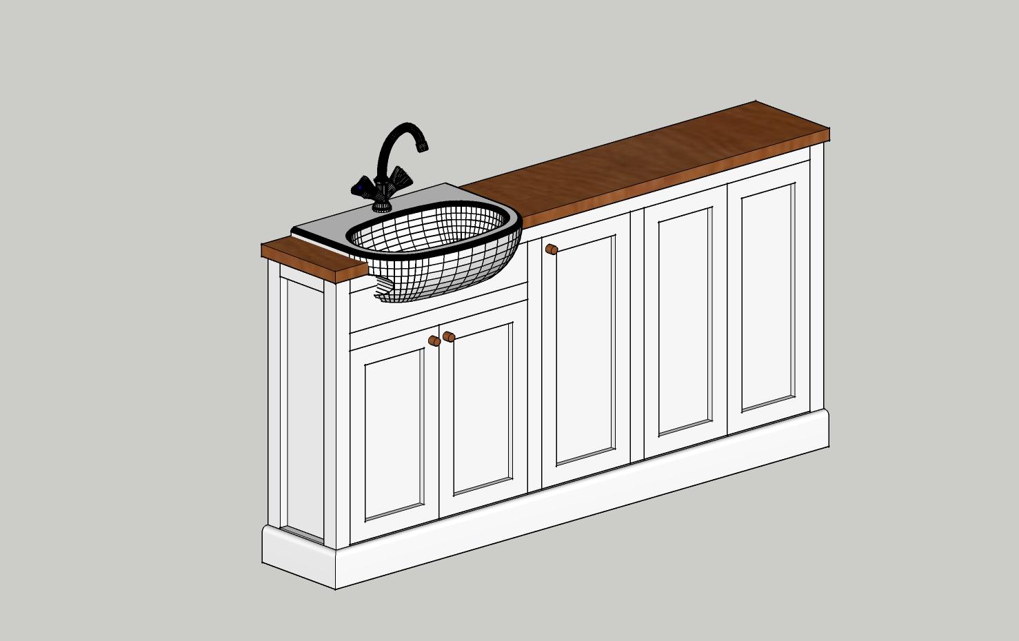

Moonshine Posted March 12, 2020 Author Share Posted March 12, 2020 5 minutes ago, joe90 said: The off centre toilet would annoy me and my OCD). It does me, and there is an off centre window above it. However hopefully mitigated by a thin cabinet (20cm) with integrated sink, going up the left hand side, as below; 1 Link to comment Share on other sites More sharing options...
Ferdinand Posted March 12, 2020 Share Posted March 12, 2020 22 minutes ago, ProDave said: Down the centre is very wasteful. EVERY edge tile will be just a bit over half a tile leaving you an offcut just a bit under half a tile, with nowhere to use it. He already has the tiles by the look of it, so there are enough for both methods (?) Link to comment Share on other sites More sharing options...

ProDave Posted March 12, 2020 Share Posted March 12, 2020 2 hours ago, Moonshine said: It does me, and there is an off centre window above it. However hopefully mitigated by a thin cabinet (20cm) with integrated sink, going up the left hand side, as below; That's new information. I would say centred on the visible floor after accounting for what is covered by the unit, and accept at either end it might look odd. Then try and centre the toilet also on that bit of visible flooring, No I won't suggest also moving the off centre window. Link to comment Share on other sites More sharing options...

Simplysimon Posted March 12, 2020 Share Posted March 12, 2020 as i said, staggered by half a tile then no straight joint lines Link to comment Share on other sites More sharing options...

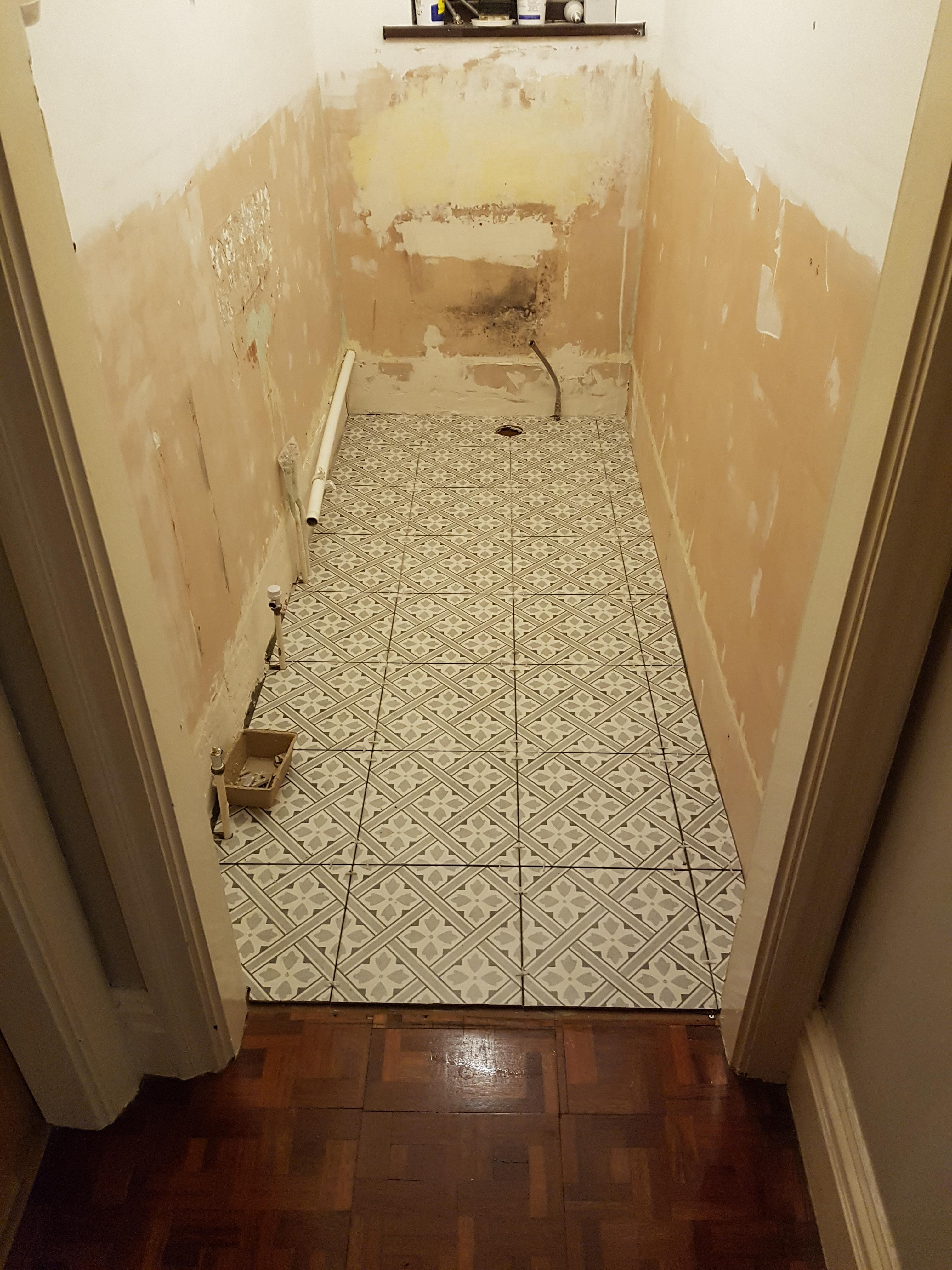

Moonshine Posted March 13, 2020 Author Share Posted March 13, 2020 On 12/03/2020 at 09:20, ProDave said: Down the centre is very wasteful. EVERY edge tile will be just a bit over half a tile leaving you an offcut just a bit under half a tile, with nowhere to use it. Centred on the WC would be much more efficient. Just a sliver cut off the right hand side (and with luck enough to reach into the door recess) and the other side will need less than half a tile so each full tile will do 2 cuts. That side looks like it has the basin anyway, so centred on the WC puts it pretty much centred on the walkway. I ended up doing as you mentioned 4 Link to comment Share on other sites More sharing options...
ProDave Posted March 14, 2020 Share Posted March 14, 2020 That looks good. It will be interesting to see it when finished with the sink unit in place. Link to comment Share on other sites More sharing options...

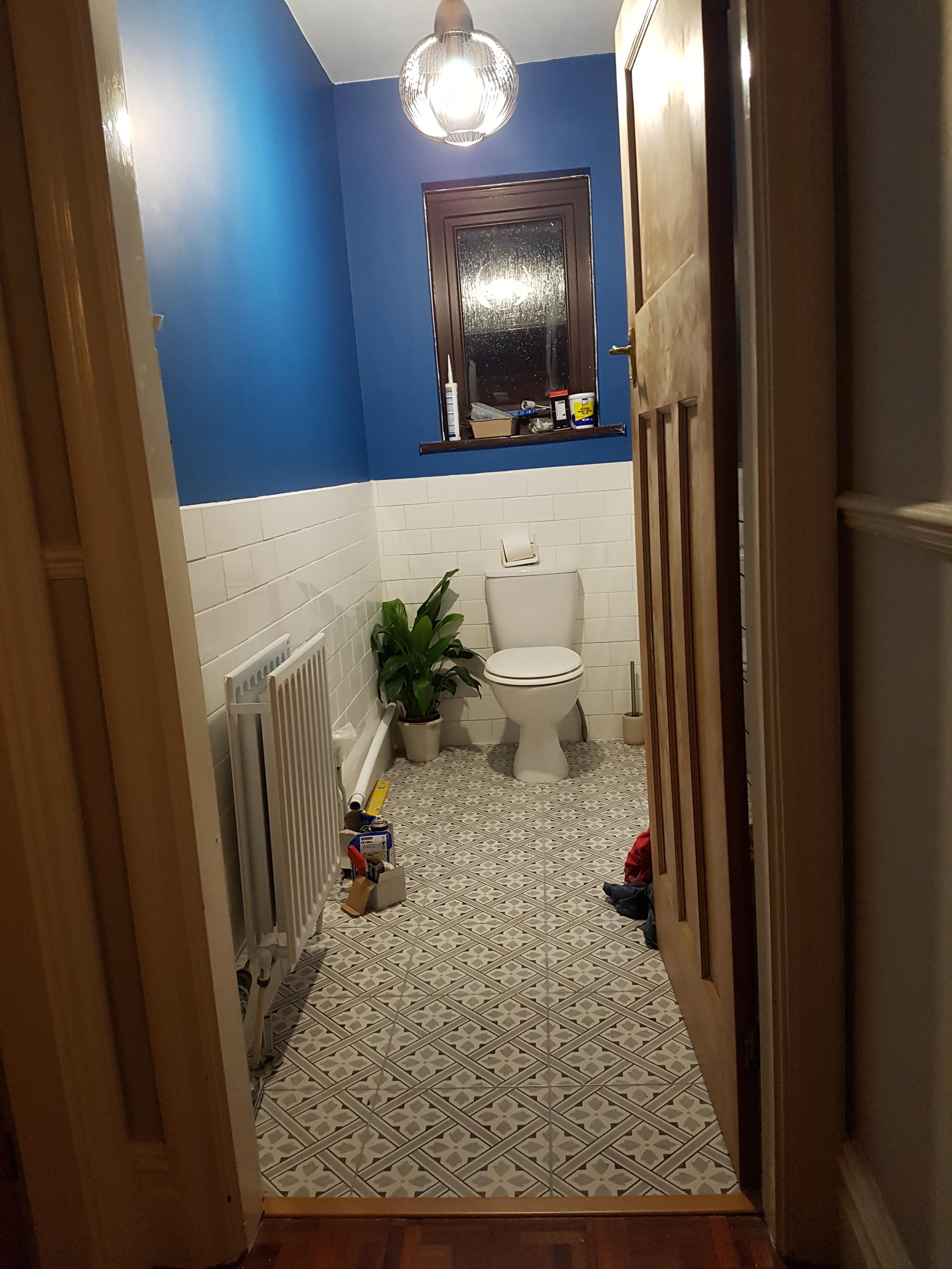

Moonshine Posted March 24, 2020 Author Share Posted March 24, 2020 On 14/03/2020 at 09:05, ProDave said: That looks good. It will be interesting to see it when finished with the sink unit in place. No unit in yet (I need to build it), but the rest is pretty much there. 3 Link to comment Share on other sites More sharing options...

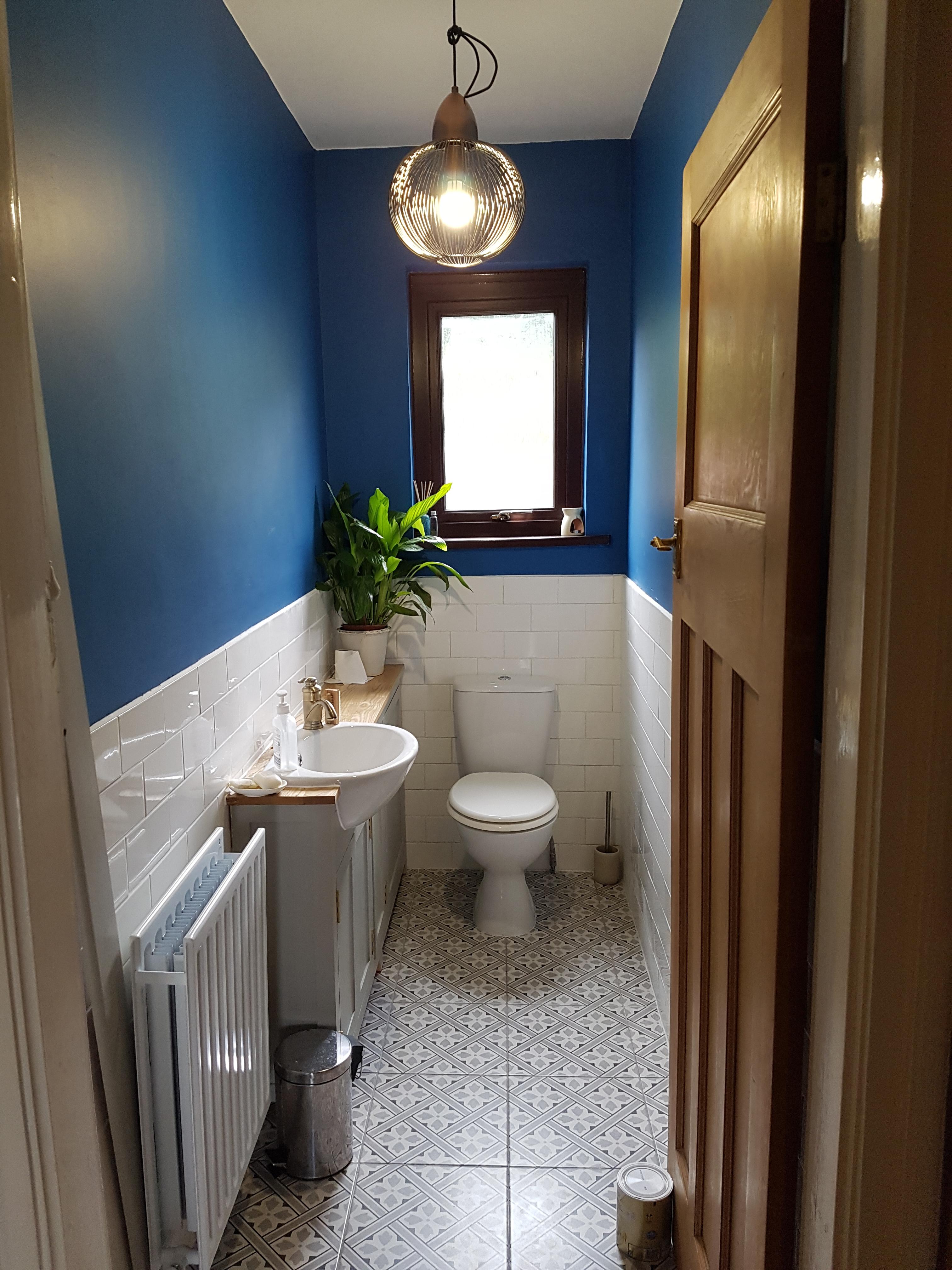

Moonshine Posted June 28, 2020 Author Share Posted June 28, 2020 Home made cabinet now in with only a mirror and a couple of other small jobs to do. This job dragged on and on! 1 Link to comment Share on other sites More sharing options...
Onoff Posted June 28, 2020 Share Posted June 28, 2020 31 minutes ago, Moonshine said: small jobs to do The right place to do them... Link to comment Share on other sites More sharing options...
