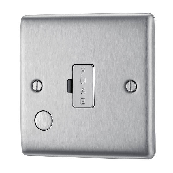

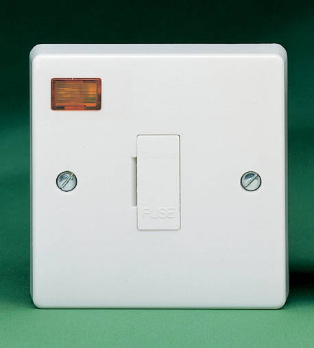

Jeremy Harris Posted March 8, 2020 Posted March 8, 2020 3 minutes ago, pocster said: But a FCU has a switch ; assume that’s not allowed in a bathroom ??? - or have I got it wrong ? No, you can get non-switched FCUs, with a flex outlet (it's hidden under the lower edge in this photo): That one has an indicator, handy for a heater as you can see when it's on. 1
Pocster Posted March 8, 2020 Author Posted March 8, 2020 4 minutes ago, Jeremy Harris said: No, you can get non-switched FCUs, with a flex outlet (it's hidden under the lower edge in this photo): That one has an indicator, handy for a heater as you can see when it's on. Ok ! I’m confused ! - dumb question for sure but how does the towel rail cable get into that ?
Jeremy Harris Posted March 8, 2020 Posted March 8, 2020 2 minutes ago, pocster said: Ok ! I’m confused ! - dumb question for sure but how does the towel rail cable get into that ? There's a flex outlet under the lower edge, usually with a small plastic blanking plug that needs to be removed to feed the cable out, plus there is a cable grip at the rear to secure the flex. Here's a link to the full description: https://www.tlc-direct.co.uk/Products/CB4828slash3.html 1
Pocster Posted March 8, 2020 Author Posted March 8, 2020 6 minutes ago, Jeremy Harris said: There's a flex outlet under the lower edge, usually with a small plastic blanking plug that needs to be removed to feed the cable out, plus there is a cable grip at the rear to secure the flex. Here's a link to the full description: https://www.tlc-direct.co.uk/Products/CB4828slash3.html Ahhhhh ! Are all non switched FCU’s like that ?
Jeremy Harris Posted March 8, 2020 Posted March 8, 2020 2 minutes ago, pocster said: Ahhhhh ! Are all non switched FCU’s like that ? Some are, and some aren't. You need to pick one that specifically mentions that it has a flex outlet. I prefer the ones that have this flex outlet at the bottom edge, but you can get them with the flex outlet coming out the front, like this one: 1

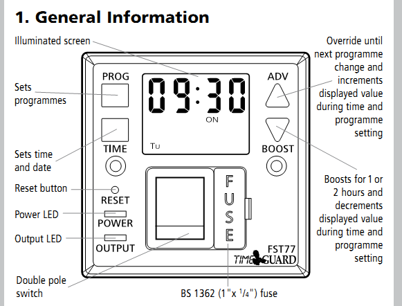

ToughButterCup Posted March 9, 2020 Posted March 9, 2020 Thanks @PeterStarck Tell me is the display on the Supply Master Fused Spur Time Switch (called Easy View in the advert) back-lit? I find it incredibly difficult to see some of those small LCD displays when there's not much ambient light. Need a ...?

Jeremy Harris Posted March 9, 2020 Posted March 9, 2020 57 minutes ago, AnonymousBosch said: Thanks @PeterStarck Tell me is the display on the Supply Master Fused Spur Time Switch (called Easy View in the advert) back-lit? I find it incredibly difficult to see some of those small LCD displays when there's not much ambient light. Need a ...? Yes it is, according to the manual: 1

Gone West Posted March 9, 2020 Posted March 9, 2020 3 hours ago, AnonymousBosch said: Thanks @PeterStarck Tell me is the display on the Supply Master Fused Spur Time Switch (called Easy View in the advert) back-lit? I find it incredibly difficult to see some of those small LCD displays when there's not much ambient light. Need a ...? This is mine in a well lit room without flash. Mine are a few years old now. 2
