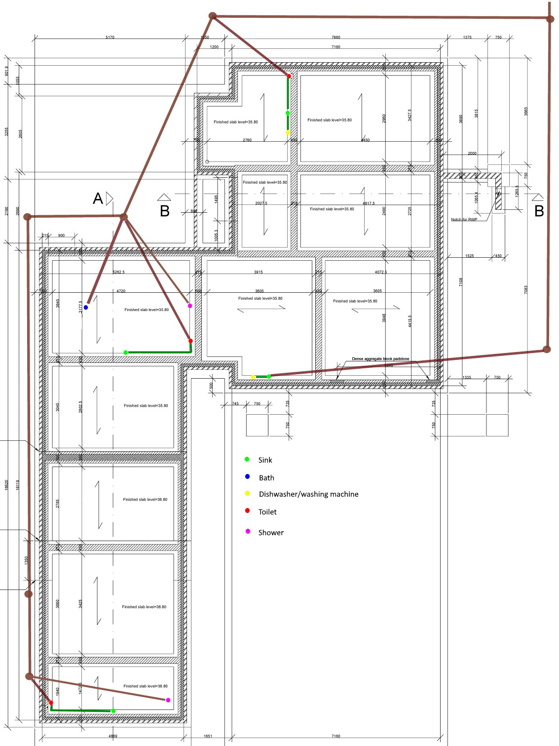

andy Posted March 25, 2020 Posted March 25, 2020 Finally we've escaped the rain and mud and have a semblence of a house... I am having a "discussion" with BCO about AAV. They are insisting that I have to have a penetration through the zinc roof for the furthest connection from the mains sewer and an AAV is not acceptable unless my structural engineer (eh?) can mitigate the yellow hightlighted: 1.33 Ventilated discharge stacks may be terminated inside a building when fitted with air admittance valves complying with BS EN 12380:2002. Where these valves are used they should not adversely affect the amount of ventilation necessary for the below' ground system which is normally provided by open stacks of the sanitary pipework. Air admittance valves should be located in areas which have adequate ventilation, should be accessible for maintenance and should be removable to give access for clearance of blockages. Air admittance valves should not be used outside buildings or in dust laden atmospheres. Where there is no open ventilation on a drainage system or through connected drains, alternative arrangements to relieve positive pressures should be considered. Any thoughts...? I'd rather have an AAV no no daft cold bridge/cowl on my zinc roof but not sure how to convince them... foul water is like this with the only air admitance we're talking abotu needing being bottom left corner - no redesigning the foul runs now please or I'll cry

andy Posted March 25, 2020 Posted March 25, 2020 I just need a way to calculate the "amount of ventilation" somehow - anyone have any ideas? I am happy to have a couple of AAV - one bottom left, one in attic just below the "B" in the image above but need to justify with some numbers.
Mike Posted March 25, 2020 Posted March 25, 2020 5 hours ago, andy said: I just need a way to calculate the "amount of ventilation" somehow - anyone have any ideas? Their use of 'amount of ventilation' doesn't relate to a specific volume, IMHO. The regs require a vent pipe at or near the end of the drain run to allow potentially explosive gasses to be vented out of the sewer. An AAV does the opposite, allowing air to flow in if there is a negative pressure, to preserve the seal in waste traps. As Peter suggests, a separate external open-vented stack is the likely solution. That could run up the outside of the house, but a short stack in a nearby hedge would probably be ideal.

andy Posted March 27, 2020 Posted March 27, 2020 On 25/03/2020 at 16:53, joe90 said: I have an AAV within the house but an external vent stack on my garage (furthest toilet) on your diagram can you not put a stack on the bottom left external drain which is the furthest point and no cold bridge. Hi I could do but the path down the side is quite narrow so would be a bit in the way. Options I have as I see it: Somehow get agreement I can have 1 or 2 AAV internally Put an external vent on the bottom left either going straight up through the roof or dogleg out through the gable wall at the bottom of the picture - we have a decent overhang of the verge there, so it can either terminate under the verge (no opening windows anywhere nearby) or even go through verge and zinc roof there if I had to. It would be great if I can quantify the vent requirement to prove 2 AAV will suffice I guess

andy Posted March 27, 2020 Posted March 27, 2020 I have been told we can go down to 75mm instead of 110mm (not sure if 75mm exists as a valid pipe size tbh!) and think under the eaves is OK, which at least stops me needing to go through the zinc which might be the easiest fall-back if I really can't do AAV... I hate the inconsistency of building control!
andy Posted March 27, 2020 Posted March 27, 2020 2 minutes ago, joe90 said: My internal AAV Is 50mm !,! See what I mean...
