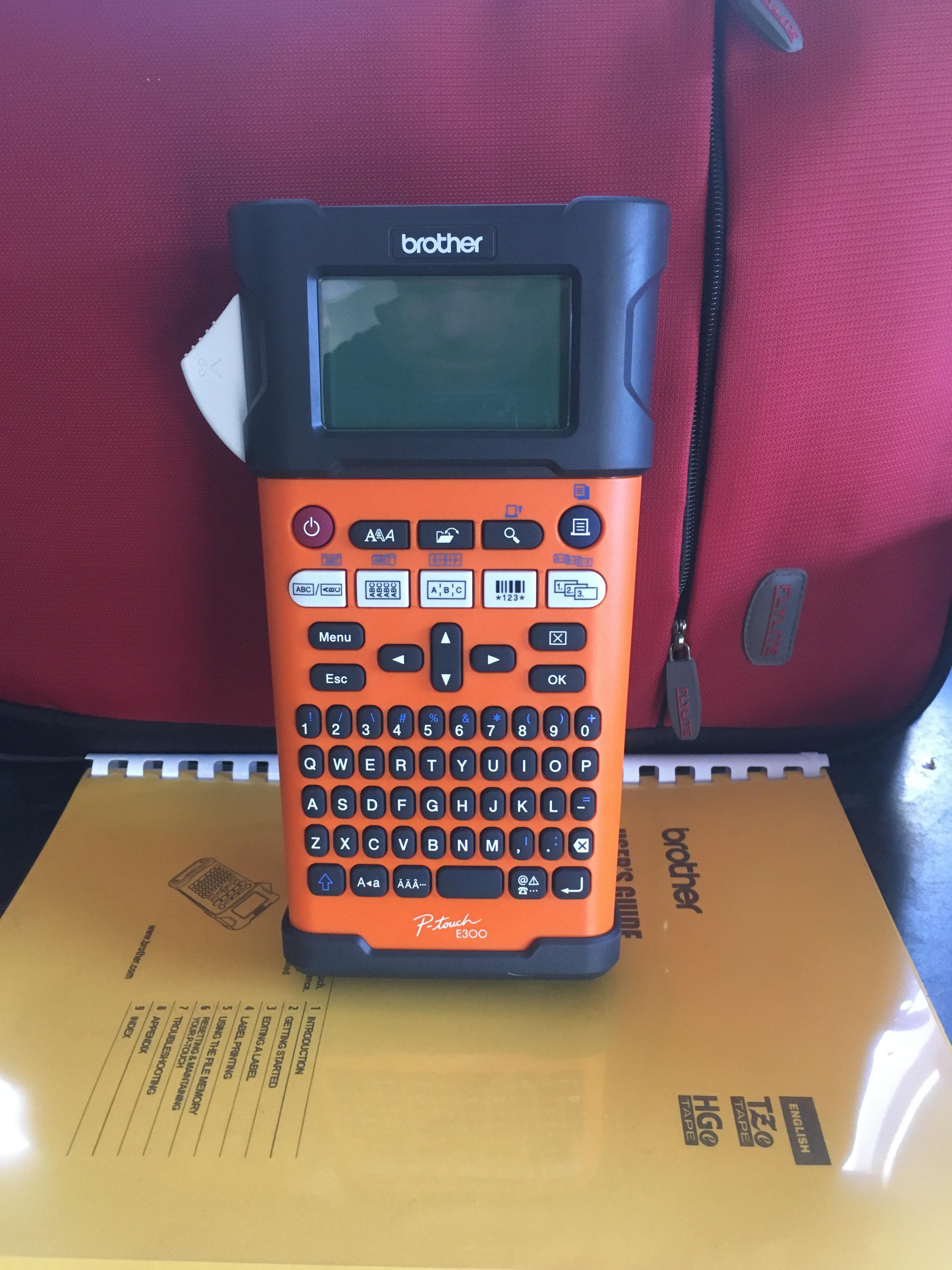

Russell griffiths Posted February 24, 2020 Posted February 24, 2020 So I’ve just been given a brand new E300 label maker thingy anybody used one, got any tips for ease of use, or do I do myself a favour and chuck it in the garage as it will be one less thing to annoy me.
ToughButterCup Posted February 24, 2020 Posted February 24, 2020 Oooooo, thats posh. I bought the cheapest one - and cant live without it. I would be a raving looney if our circuits weren't labelled. See if you can go for the absolute minimum , something like switch on (top left) type the label print (top right) cut (left hand white thing). Thats all I do with ours. If you want to throw it, tell me and I'll send you my address 1

Russell griffiths Posted February 24, 2020 Author Posted February 24, 2020 Does this stick well to pvc cables. Or do I need a specific one for cables.
Bitpipe Posted February 24, 2020 Posted February 24, 2020 7 minutes ago, Russell griffiths said: Does this stick well to pvc cables. Or do I need a specific one for cables. What worked well for me was to print a longer than required tag (using spaces), loop round cable and stick it back on itself.
Jeremy Harris Posted February 24, 2020 Posted February 24, 2020 If it's like my cheapo Brother it may well have a cable label option (there's an icon with "ABC" and a loop) that does this automatically.
Russell griffiths Posted February 24, 2020 Author Posted February 24, 2020 Thanks all I will charge it up and have a play.
Miek Posted February 25, 2020 Posted February 25, 2020 18 hours ago, Russell griffiths said: Does this stick well to pvc cables. Or do I need a specific one for cables. You can choose cable 'wrap format' then enter the cable diameter and print, this works well for round cables. Or you can choose 'flag' format an it will print a long strip which wraps around the cable but leaves a long bit with the printing on. You can buy heat shrink tube print medium but it's very expensive for what it is. Just a note on cartridges, as with all printers the cost is in the ink. Cheap clone cartidges work well but the glue is not so good I've found, especially if doing cable wrap, but it's a third the price. I use clone eBay cartridges myself as I can't stomach the brother prices. 1
