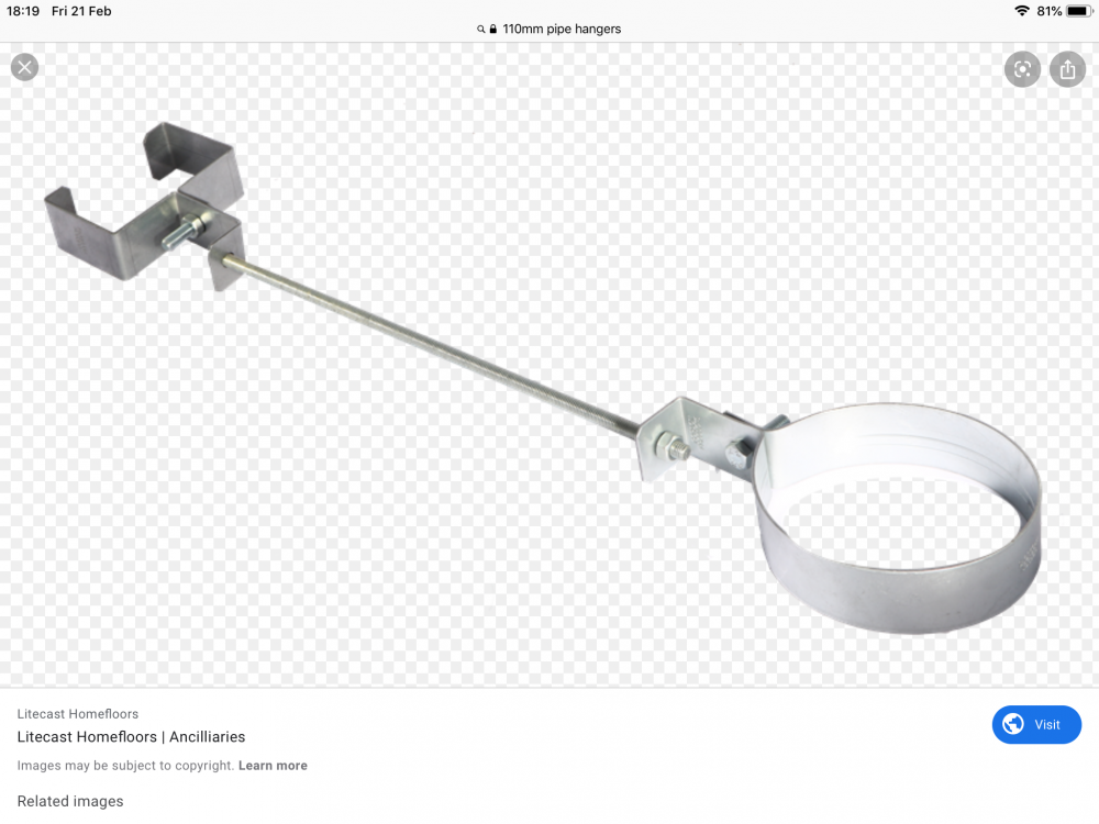

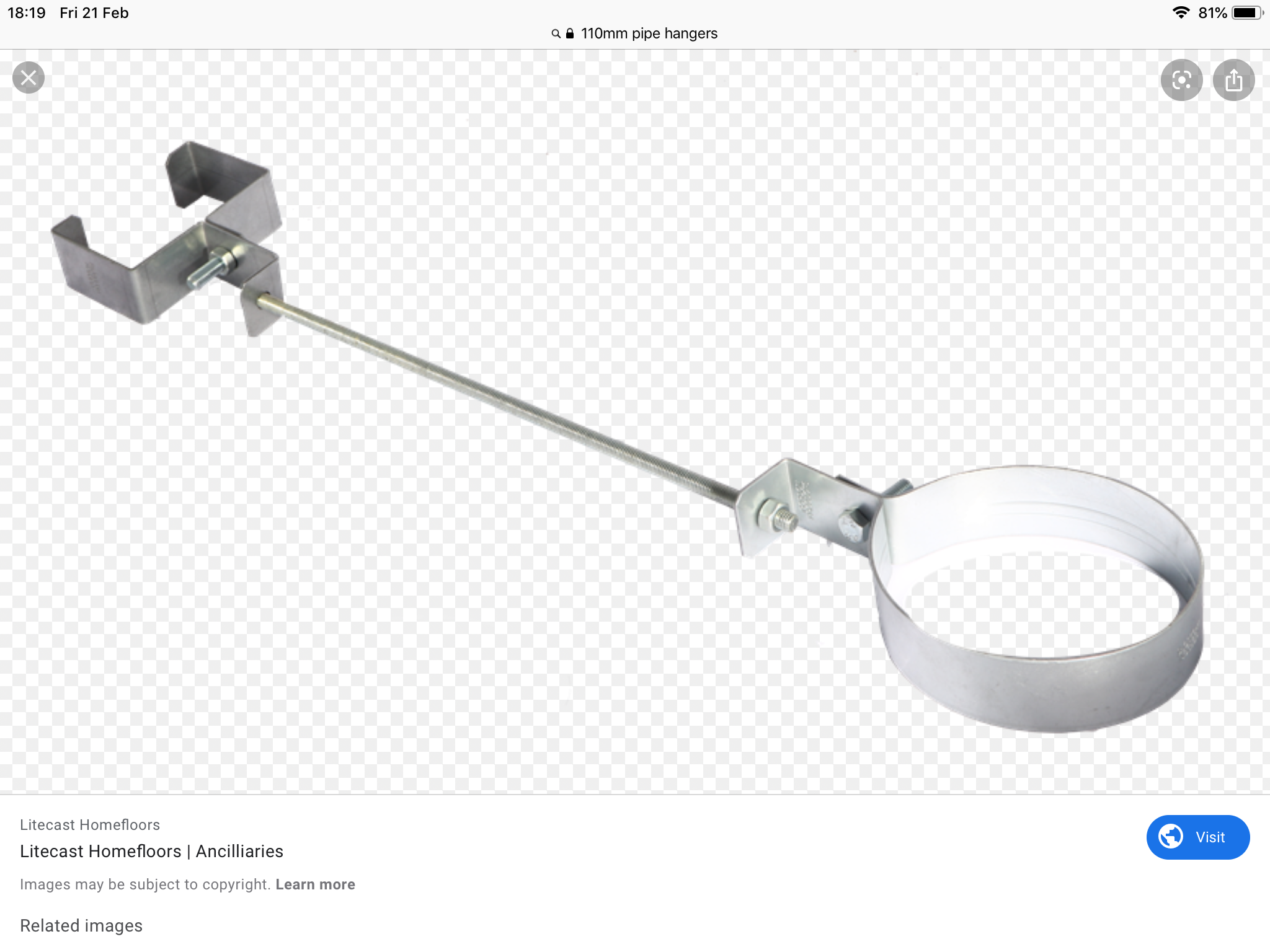

Pocster Posted February 24, 2020 Author Posted February 24, 2020 On 21/02/2020 at 18:20, Russell griffiths said: Here you go geezer. No good Will only supply if used with their own beams which apparently are different. Guess I’ll have to make my own

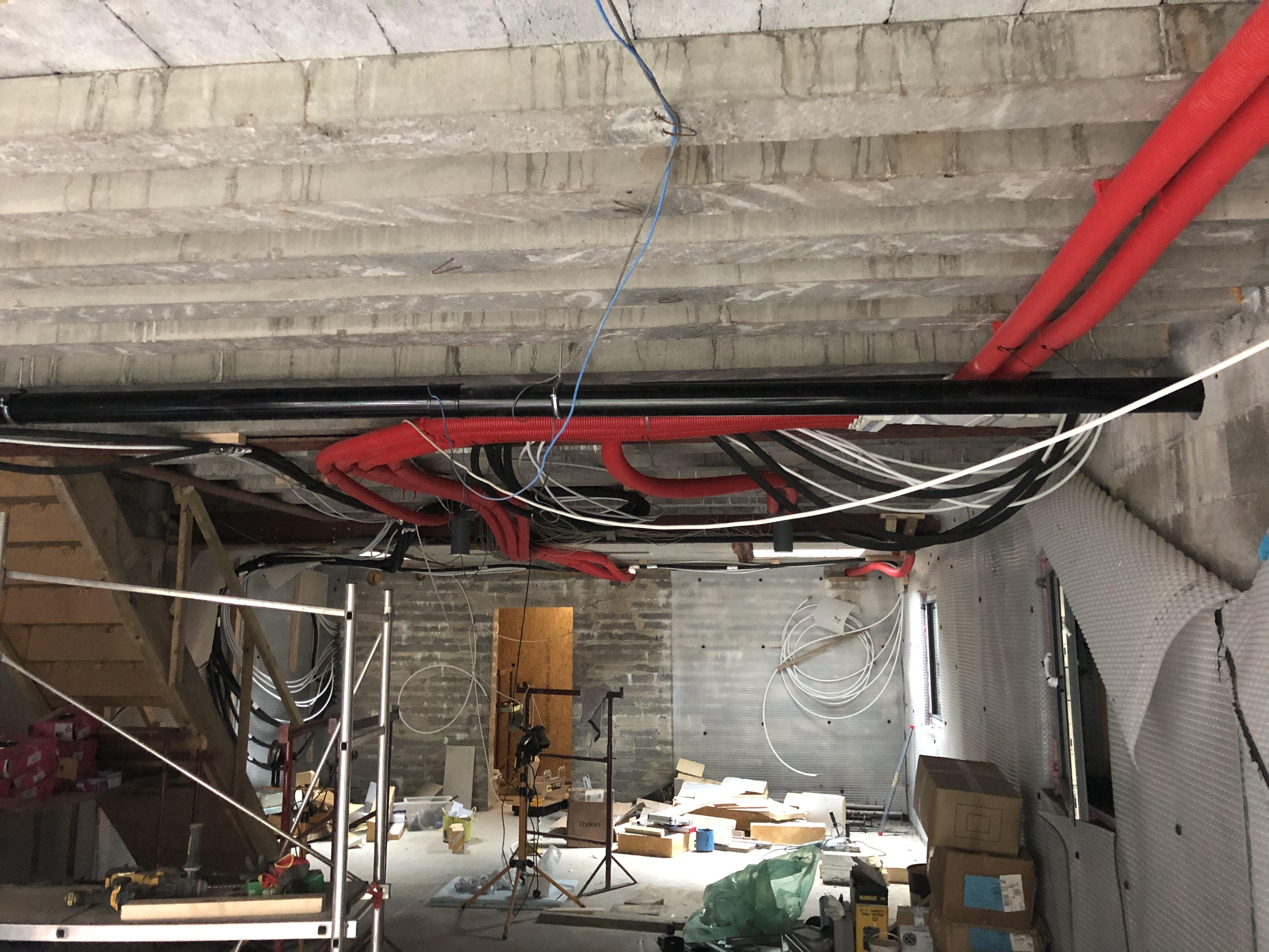

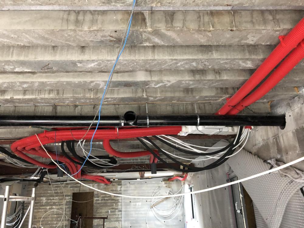

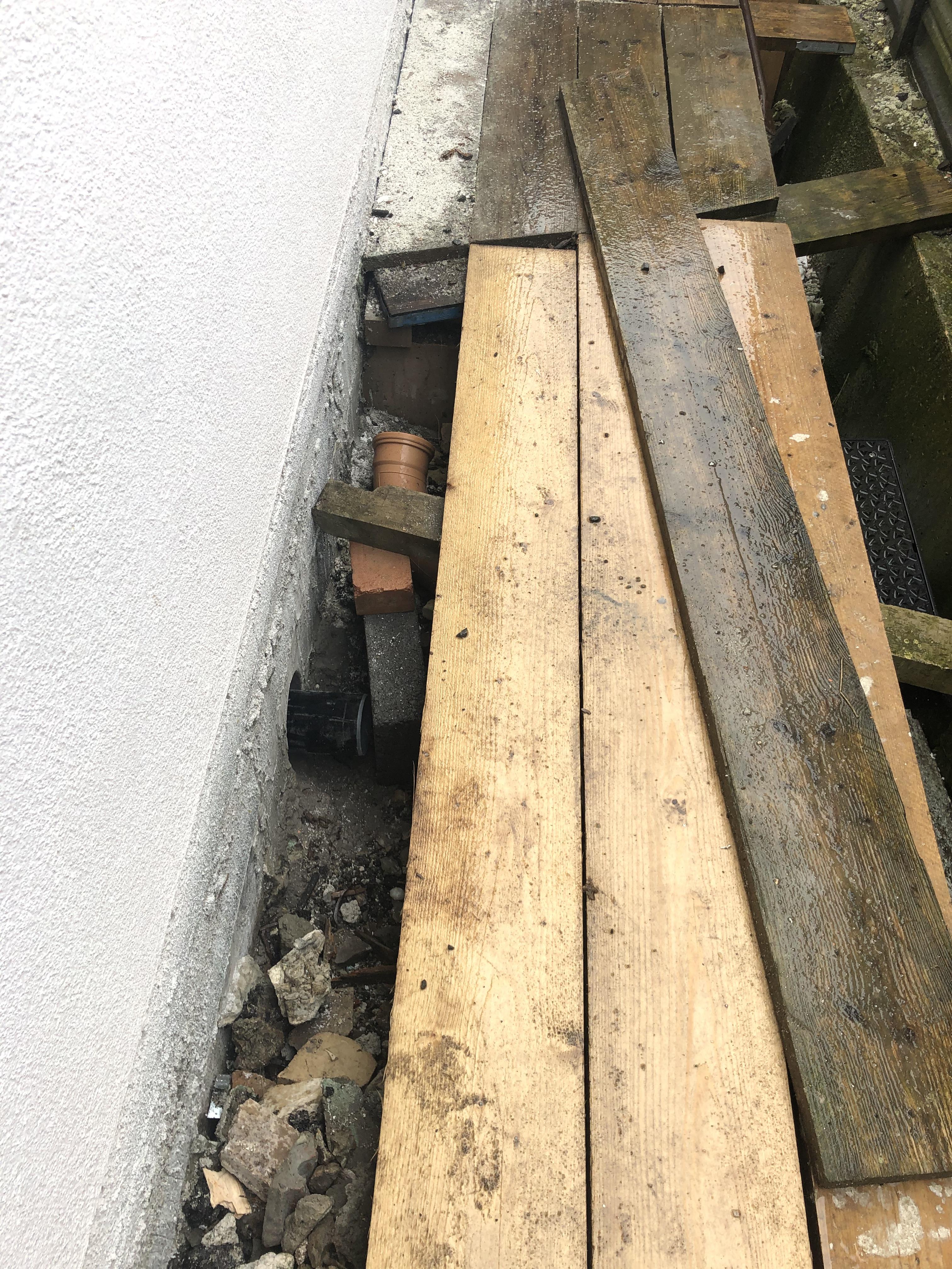

Pocster Posted March 4, 2020 Author Posted March 4, 2020 Preliminary test of theory ? Drain through to outside ; got to adjust the clamp length and add a few more . Aiming for 10mm fall per metre ... 1

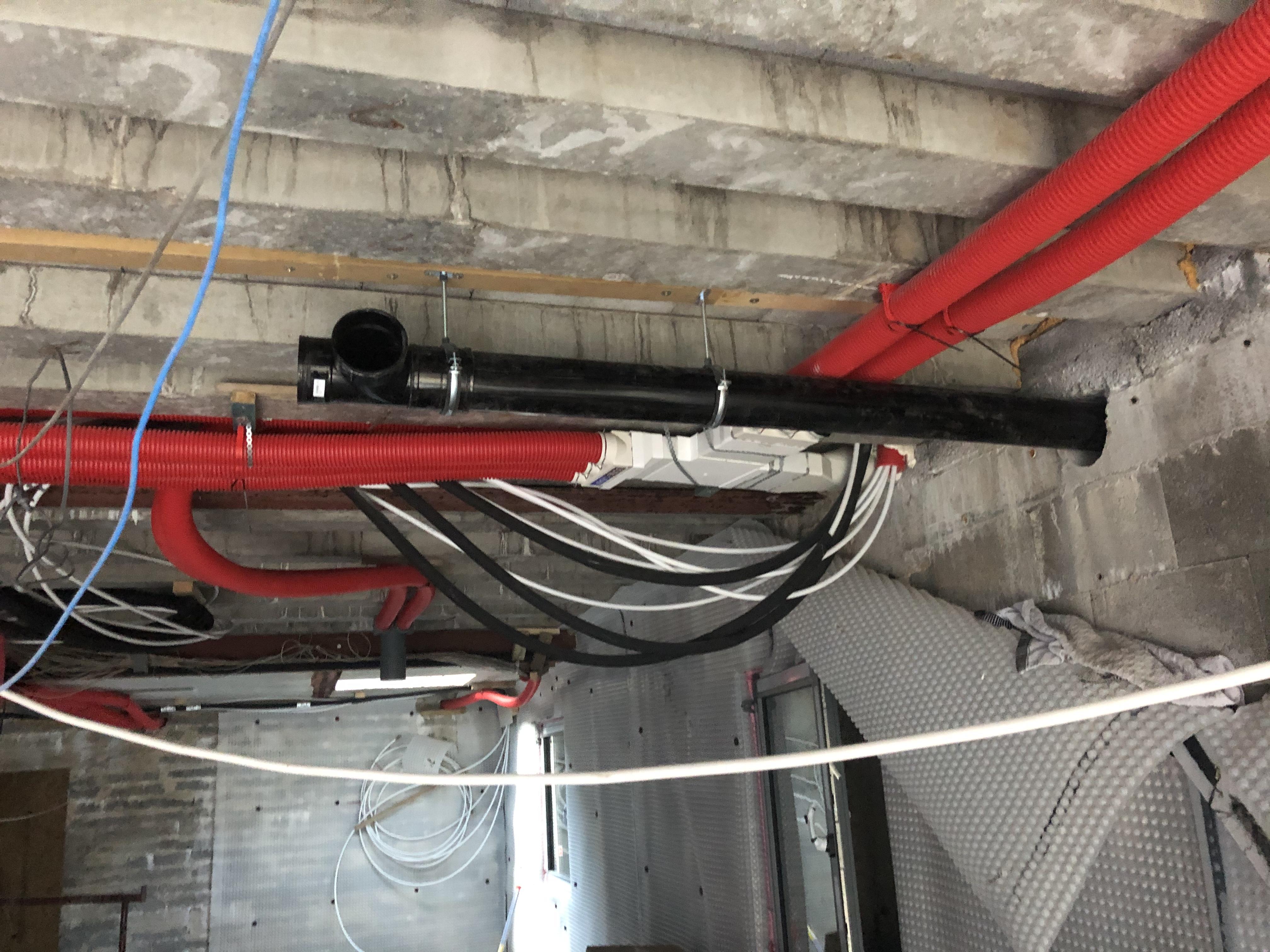

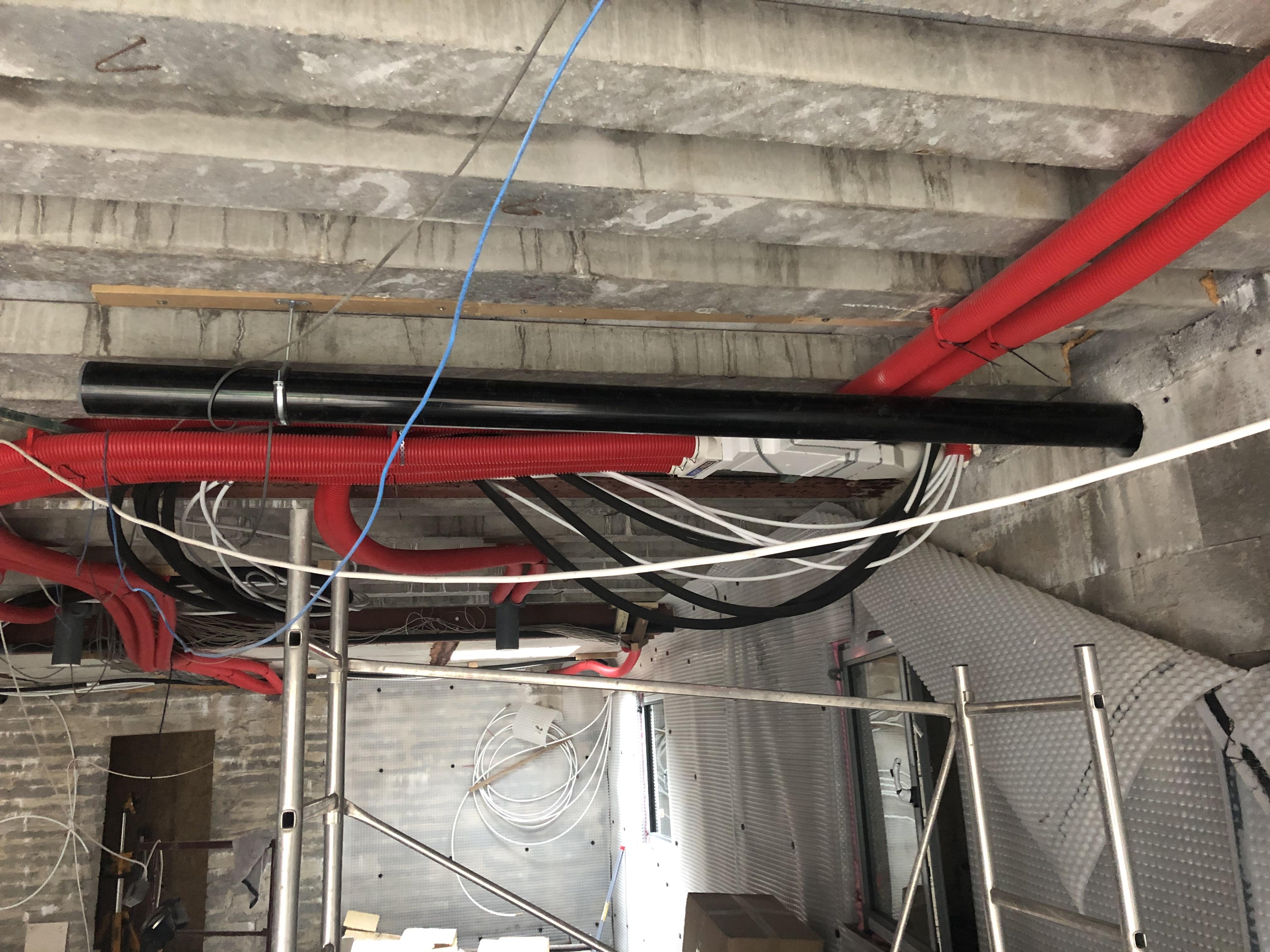

Pocster Posted March 4, 2020 Author Posted March 4, 2020 Well ! After much faffing ! Measuring off the floor blocks above ; difference between each end is around 20mm . Doesn’t look like much of a fall !!! Should I make it steeper ? Appreciate from the photo you can’t tell ??

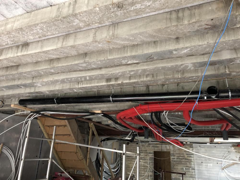

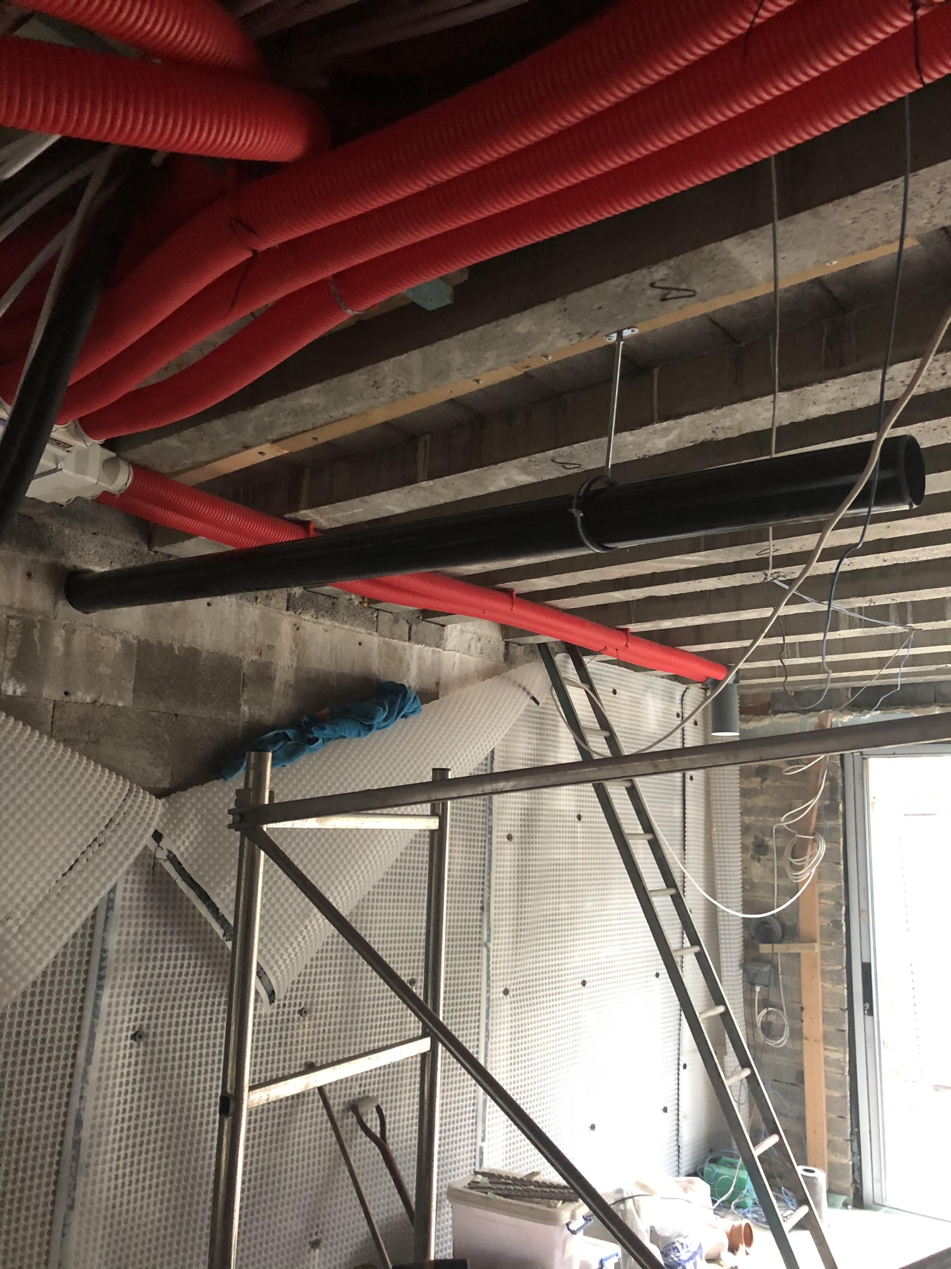

Pocster Posted March 5, 2020 Author Posted March 5, 2020 Still doesn’t look like much of a fall . Pipe now nearly 6m Fall is around 5cm . That enough ??
Mr Punter Posted March 5, 2020 Posted March 5, 2020 75mm would be better. 100mm preferred. 50mm only gives you 1:120. Make sure it is properly supported with a bracket every metre. 1
Pocster Posted March 5, 2020 Author Posted March 5, 2020 27 minutes ago, Mr Punter said: 75mm would be better. 100mm preferred. 50mm only gives you 1:120. Make sure it is properly supported with a bracket every metre. Yes - I was going to add a bracket every metre . 100mm fall across 6metres it will be ?

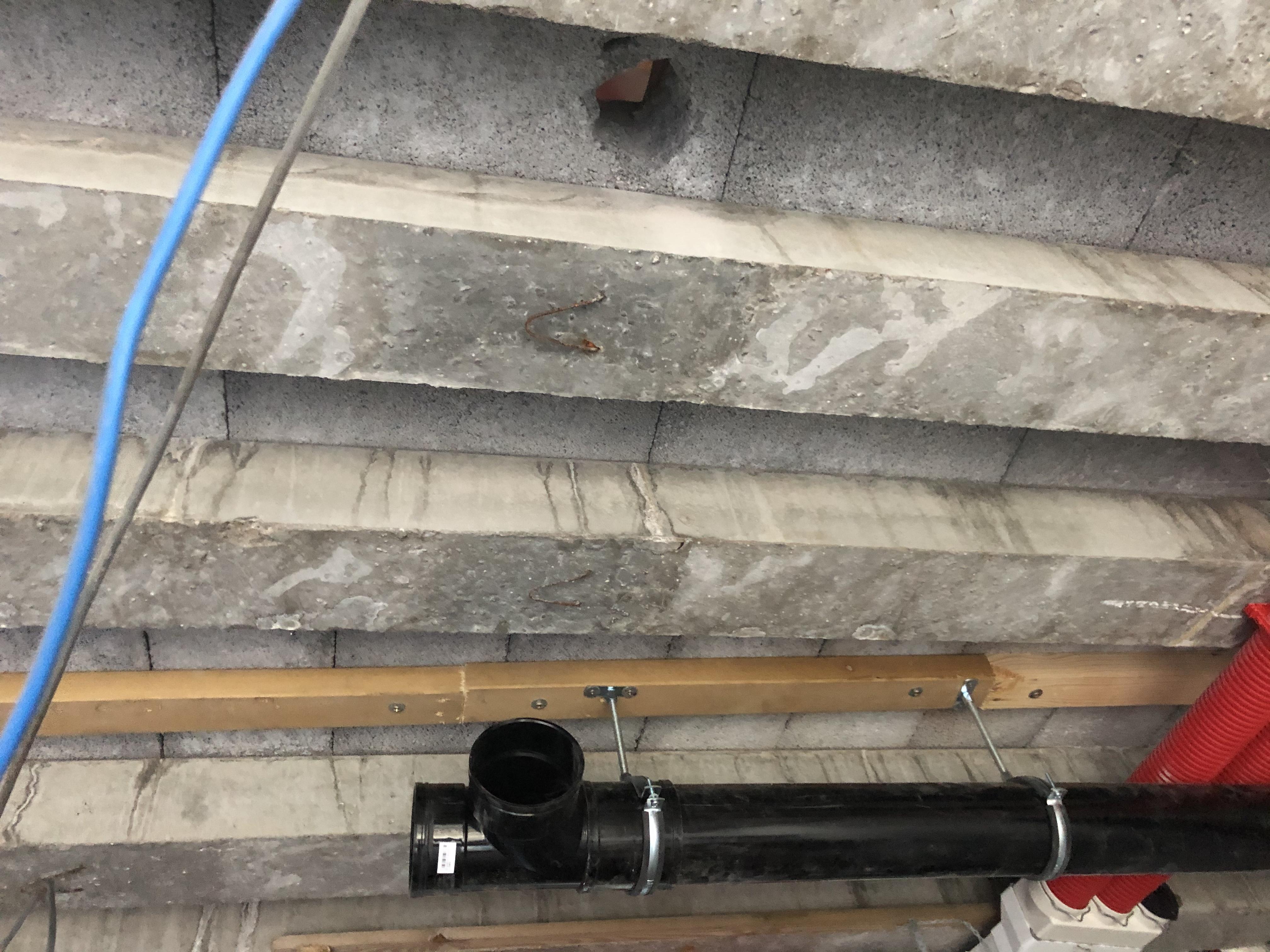

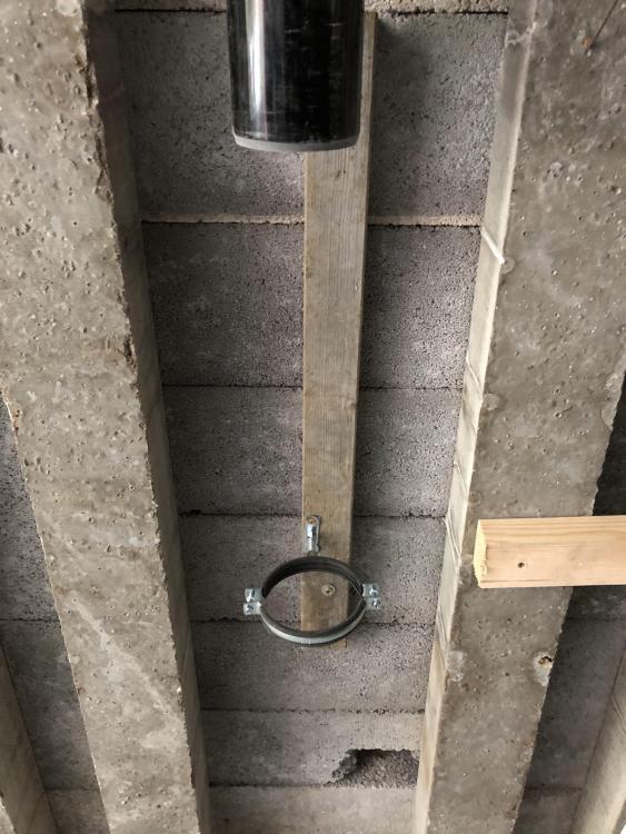

Pocster Posted March 6, 2020 Author Posted March 6, 2020 Awkward work on your own ! First section in and glued . Toilet joint relatively near hole for toilet waste Forgot how nice the glue smells !!
Russell griffiths Posted March 6, 2020 Posted March 6, 2020 I love the smell of napalm in the morning. 1
Russell griffiths Posted March 6, 2020 Posted March 6, 2020 Do you know you don’t need to put that bit of timber up to fix those brackets to. You can get a little insert that you drill a hole in the block poke in insert and screw stud into it and insert expands in the block. I will shut up if you already know this. 1
Onoff Posted March 6, 2020 Posted March 6, 2020 If you were able to drill those concrete beams you could have resin anchored the long studs in.
Pocster Posted March 6, 2020 Author Posted March 6, 2020 4 minutes ago, Russell griffiths said: Do you know you don’t need to put that bit of timber up to fix those brackets to. You can get a little insert that you drill a hole in the block poke in insert and screw stud into it and insert expands in the block. I will shut up if you already know this. No I don’t know what you mean ( even though all the timber is up )
Pocster Posted March 6, 2020 Author Posted March 6, 2020 2 minutes ago, Onoff said: If you were able to drill those concrete beams you could have resin anchored the long studs in. The lintels are hard to drill so F off ! ?
