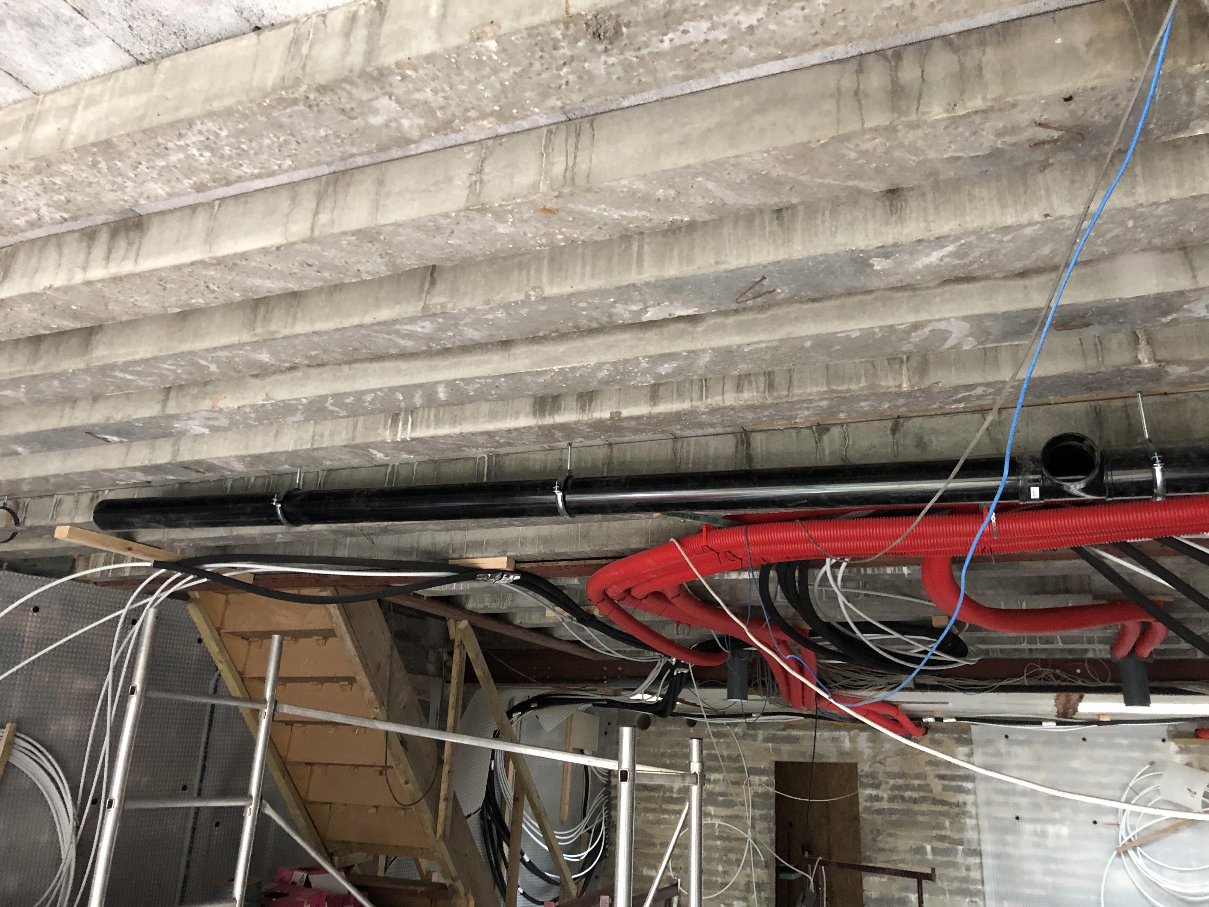

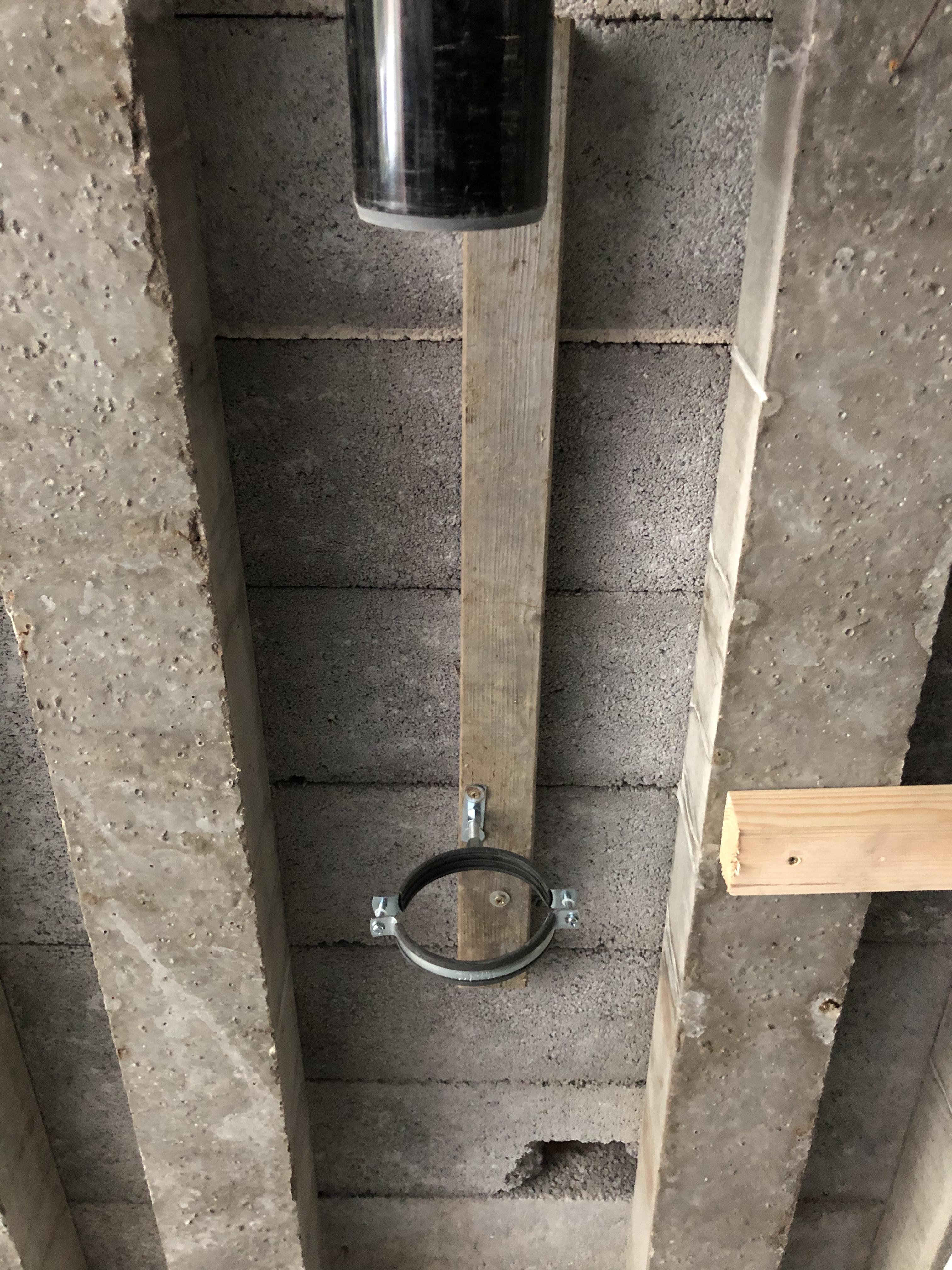

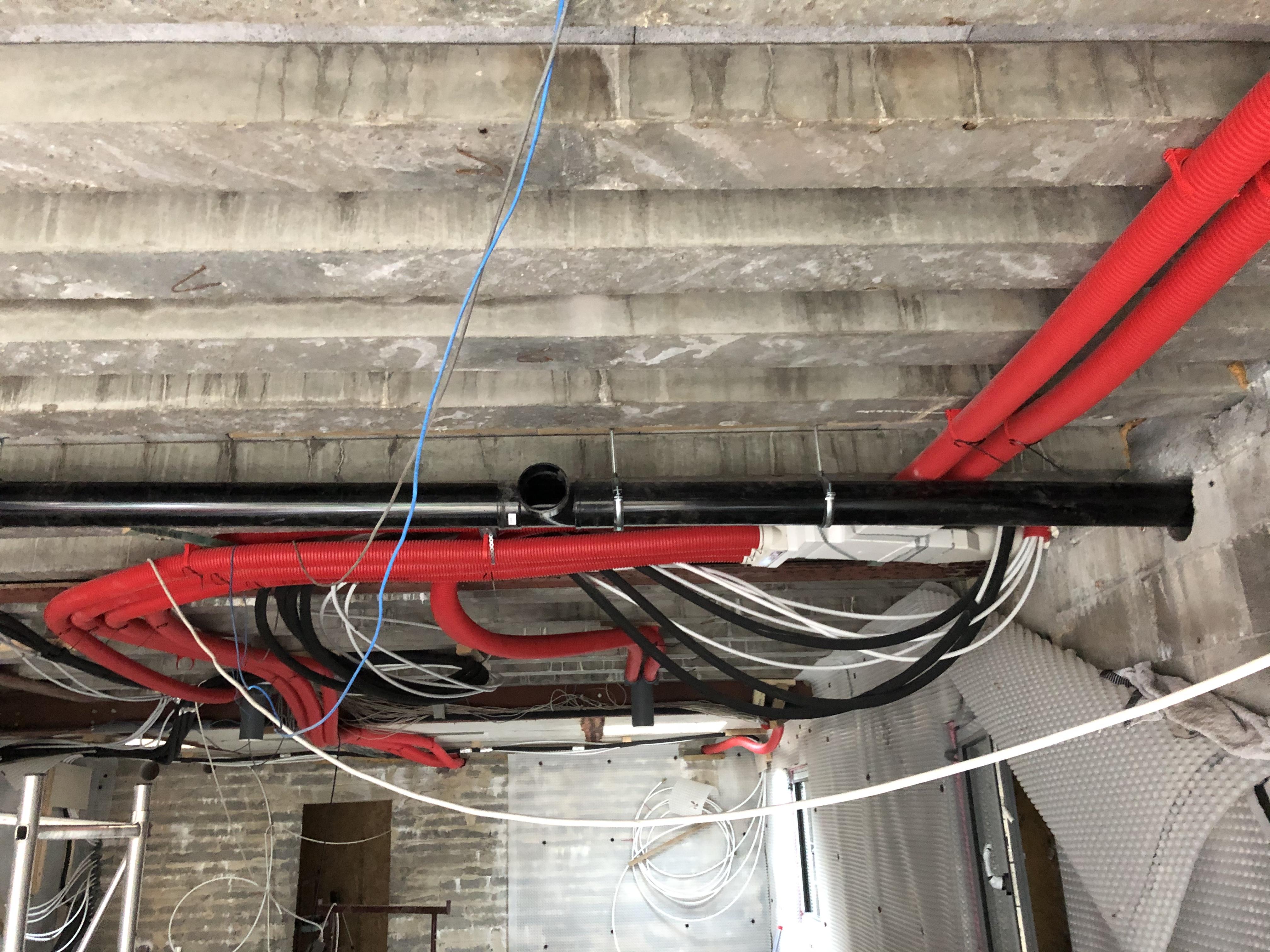

Main run almost done . Welded with pretty good fall
Not sure how I’m going to connect ensuite wc ( hole shows point I’m expecting waste to come through ) - straight to end of main soil run I guess . Assume I’m ok to do a 90 tee right at the end and wc straight into that ...

  • Also, once you are under the floor, and, or, above the ceiling, i would go from 40mm to 50mm then into the 110mm. You will prob be ok with short runs, but i would still go to 50mm
