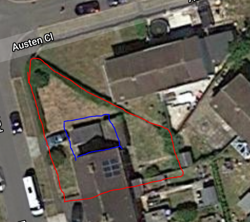

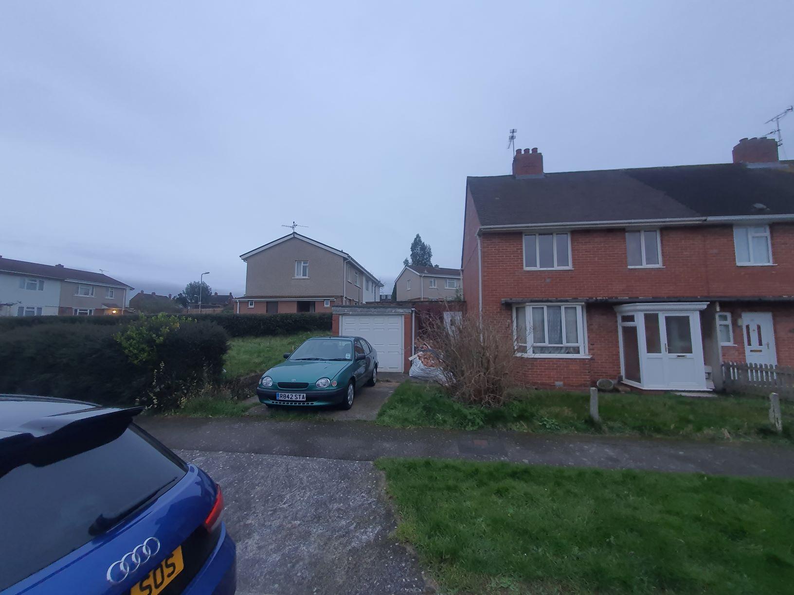

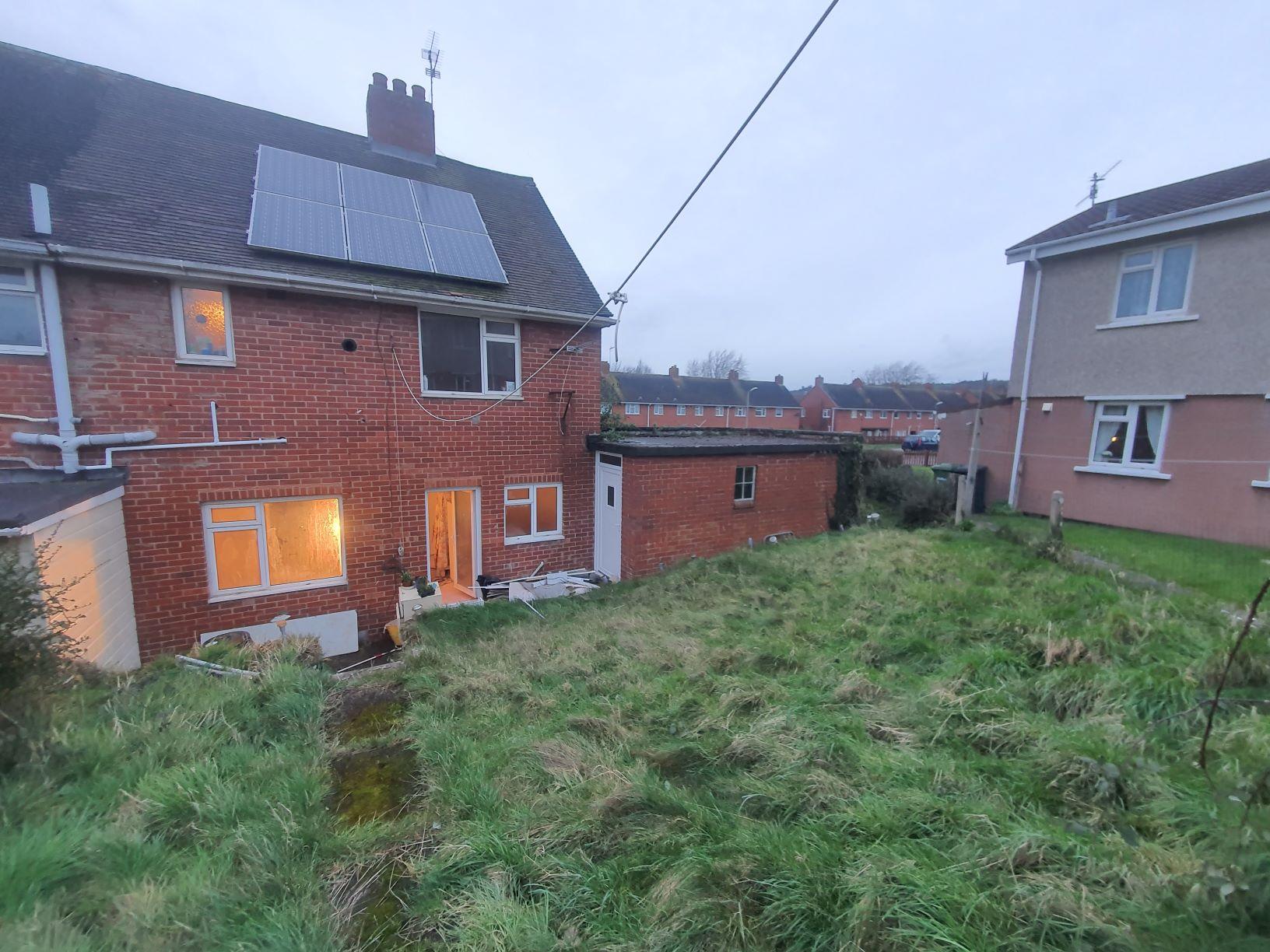

Jordan1 Posted February 19, 2020 Share Posted February 19, 2020 Hi All, has anyone had any experience with submitting planning permission for an end terrace? Had the planning officer round last week to run through our proposal and he said it was an awkward plot; putting another 3 bed house on the end would make sense and looks right from street side (already a single story garage in the footprint of the proposal) but the main detractor was that as the rear gardens of the neighbours all look onto one another building up another story above the garage may be over bearing to the adjoining garden. I'm planning to push back on this due to a number of reasons; -Privacy; all the back gardens look onto one another from the outset and if it comes to it we could use obscured glass on the top floor - Light doesn't seem to be a problem -View; the garden within the closest proximity cant actually see the open air view from the window, can only be seen when in the garden. Additionally he said a extension ( half house = 3m) would probably be allowed but the difference between this and allowing the new build really would seem negligible. Looking at other submissions in the area new infill houses and extensions have been built although not in the exact same situation apart from one up the road which was given planning permission due to an administrative error! The refusal was printed on a piece on paper which said PLANNING PERMISSION GRANTED and so had no conditions which is an interesting case. Does anyone have any advice on what to emphasise in the application? Pictures attached, thanks for any help given Link to comment Share on other sites More sharing options...
ProDave Posted February 19, 2020 Share Posted February 19, 2020 It looks a better prospect from the front than it does from the back. First thing that springs to mind is parking. Both houses need off road parking, how do you propose to fit that in? You could design a house where all bedrooms looked out to the front or side and only say a landing and a bathroom looked out to the back with obscured glass to counter the overlooking argument. The new house really won't have much garden to the rear, so design it almost to ignore that and concentrate on it utilising the side garden as it's main garden area. In many ways this is a similar plot to a previous semi detached house we had. I did for some time think about trying to get planning for a second house, but it would have meant both having a tiny garden, having a very awkward shared parking area, and the new house in any case would have been very small. In the end we decided a better use of the plot was an extension that almost doubled the size of the house, but kept it as one house. Link to comment Share on other sites More sharing options...
Jordan1 Posted February 19, 2020 Author Share Posted February 19, 2020 Thanks for your reply, that's interesting. The plan is to rent out this house once renovated so I probably wouldn't go for an extension. The majority of the street doesn't have off road parking and the min garden size of 55m per house can be met ( assuming side garden is counted although not ideal, it really is quite a big plot). I completely agree with your suggestions for privacy, the main obstacle the planning officer who cam round seemed to point to was a second floor could be over bearing on the neighbouring property. Considering the new build would still be lower than the neighbours house and the suggested plan would pull the house footprint back away from the neighbours in line with the current house I believe there is a case to push back? Seems a mostly subjective objection Link to comment Share on other sites More sharing options...

Jordan1 Posted February 20, 2020 Author Share Posted February 20, 2020 (edited) 16 hours ago, Ferdinand said: Have you a plan (from largest scale on Council Map website would do). Ferdinand Thanks for your reply. Couldn't easily find a plan but the total plots about 25mx 23m so roughly ~290m² in total, existing house is around 6m and the blue box where I've drawn the proposed footprint is ~ 6m. Its the proximity to the neighbours that seems to be why it may bee seen as overbearing but as I pointed to in the post the proposed building would be at a lower level and a step back from the existing footprint of the garage Edited February 20, 2020 by Jordan1 Link to comment Share on other sites More sharing options...
Jordan1 Posted February 20, 2020 Author Share Posted February 20, 2020 11 hours ago, bassanclan said: You could start by examining the building work you could do under permitted development Thanks bassanclan.The planning officer said theres no doubt wed get an extension (up to half the size of the house), but didn't like the idea of a single story dwelling as surrounding is all 2 story. Where should I look for info on PD? Link to comment Share on other sites More sharing options...
Ferdinand Posted February 20, 2020 Share Posted February 20, 2020 (edited) I think you have a decent chance of a modest detached house or a bungalow on that. if you are talking about rentals a small 2 bed bungalow would be a superb proposition .. you would get 5-10 year tenants no problem from parents of a local family. I would start from making it symmetrical across the corner with the neighbour to give a consistent appearance. You can perhaps have part of the garden on the corner as your private amenity space since you can just grow the thick hedge to 2m with no need for approvals. Driveways and access will be the challenge, with the proximity to the junction. The distance to the notional apex of the junction corner is likely to be 10-15m, and that car you can see will be 4 or 5m, so you may have a fighting chance of getting a new drive the far side. Many oldsters will want a low maintenance patio garden, which may help. Needs very careful planning, but could work. I would also try and buy a hunk of their corner side garden from the neighbour before breaking cover, which would help. Edited February 20, 2020 by Ferdinand Link to comment Share on other sites More sharing options...
