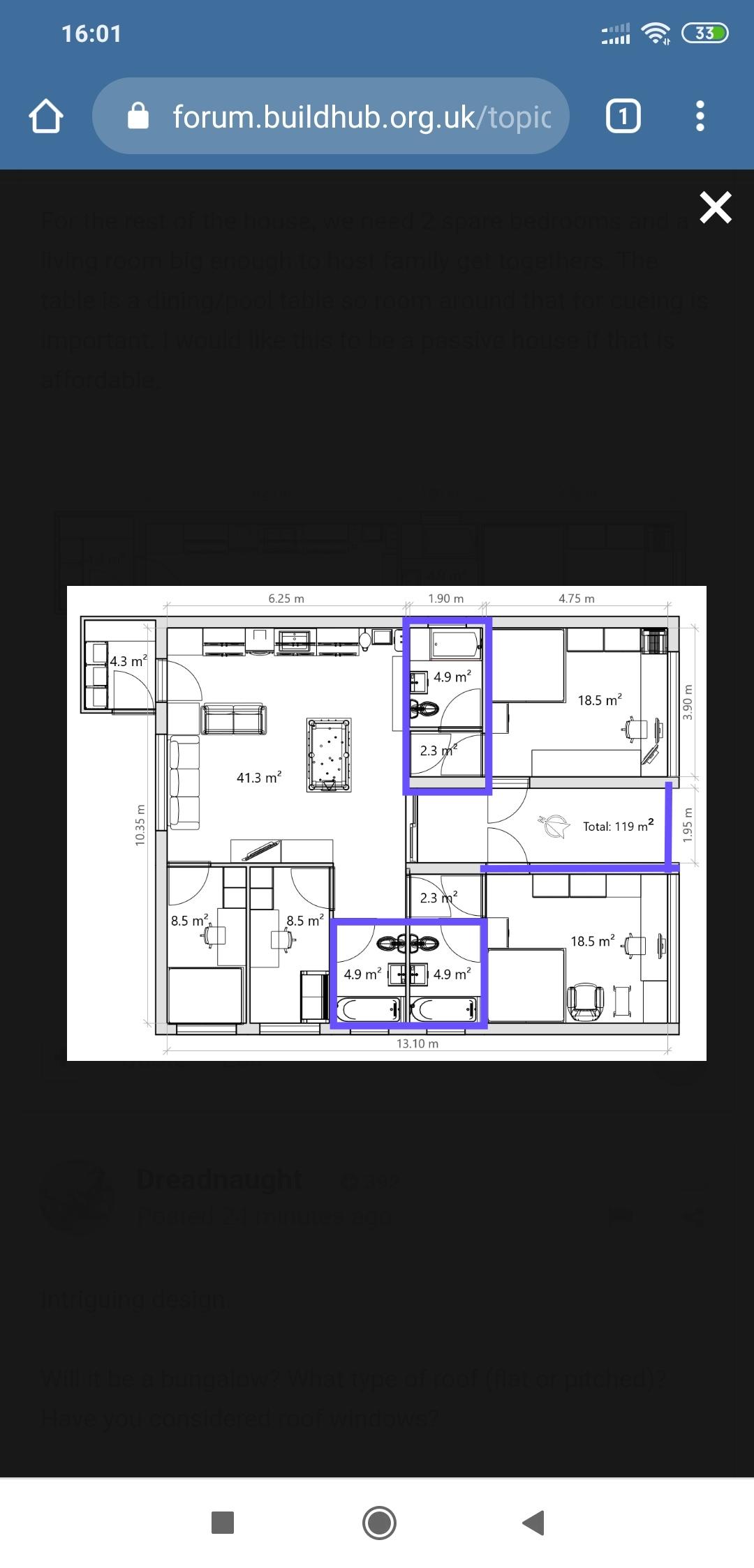

Falesh Posted February 19, 2020 Share Posted February 19, 2020 I've gone through a lot of different plans and have homed in on one that seems to tick all our boxes for the smallest amount of space. This plan is one I will be taking to an architect to finalize, so it isn't meant to be perfect. What would be useful is if anyone can point out stuff that obviously won't work or things I have forgotten. I have ME so I sleep lightly till midday or later and as such I need a very soundproof bedroom. That means it can’t share a wall with rooms other people will use. I also spend most of my time in my bedroom as I can’t walk much so it is more a bedroom flat than anything else. Since I can’t get out much I want to bring as much of the outdoors in, hence the large window facing what will be a wildlife garden. My father will be living in the other large bedroom and also wants it to be fairly self contained and soundproof so that we can both have our own guests without bothering the other. The gap between these two rooms is slightly awkward, but there has to be some gap for soundproofing and so making it 1.95m lets it have uses like for hanging washing to dry, storing bikes, etc. For the rest of the house, we need 2 spare bedrooms and a living room big enough to host family get togethers. The table is a dining/pool table so room around that for cueing is important. I would like this to be a passive house if that is affordable. Link to comment Share on other sites More sharing options...

Moonshine Posted February 19, 2020 Share Posted February 19, 2020 (edited) A couple of comments That 1.95m gap is very awkward and i think that you should just include that in the envelope of the house. If you have that gap it will make the roof design more complicated. Is there only purpose for that gap for sound? you could get really really good sound insulation from a 300 - 400mm wall width. The lobbies to each of the larger bedrooms are slightly odd, why do they have doors on them? sound reduction from the main area? Generally i think you could be much more efficient with space, and get those two smaller bedrooms a bit larger and better integrated. Edited February 19, 2020 by Moonshine Link to comment Share on other sites More sharing options...

Jeremy Harris Posted February 19, 2020 Share Posted February 19, 2020 I agree with the above about the 1.95m gap. Just making a thicker internal wall will give the same level, probably better, of sound suppression, I'm sure. Our external walls are extremely good at keeping out sound, yet are all timber. The secret seems to be the thick layer of dense blown cellulose insulation, perhaps together with the twin stud wall design, that isolates the inner and outer skins from each other. Also, if that space is external, then including it inside the envelope will reduce the heat loss a fair bit, by reducing the external wall area. Challenging set of requirements, for sure! Link to comment Share on other sites More sharing options...

ProDave Posted February 19, 2020 Share Posted February 19, 2020 As a compromise, keep that gap between the bedrooms as outside space, but span the roof over it, giving a much more conventional roof design and overall appearance and making that gap a covered outside space. Link to comment Share on other sites More sharing options...
Declan52 Posted February 19, 2020 Share Posted February 19, 2020 You have 3 small bathrooms each of which looks to small. By removing the really small corridor at each you could have 2 much bigger bathrooms . You can buy heavy doors,oak or walnut which will be better for keeping sound out of your offices. Move the front door to the end of the Wall so it's a square. You will save a fortune in terms of doing the roof plus you won't need to buy 2 external doors for your offices. Link to comment Share on other sites More sharing options...

Falesh Posted February 19, 2020 Author Share Posted February 19, 2020 5 minutes ago, Moonshine said: The doors are indeed the weak point, and you have two doors opposite each other on the 1.95m gap. So sound will go through these, and the sound proofing provided by the 1.95m gap is irrelevant unless the transmission path through the doors is treated / controlled. i can understand your loss of sleep is very important, but the sound insulation can be treated is a lot better way than a gap (derogated by doors), and you would loose all that lovely internal area. You have a point, but it is easier to buy chunky airtight external doors then getting good soundproofed indoor ones. I definintly agree that the gap is, odd, but all my research on soundproofing has shown that if you want to soundproof a room you either can't share a wall or you have to spend more then it would cost to build a room within a room to do it. Having said that, I am by no means an expert on acoustics so there may be a way of doing things differntly. This is one thing I can't gamble on though, it has to work. Link to comment Share on other sites More sharing options...

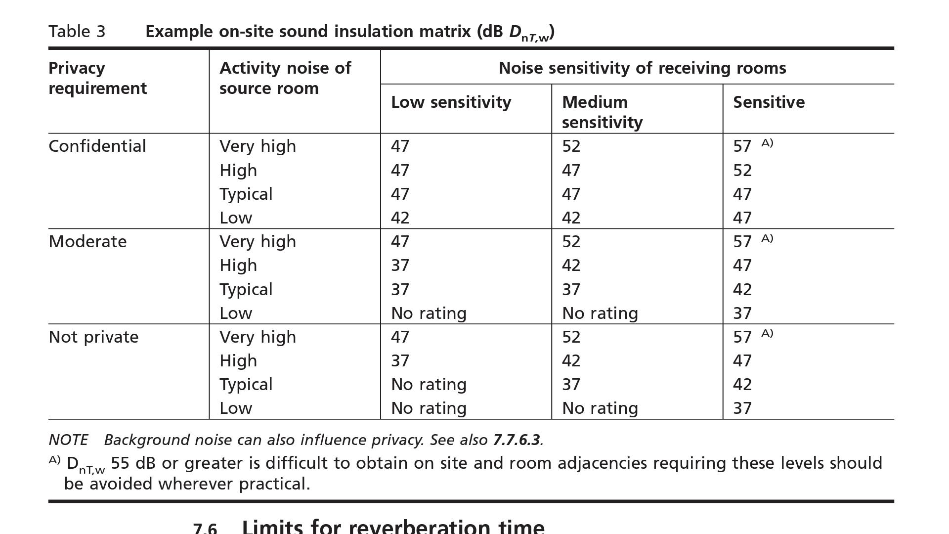

Moonshine Posted February 19, 2020 Share Posted February 19, 2020 23 minutes ago, Falesh said: I am by no means an expert on acoustics so there may be a way of doing things differently I have been doing acoustics for 15+ years and the term expert gets banded about a bit (i have been called one, but I really don't like the term). As you are building from the ground up you can do a lot in terms of layout and wall specifications. The lobby is a good idea, but you need to think about the practicalities and access, as getting a good acoustic door needs seals on all perimeters. Have a look here for the type of constructions. https://www.lorientuk.com/resource-centre/acoustic-search Also, are you looking to acoustic up-spec the external window? Link to comment Share on other sites More sharing options...

Moonshine Posted February 20, 2020 Share Posted February 20, 2020 On 19/02/2020 at 17:40, Ferdinand said: I think this acoustics debate may go round in circles to an extent for want of specific experience / reference. Can I suggest you ask for a few people with varying constructions where you can go and visit, and take a ghetto-blaster or computer plus speaker with a recording of the type of noise you are concerned about (or a person with a trombone ?) to gain some real examples of how the acoustics work for you with various known types of construction? You may be pleasantly surprised, or at least could rule things out more authoritatively. Tbh I don't think that would really be a worth while exercise as you don't know what the objective sound reduction of each wall is unless you test them. Also a masonry wall will sound different to a stud wall. The specification of wall can be derived buy using a matrix as below from BS8233:2014 (note these are DnT,w figures not Rw figures) Link to comment Share on other sites More sharing options...
