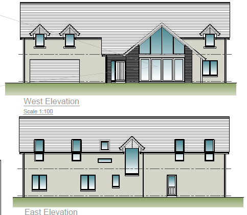

We are now homing in on our final design.
We have pushed the roof up so it is  1-3/4 storey and have a number of dormers (8-in total!) see below.
The house is about 50m^2 bigger than I had hoped (which i underestimated, and now want this size) hence I am in a bid now to simplify construction where possible but retain the size ( not because i want it to be big, but because it is the right size). The dromers look not bad, and I like the idea, but i know they add significant complexity and hence cost. Would it be better if these were simplified to Velux style that cross the wall/roof threshold? (picture below) is it a cheaper option?

As well as cost and complication, the big issue with dormers like that is that you need lots of downpipes for the gutters.
As drawn you would need a downpipe in front of the garage door or across the front of the house, I made this mistake on my last house but we managed to put it inside the garage. You would actually need multiple downpipes on the elevations.
The Velux windows would not fix this, unless you put gutters in front of them which is not ideal. You could move some of the Veluxes up to just be in the roof.

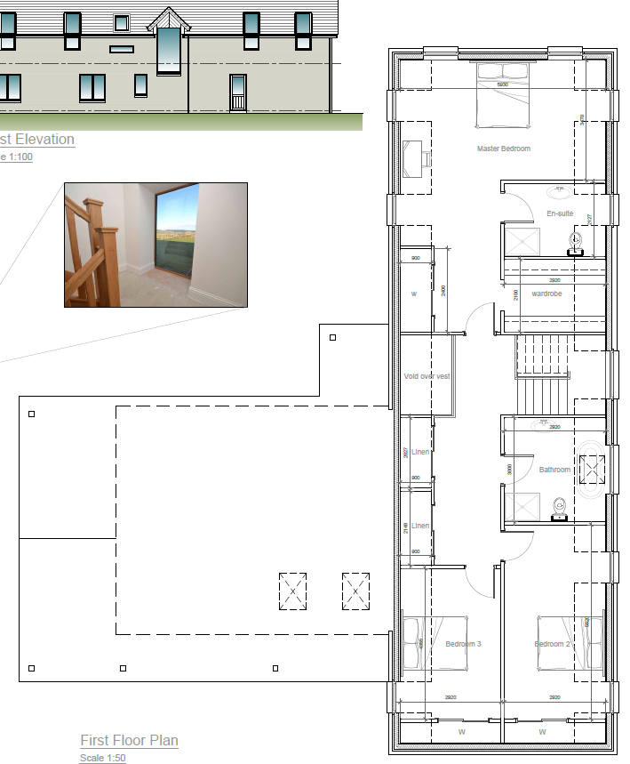

I could see better with the new floorplan you uploaded.
I do think dormers look nicer than the Velux windows.
I would lose the one on the stair window as it is not necessary with the window on the half landing.
I would consider making the master en suite window just a Velux in the roof.
The problem is the two Veluxes at the front of the master bedroom. I am not sure hot to fix that without damaging the look of the house. You could try a double sized one instead of two separate ones, or making the one opposite the en suite a Velux in the roof, but these may not look right.

Perhaps look at reducing the number of dormers and increase their size.  The one that cuts through the floor zone looks a bit odd.  Could you add windows to the gable ends?

@AliG The downpipes were breaking my heart - but at the rear so I was living with it.
@Mr Punter I was actually waiting on a update to include those. See below...you and @AliG have got it right, the stairwell one needs to go.

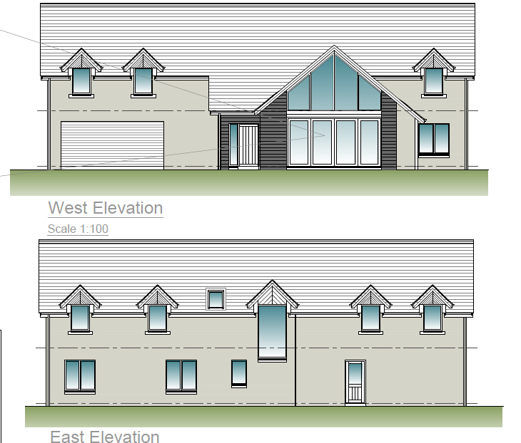

Reassuringly since posting this some changes were already underway to simplify, which you guys had picked up on. see below:
As a cost saving measure (compared with dormers) I can keep them like this at the rear. or make them skylights only which furtehr simplifies the roof and wall constructions and gets rids of lots of downpipes.
On the front elevation I am toying with getting rid of the right hand dormer above garage and changing to skylight (albeit may mess with balance) and I am adding a large skylight above vestibule at front door to provide light from second floor landing.

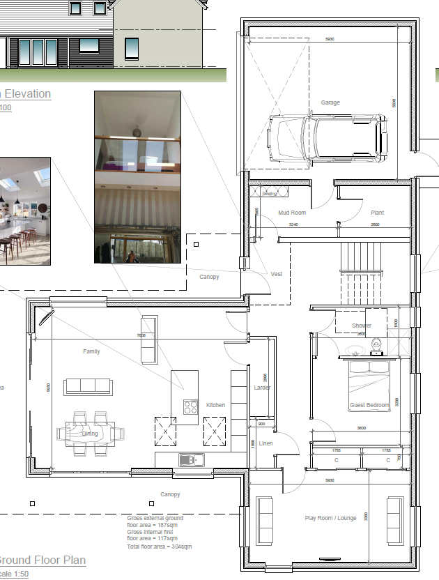

I have included a floor plan to make it easier to understand.  Thanks again to all.
