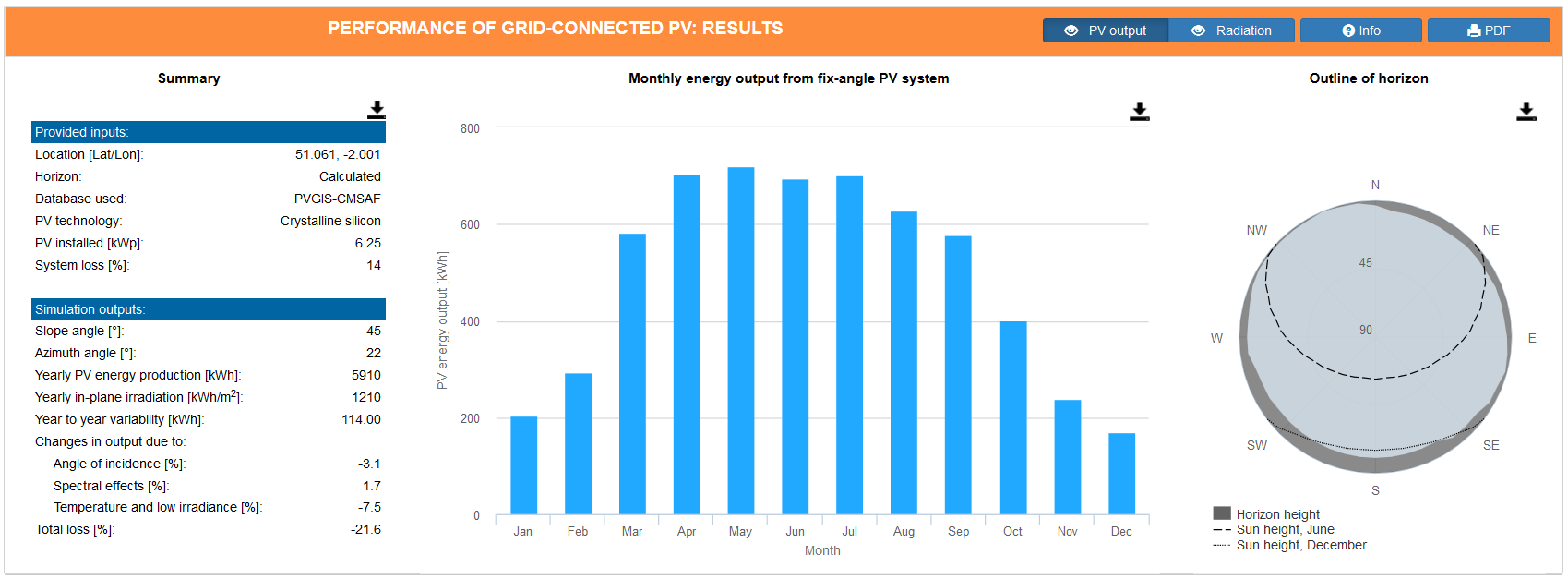

Jeremy Harris Posted February 18, 2020 Share Posted February 18, 2020 As a guide, this is a plot of the generation from a 6.25 kWp system, facing a bit west of south and angled at 45° at our location: It illustrates pretty well how PV generation drops a great deal around October and doesn't pick up again until March, making it less than useful for heating. 1 Link to comment Share on other sites More sharing options...
