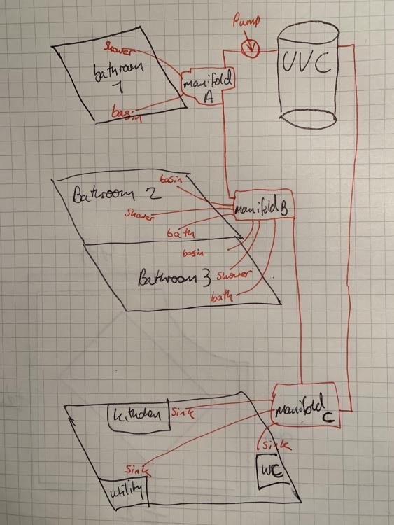

Adsibob Posted January 16, 2021 Share Posted January 16, 2021 I’m interested in reviving this thread as I have a similar query, in that I am also gutting and replumbing a 5bed property with three bathrooms. I’m not so worried about an endless supply of hot water, as I think a 250L cylinder will be enough (and I would imagine 300L would be enough for @sendu since bathing water is much cooler than cylinder water so once it’s mixed with cold water, a 300L cylinder of hot water could provide for several baths and even more showers). My concern is more about the long run of pipes making the time it takes for hot water to travel from the cylinder to the outlet as much as a 12m distance for some outlets, most of which is upwards against gravity. A solution that has been suggested to me for this is to have a whati think it’s known as a primary circuit which essentially continuously or intermittently (depends on the setup) circulates hot water to the outlets before the tap is turned on so that the water is waiting for you. There are two ways I’ve been told about how this can be achieved: with PIR motion sensors that activate the circuit when one approaches the outlet, or a less sophisticated solution which continuously runs the water around the circuit with a pump during waking hours. Still investigating which one suits me best: My main concern about the PIR activated system is that it is possibly more likely to go wrong, but I’m not basing that on any evidence. It’s just a gut instinct. It’s more expensive to install, but it should save slightly on running costs/heat loss vs the pump. My main concern about the pump is noise. I hate house sounds, particularly pumps. If anyone could comment about either system and their pros and cons, that would be really helpful. Link to comment Share on other sites More sharing options...

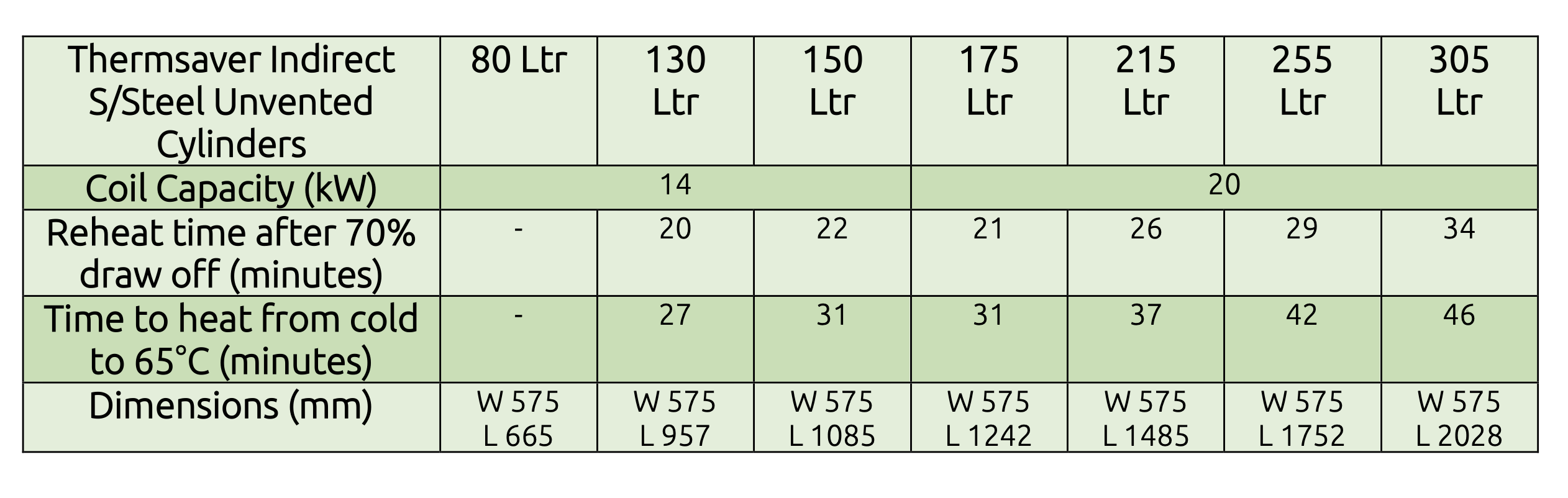

AliG Posted January 16, 2021 Share Posted January 16, 2021 (edited) I have a 500L UVC but set it to only 50C, I can turn it up if we have a lot of people staying. It came from this company, as you can see from the specs it takes time to reheat a tank and all the time you are diluting the water temperature down. The Telford 300L cylinder says 29 minute reheat from 75% draw off so similar to the numbers below. An UVC cannot take the full 40kW output of a large boiler usually, so you cannot just add a bigger boiler to heat it up faster. A couple of simultaneous 10 minute showers at 40C are going to use around 150L of 64C water. So your tank would need around half an hour to reheat. If you draw 150L of water from a 250L cylinder at this time of year when the water temp is only maybe 4 or 5C then you are going to reduce the temperature in the cylinder to around 30C The water will be heating up as you draw it out, but a 250L cylinder would struggle to hold 40C for the duration of 2x10 min simultaneous 10L/min showers. It would be at around 37C when the showers were over. A 300L tank on the other hand would only see a drop to 35C as you are using less of its capacity. Thus including the heating capacity it can hold the temperature over 40C for the same two showers. The issue then is what if someone comes along to have a third shower. You would only have to wait around 5 minutes for the 250L to be back at 40C. But if you start with the temperature at 40C, by the time you are finished it would be 26C, again the boiler is running, so it would actually end up at around 33C. To be able to have a shower you need a starting temperature in the low 50s in a 250L tank and 50C in a 300L tank so either tank would need close to 20 minutes to heat up after 2 showers before you should start another one. From these numbers basically a 250L tank would struggle to hold the temperature above 40C for two simultaneous long showers or a bath and a shower. A 300L would do it more comfortably. Neither tank is going to have enough hot water for 3 simultaneous showers. This is why I went to 500L as 3 simultaneous showers or a bath and 2 showers was my target. We often have a lot of people staying. Edited January 16, 2021 by AliG Link to comment Share on other sites More sharing options...

AliG Posted January 16, 2021 Share Posted January 16, 2021 Either 30 or 35kw boiler should be fine. As you are tight for space the way to effectively increase the size of your tank is to run it hotter. You can fill it with 75C water and then have a mixer valve that minimises the temperature coming to the taps. 15mm copper pipe holds 0.14L per metre and 22mm holds 0.31L per metre. Plastic pipe has thicker walls so is a bit less. So a 12M 15mm pipe would hold around 1.5L of water. Assuming a shower at 10L/min it would take around 10 seconds for 15mm pipe to run hot and 20 seconds for 22mm pipe. I wouldn't worry about it. Gravity shouldn't have any impact as long as you have enough water pressure. I have a circulating water circuit as my longest pipe run is over 30M and there was nowhere else to put the tank. They waste a lot of energy if you leave them running all the time. I just run it 4 times a day. It is like having a radiator that is hot in your house 24hours a day 365 days a year and I would recommend trying to minimise the amount water in the pipes instead which reduces losses and speeds up the water getting to the tap. Link to comment Share on other sites More sharing options...

Adsibob Posted January 16, 2021 Share Posted January 16, 2021 42 minutes ago, AliG said: Either 30 or 35kw boiler should be fine. As you are tight for space the way to effectively increase the size of your tank is to run it hotter. You can fill it with 75C water and then have a mixer valve that minimises the temperature coming to the taps. 15mm copper pipe holds 0.14L per metre and 22mm holds 0.31L per metre. Plastic pipe has thicker walls so is a bit less. So a 12M 15mm pipe would hold around 1.5L of water. Assuming a shower at 10L/min it would take around 10 seconds for 15mm pipe to run hot and 20 seconds for 22mm pipe. I wouldn't worry about it. Gravity shouldn't have any impact as long as you have enough water pressure. I have a circulating water circuit as my longest pipe run is over 30M and there was nowhere else to put the tank. They waste a lot of energy if you leave them running all the time. I just run it 4 times a day. It is like having a radiator that is hot in your house 24hours a day 365 days a year and I would recommend trying to minimise the amount water in the pipes instead which reduces losses and speeds up the water getting to the tap. So are you saying that if my maximum pipe run from tank to outlet is about 12M, I shouldn't bother with a secondary loop because the extra heating costs are not worth the time saving? I find that a little bit surprising because the property I'm renting at the moment (not the house I'm re-doing) has pretty good water pressure, with a Megaflo Heatae Saedia CL250 tank about 13M or maximum 15M from the bathroom and the outlets in that bathroom take quite a bit longer to heat up: the first use of the day will take about 30 seconds to get warm and 40 seconds to get hot. That is with turning the tap on full (which results in more water than one would normally need to wash your hands). But the problem isn't just limited to the basin, in that when I'm in the bath, say I want to add more hot water after 20 minutes or so, I need to endure 20-30 secs of cold water first. Obviously I don't know how this was set up, and maybe the pipe runs are not direct, but that would be surprising as everything is on the same floor (it's a ground floor flat) with the tank at one end of the corridor and the bathroom at the other. There is actually a grunfos pump by the side of the heatrae megaflo that is not currently switched on. The landlord said I could switch it on if I wanted to but I've not yet experimented. It's right by our bedroom and the Mrs is sensitive to sound. Link to comment Share on other sites More sharing options...
