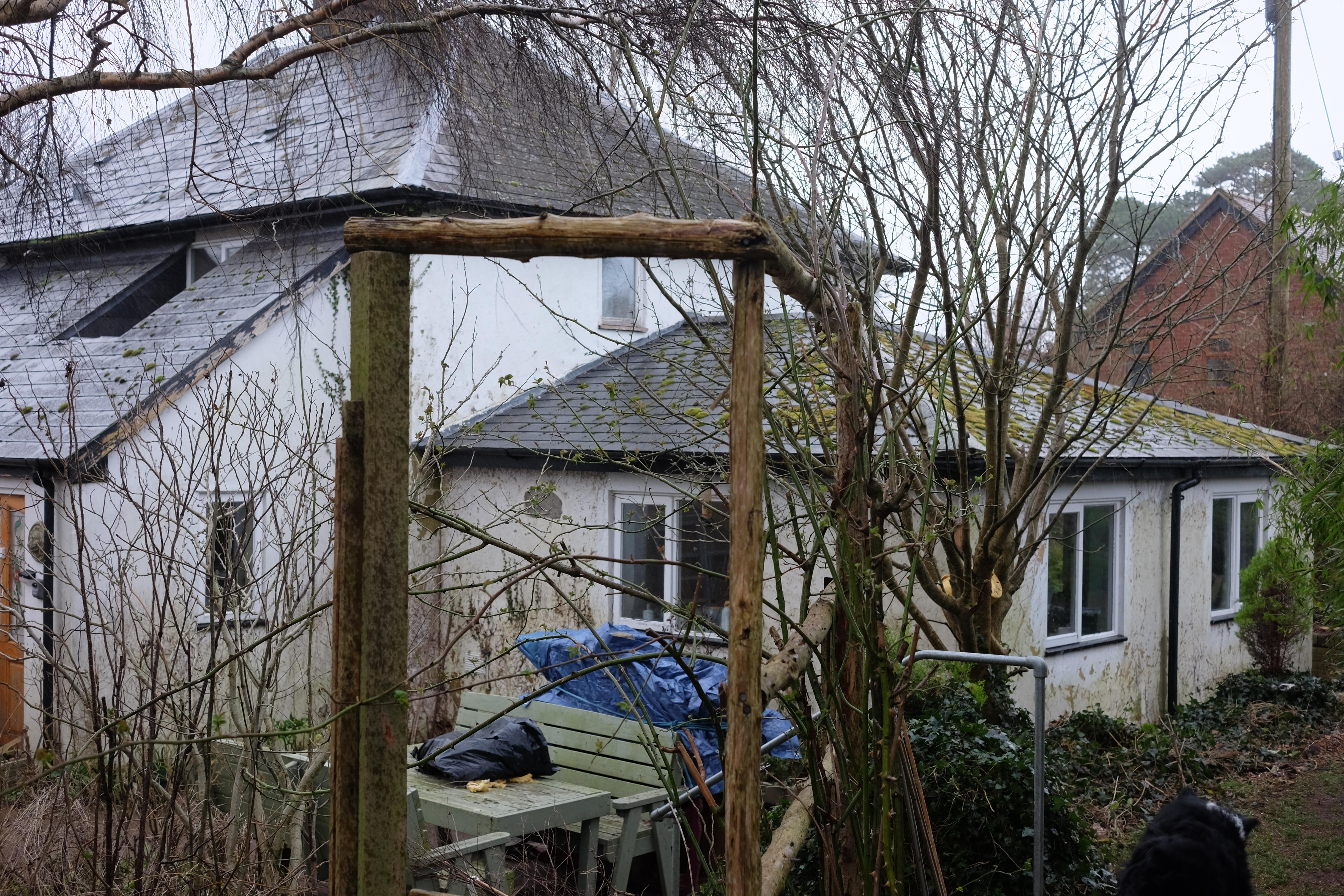

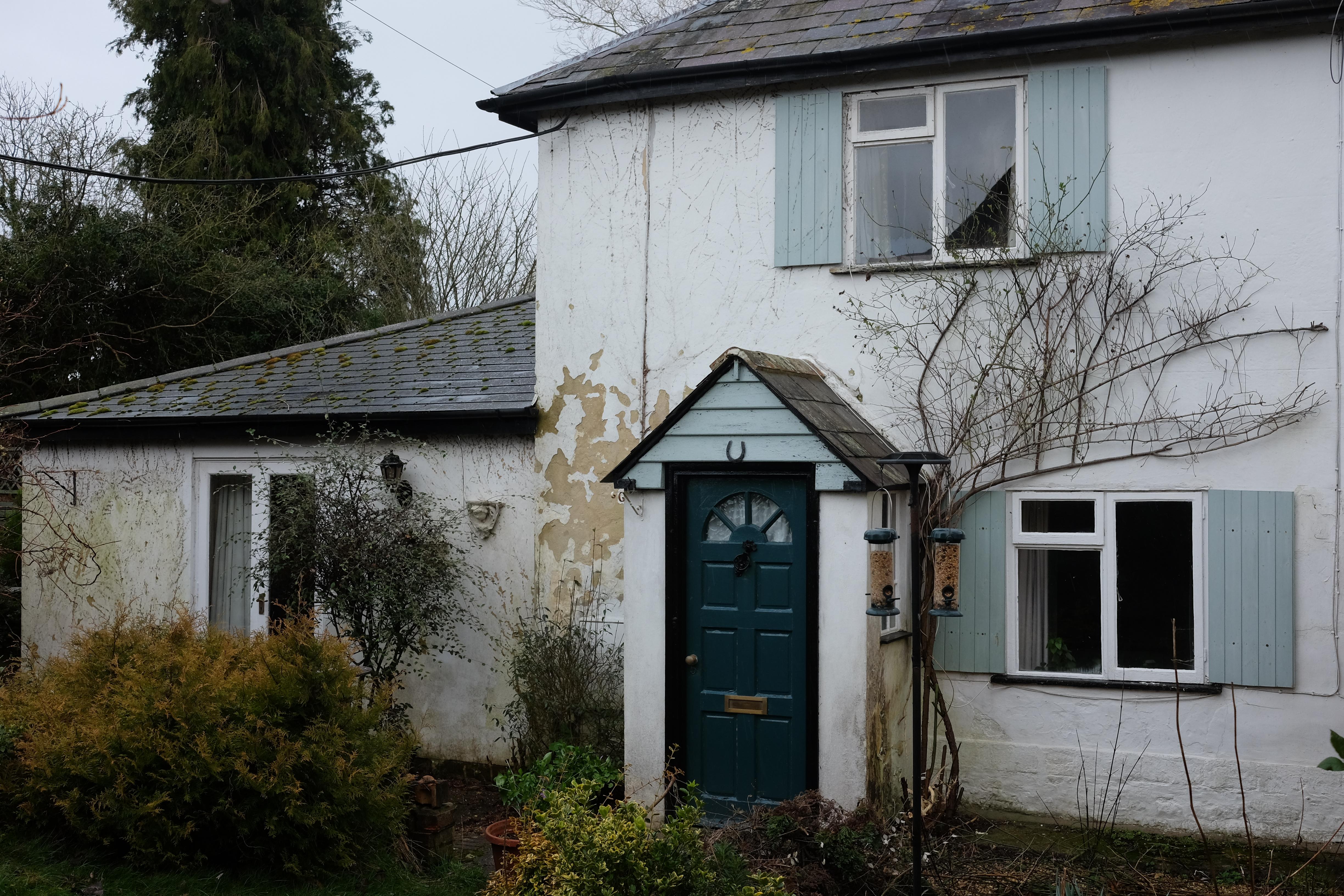

Delicatedave Posted February 9, 2020 Posted February 9, 2020 My tiled roof needs some work, the is a lot of moss and the "ridge tiles" look as if they need refixing. Problem is I've never done a roof. The are no broken tiles and it's not that high, well half of it's an extension. What do ya think?
PeterW Posted February 9, 2020 Posted February 9, 2020 Tiles may not be nailed depending on age - you may find you can push one or two up and then walk up the holes. Verges will be nailed, last couple of rows before the ridge should be too. Worth changing to a dry fit ridge system if you’re doing a roof as they are more secure than cementing them on.
MikeGrahamT21 Posted February 10, 2020 Posted February 10, 2020 +1 for dry ridge. If the roof is fairly old, and the tiles are concrete, be very careful walking on them as they will be quite brittle and could crack, so make sure you've a few spares knocking about to replace any which go. I always try and walk on the joints, as theres a bit more thickness of tile to support my weight.

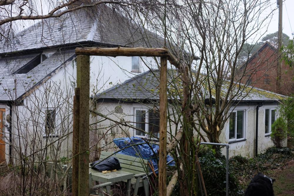

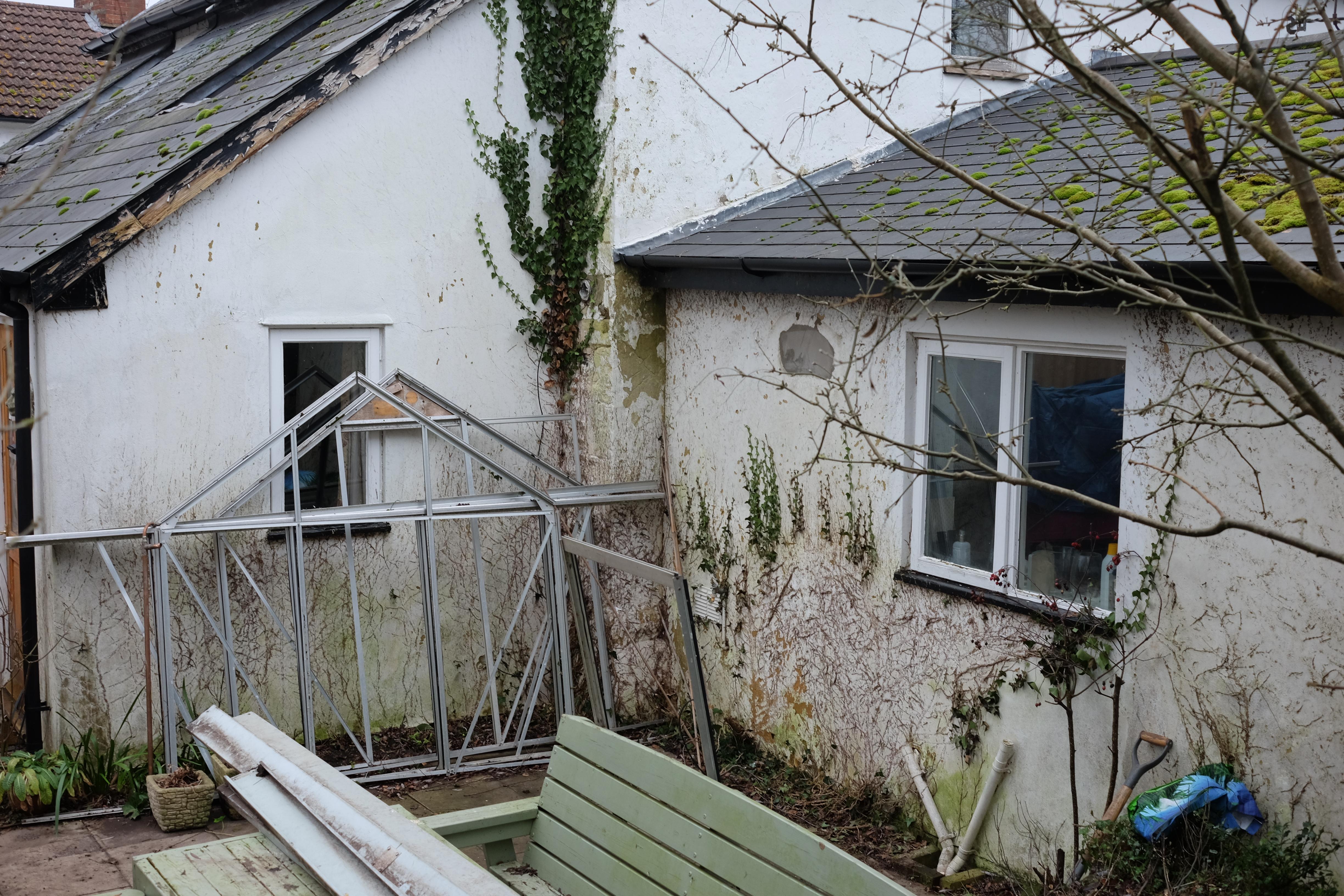

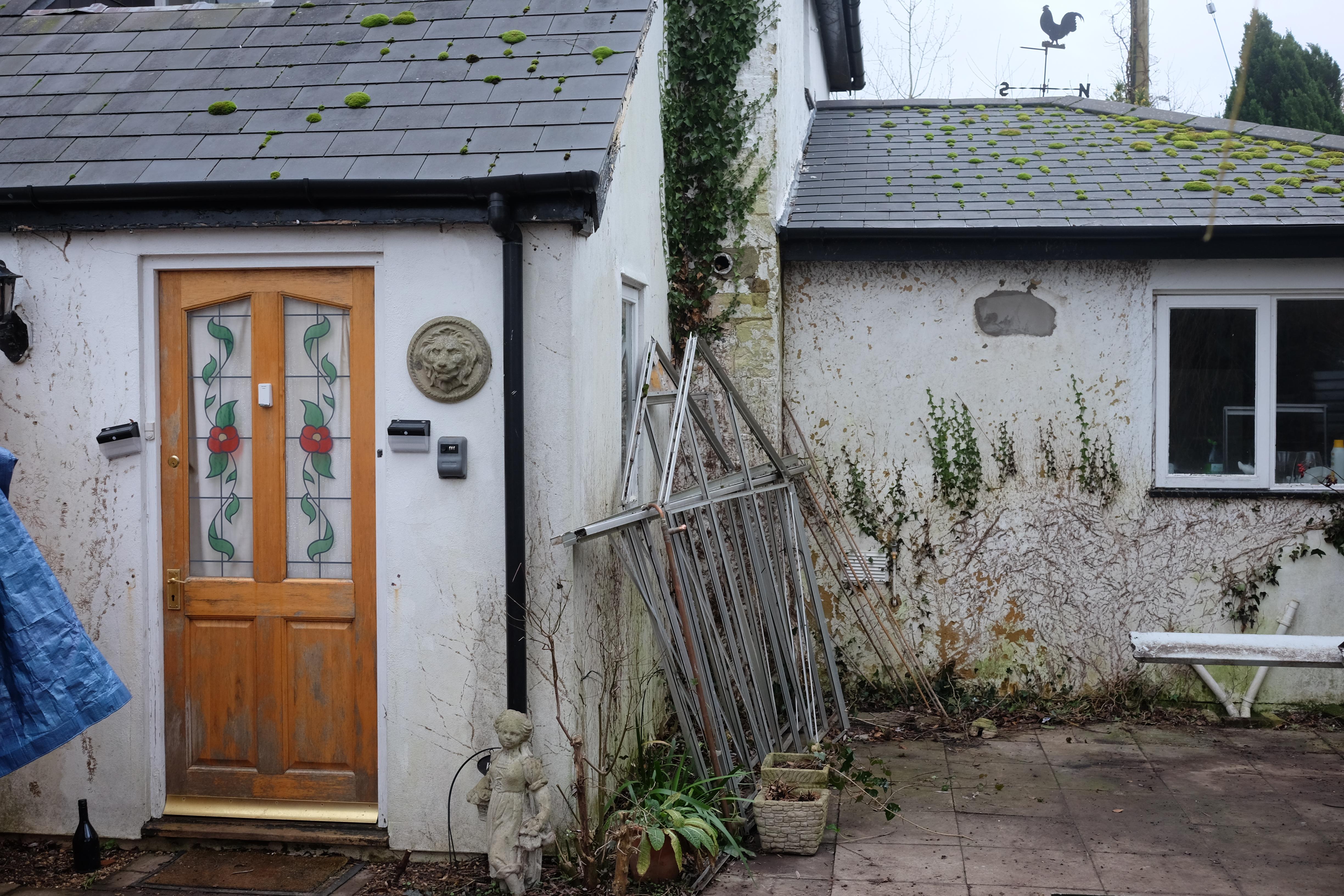

Delicatedave Posted February 10, 2020 Author Posted February 10, 2020 19 hours ago, Declan52 said: A few pics would help. Well until about an hour ago that was impossible but I've just had some trees removed and here goes. The roof is not that old, maybe early 90s
Mr Punter Posted February 10, 2020 Posted February 10, 2020 They look like Eternit composite slate. Not my favourite but quite cheap and they last OK.
Delicatedave Posted February 10, 2020 Author Posted February 10, 2020 37 minutes ago, Mr Punter said: They look like Eternit composite slate. Not my favourite but quite cheap and they last OK. Yea but do the break if you walk on them. To be honest I'm thinking get up on the extension only and then blast off the moss with a pressure water (making sure I down go under the tiles). The cement in the ridge? tiles and fix the flashing. If do that I can get a roofer to do the high roof and fix the chimney pointing etc.
Declan52 Posted February 10, 2020 Posted February 10, 2020 You could mix some copper sulphate up and using a pump sprayer cover the roof and let it work away for as week then use a garden hose and rinse it of. Once you have the moss removed then you will be able to see what exactly needs done without you needing to get into the roof. Don't power hose the tiles, it will cause more damage to the surface of the tile. The patch job along your flashing will need to be removed and done right. How are you at heights??? Can you hire a roof ladder if your not the best???
