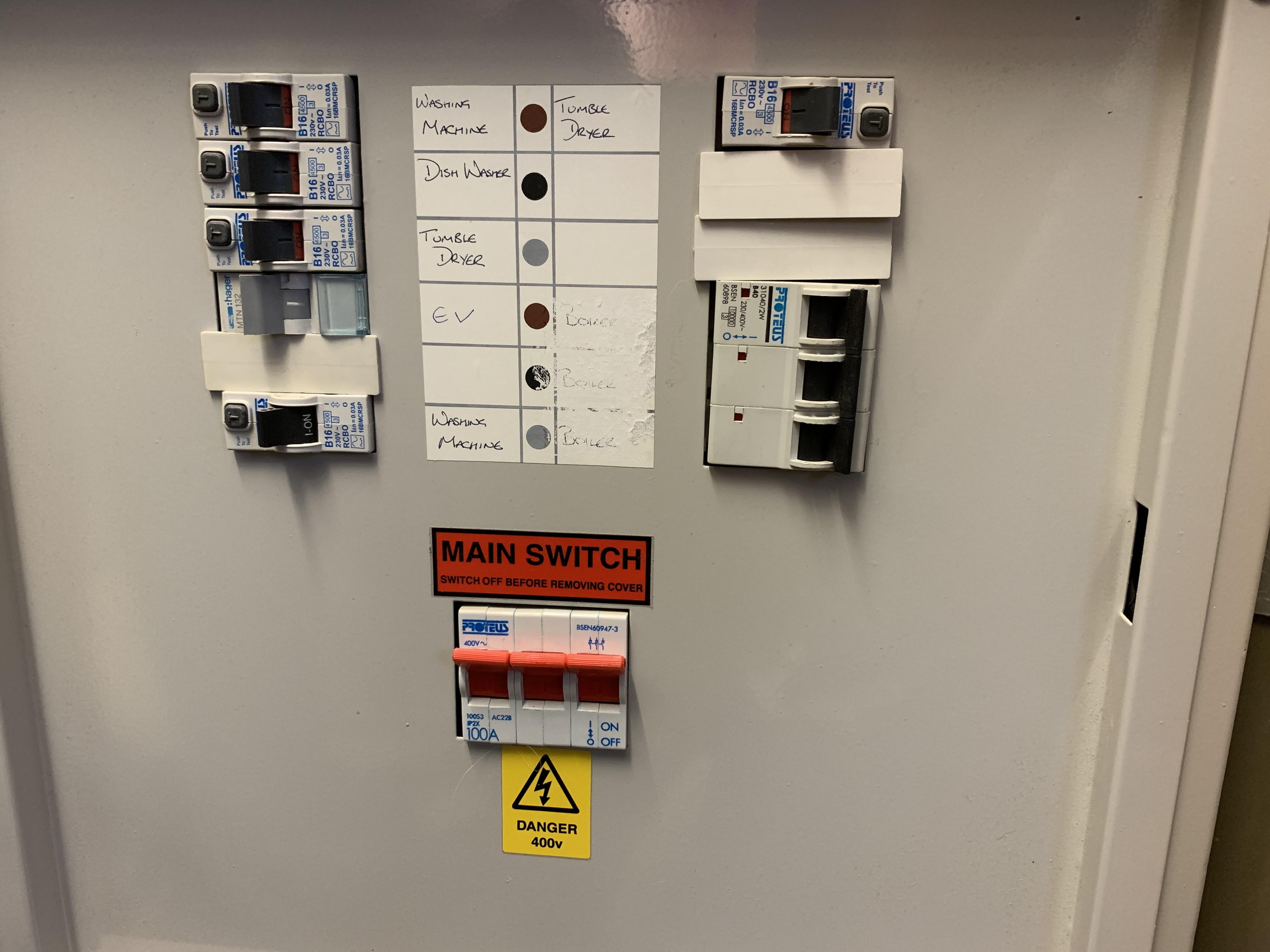

ProDave Posted February 11, 2020 Posted February 11, 2020 What you need is a normal timer switching a contactor. Is there any spare space in the consumer unit that feeds the charger? Picture? 1
newhome Posted February 11, 2020 Author Posted February 11, 2020 3 hours ago, ProDave said: What you need is a normal timer switching a contactor. Is there any spare space in the consumer unit that feeds the charger? Picture? Here is the CU that feeds the charger (marked EV).
ProDave Posted February 11, 2020 Posted February 11, 2020 Ah a 3 phase board. Not so convenient. You would be looking at something like this, https://www.ebay.co.uk/itm/CONTACTOR-63-AMP-2-POLE-AC-12kW-NORMALLY-OPEN-HEATING-LIGHTING-DIN-RAIL-MOUNT/174122632964?epid=6007308395&hash=item288a848704:g:dYcAAOSwBY5d8RnJ It might be possible to put that inside the CU, but not in place of a pair of mcb's as you can often do with a single phase board. It all depends how much room there is inside and how much depth. Alternatively the contactor could be mounted above or alongside the CU in it's own enclosure. Use a normal single channel central heating programmer to set the on / off times. the output of the timer feeds the coil of the contactor. P.S. Have you really got two washing machines and 2 tumble dryers? 1

newhome Posted February 11, 2020 Author Posted February 11, 2020 2 hours ago, ProDave said: P.S. Have you really got two washing machines and 2 tumble dryers? Lol, not now as it seemed to be overkill with just me living here but there is space / plumbing / wiring for a washing machine and dryer upstairs. The 2 I use currently are in the utility room. Should have included 2 dishwashers really as if this house was fully occupied that would be useful.
