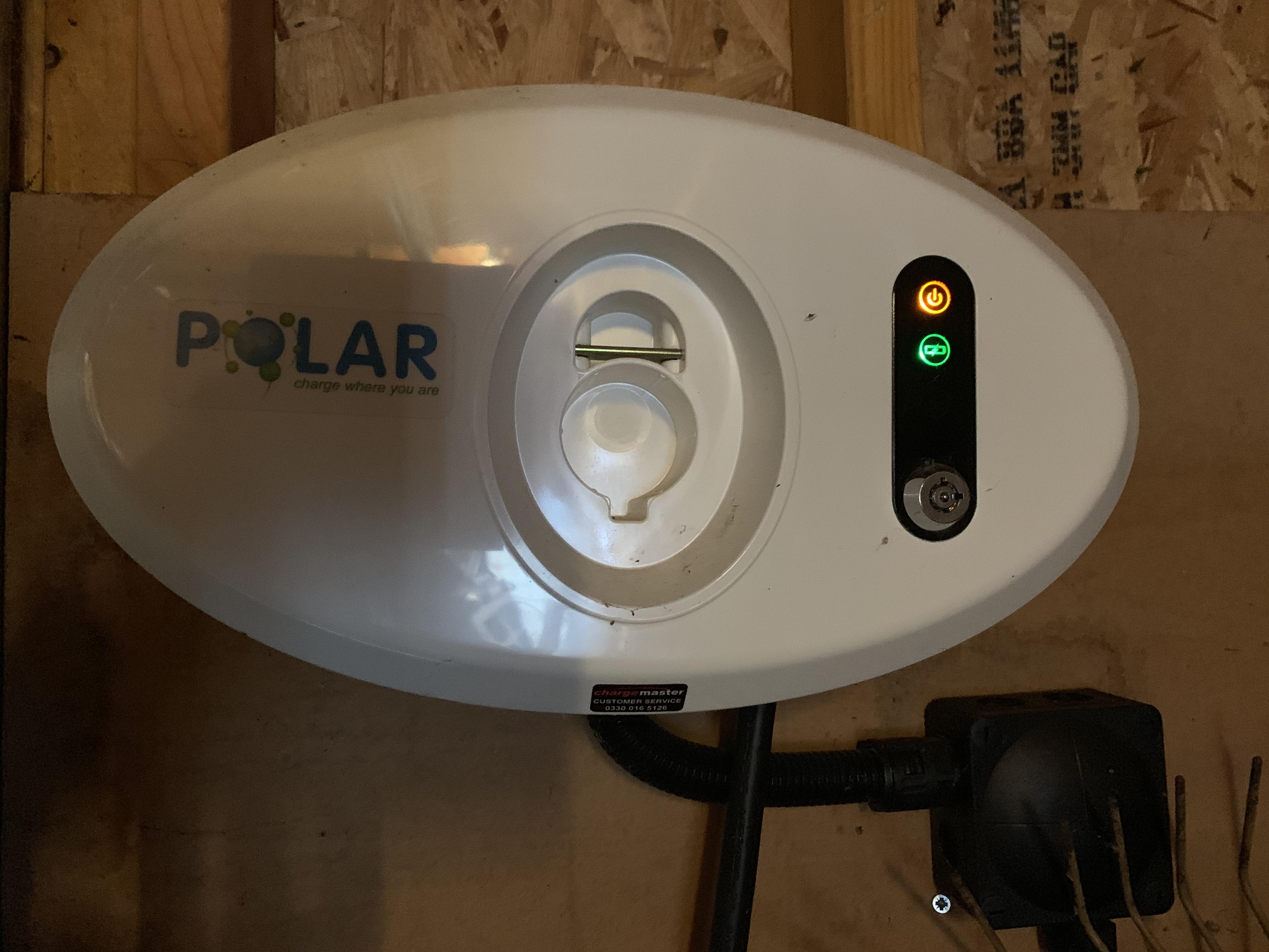

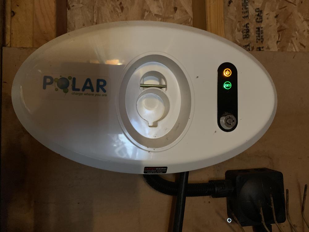

The heating can be reset to heat my TS overnight so no problem there but my car charger has no timer setting that I can see. It appears to be on a separate RCD so I could just flip it on when I go to bed and off again in the morning but a timer would be much more convenient as I’m bound to forget! Neither the car nor the charger has anything inbuilt to control the times. If it’s plugged in and on then it’s charging. The charger is in the garage and ideally the timer would be in the house next to the CU. Is that possible? I googled and consumer unit timers appear to be a thing?

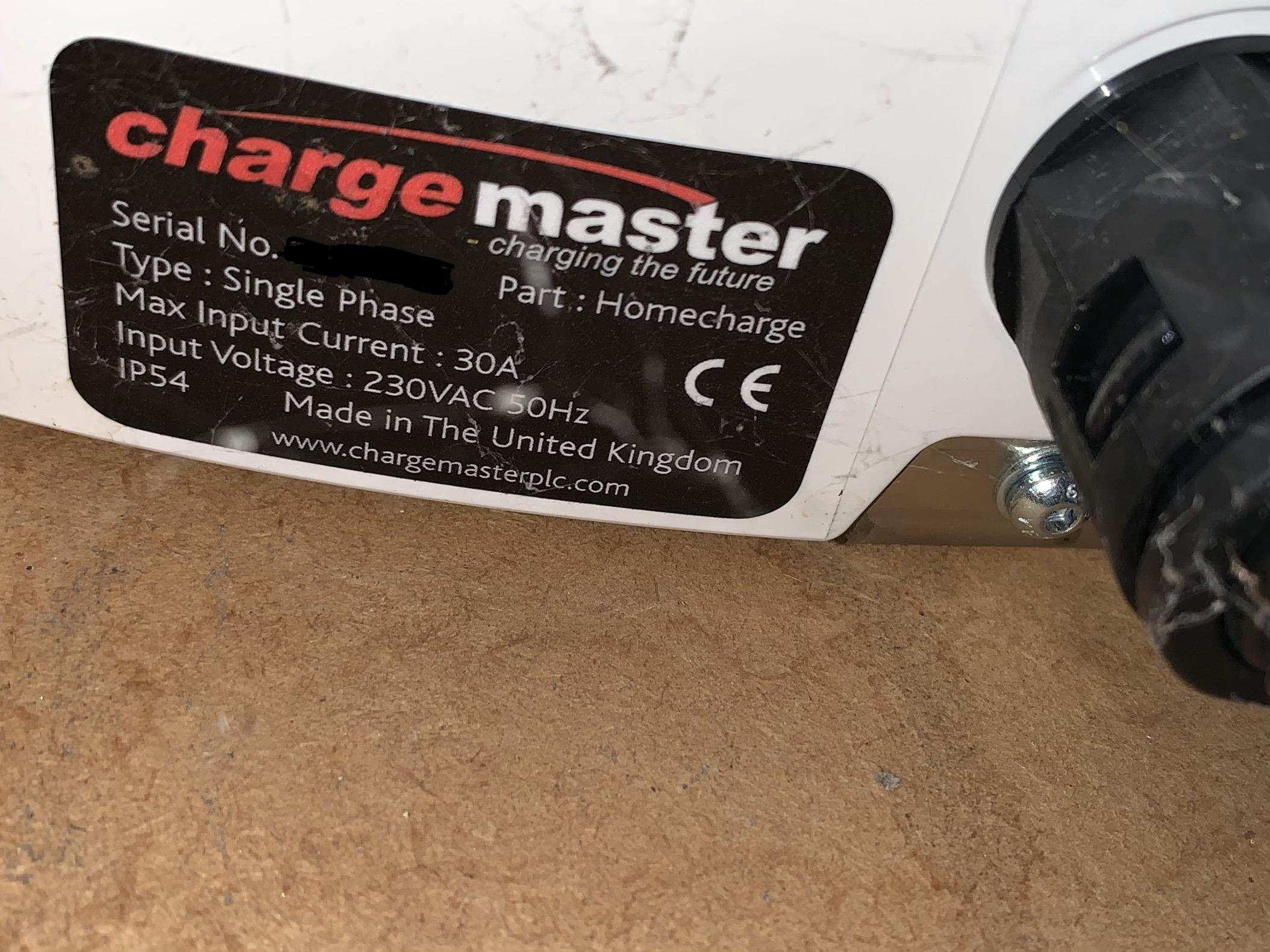

It's not easy to just fit a timer to a charge point, for a few reasons.  The first one is that the current being switched is pretty high (30 A in your case, could be up to 32 A) and that means using a time switch that's capable of handling that sort of current, and they aren't that common or cheap.  Another potential issue is the way that the car and charge point interact.  This varies from one EV to another, but some need the control pilot signal from the charge point to be active as soon as the lead is plugged in, so the car can adjust its onboard charger to the advertised current, before any charge timing can happen.  Other EVs will either just accept a charge point going live whilst plugged in and start charging, throw a charging error if this happens or refuse to charge (mine does the latter, it point blank refuses to charge if the charge point is run on a time switch).  In theory timed charging like this should work OK, but theory and practice are often different when it comes to the foibles of some EVs.
Was your charge point installed with an OLEV, or other, grant?  If it wasn't, then you may be able to get it swapped over for a smart charge point that offers scheduled, or tariff tracking, charging, (if your car will accept this).  All new charge points that are partially grant funded have to be smart, so they can all be scheduled etc.  In your case there there are two grants available, up to £500 from OLEV plus £300 from a Scottish grant initiative.
You can probably do a test to see how your car responds to the charge point going live after being plugged in, by turning off the circuit breaker (with the car unplugged), plugging the car in, waiting for maybe half an hour to be sure the car has fully shut down it's onboard systems, then switching  the circuit breaker on.  This is safe, as turning the power on initially won't draw a high current, as the charge point has to boot up and then do the control pilot handshake with the car, before it will turn on its internal contactor.  If the car charges OK doing this, then you have the option of adding a time switch and contactor to the circuit supplying the charge point.  This is probably the cheapest option overall.

Yes, there is, but it's not at all easy to break into this in a commercial charge point to do this.  My charge point is home made, and includes an enable port, that allows the control pilot connection to the car to correctly signal that charge power is, or is not, available.  The standard allows for this, and cars are supposed to stick to the protocol, but not all do.
My charge point has three modes, selectable via a three way switch, off, on and timed.  In the timed position the charge point signals to the car that charge power is available only during the E7 off peak period.  That worked perfectly with both the Prius Plug In and the BMW i3, but is completely ignored by the Tesla Model 3, as the Model 3 doesn't seem to follow the protocol, and refuses to wake up and start charging when the charge point signals that power is available.
The advantage of doing it the proper way, like this, is that the timer is only working with logic levels, not switching power, plus the charge point maintains the right control pilot signal, so the car should know that it is connected, but that no charge current is being advertised, so it should wait for an indefinite period for the control pilot to start advertising.
Yes it was done via a Scottish grant.
