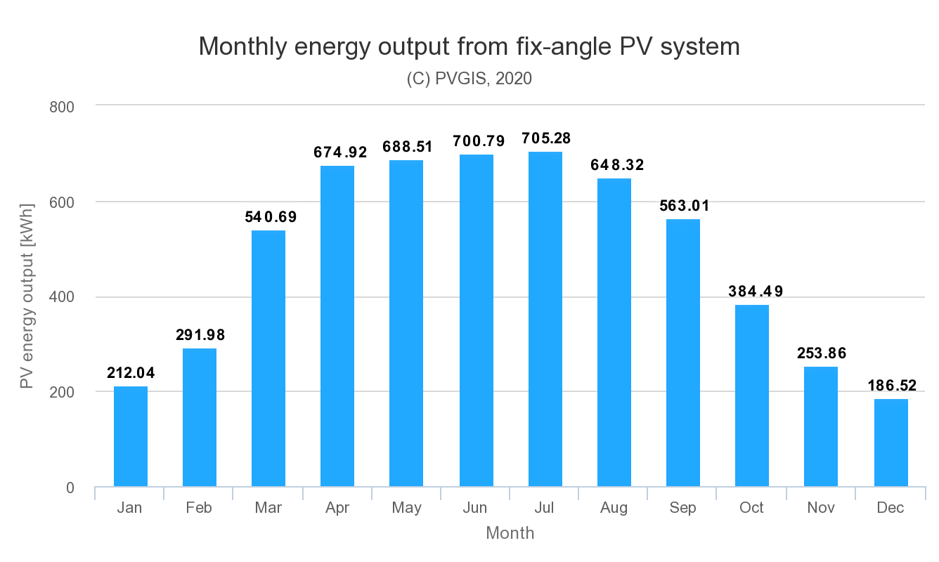

Ferdinand Posted February 8, 2020 Posted February 8, 2020 Does 12V lighting offer much benefit over the energy reduction of modern LEDs? Suspect that it is a bit like trying to use solar for heating - in the seasons you need it there is 90% less energy from sunlight.

Delicatedave Posted February 8, 2020 Author Posted February 8, 2020 8 minutes ago, Ferdinand said: Does 12V lighting offer much benefit over the energy reduction of modern LEDs? Suspect that it is a bit like trying to use solar for heating - in the seasons you need it there is 90% less energy from sunlight. It's not all about cost reduction now, who knows what cost electric will be in 5 years. But I think with the help of some storage it's do-able even in the UK. I mean I have solar lights down my drive which come on at around 6pm and most night stay on bright enough till 10pm. So about a 12 hour charge has last 4-5 hours on those cheap buggers.

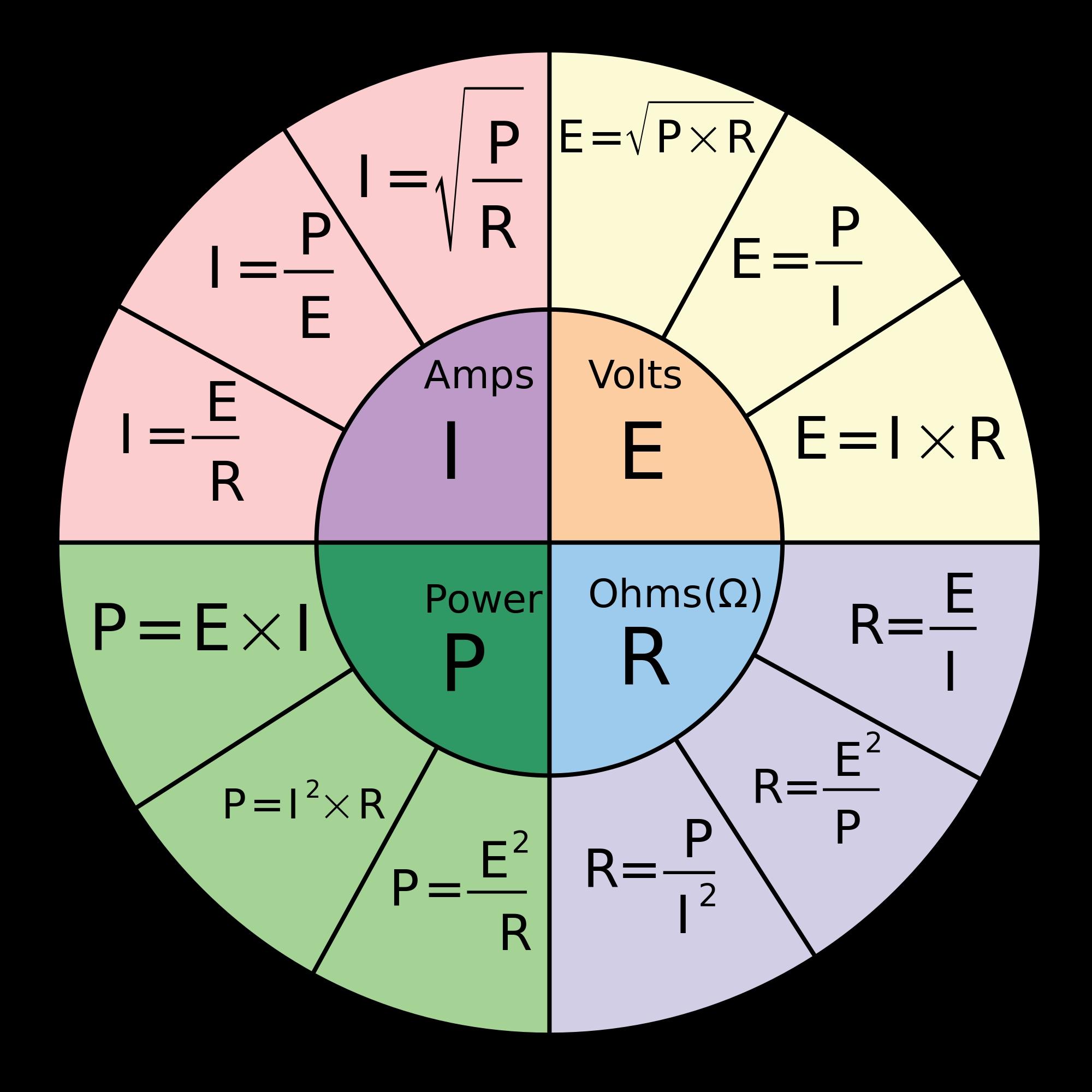

SteamyTea Posted February 8, 2020 Posted February 8, 2020 Welcome 17 minutes ago, Delicatedave said: low voltage systems Not really about voltage. It is about power, the watts, and energy, the joule, also known as the watt-hour. But it really comes down to how much you want to spend. 13 minutes ago, Delicatedave said: who knows what cost electric will be in 5 years Across the developed world this has been consistent at around the 5% of median household income, for decades. This is mainly to do with government interventions.
Jeremy Harris Posted February 8, 2020 Posted February 8, 2020 24 minutes ago, Delicatedave said: At the moment I'm thinking of either one big solar array on the roof - it gets sun all day. Or section off the house and use a panel each section but I've not looked into wind yet and even a large storage system like Tesla is not out the question - I as like ? Early days yet as I need to understand this more. Also need to find a way to heat both space & water unless I use electric from the grid. At the moment I'm looking a supplementing, ie warming the water before it gets to the washing machine & using fans to take warm air from the top of a room and push it places like the hall & bathroom. I think I can do all that with low voltage systems. It's really hard to do high power stuff, like warming water and space heating, at 12 V. Might be an idea to take a look at the Navitron forum ( https://www.navitron.org.uk/forum/ ), as there are a few there who are totally off grid, plus some who are partially off grid, and have a fair bit of experience of using low voltage DC. I'm pretty sure that most end up running systems at around 48 V, really to overcome the problems caused by cable power loss as much as anything else, but they may still be good source of expertise on low voltage stuff. 1
DamonHD Posted February 8, 2020 Posted February 8, 2020 FWIW I run some low-power stuff such as my server (and occasionally my laptop and a small amount of lighting) from a 12V off-grid system with ~500Wp of panels scattered round the front and back of the house at low level. It has some storage, nominally ~2kWh though ageing and in need of replacement. I also have a fairly big (>5kWp) grid-tied solar array and now a smallish AC-coupled battery. All heavy lifting including basically anything to do with heat is done from this part. Rgds Damon 1

Delicatedave Posted February 8, 2020 Author Posted February 8, 2020 16 minutes ago, SteamyTea said: Welcome Not really about voltage. It is about power, the watts, and energy, the joule, also known as the watt-hour. But it really comes down to how much you want to spend. Across the developed world this has been consistent at around the 5% of median household income, for decades. This is mainly to do with government interventions. Your point about 5% is subjective and I won't base my calculations on those thanks. If you take the UK as an example, it really depends on effort & luck with switching & the way you understand and use the energy. I'll give you 2 small examples of what I mean - Having just moved into this home my first action was to switch electric providers, the difference between the one I was with and the one I am is more than 30%. Secondly the people who lived here before us didn't know how electric storage heaters work, they even had wooden covers over them so they couldn't change the setting. How they were set loaded up maximum heat and let out maximum. The result being the had the equivalent of 12 electric ovens on full for 6 hours and the heat from that was eing sent into the rooms from about 8pm at night till exhausted, all though the night. Result being their electric bill was well over £2k a year, the home was still cold. My bill will be already half that and I aim to get it become £500. So you see no one will see only 5% unless they actively keep on top of it.
SteamyTea Posted February 8, 2020 Posted February 8, 2020 1 minute ago, Delicatedave said: So you see no one will see only 5% unless they actively keep on top of it. My point was in response to where electrical energy prices are heading, not individual usage. 15 years ago, when oil prices shot up, people where talking about $250/barrel being the new normal, but they are still at the long term average of ~$50/barrel. I have a similar sized place to you, and it comes in at about £600 a year with meter rental and VAT. I have (for my own reasons) not bothered to change supplier, though I do keep an eye on prices.
