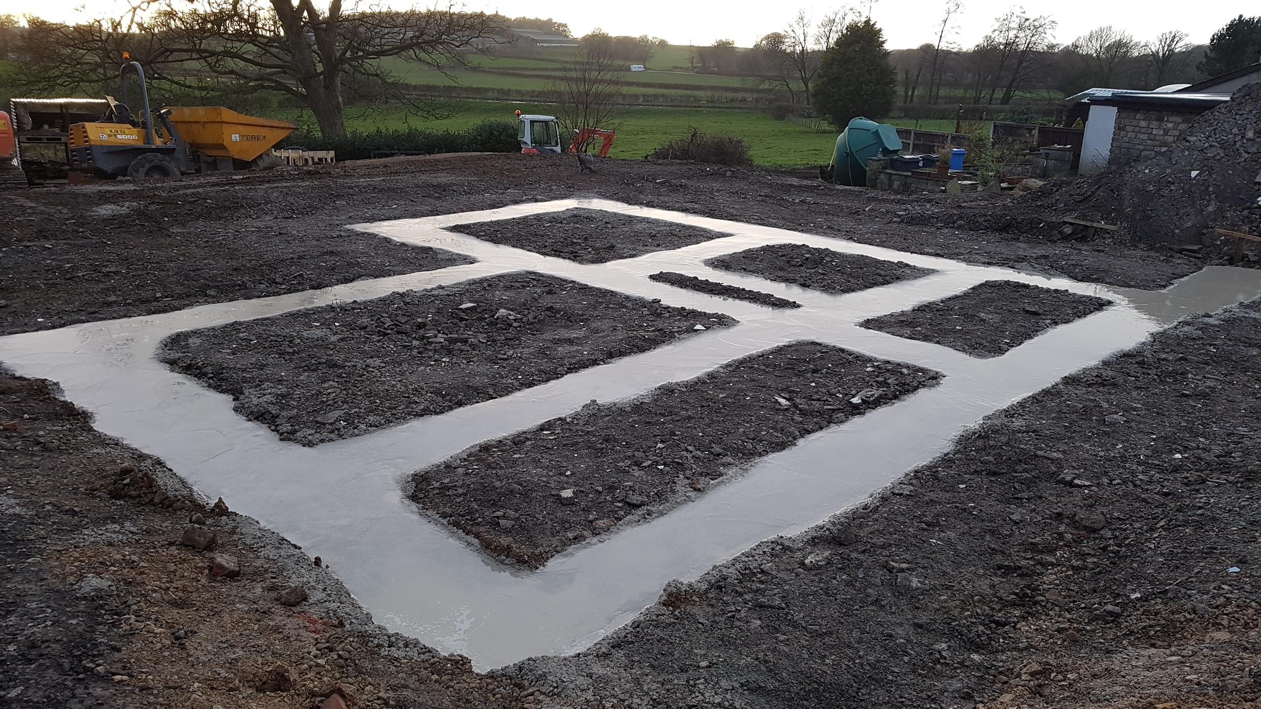

deuce22 Posted February 4, 2020 Share Posted February 4, 2020 Hi. I've only ever used strip foundations in the past, so I have know experience with the costs of a raft and pile foundations. I have been advised to use a raft foundation on this development, but was wondering what the difference in cost is between the two. What would be the preference for people on here. Thanks. Link to comment Share on other sites More sharing options...
Alex C Posted February 5, 2020 Share Posted February 5, 2020 You only tend to use piles when you have no alternative due to ground conditions as they are expensive. A lot of self builders on here have used highly insulated rafts and they work very well and are pretty straight forward. 1 Link to comment Share on other sites More sharing options...

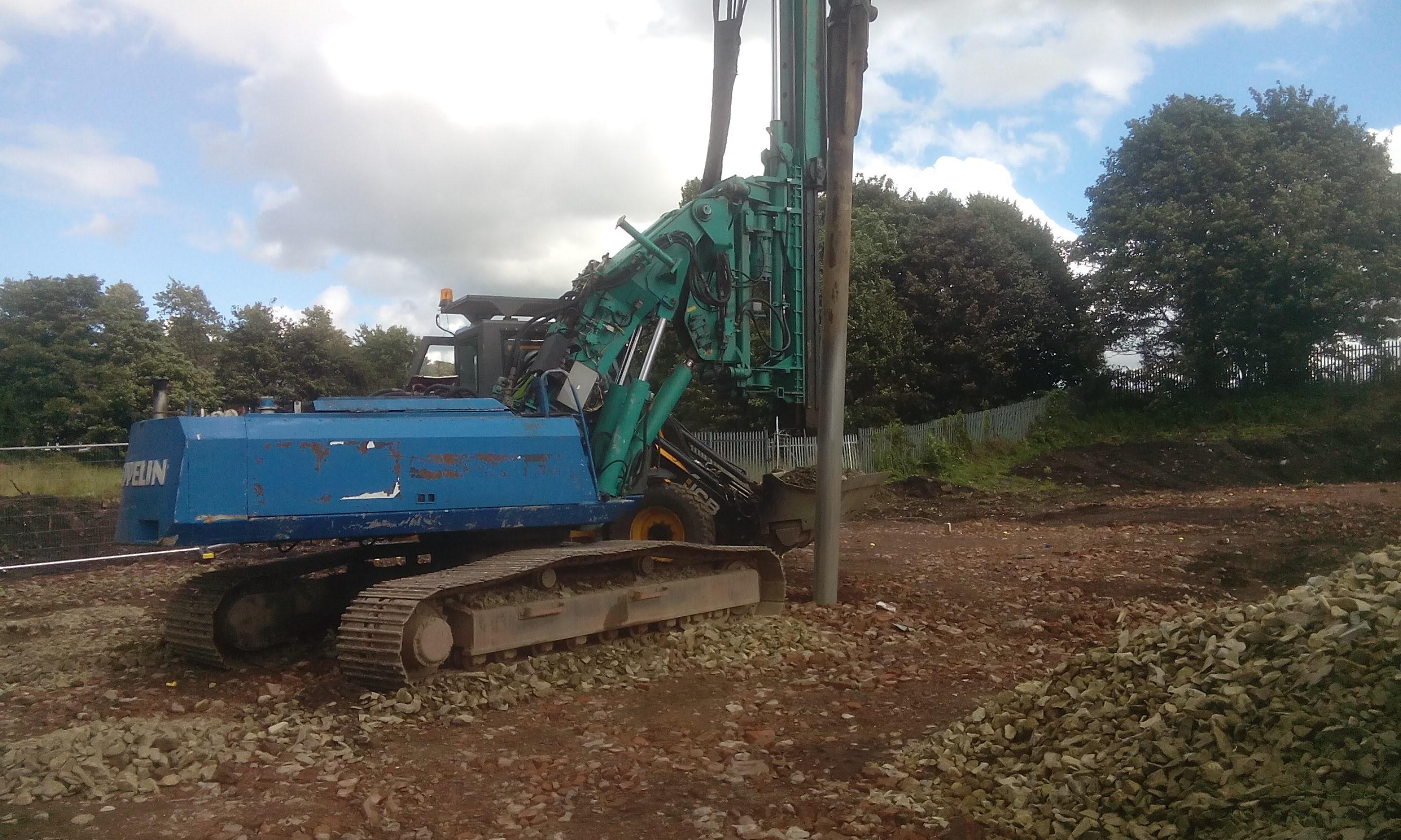

ToughButterCup Posted February 5, 2020 Share Posted February 5, 2020 64 piles , £7,000 ish. Needed because we are on Made Ground - 100 m m raft sitting on 300 mm of EPS Link to comment Share on other sites More sharing options...
deuce22 Posted February 5, 2020 Author Share Posted February 5, 2020 Thanks very much both. I'm just doing as much research now before I actually start construction. I've never dealt with piles before and assumed it was more expensive, but somebody said it is similar to a raft. Just so I understand, the 7k for the piles was to get you to a position to then pour concrete (similarly to a strip foundation)? I'll stick with the raft then and do some research into the different options. Thanks. Link to comment Share on other sites More sharing options...

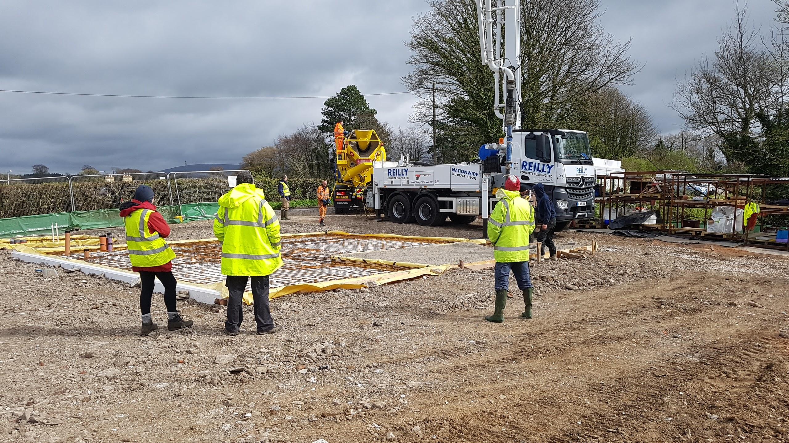

deuce22 Posted February 5, 2020 Author Share Posted February 5, 2020 I'm going to calculate costs on the different raft options available and then I'll have something to work from. Just so I understand the method properly, can somebody tell me if this is correct for a raft foundation. Shutter the area to be poured, install all the steel and then pour the first slab. Wait for that to cure and then pour the second slab. Lay DPC and insulation and then screed over the top for the finished floor. I have just spoken with Isoquick and they said that the insulated forms get laid and then the concrete gets poured. There is no need for shuttering and the concrete can be floated for the finished floor. Am I correct? Thanks. Link to comment Share on other sites More sharing options...
Gone West Posted February 5, 2020 Share Posted February 5, 2020 1 hour ago, deuce22 said: I have just spoken with Isoquick and they said that the insulated forms get laid and then the concrete gets poured. There is no need for shuttering and the concrete can be floated for the finished floor. Am I correct? We had the first Isoquick installation in England and it is a very simple system. It can only get spoilt if the concrete is badly laid. See my blog for details . I can't see any reason it can't be done DIY. 1 Link to comment Share on other sites More sharing options...
Alex C Posted February 5, 2020 Share Posted February 5, 2020 Take a look at my time lapse video that is on the mbc timber frame website. Shows pretty clearly one method of installing an insulated raft Link to comment Share on other sites More sharing options...
deuce22 Posted February 5, 2020 Author Share Posted February 5, 2020 Just had a look at your development Alex, it is great. I didn't see a video, but can see how it was done from the images. So the finished floor was the poured concrete? How thick was the concrete? Is your blog on this site Peter? Did either of you have a comparison of the costs between what you used and a standard raft to finish floor level? Thanks. Link to comment Share on other sites More sharing options...
Alex C Posted February 5, 2020 Share Posted February 5, 2020 (edited) This is the link to the video Finished floor was tiles over concrete. You are never going to get a very good standard of concrete floor from polishing a structural slab. Concrete thickness is dependant on the design of the slab and ground conditions. Mine is technically different to the majority as it is structural with more steel in and also thicker. I wanted decent insulation with no thermal bridge so didn't look in to cost for a 'normal' raft. Edited February 5, 2020 by Alex C 1 Link to comment Share on other sites More sharing options...
ToughButterCup Posted February 5, 2020 Share Posted February 5, 2020 64 piles , £7,000 ish. .... Yes @deuce22. We used piles that are sometimes called ground improvement columns. Your piling contractor will take responsibility for the design. Link to comment Share on other sites More sharing options...
