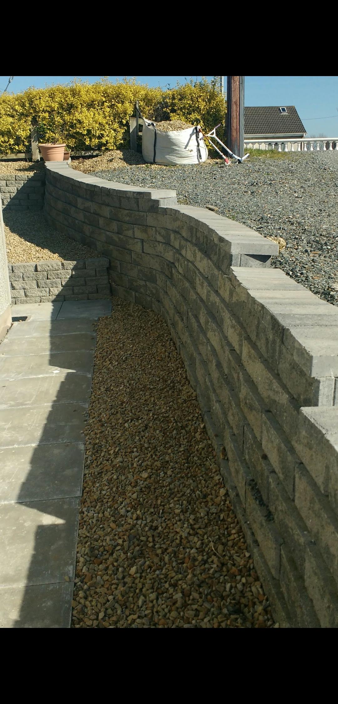

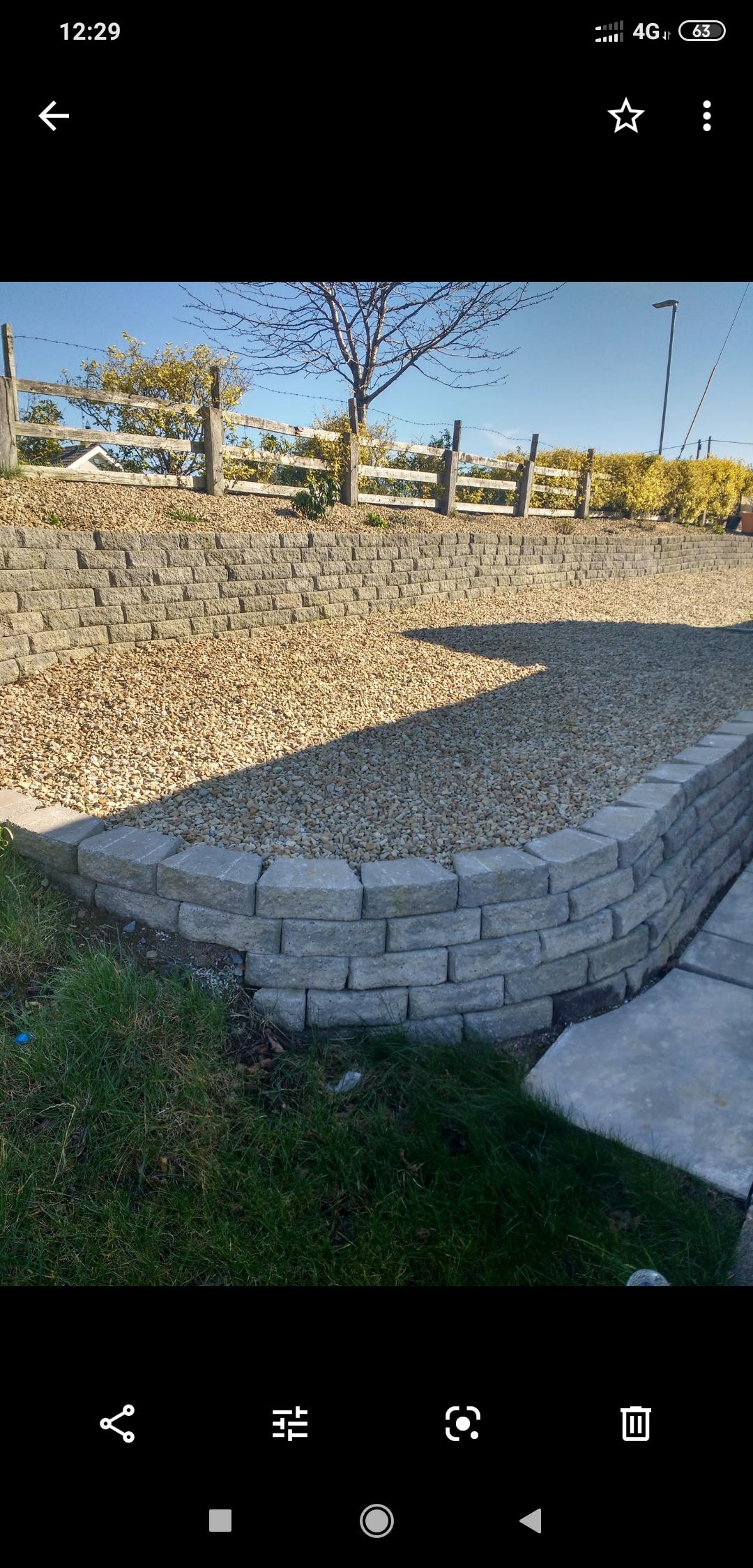

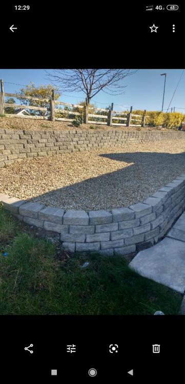

Declan52 Posted February 3, 2020 Share Posted February 3, 2020 I used these blocks for mine. They require no concrete base, a 200mm depth of well compacted hardcore is all mine sits on. They are as DIY as a retaining wall comes. https://ag.uk.com/retaining-wall/anchor-diamond/ Link to comment Share on other sites More sharing options...
Declan52 Posted February 3, 2020 Share Posted February 3, 2020 I have 2 different size blocks in my walls. The largest can go to 1.2m without any membrane but can go higher if needed using one. The smaller blocks can go to 0.9m and that's it. 2 Link to comment Share on other sites More sharing options...

Declan52 Posted February 3, 2020 Share Posted February 3, 2020 1 hour ago, PeterW said: @Declan52 what was the unit price or price / m2 for those ..? I think the larger block holding the driveway back was £25 sqm and the smaller £15sqm. But I got a very good deal as I also bought a lot of their paving blocks as well at the same time and I used the same company for my thermal blocks so had bought maybe £10k worth of materials from them. And that was 5 years ago and they are a local company to me. Link to comment Share on other sites More sharing options...
Temp Posted February 3, 2020 Share Posted February 3, 2020 Those look good @Declan52 I think your photos show off the blocks better than some of theirs. Link to comment Share on other sites More sharing options...
