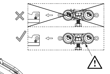

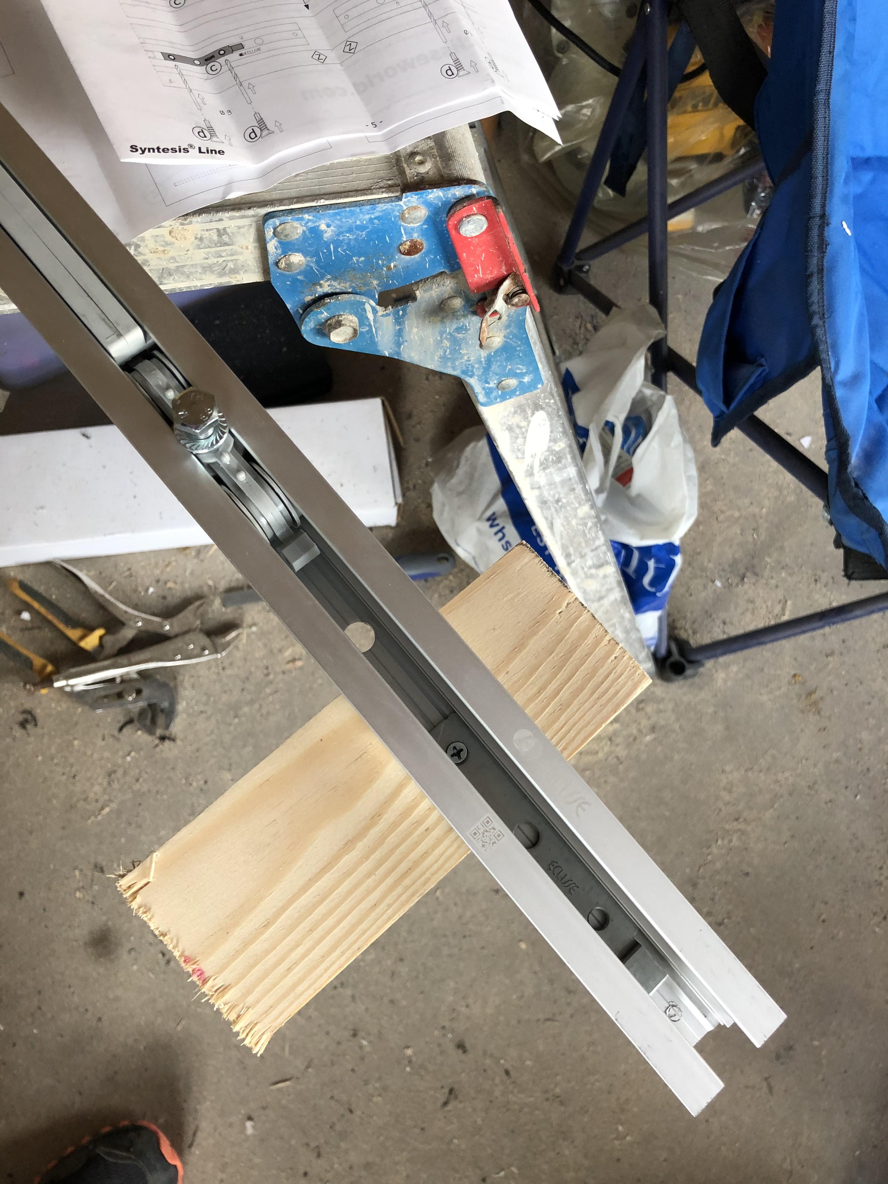

I found these instructions which appear similar but only have one white "catch" rather than two.
https://www.eclisse.co.uk/content/installation-accessories/603024103%20Scheda%20Rallenty%20BIAS.pdf
I think it might catch on the shaped end of "Item C".
Does your kit have the same or similar part?

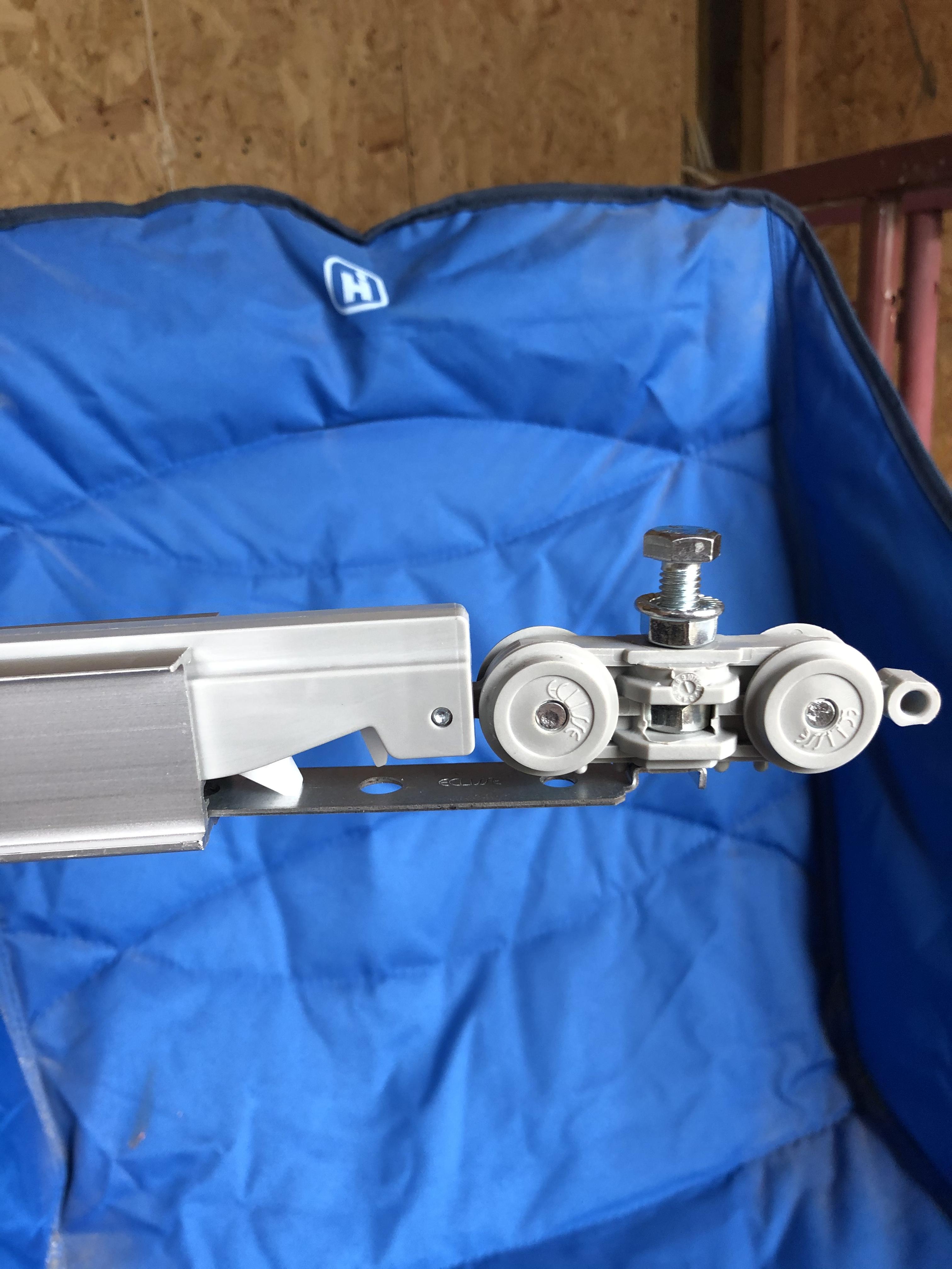

The C bit is in the top of the rail . Anti slam just goes over it . Something has to hit that white rocker to trigger the anti slam but there isn’t anything .

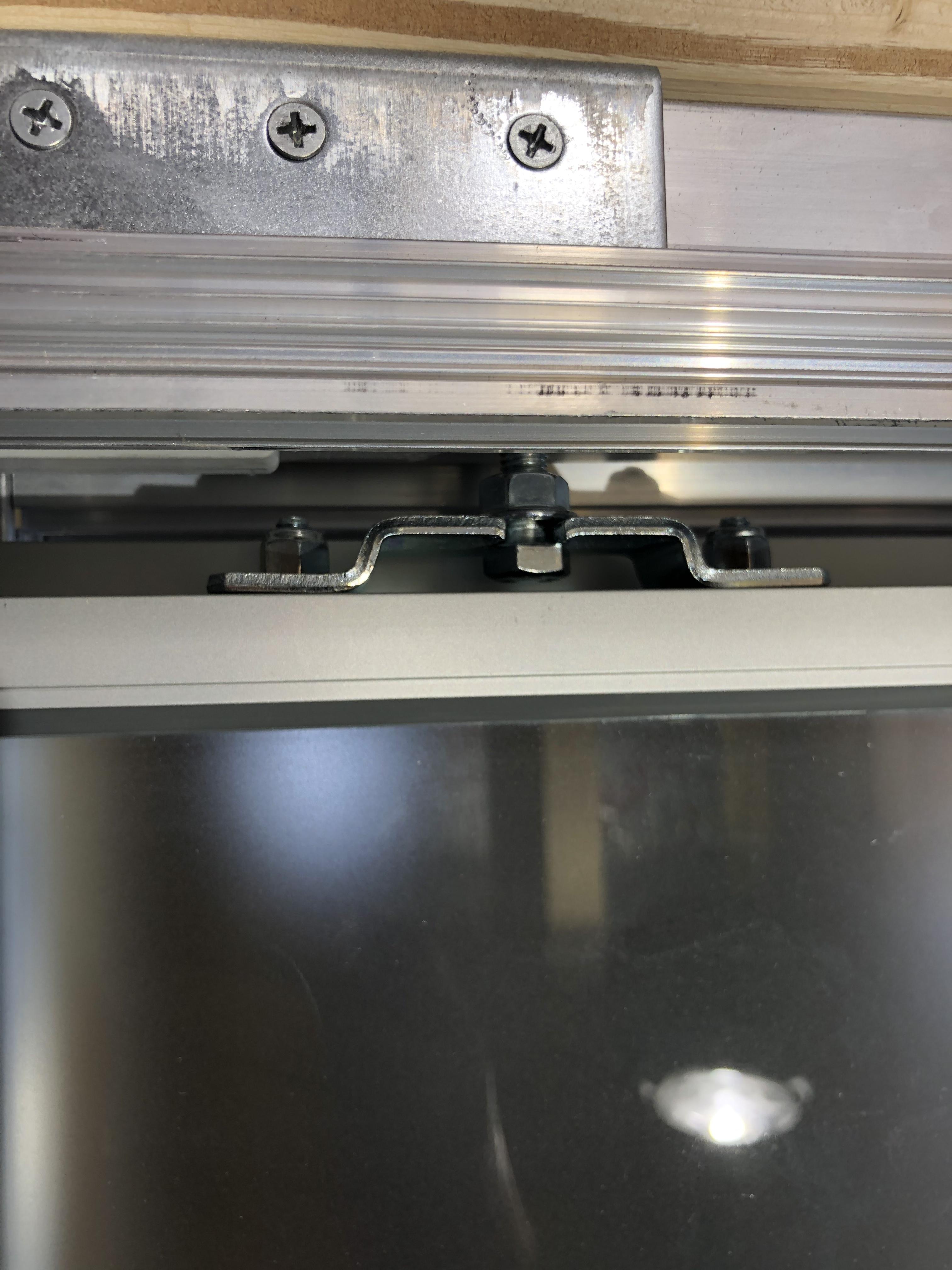

Posted (edited)
Assuming I’ve got this right ...
White anti slam has nothing to trigger it
Edited by pocster
Posted

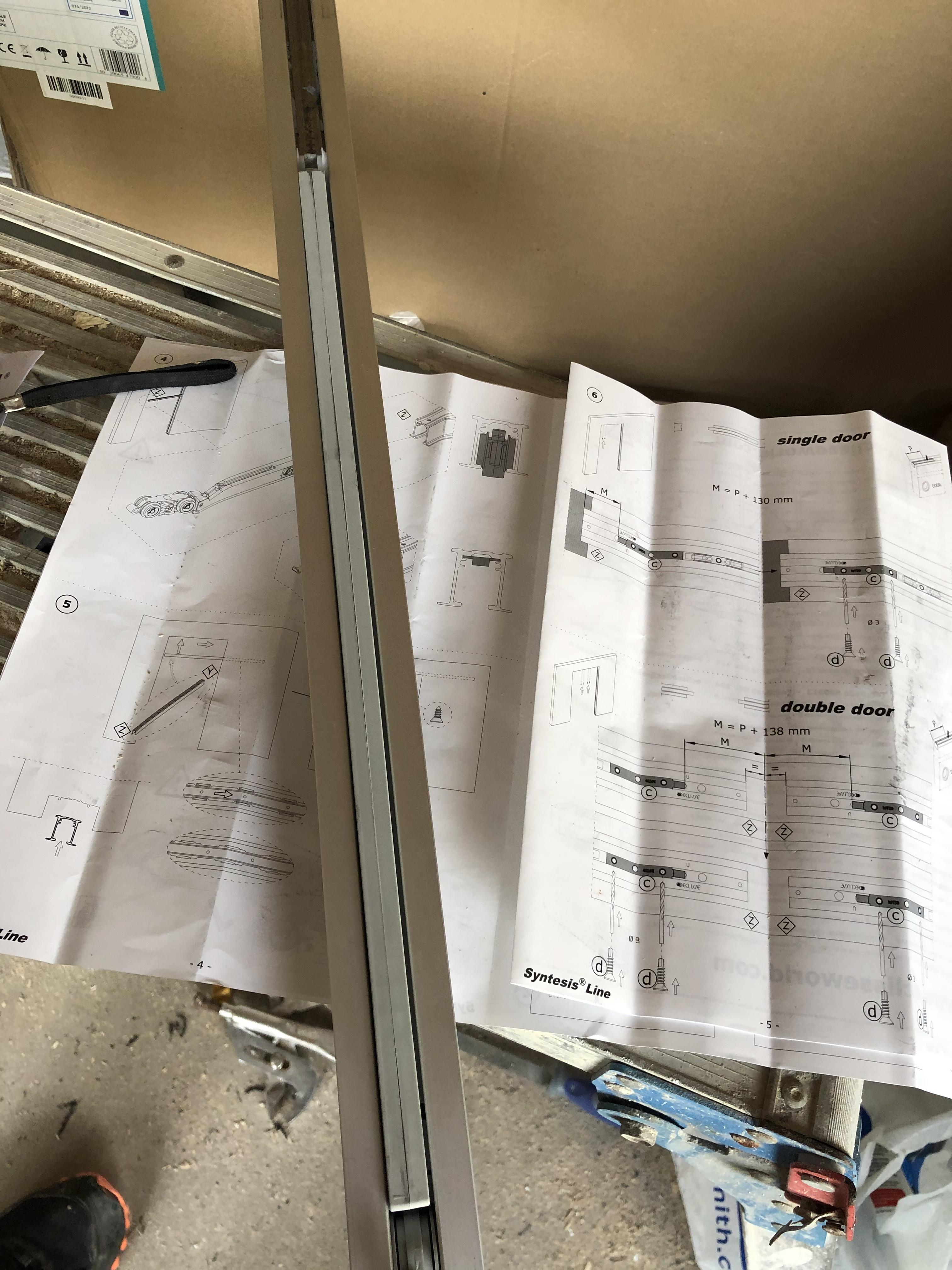

Ok . I decided to go AWOL ! I.e ignore instructions!! . I think I can get it working but it’s nothing like any of the instructions!!! . Not sure that’s classed as a good plan !!
Posted
Just had a quick look at the instructions.  Your runner with the nut and bolt is the wrong way up.  Not sure if it helps but probably best follow the instructions!
  • Like 1
Posted
Yet - I noticed that after posting . Correct way round now .
That part C lip bit is causing me confusion now . Screwed it to a piece of wood to test how all this supposedly works - gone back to the double anti slam just too see ...
Posted
Bet @Onoff just looks at anything work nicking in the background.
Eclisse instructions are terrible because they send so many variations. None of them are particularly clear even if you stick with one set . So I assume this is correct because it appears to work ! . Next step stick it in the frame and get that pig of a door on it .

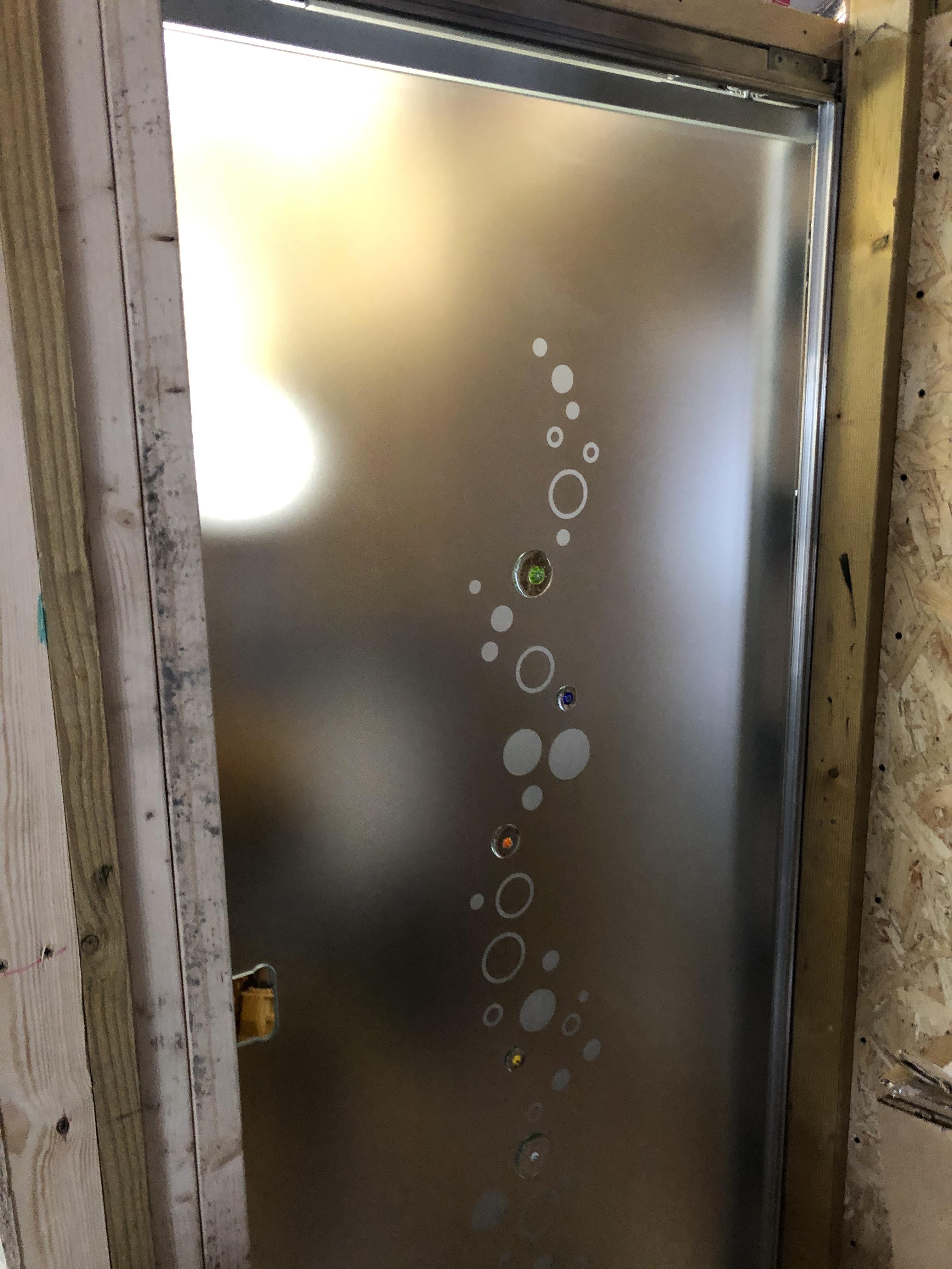

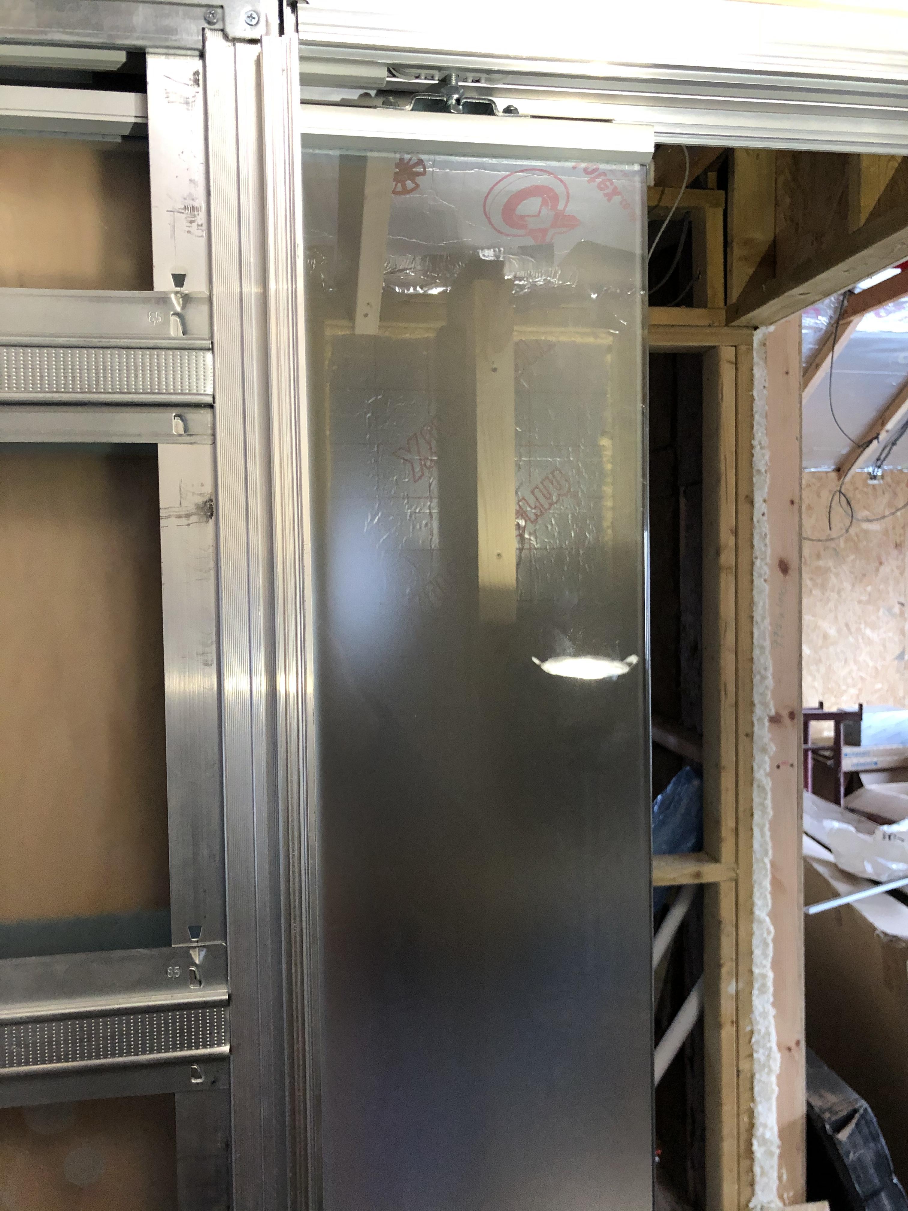

Posted
What a pig ! . Ok , I’m doing it on my own but ffs ! - with a 50kg door it’s a nightmare !
This is the single most thing I’ve sworn at on the entire build to date !
It’s on ‘loosely ‘ . Assuming I can adjust ( what minor adjustments there are ) it won’t be coming off again !!
So the little ‘rollers’ that you fit on the finished floor before installing the door can f right off . I’ll cut them in half and glue them in .
ffs !

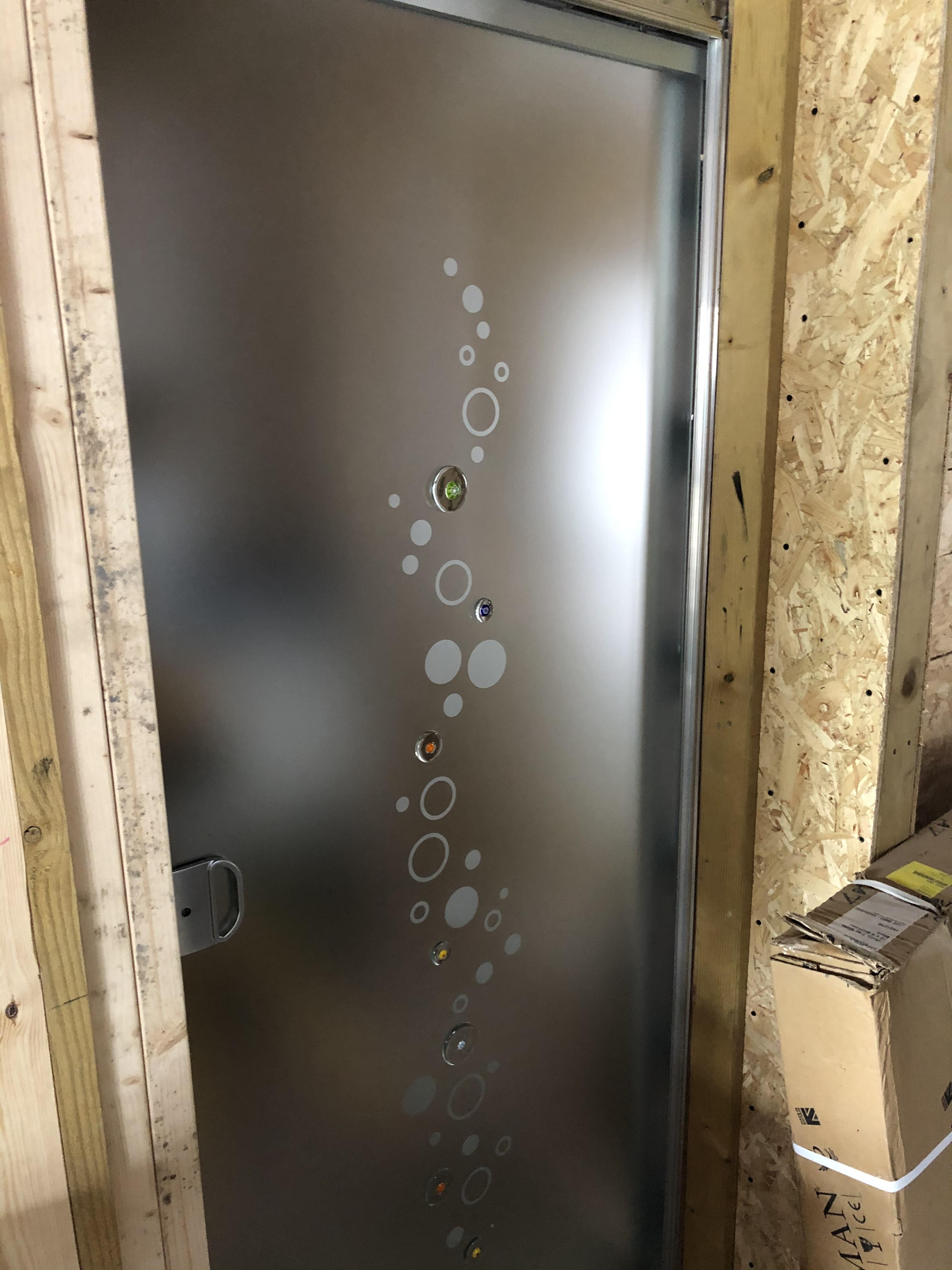

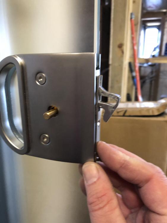

Posted

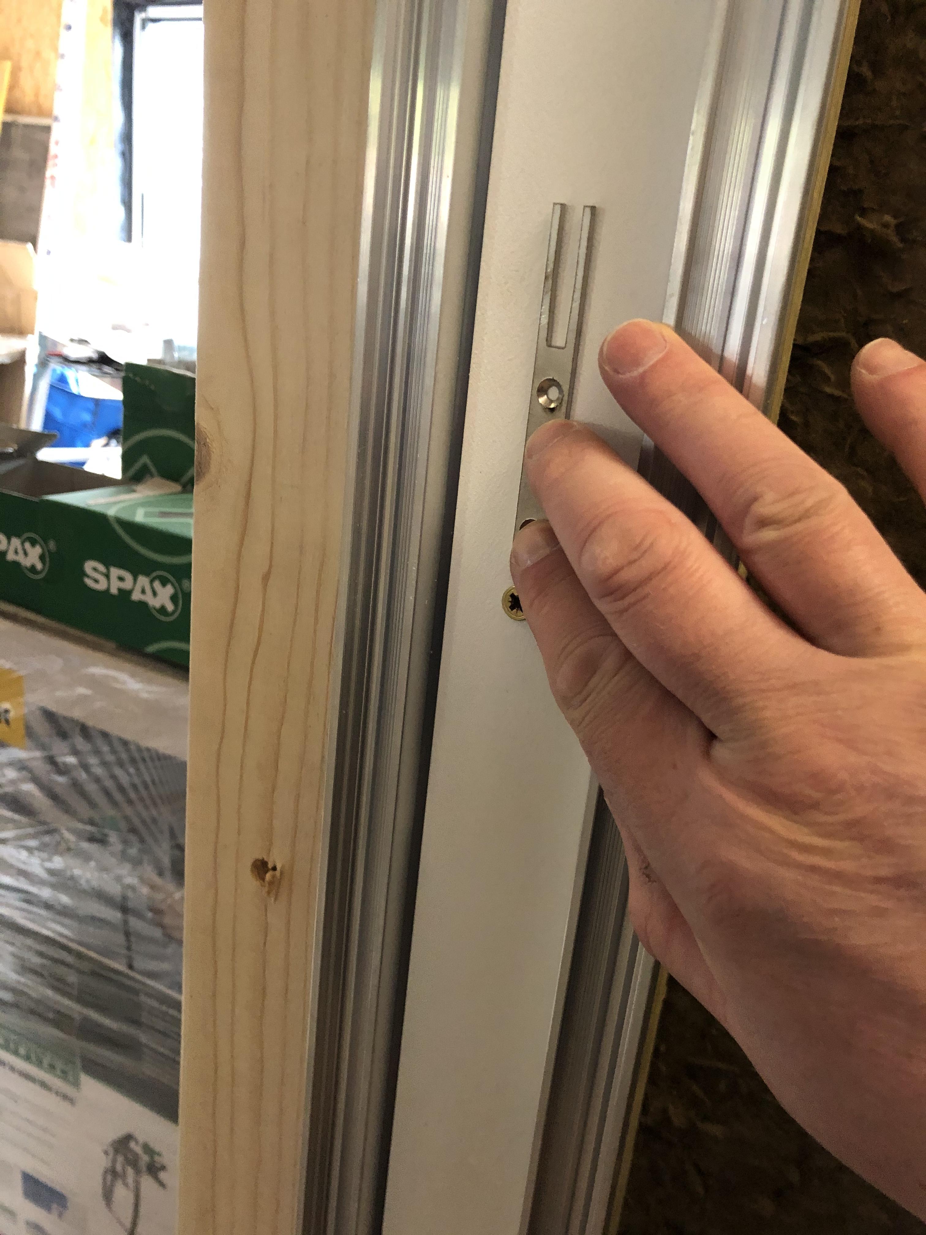

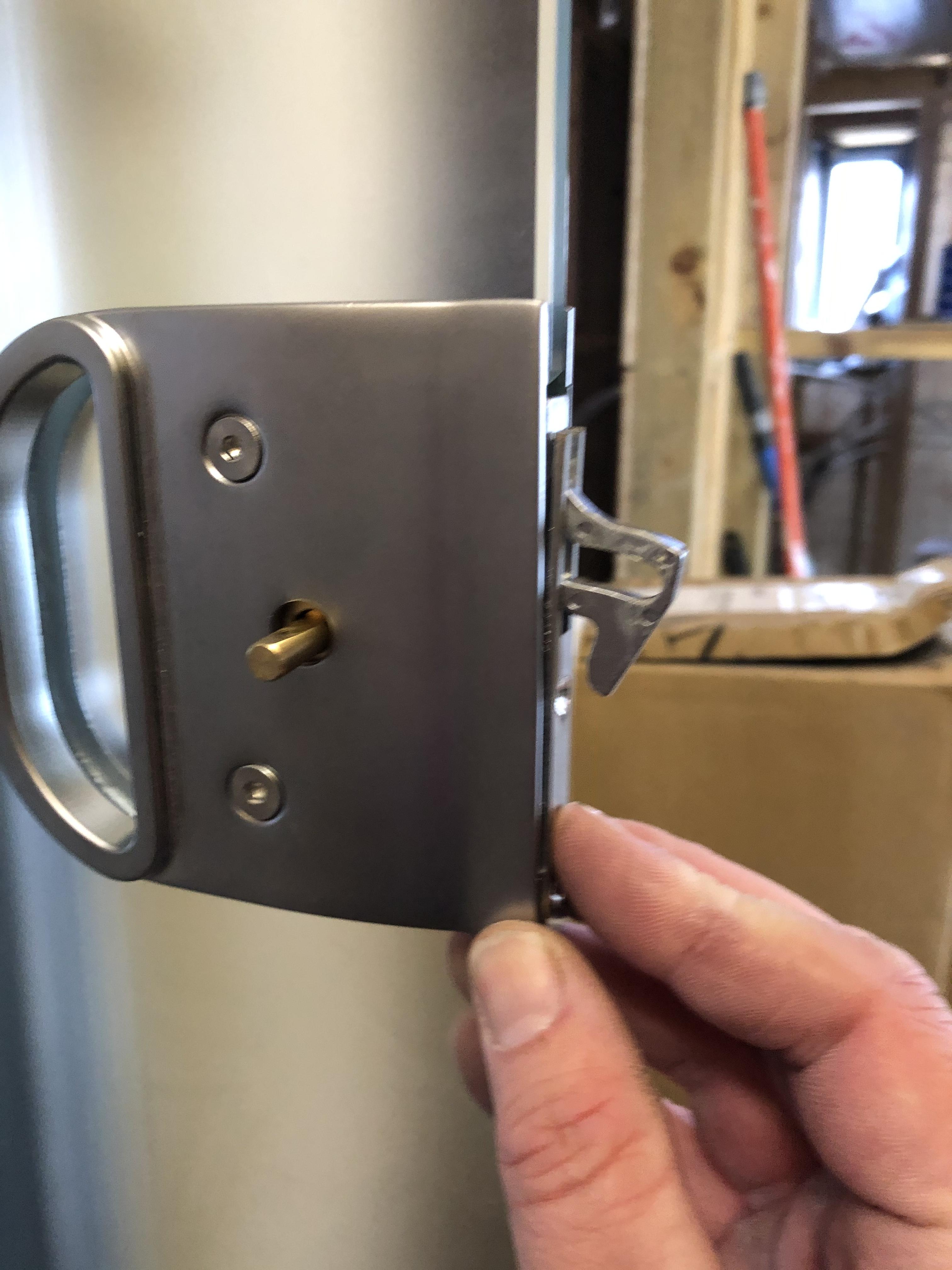

The next pita - the lock .

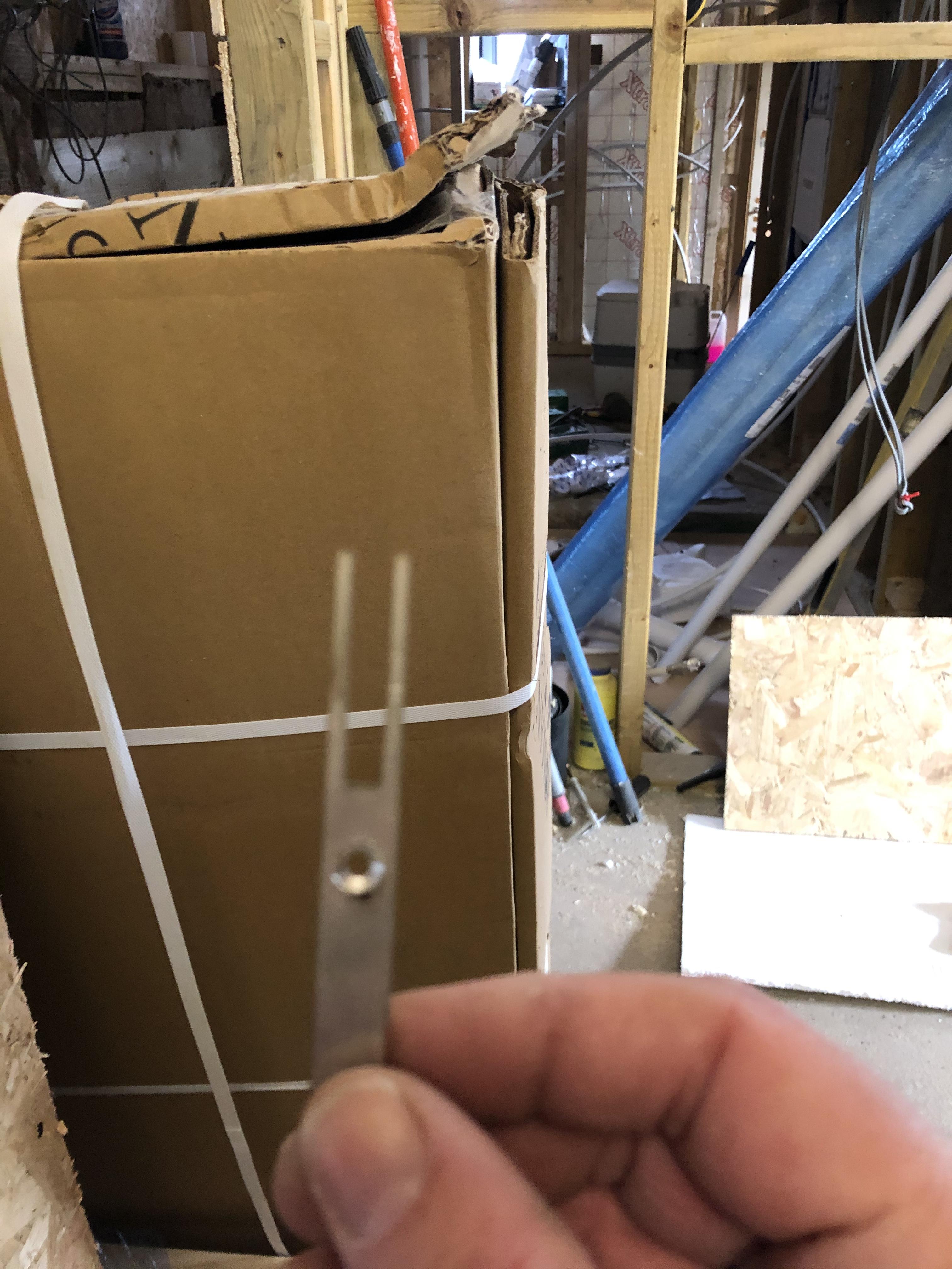

Can see how it works . Turn and ‘arm’ comes out and hitched into tuning fork shape . So I’ve got to cut a recess into the steel frame ?!? . I really don’t get the ‘design’ of this entire system . It’s not thought out - everything’s a pita !
Posted
8 minutes ago, pocster said:
Not sure of ‘nice way’ to cut into the steel . Multi tool blade won’t do it .
I feel you pain. I would have launched that thing down the bloody garden by now.
  • Like 1
Posted
It’s so ill conceived. Months ago I briefly looked at the instructions ( all 4 versions ) and thought f this !
But alas as I have to build a stud wall over the door frame in the ensuite I have to do it some day . SWMBO of course thinks it looks fab ! . It is smart - but installation designed by an idiot .
I can drill the steel - but that will look shite . Why they couldn’t supply a decent catch ( strike ? ) plate I don’t know . Then at least it could over up the hole that’s a mess . Not sure what to do on this . Better eBay see if there is a multi tool steel cutter blade . I hate things like this because you only have one chance . ? . I need like 5 attempts before I get it right .
Posted
I think a multi tool will be hard work, slipping ect. I would prob go for a series of small drill holes, going larger to link them, and then file it out...... Ok. Ok. I would bin the lock. Who needs that level of privacy

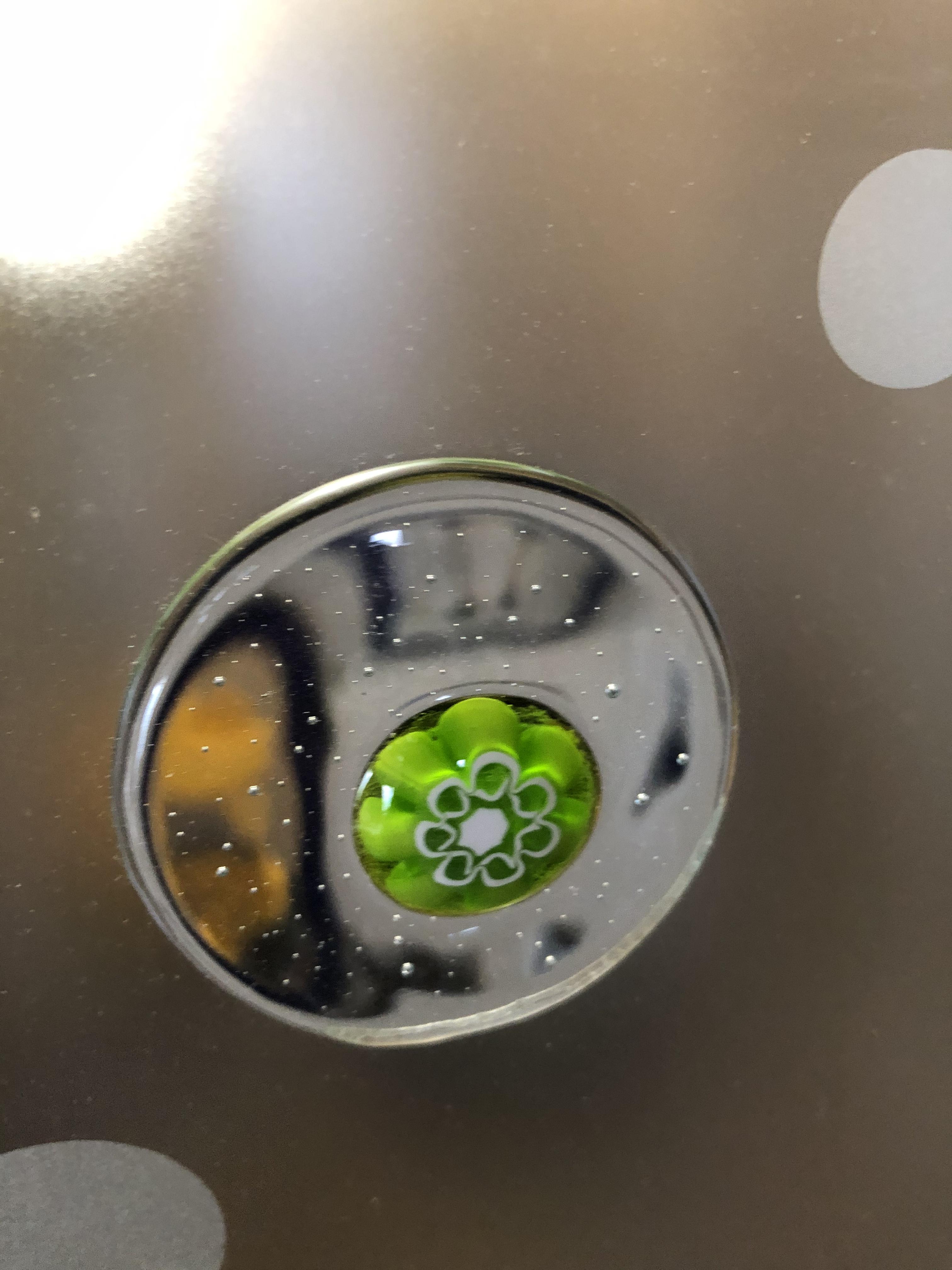

Posted
This is funny !
privacy glass yes . But if you look through the coloured bits you can see straight in ??????
f ing Eclisse !
Posted
£50 quid says once SWMBO realises this I’ll have to put a lock on the bedroom door anyway . What a joke !
