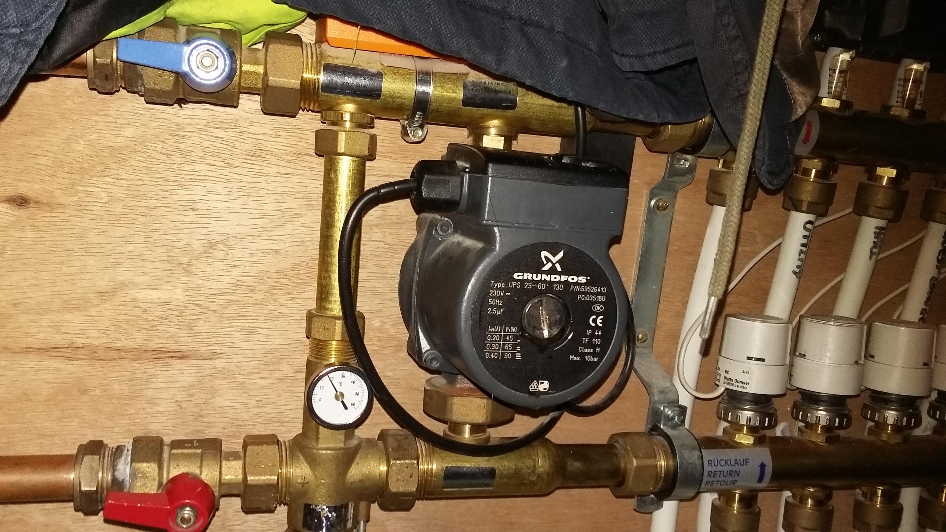

ProDave Posted January 30, 2020 Posted January 30, 2020 It's that time of year. My turn to have an UFH fault. This is in our old house, still owned by us and let. The problem is the downstairs UFH. Here is the manifold: Flow and return come in from the left (the red and blue service valves) from an oil fired boiler. The brass 3 port valve at the bottom left with the temperature gauge is the thermostatic blending valve. the adjusting handle is just out of shot of the bottom of the picture. All the electrical controls seem to be working, The UFH controller is calling for heat. The motorised valve (mounted next to the boiler) is opening and is calling for heat from the boiler which is firing. The UFH pump is circulating as it the main system boiler. the manifold actuators are opening and water circulating through the UFH pipes. What is not happening is significant flow from the boiler. the flow pipe into the red service valve is hot to the touch, but everything else on the manifold is cold to the touch and so is the return pipe from the blue service valve. The temperature gauge is reading 20. I am thinking it must be the blending valve is stuck in the "satisfied" position so not allowing heat in from the boiler and just recirculating what it has? does that sound like a plausible failure? If so does anyone recognise that blending valve? the whole system came from Continental in about 2004 so I will fire off an email to them to see if they can supply a new valve but suspect it may be available somewhere else cheaper. But I am seeking a sanity check from the forum before I continue the "fault find by substitution" method.

Triassic Posted January 31, 2020 Posted January 31, 2020 I was wondering, could it be an airlock? The blending valve simply allows cool return water to mix with the hot boiler water, so even if it’s stuck open or closed it shouldn’t stop hot water entering the system?

Carrerahill Posted January 31, 2020 Posted January 31, 2020 (edited) 3 minutes ago, Triassic said: The blending valve simply allows cool return water to mix with the hot boiler water, so even if it’s stuck open or closed it shouldn’t stop hot water entering the system? Of course it could, simply put yes, but it is basically an automatic valve which varies the flow from return or hot to create the ideal temp. If it was to completely isolate the hot intake side, which in the event that there was no demand and the manifolds were hot, it would just cycle the local water until demand dropped circuit temp. Edited January 31, 2020 by Carrerahill
Carrerahill Posted January 31, 2020 Posted January 31, 2020 (edited) Edit on my above post (2 up), it looks like you could drop the active parts from that valve by removing the collar under the temp adjustment without the need to remove anything from the system. Not only that, if you did need a new one, I would be tempted to leave the existing body and replace only the inner workings to save some faff. Edited January 31, 2020 by Carrerahill
ProDave Posted January 31, 2020 Author Posted January 31, 2020 12 minutes ago, Carrerahill said: Edit on my above post (2 up), it looks like you could drop the active parts from that valve by removing the collar under the temp adjustment without the need to remove anything from the system. Not only that, if you did need a new one, I would be tempted to leave the existing body and replace only the inner workings to save some faff. Thasnks. I am going back there shortly so that will be my first line of attack.

ProDave Posted January 31, 2020 Author Posted January 31, 2020 Right, I am back from my further diagnosis visit. I took the bottom adjusting knob assembly off. With that off, if I open the return service valve, water pours out. If I open the flow service valve, water just trickles out. To confirm it is not the actual flow pipe from the boiler blocked, I cracked open the nut on the output of the flow isolator and water poured out of that. So that seems to confirm it is not accepting hot water flow in even when stone cold. I could feel the cartridge but it's close to the floor and I could not see in and it was not inclined just to drop out so I aborted that. I can't remove the complete assembly and leave it, as annoyingly one of the service valves does not shut off completely so would leave a drip drip drip with nothing to plug the holes left by the blending valve. Off to order the replacement. Oh and Continental just replied. they no longer do that manifold, they can't supply spares, they suggest a new front end to the manifold with a different mixer and all the changes to the pipework to go with that. No thank you.

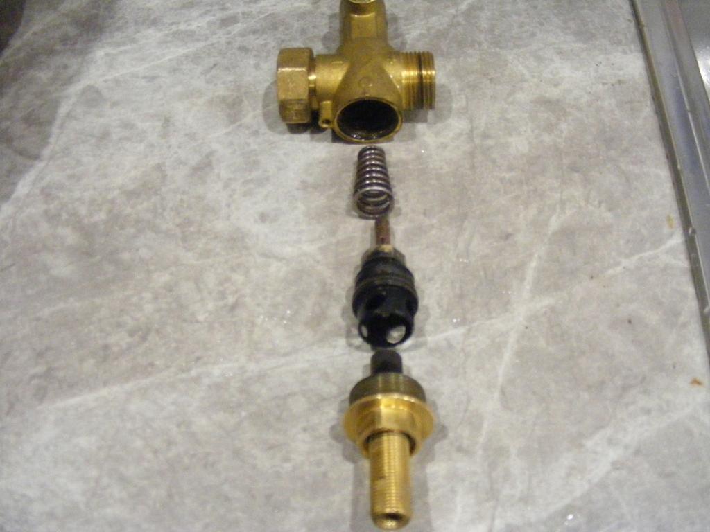

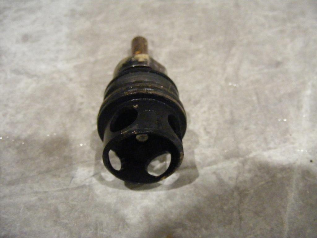

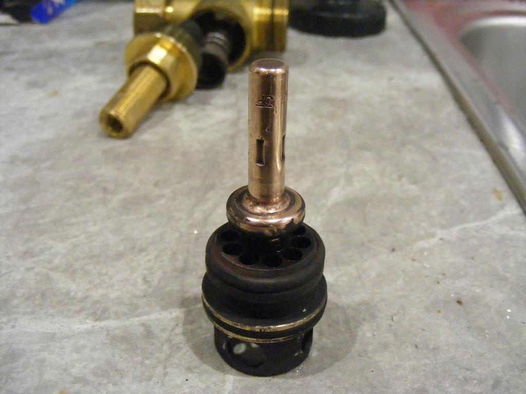

ProDave Posted February 13, 2020 Author Posted February 13, 2020 The new blending valve arrived today. So this afternoon I went and fitted it, and normal operation has been restored. Time to dismantle the old one for a post mortem. This is what comes out when you undo it: Note that it took some persuading to get the bits to come out. I believe the central, rather black looking bit is supposed to slide up and down against that conical shaped spring. Well it was well and truly stuck. This is that central bit, after a bit of a clean up In the recessed bit is a "pin" This is what the adjusting spindle pushes on. I believe this is the thermostatic bit and the pin is supposed to push out and expand as the cartridge heats up? Well the pin just pushes in with almost no resistance all the way and heating up the cartridge makes no difference, so safe to say it's broken. This is the top of the cartridge polished up a bit: I can't see how to dismantle it any further, i.e how you separate the copper looking cartridge from the brass body? Anyway stamped into the copper cartridge bit is a number around it's circumference: 0793 3F 123 As the number is around the circumference and all equally spaced, I might not have picked the right starting point for that number. Anyone recognise it? Any chance of getting a new cartridge to restore this one as a spare for the future?
Nickfromwales Posted February 13, 2020 Posted February 13, 2020 Put it in the bin dave, it lasted 16 years lol!!
