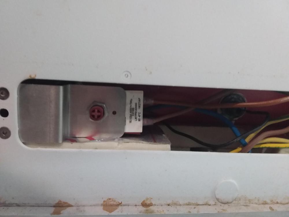

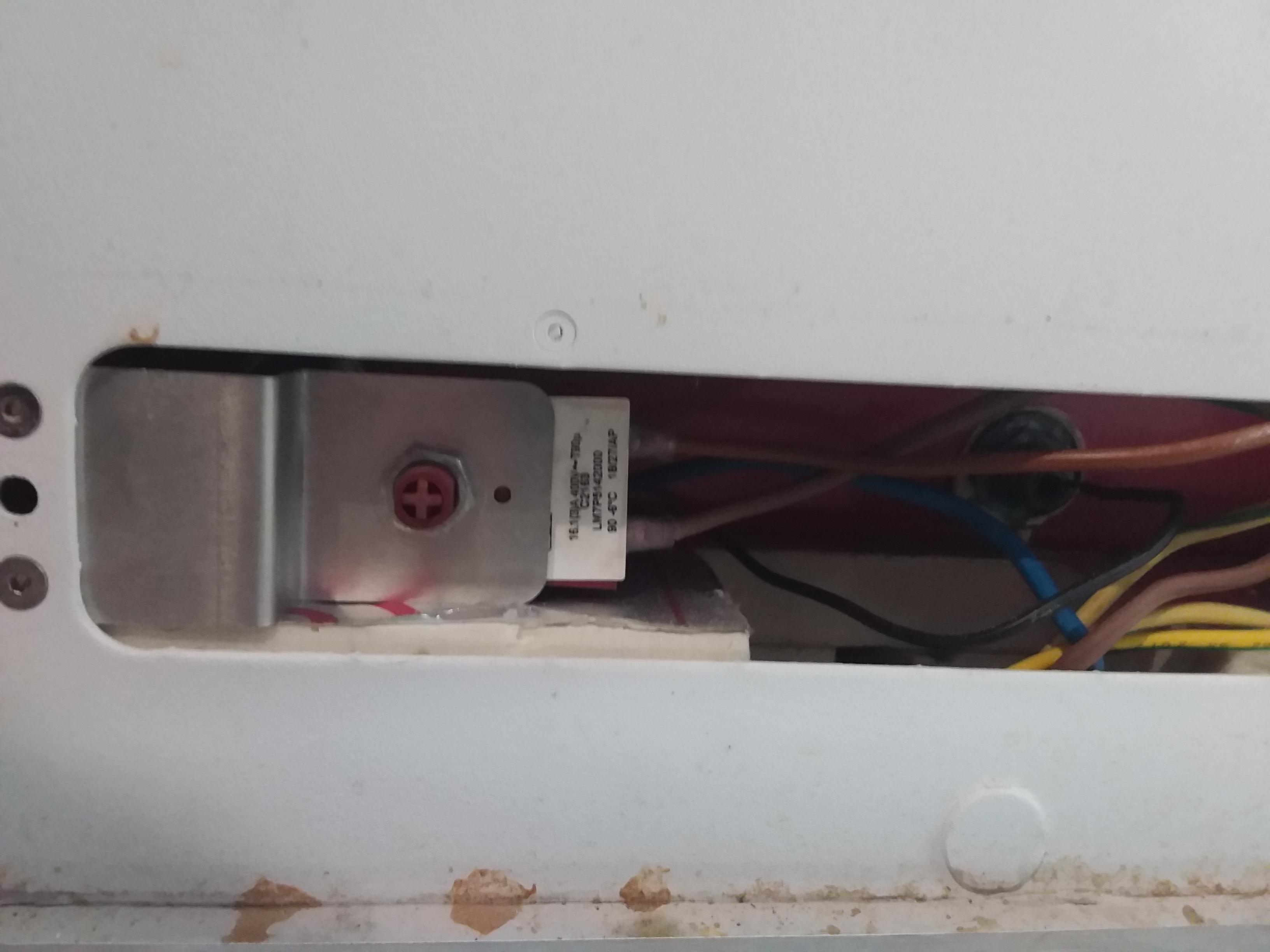

Sadly, they want the old one back. I have now taken the bottom plate off to reveal a few wires as shown.
The thing at the left of the photo is the over-temp cut-out.  If it's tripped then you can tell when you try to reset it by pushing it in, as it will click.  If it doesn't click it hasn't tripped, in which case it seems likely that the Finder contactor in the control box may have failed, as ours did.
I had the same problem with Sunamp wanting to send a complete replacement unit.  As ours is upstairs, and a complete nightmare to get up the stairs, I managed to persuade them to just send a replacement control box and sensor string, which seems to have done the job.
The brown reset button seems to be set, so that is one easy solution ticked off.
Whip the lid off the control box and see if your unit has a contactor with the maker's name Finder on it, towards the lower right corner.  If it has, then it's possible that's failed, as ours did.
