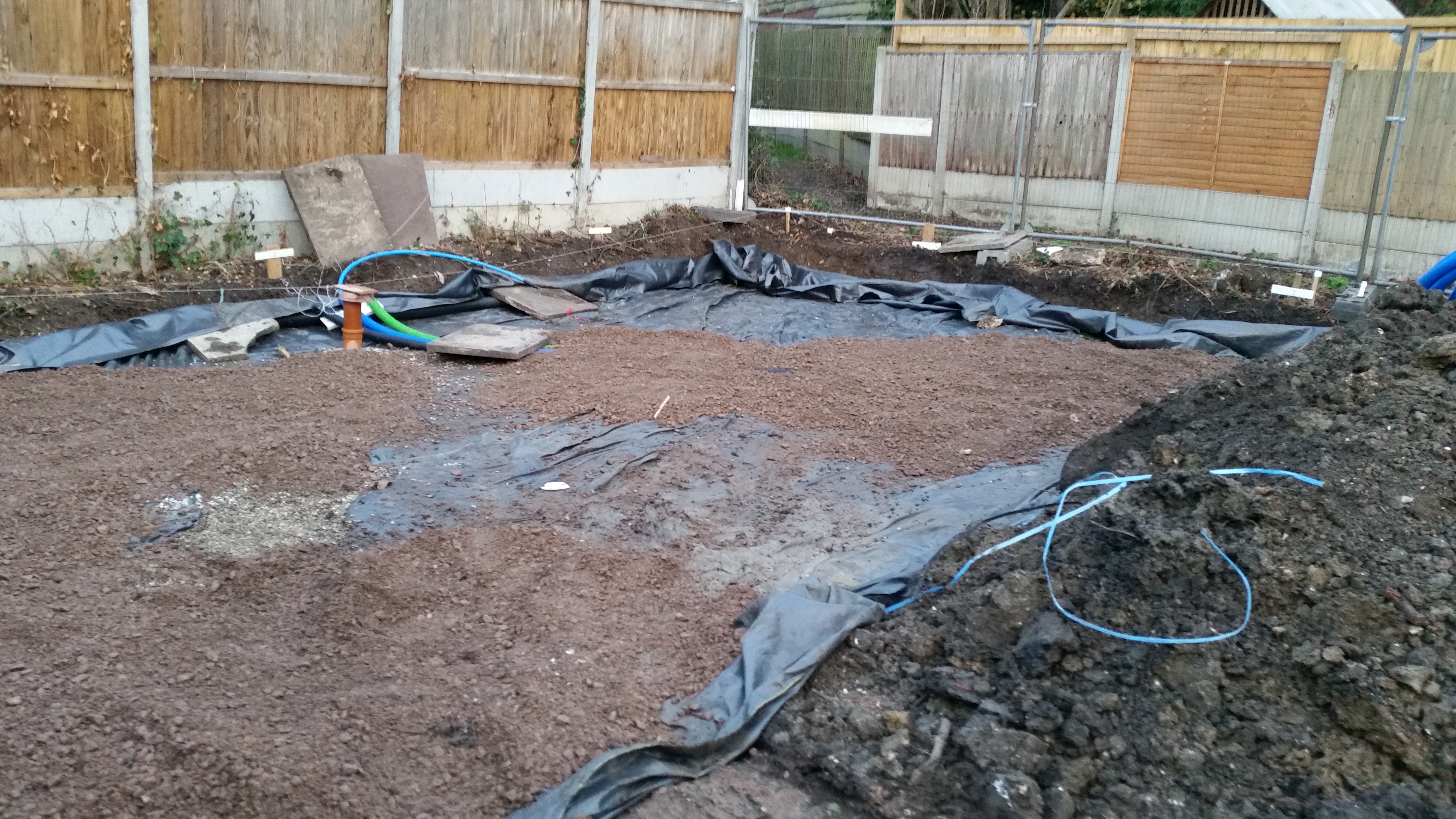

MikeSharp01 Posted November 7, 2016 Posted November 7, 2016 (edited) Wondering what the merits of putting water pipe (MDPE) in ducting is? Unless you lay the ducting reasonable straight getting 32mm MDPE through a 50mm duct would be difficult, so bigger needed, then there is the fact that MDPE is fine directly in the ground, and away from harmfull UV there as well. Got to lay the water to the phase one this week and am wondering if I should get some ducting or not? PS assuming that I should not put any connections under ground anyway. Edited November 7, 2016 by MikeSharp01

Onoff Posted November 7, 2016 Posted November 7, 2016 My reasoning was that my ground is full of flints and adjacent tree & bush roots. So added mechanical protection. I put 25mm MDPE down a 63mm OD duct around 40m run without a problem. The hardest but was getting a 1m bit of 22mm pipe insulation down between the duct and MDPE where it comes up through the suspended floor. Tapering the insulation with a craft knife and some silicon spray sorted it! But then what do I know, I even duct SWA just in case.....
Barney12 Posted November 7, 2016 Posted November 7, 2016 Either in a duct or in soft sand is standard. The theory being that the pipe "pulses" with water demand which could cause a stone, sharp object etc in the ground to slowly wear through the pipe. In practice I cant see it being that likely but for the price of a bit of ducting or a bulk bag of builders sand do you really want the grief? We ducted all our runs as the ground is full of rocks and stone.

MikeSharp01 Posted November 7, 2016 Author Posted November 7, 2016 On 07/11/2016 at 09:47, Onoff said: Interesting about the pipe pulsing! Expand Yes it is. I think I will get some duct as it's going through wacked base in places and will allow a new pipe to be fitted if ever needed. Ducting does have a risk in that of the pipe does burst the water will fill the duct and probably the house! Anyway thanks all, know exactly the way to go.
Declan52 Posted November 7, 2016 Posted November 7, 2016 Take out the rubber seal in the duct so if in the billion to one chance it bursts water can escape.
joe90 Posted November 7, 2016 Posted November 7, 2016 (edited) Perhaps seal the duct to the water pipe inside the house but leave it open in the meter box or whatever is at the other end. I did not use duct outside the house as we are in pure clay and even the electricity cable laid by SWEB left out the sand when they back filled the trench. Edited November 7, 2016 by joe90

MikeSharp01 Posted November 8, 2016 Author Posted November 8, 2016 Got it all done today, despite being very cold to start with but the sun came out and warmed up the water duct, pushed all 50M of 25mm pipe through the duct, no draw string needed just a good dolop of silicone grease, took about 20 mins of concentrated effort to get it through (protected the end with duck tape). Then I just laid the three ducts ( water, electricity & comms) in and started to cover with type 1, will finish Thursday and start with the polystyrene insulation and former for the slab.

volcane Posted April 30, 2017 Posted April 30, 2017 just resurrecting this thread; We are in the process of preparing the insulted foundation. Should the water pipe (MDPE) be contained within a duct as it runs through the slab? I know that that type of pipe is generally not run within any ducting.
MikeSharp01 Posted April 30, 2017 Author Posted April 30, 2017 As I understood it the pipe doesn't have to run in a duct but I thought that it has a bit more protection in a duct and if I ever have to replace it under the slab I could bu just pulling / pushing a new length along the duct.
Jeremy Harris Posted April 30, 2017 Posted April 30, 2017 I ran our water pipes in ducts under the slab, for two main reasons. The first are as Mike has said, the second is that sooner or later there is going to be a mains water connection available in the lane in front of the house, as the 80+ year old cast iron pipe that's there at the moment will have to be replaced before long. I wanted the option to have an easy mains water connection if it became available and if we felt it worthwhile, so I ran an extra 100mm blue duct to make pulling a pipe through a lot easier in the future. This duct also runs under the path around the house, and terminates close to the boundary, so a short trench and a bit of new pipe and we could be easily connected at probably the minimum connection charge. The duct is sealed at both ends, and has a foam plug in the house end to prevent heat loss.
