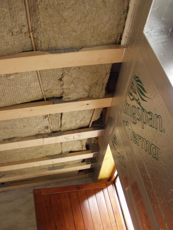

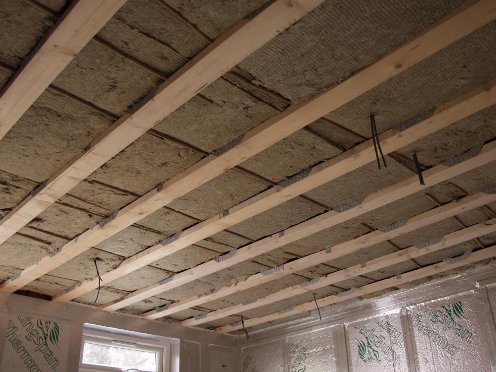

Hi Peter.. I just want to be super-sure on this fluff/cables proximity: could you explain what you mean by this ^ post? (I prefer to understand xyz before doing it).
I seem to recall 'derating' mentioned before.. but it was complicated.
Is there a way to simplify the answer for me (bar 'yes- just stuff it in b*tch!!') ?

De-rating cables is when you lower their current carrying capacity as if you wrap a cable in insulation it warms up quicker and therefore as power / amps / heat are directly related you say instead of a wire in insulation carrying say 25 amps, it should only carry a max of 20 amps.
This de-rating is only really relevant when it is for long lengths of cable as they cannot lose this heat elsewhere. As what you are talking about here is a short length of insulation, then it is not relevant.

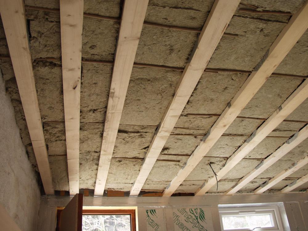

But aren't these cables though 'long lengths' ? they're coming from all over the extention > to this congregation area above the door > to all bunch together for the exit thru 2 ft wall.. into main house.
I can understand that I'm not 'wrapping them in insulation' (I assume a sheath situation.. but can't picture it).. or.. am I not doing exactly this if I stuff me 'oles guvnor?
It’s not an issue ... if the whole length was wrapped in insulation then you have to de-rate the cable but you’re not.
Fill the gaps with insulation ...
Ok I think I understand.. you mean my cables onwards from this stuffed 'junction area' are mostly either sitting ontop the rockwool, clipped to the side of vertical studs with a bit of gap before the rigid PIR (mostly so on the verticals so,).. & even if this congregation/ junction area above door has all the cables squished between joist & the rockwool.. as its only for this small 3ft section, its inconsequential.
Am I getting the gist correct here? I'm not quite understanding "wrapped" whether it means an insulation 'sheath' (which not one inch of any cable has anywhere) around a cable, or a full surrounding 'envelope' of rockwool, or whether a combination of rockwool on one side & joist on the other designates it being "wrapped".
43 minutes ago, PeterW said:
Correct ..! It is about the fibre / thermal insulation not the electrical insulation
Ok Peter thanks- will do.
