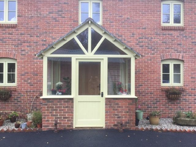

Carrerahill Posted January 16, 2020 Share Posted January 16, 2020 (edited) 13 minutes ago, vivienz said: I've always known that our site is exposed to strong south-westerly conditions but the storms and seemingly constant rain since October have emphasised just how much, and water regularly gets driven under our front door on the south face of the building. I need to get some rain protection in place, at the very least a canopy and have seen my heart's desire on pinterest. Of course, it looks expensive. Can anyone give me some start points on where to source one of these? It looks sturdy enough to withstand the winds that come sweeping across. I don't think a polycarbonate one will look nice or be up to the job and I'm not confident of anything reliant on a couple of fixing points as it will need to be over 2m wide. Any pointers welcome. Our steel chap makes these as customs. We have been involved in the structural design of canopies for commercial properties and I did a lit one, see attached, this is one of ours, I even have photos of it during fabrication somewhere. This one had the impression of it going through the glass in a complete 360° section. Photo is just a grab from Street View. Edited January 16, 2020 by Carrerahill Link to comment Share on other sites More sharing options...
vivienz Posted January 16, 2020 Author Share Posted January 16, 2020 Oooo! That's lovely! Okay, so I'm probably best contacting a fabricator. Will do and will report back. Thanks! Link to comment Share on other sites More sharing options...

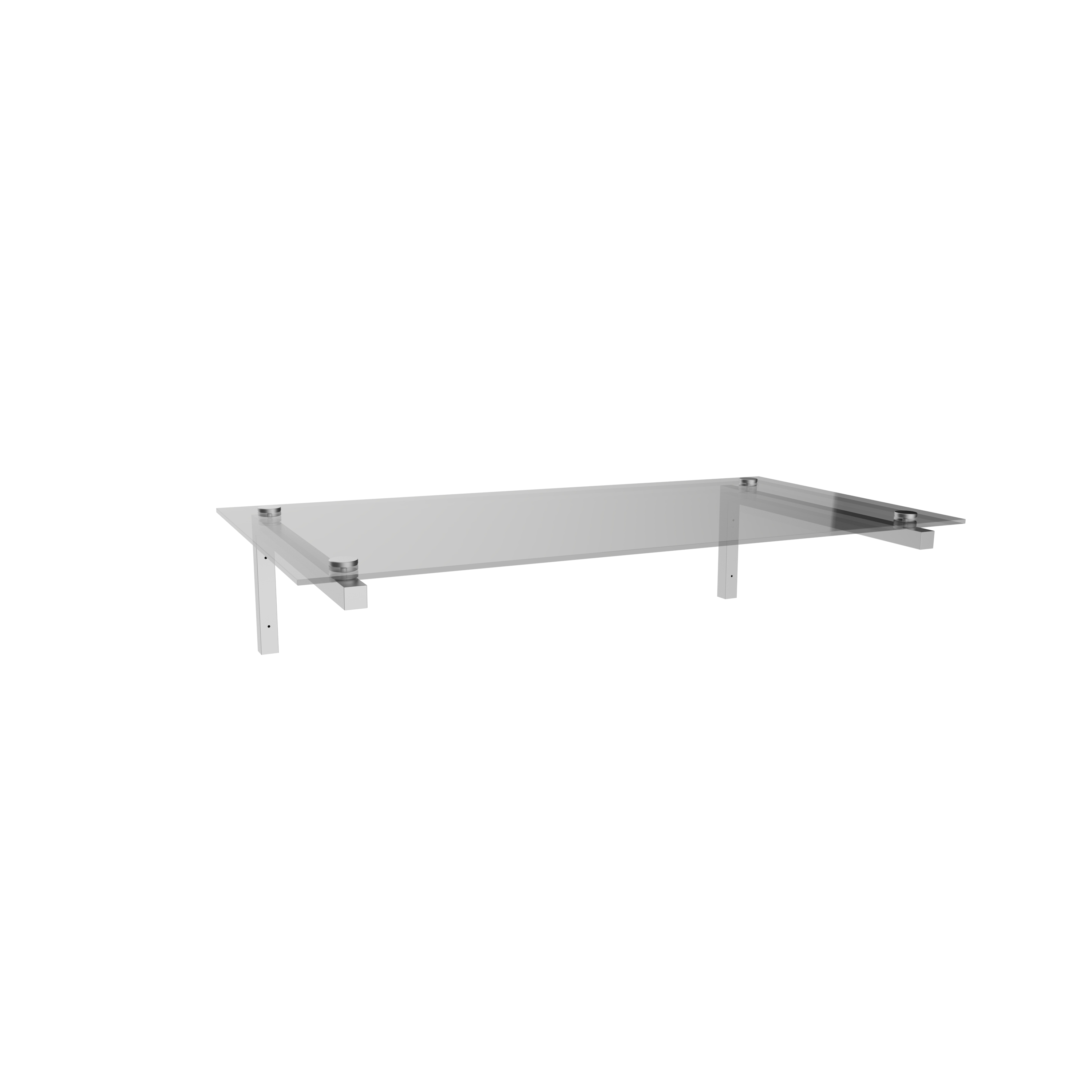

Dreadnaught Posted January 16, 2020 Share Posted January 16, 2020 (edited) @vivienz, in the unlikely event that your impeccable taste would accept something like this, this is what I had been considering before. Its possible to buy the various chromed metal parts from AliExpresss and have the toughened glass made here. Unobtrusive, probably quite cheap, probably easier to mount. Edited January 16, 2020 by Dreadnaught 1 Link to comment Share on other sites More sharing options...
vivienz Posted January 16, 2020 Author Share Posted January 16, 2020 Can I be brutally honest/my usual tactless self? Those fixings look an awful lot like the shower arms I have in my bathrooms. Okay in the bathrooms, but not over the front door. That's the problem with pinterest - it's responsible for the ceiling feature in my lounge, my wetroom and possibly a canopy. None of which are/will be cheap. Damn! 4 Link to comment Share on other sites More sharing options...

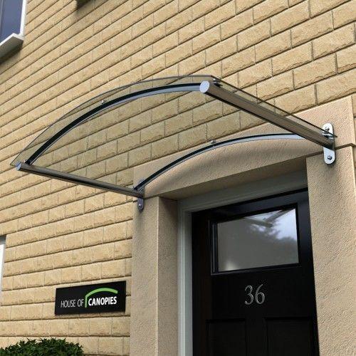

Carrerahill Posted January 16, 2020 Share Posted January 16, 2020 10 minutes ago, vivienz said: I've seen lots of examples with curved glass - would that help counteract the span at all, assuming the design would work for you? Like this one. I like the look of this one, however, my worry about this one would be the small fixing area, fine if you can stick two pieces of threaded rod with resin into a piece of concrete but that just looks like a recipe for disaster, with wind loading I could see that loading up those fixings significantly, the result is then damaged masonry etc. if it lets go. The one Jeremy designed spreads the load a bit down the wall and puts a decent potion of the load into compression on the bottom of the arm with the top fixings in tension giving the clamping force required to lock it into place. Link to comment Share on other sites More sharing options...

vivienz Posted January 16, 2020 Author Share Posted January 16, 2020 1 minute ago, SteamyTea said: As much as I like the look of them (glass canopies), I would not trust one in the winds I get. There is also keeping it clean. And not making it look like a BMW showroom. The wind here is pretty fierce - we have no shelter at all between us and the southwesterlies that come in, which is why I like the look of the one with the glass retained by 3 brackets. It would look not dissimilar in style to the brise soleil we have fitted and then hasn't been a creak or groan out of that through all the bad weather, so I have some confidence in that type of design. Keeping it clean shouldn't be a problem, just a quick wipe down and maybe a coat of Rainex on it to stop stuff sticking as well (it used to work a treat on the shower screen at the old house where we had hard water!). As for a BMW showroom, no chance of that with a pair of Fiat pandas parked around the corner - a BMW wouldn't be seen dead around here! Link to comment Share on other sites More sharing options...
