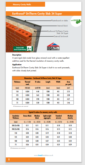

PeterW Posted March 20, 2021 Share Posted March 20, 2021 Medium block both sides and a 200mm cavity will do that with either Rockwool or EPS bead at 0.032 Link to comment Share on other sites More sharing options...
Buzz Posted March 20, 2021 Share Posted March 20, 2021 decent guide for what is achievable with 0.34 at different cavity widths Link to comment Share on other sites More sharing options...

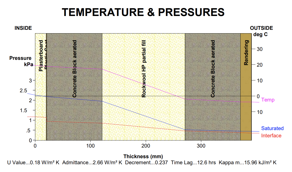

puntloos Posted March 20, 2021 Author Share Posted March 20, 2021 (edited) 7 minutes ago, PeterW said: Medium block both sides and a 200mm cavity will do that with either Rockwool or EPS bead at 0.032 Wow, I'm suprised that for the extra 0.03 (0.18 -> 0.15) I'd have to increase my wall 50mm given the calculation I posted earlier with 150 rockwool (reproduced below, more details in my original post [link] ) Edited March 20, 2021 by puntloos Link to comment Share on other sites More sharing options...
PeterW Posted March 20, 2021 Share Posted March 20, 2021 You’ve used aerated blocks, I’ve used standard mediums as I wouldn’t use aerated blocks if you gave them to me with a £10 note taped to each one ... 1 Link to comment Share on other sites More sharing options...

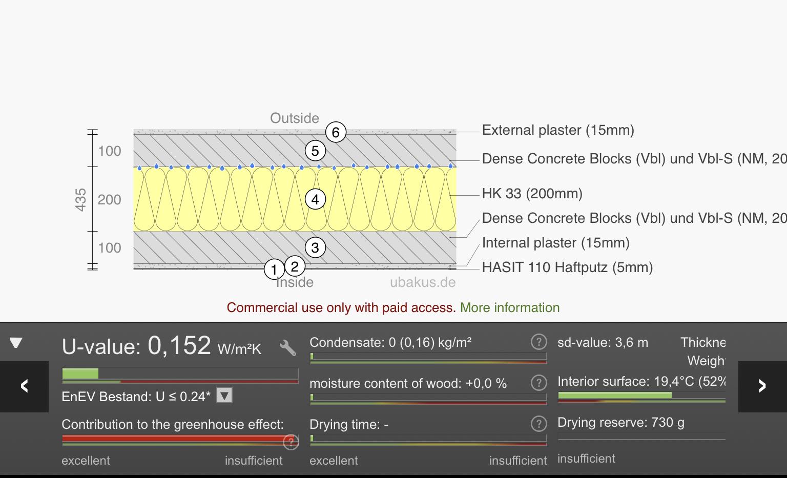

Iceverge Posted March 21, 2021 Share Posted March 21, 2021 ditch the plasterboard. rubbish for airtightness, skim 5mm sandcement plaster 15mm medium block 100mm EPS blown beads with stainless steel wall ties 200mm medium block 100mm sand cement render 15mm if you search my last few posts you’ll see how little a difference chasing the last few decimal places in wall u values makes. Unless you’re aiming to make a true air heated passivhaus or need certification your efforts are better aimed toward airtightness. As for the mortar snots. extend your cavity as far below the ground as you can. this will stop droppings building up and bridging above dpc level (i’ve seen it happen). otherwise as long as your brickies clean the ties before the mortar sets EPS blown beads are pretty fool proof. just make sure all your through wall ducts are done beforehand as the bonding can be hit and miss. 1 Link to comment Share on other sites More sharing options...
