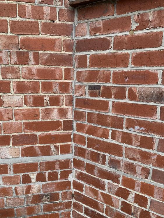

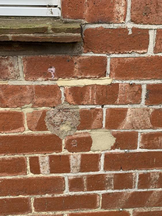

Considering renovation options for our 1926 house in an AONB in Sussex.

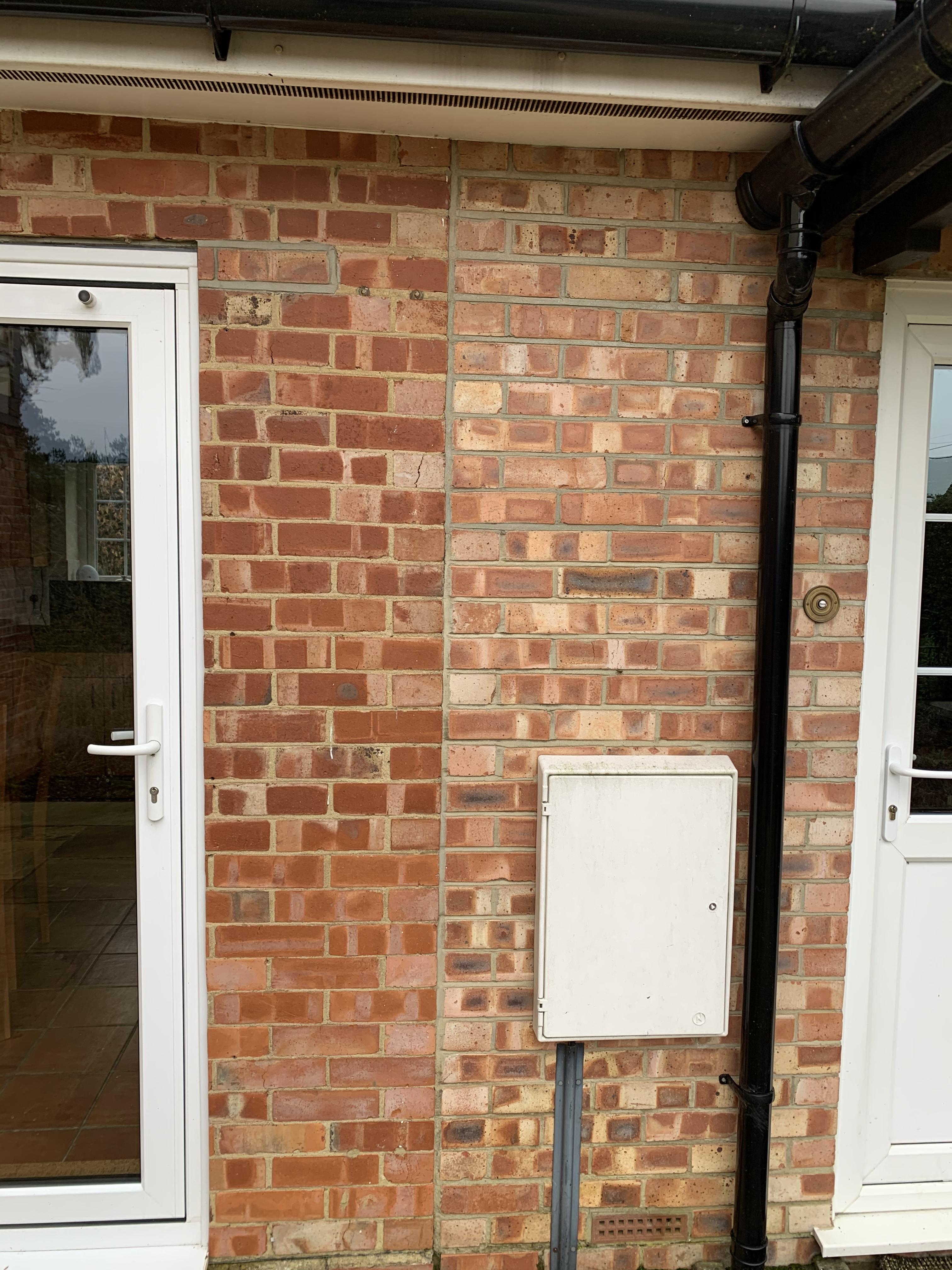

From a distance the exterior brickwork looks ok, but on closer inspection whats very noticeable is the mix of different bricks.

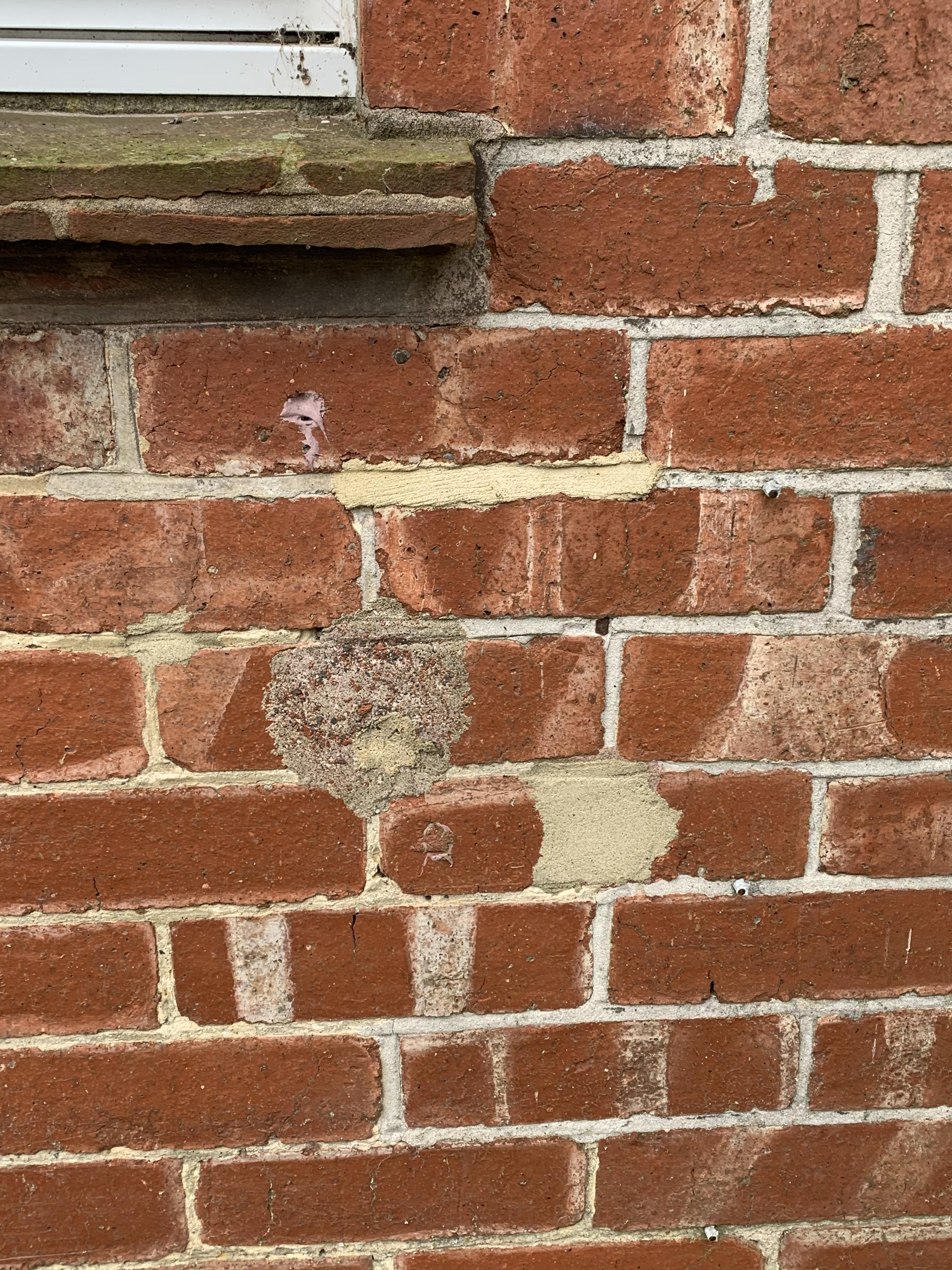

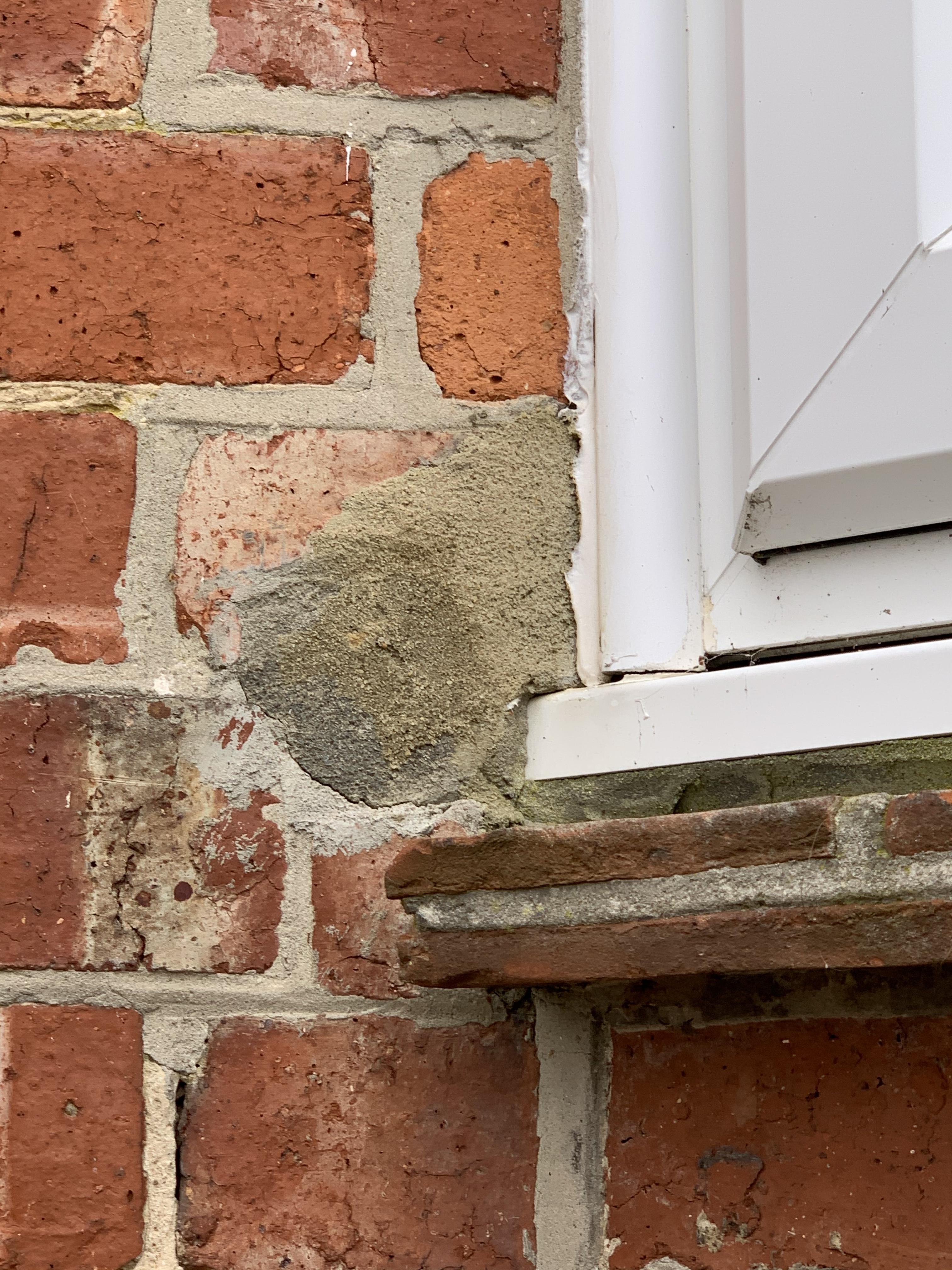

There is considerable damage around windows and where holes have been drilled for cavity wall insulation and wall tie replacement.
Wondering if ‘real’ hand made or reclaimed brick slips, applied directly to the existing bricks would be a good solution to cover up these issues with the brickwork, by giving a more consistent appearance.
Any comments or suggestions would be appreciated.
Thanks

I think that would be a terrible idea. Create problems down the line. I'd be looking to either chop out and replace with similar reclaim of you really want to or accept it for what it is. Character!
I would think that would be a major PITA, every reveal or stop area up against windows and doors will be a real hash up to get it right, window cills would need replacing.

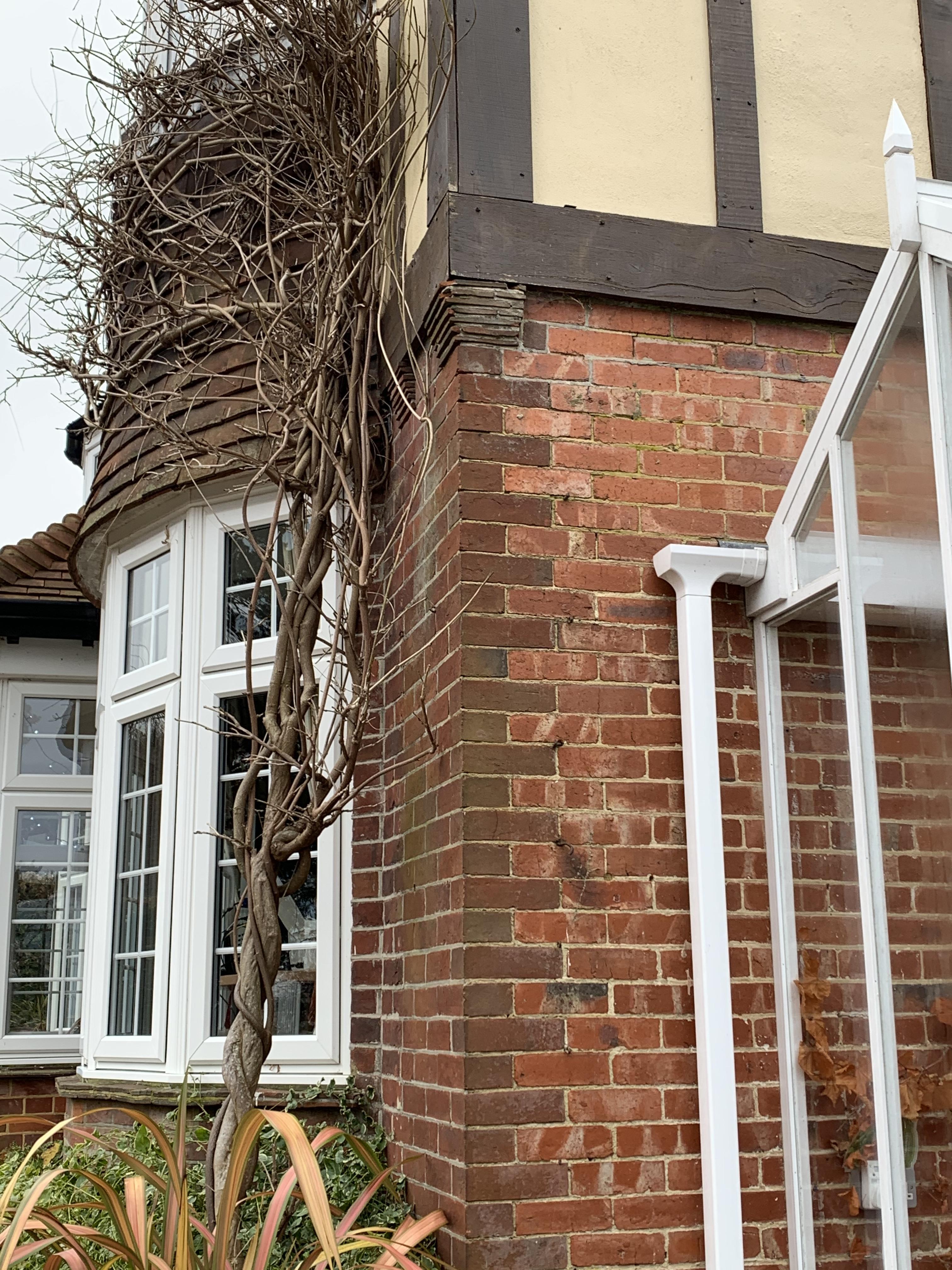

The front elevation you show is originally how they where built, nice soft red brick front cheaper fletton brick at the side.

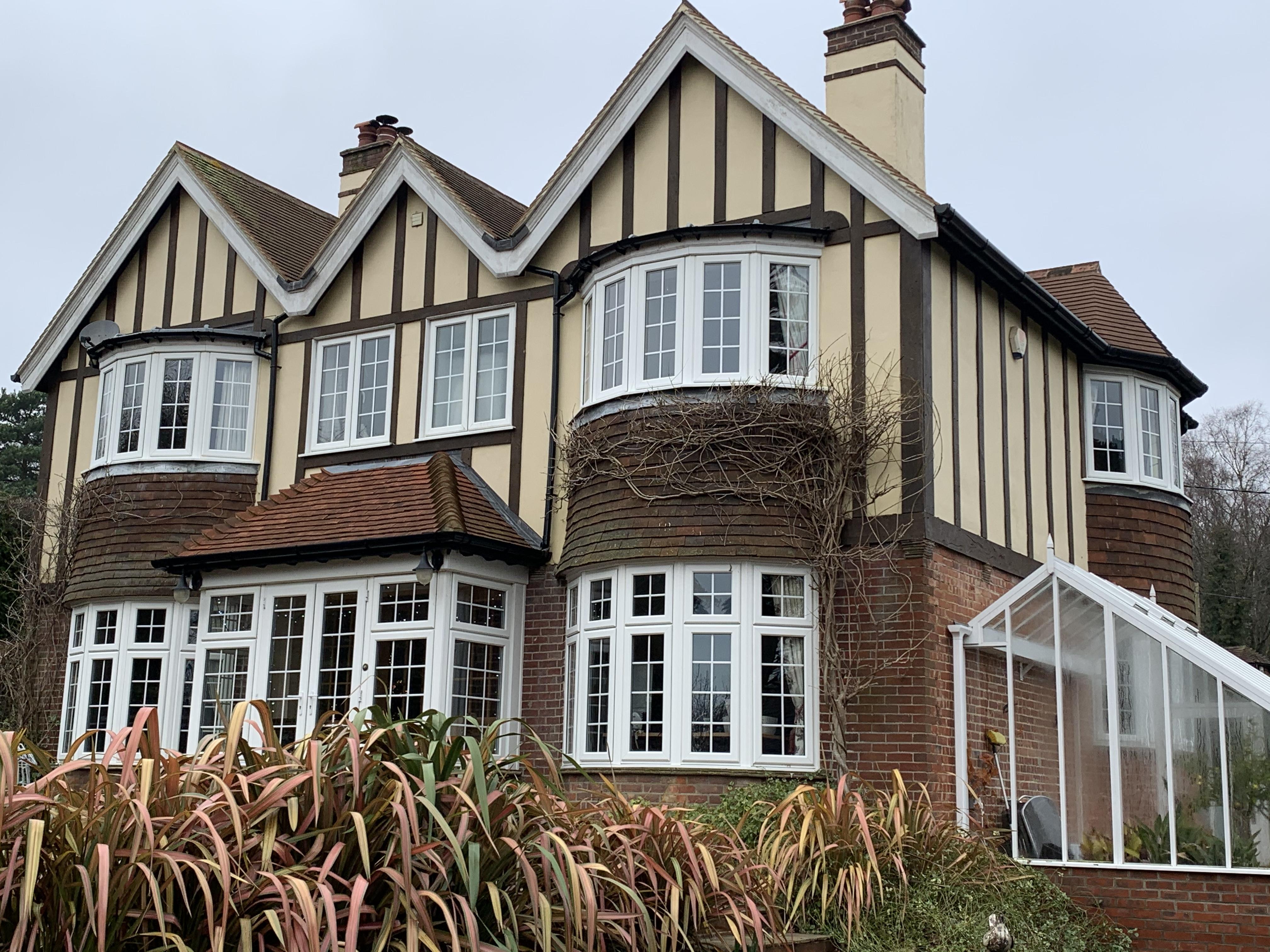

Was also thinking about replacing the 15 year old Tudor boarding and painted panels with tile hanging - would that spoil the character too ?
Edited by Robert Clark
Typo
everyone has thier own idea on what looks right -
all i would say is address all other issues first -
brick slips or clading to tudor is comestic
I'd suggest some decent repointing might go a long way to a smarter appearance. But make sure you get someone skilled, who can do a neat job, unlike what you have now.
There is a technique called tuck pointing, which is a highly skilled restoration method - the narrow pinstripes may not be quite what you need, but someone who can tuck point may have the skill to improve the appearance of your place.
www.youtube.com/watch?v=TyNY_MU62iA
www.youtube.com/watch?v=A4uNGxkTlJY (warning: background music; use mute button)
Note that in America, 'tuck pointing' seems to mean ordinary pointing, leading to much internet confusion.

If I was buying that house. I’d be worried the cladding was hiding something  if it was present. I agree repointing is a much, much better option.

Another vote for some quality repointing.  Get a quote from a proper craftsman whose work you have seen.  The plastic windows don't look good.  If you really want to lose the mock Tudor look you could just re-render.  White paint may be better.  If you do clay tile hanging you would be best to have a different shade to the brickwork - perhaps redder.
I think you could get best pointing job done and it still will not make it very pretty - and that would be a lot more work than brick slip system and you still will have the bricks which have blown faces  andf surface  cracks for water to freeze in in some parts --
 New windows being replaced and  new window ledges -maybe external insulation then slips or render
or just render the brickwork ?
looking at mock tudor ,that does not look orginal? they had better wood then
lots of gaps and nail holes obvious --maybe hiding lots of other crappy brickwork
