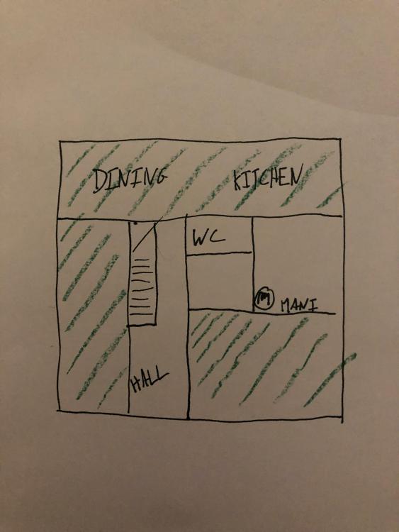

Doodlehime Posted January 3, 2020 Author Share Posted January 3, 2020 Sorry for the crude drawing. The areas shaded in green will have insulation to Current building regs and UFH. The area in question is the hall which from what I can tell is an uninsulated slab. Link to comment Share on other sites More sharing options...

Doodlehime Posted January 4, 2020 Author Share Posted January 4, 2020 8 hours ago, Onoff said: Wuss! Morning's work with a blunt spade! ? ? Im sure my father in law who is helping me would love to do it. In all honesty we dont have the time or budget to dig up the whole down stairs. Also as these wont be living areas I think it would be over kill for our ex council house. One existing concrete floor does need to come up because I believe it has suffered from sulphate attack. Also the DPM which was bitumen poured on top has been breached and the floor is seriously bad. From what I can see the solid floors in the unshaded areas are all good. If people think UFH is not an option in these areas I will us rads and hide the pipework in the new stud walls. Link to comment Share on other sites More sharing options...
