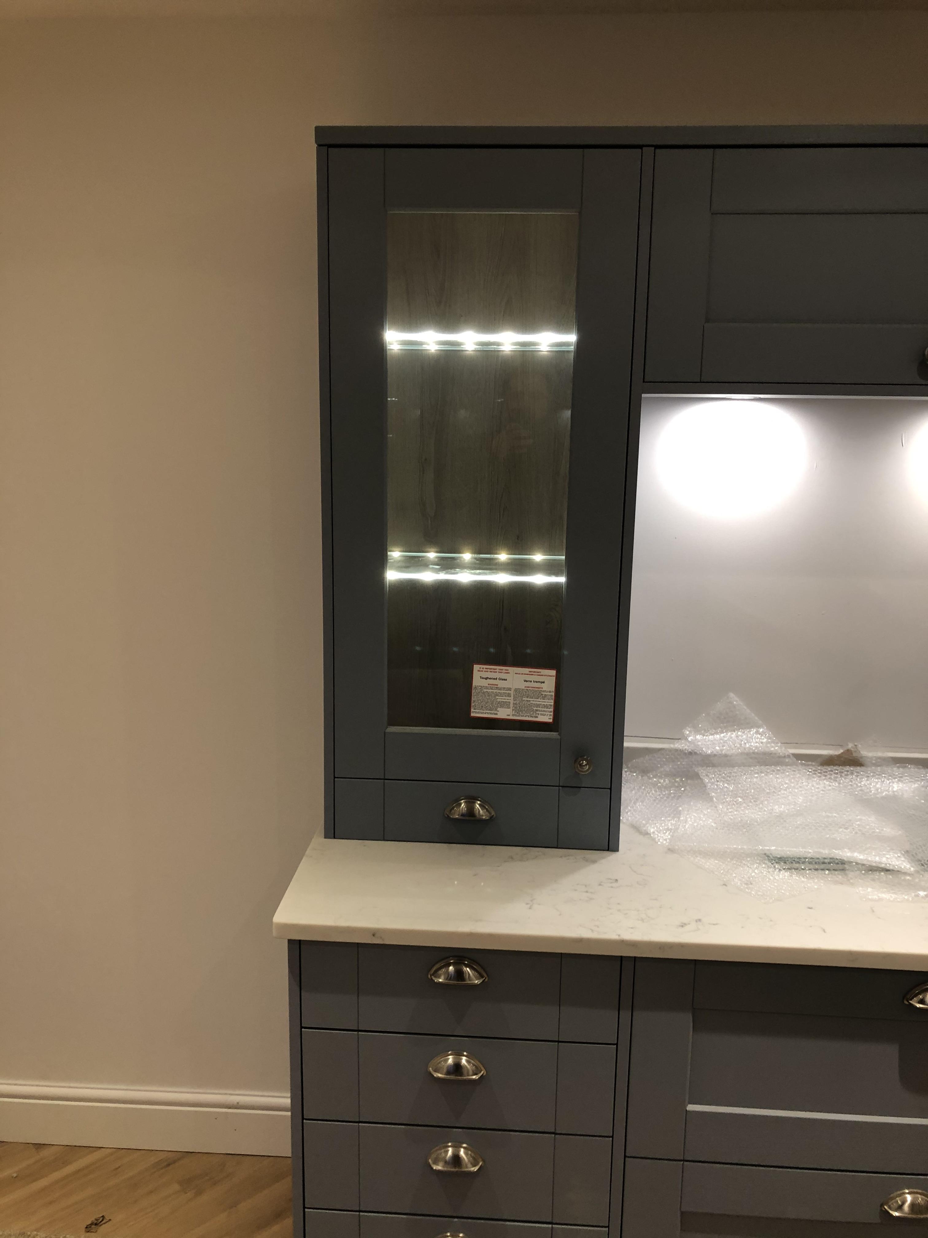

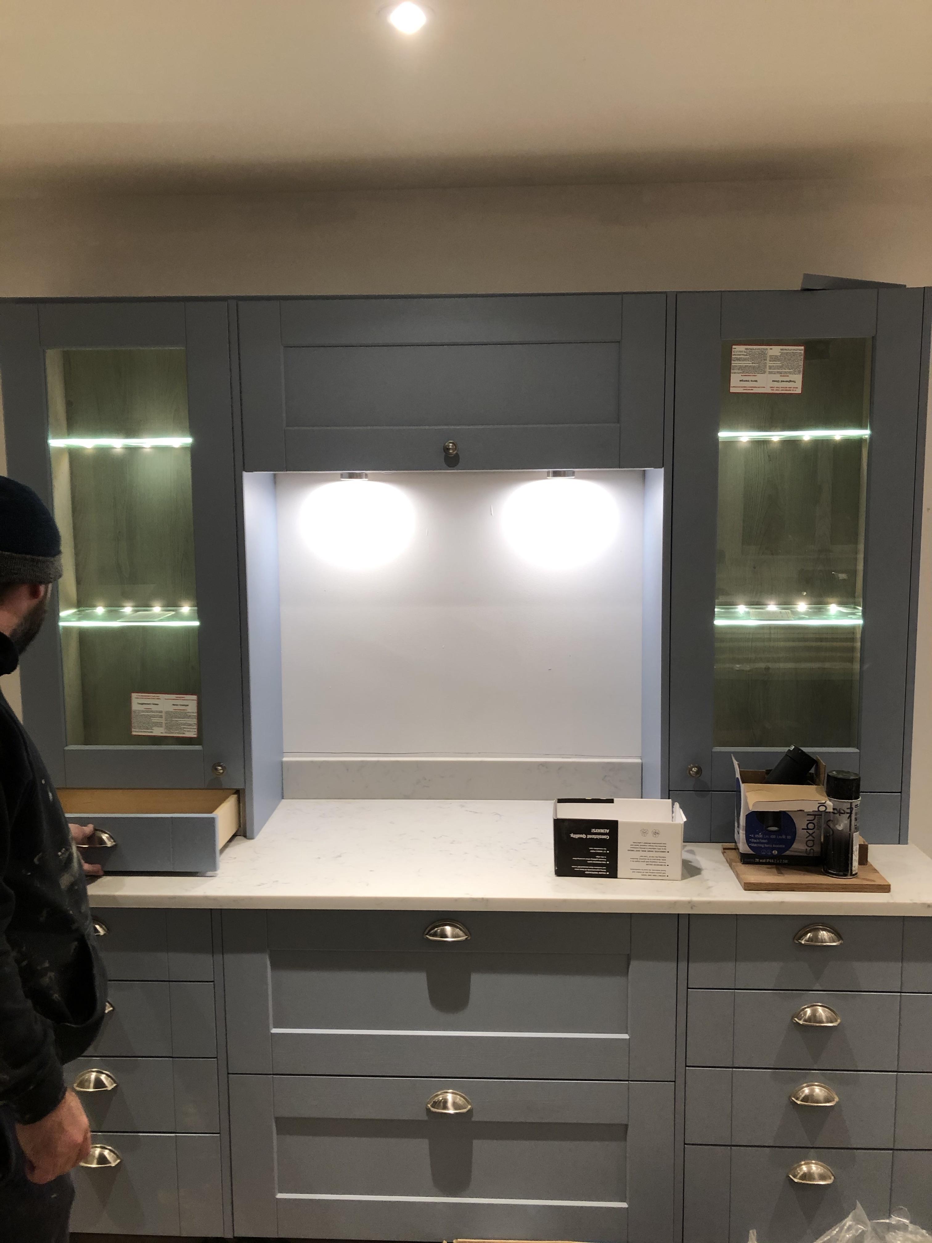

Wagas Posted December 26, 2019 Posted December 26, 2019 Hello, wondering if the forum wisdom can think of a simple (cheap) fix for making the cabinet glass shelves look less green and more natural. I presume the glass has a tint of green in it but without changing the glass is there a way of covering the edge with something so when the light is shone on it it has more of a natural light? Someone has mentioned putting a shower screen seal on the back edge which I am yet to try. Thanks for any ideas
Dreadnaught Posted December 26, 2019 Posted December 26, 2019 A layer of enamel model-makers paint on the glass edge in a colour that matches the cabinets?
Temp Posted December 26, 2019 Posted December 26, 2019 If you change the glass look at low iron Optiwhite glass. I guess it might be possible to find RGB LEDs and knoble the green ones a bit?
Russell griffiths Posted December 26, 2019 Posted December 26, 2019 glass is surprisingly cheap, why not ask at the local place for a different type.
Mr Punter Posted December 26, 2019 Posted December 26, 2019 As per others, low iron glass is what you need. Not too much more expensive but worth it especially when the glass is thick or you can see the edge.
Wagas Posted December 27, 2019 Author Posted December 27, 2019 Thanks for the ideas. I've found some low iron glass suppliers on ebay and will give it a try. Don't know why Howdens didn't just use it as standard as who wants a green lit cabinet?!
PeterW Posted December 27, 2019 Posted December 27, 2019 1 hour ago, Wagas said: Thanks for the ideas. I've found some low iron glass suppliers on ebay and will give it a try. Don't know why Howdens didn't just use it as standard as who wants a green lit cabinet?! don’t forget they will be toughened so you cannot cut them - they have to be the right size and also edge polished / bevelled
ryder72 Posted January 3, 2020 Posted January 3, 2020 You will probably have to get someone to cut and then toughen low iron glass to suit. Shelves for glass cupboards are available off the shelf in set sizes and always made from regular glass. By the time you go though this exercise I doubt its going to be cheap.
Wagas Posted January 28, 2020 Author Posted January 28, 2020 The low iron glass did the trick, total cost £26 via ebay 3
