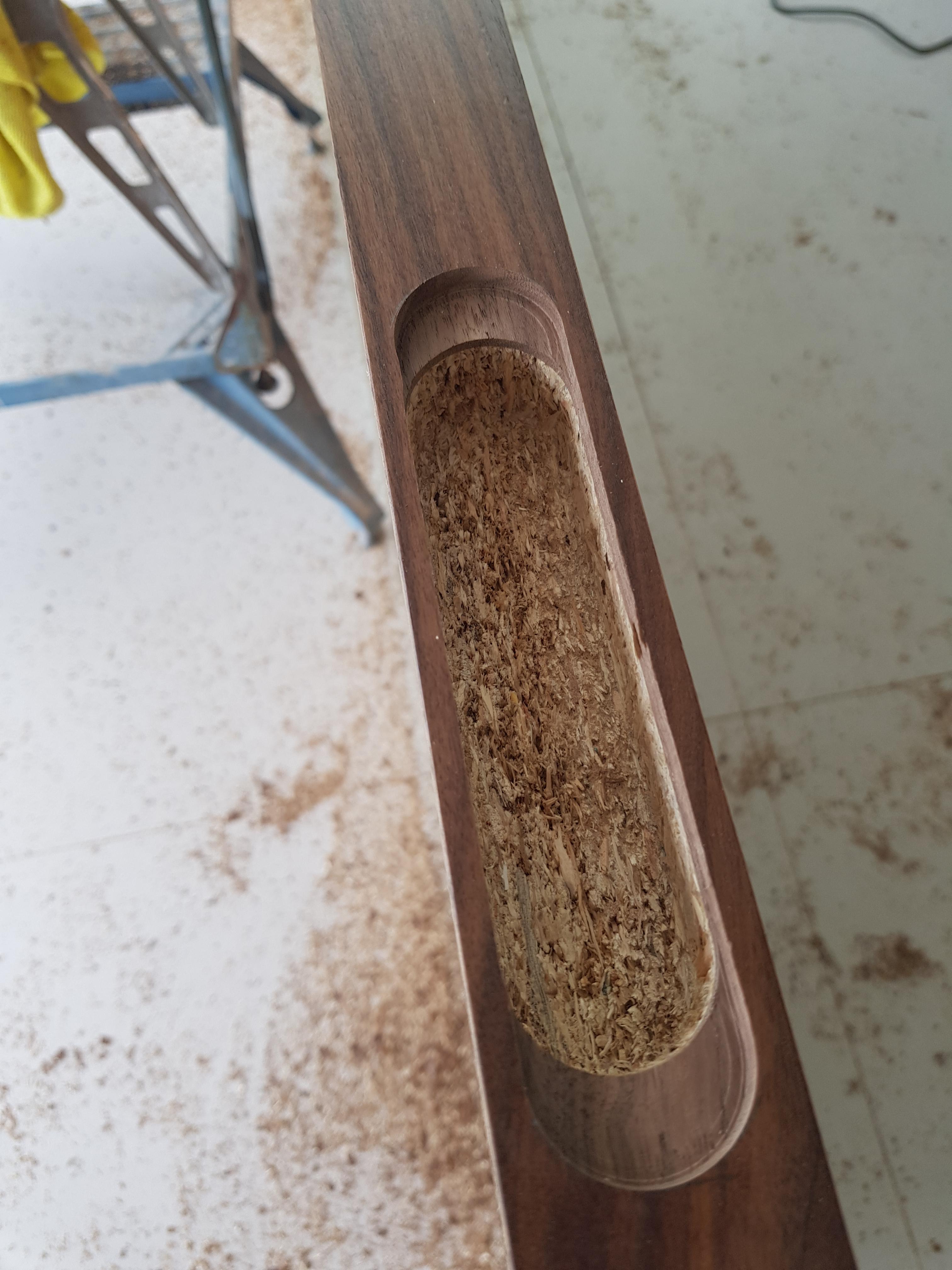

PeterW Posted October 27, 2016 Posted October 27, 2016 Do you mean a 3D hinge like a Tago or CEAM hinge..? They need to be perfectly accurate and you usually need a routing jig to do them - easy on a door, hard on a frame unless its on the bench. Most need either 3 or 4 on each door depending on weight and they are upwards of £20 each. Last CEAM jig I saw was £230 plus vat...

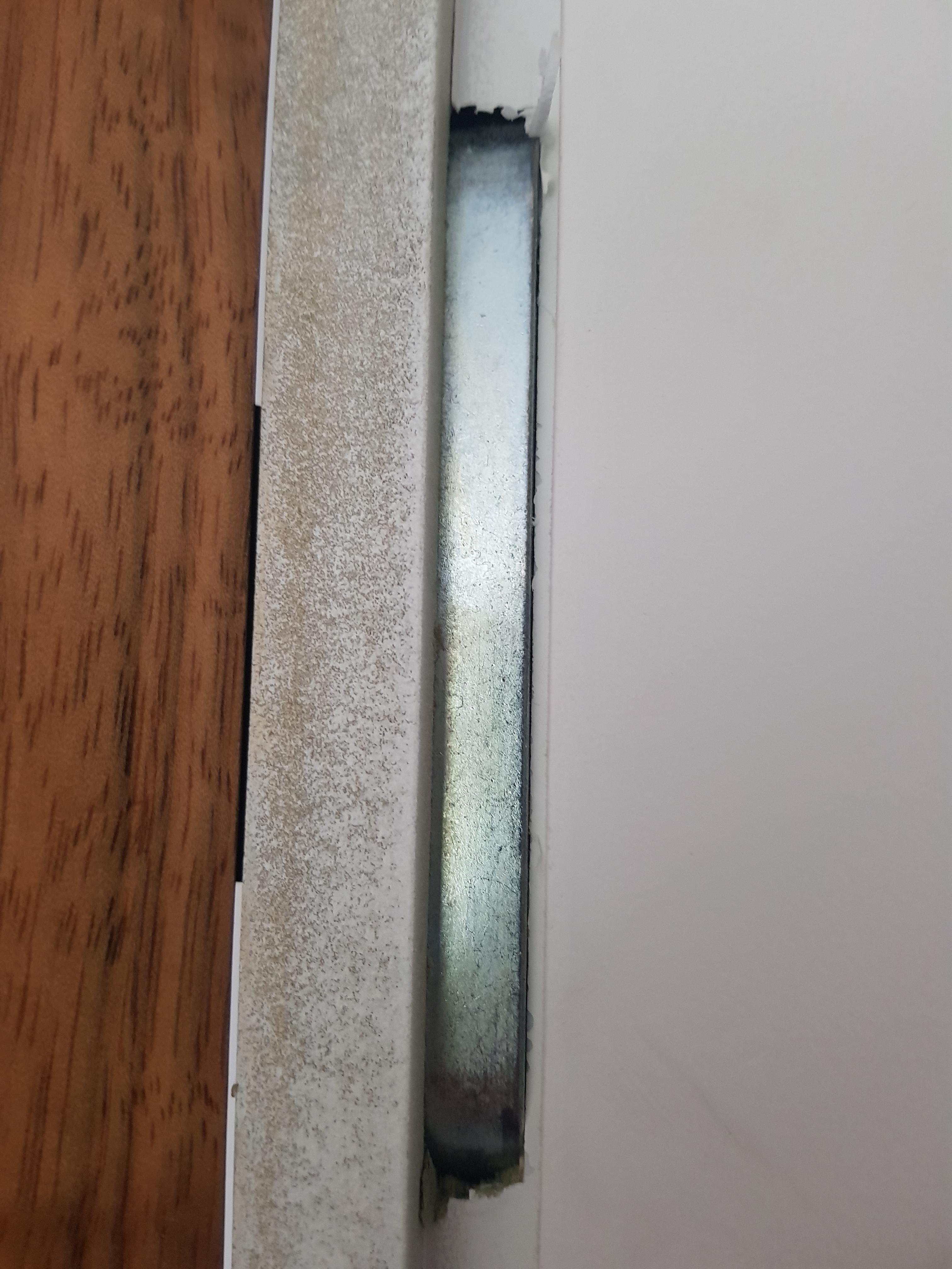

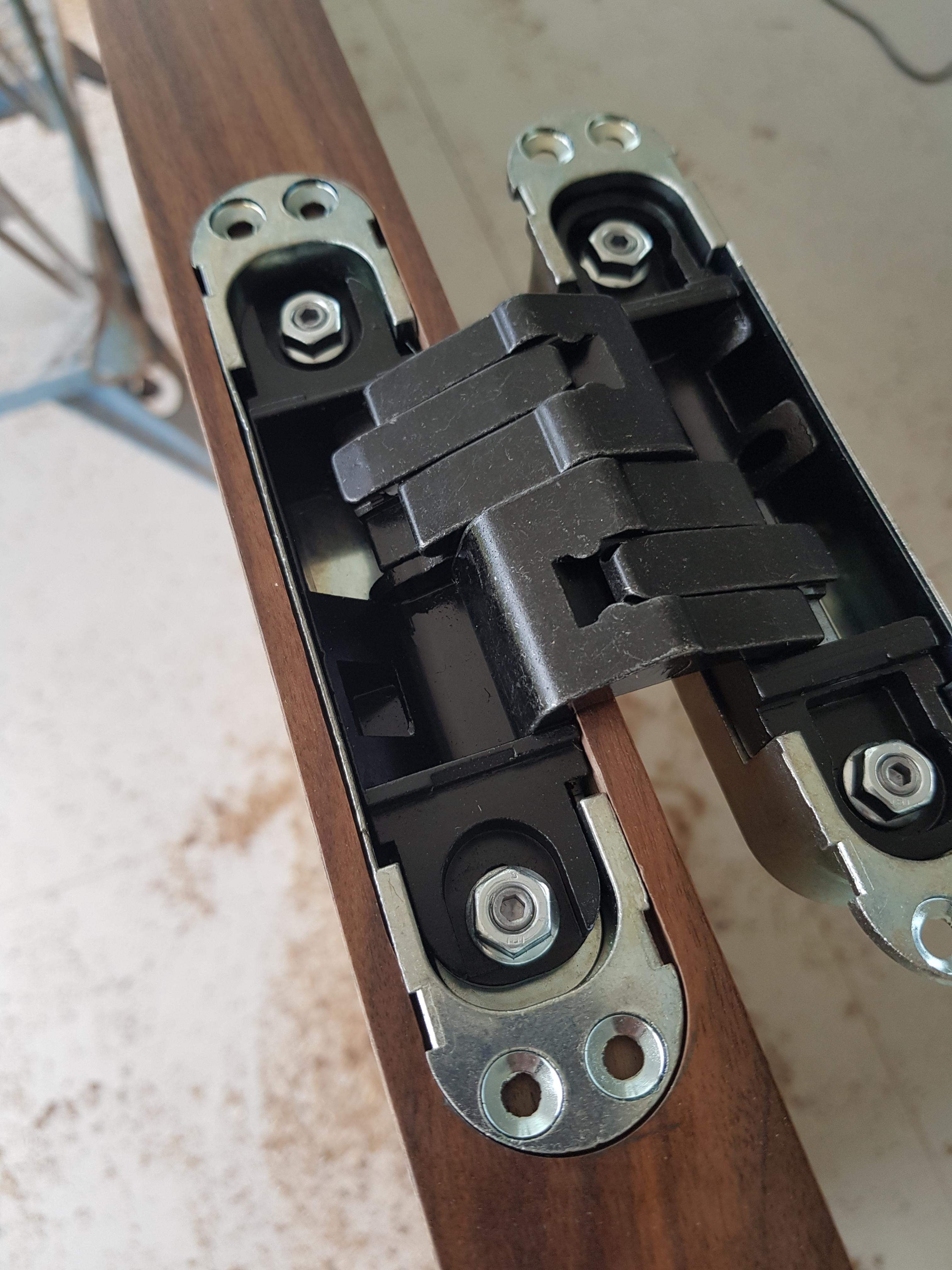

Pete Posted October 26, 2020 Posted October 26, 2020 On 23/09/2020 at 08:55, Pete said: I am using them, yes they are expensive but on my build with no architrave they will look the dogs b_______!! Just about to ring round prices as I have 15 doors to hang. Just an update on the concealed hinges. Took some working out to avoid any costly mishaps but got going now. I have used the Ceam hinges and they do feel quality. Just another 40 hinges to do!j 5

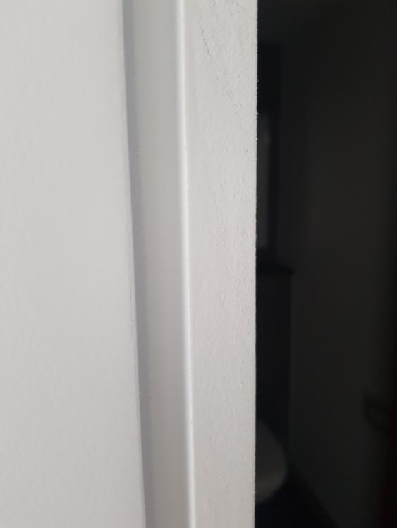

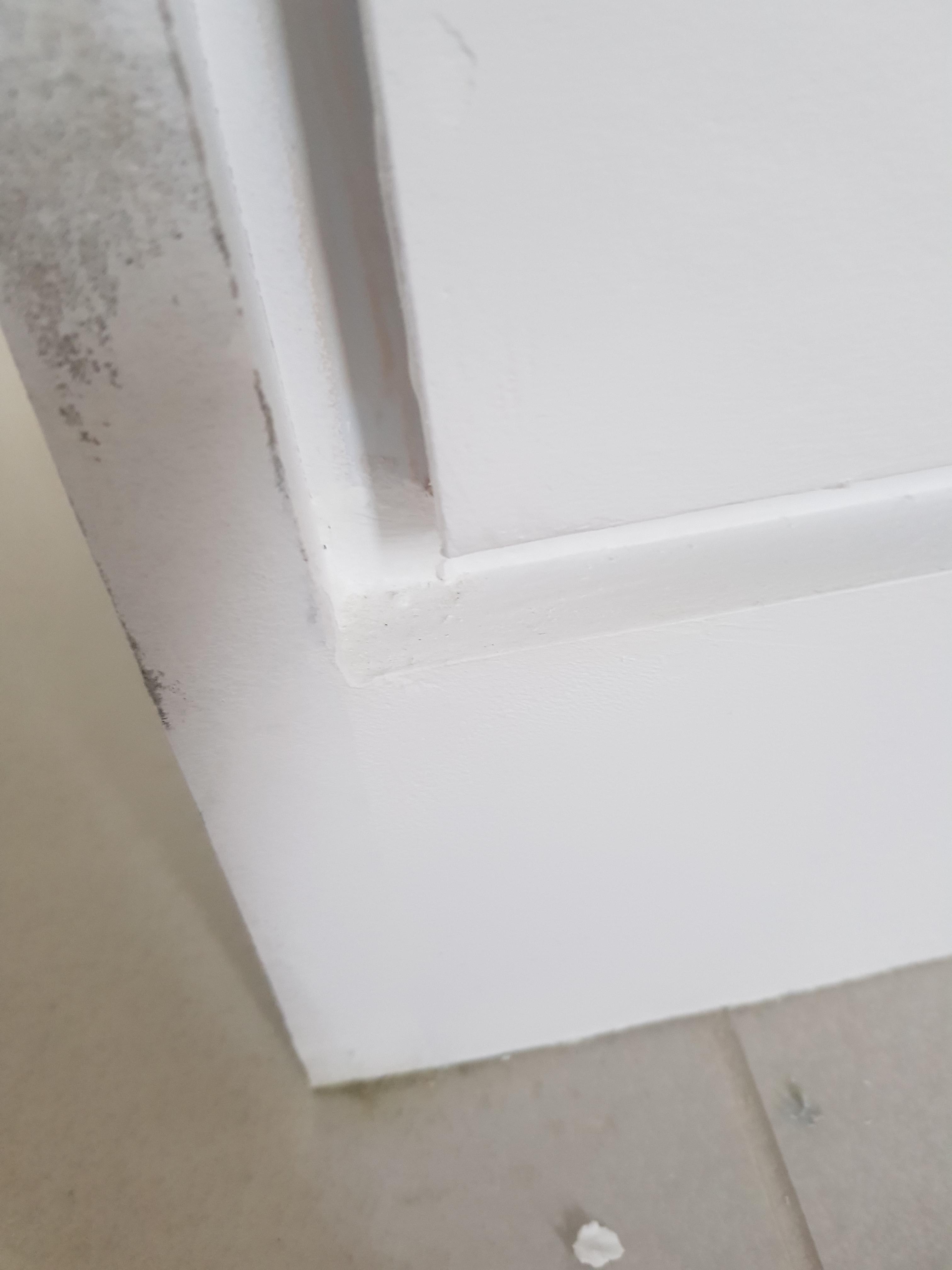

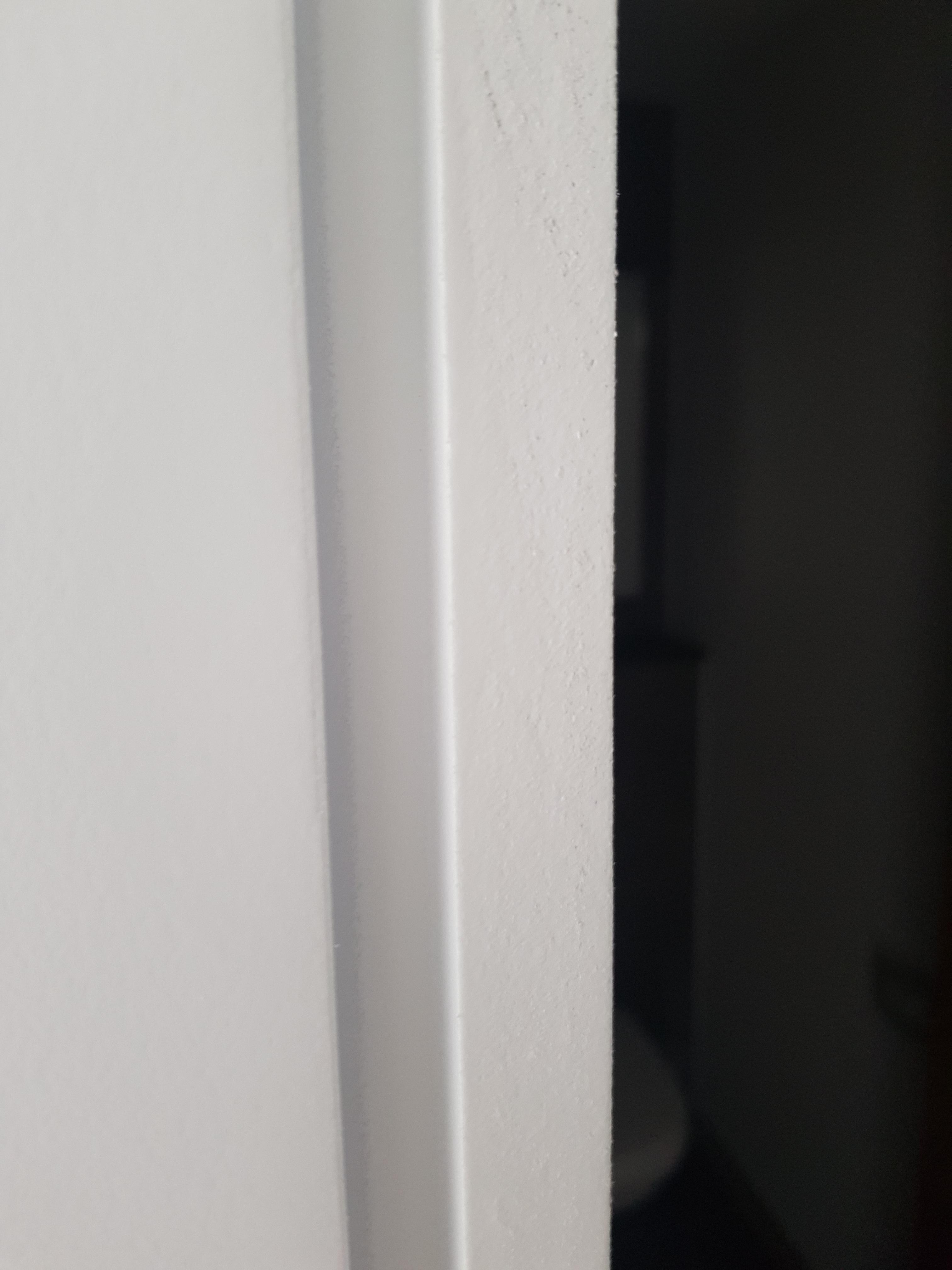

Pete Posted November 1, 2020 Posted November 1, 2020 2 hours ago, Dave Jones said: how are you finishing the board/plaster to the door liners where they meet ? Will post some pictures tomorrow because I have had an oops in detailing 1
Pete Posted November 2, 2020 Posted November 2, 2020 11 hours ago, Pete said: Will post some pictures tomorrow because I have had an oops in detailing I used a shadow gap trim to finish the plasterboard/door casing junction. What I did not allow for is the depth of the concealed hinges and position of them in relation to the shadow gap. It is not a massive error in the grand scheme of things as most of the hinges are on the hidden side of the door. It just means I will have to make an mdf trim, 12mm wide with a rebate underneath to cover the hinge body and when painted will look fine.
Dave Jones Posted November 2, 2020 Posted November 2, 2020 that looks a huge gap ? Im thinking of 6mm type gap to give a shadow / floating wall effect. Could you take one of the whole door and frame
