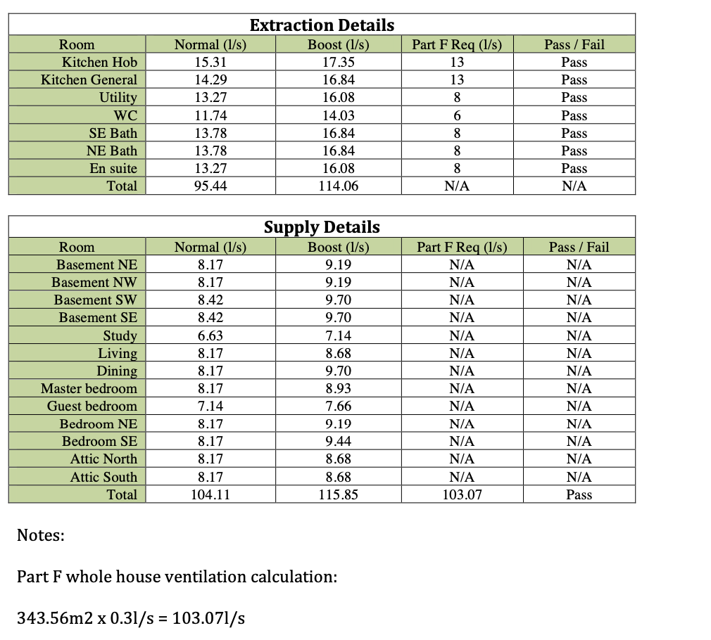

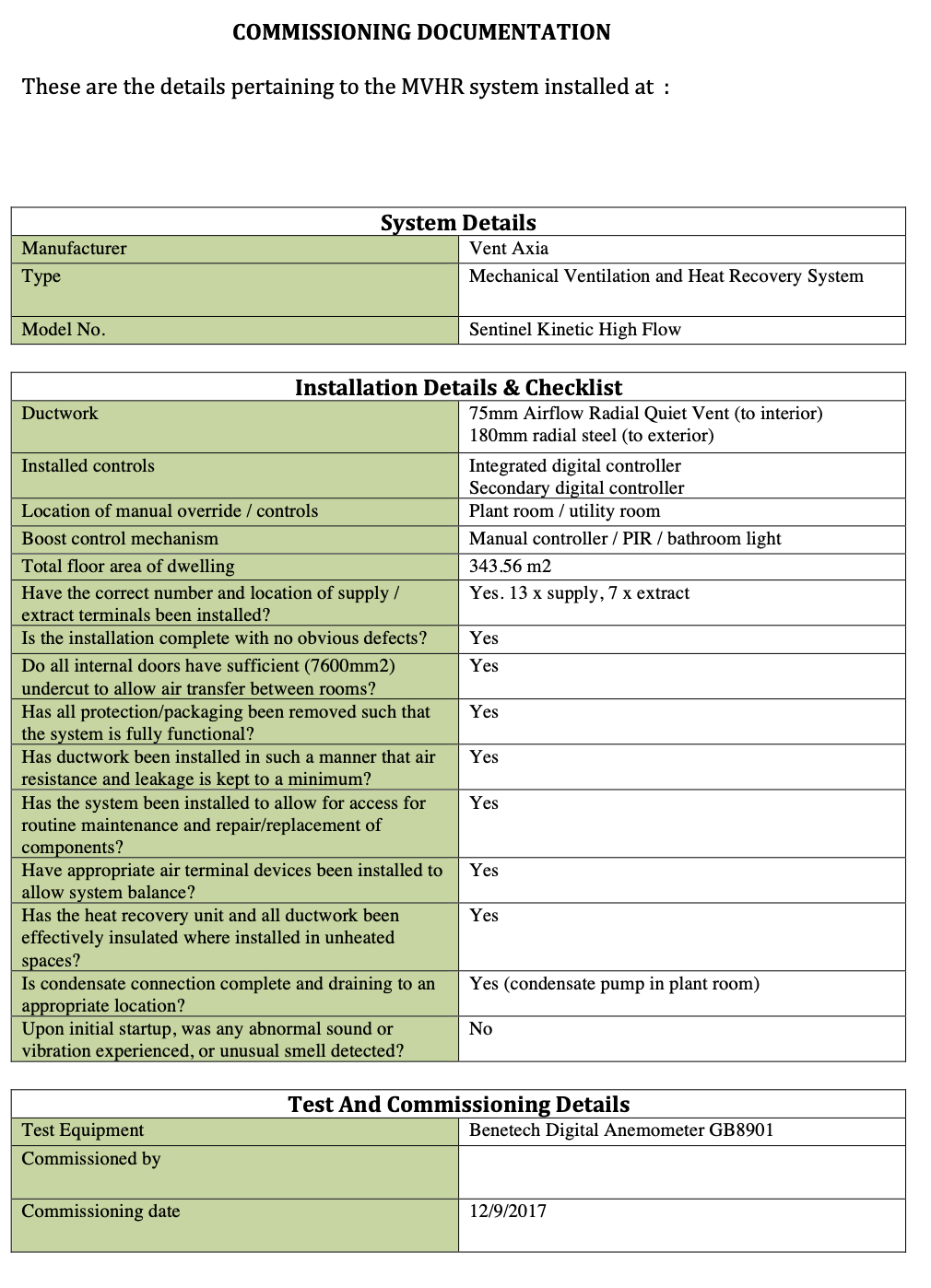

Bitpipe Posted June 10, 2020 Share Posted June 10, 2020 11 hours ago, MJNewton said: Is there a BR requirement for maximum ventilation? If not then just whack the system up to full and measure the flow rates to ensure the minimums are met and done with it. I doubt there's a need for a balancing for BR compliance too. There is a minimum whole house ventilation rate that is presented as 0.3l/s/m2 So, like others, I calculated my total internal floor area in m2 and multiplied it by 0.3. I then calculated the total supply rate in l/s by summing all the flow rates as measured at each supply terminal and tweaked the fan supply speed until it met or exceeded the whole house ventilation figure. From memory, first pass at the default 30% fan speed was about 0.25l/s so I cranked the fan up to 40% and that did the trick. Once that was established, I turned it back down to the 30% comfort level. Note that on my system (like many) the flow control is at each terminal so there is no alternative to running around and measuring each one every time you tweak the unit fan speed. That said, it only took a few hours to do the whole measurement exercise once I'd figured out how to get correct measurements. TBH - this is the last test you want to do as prior to that, most of the effort was tweaking the supply and extract to balance the system (which should remain balanced irrespective of unit fan speed). The extracts were all double ducted so easily exceeded the min extract rates. To summarise, the only thing that BR cares about wrt MVHR is: - has system been properly installed and checked - there is a tick list for this. Includes ensuring system is balanced. - are min extract rates met for bathrooms, kitchens etc? - can min whole house ventilation rate be met? (up to you if you keep these settings or revert to a lower comfort level). This is what I included in my test report to my BC independent inspector. Link to comment Share on other sites More sharing options...

Bitpipe Posted June 10, 2020 Share Posted June 10, 2020 20 minutes ago, JamesP said: ...once I can confirm its ok for myself to complete the commissioning. Do you mean a) you're happy/ confident to do it yourself or b) you want their advance permission that you're ok to do it? I would just tell them that you will provide a report that confirms MVHR commissioning & compliance to the regs. I would not view this as an 'asking permission' scenario as, unlike electrical or plumbing test certs there is no professional qualification or equivalent in existence for MVHR. If you do ask, what's the plan if they say no? Link to comment Share on other sites More sharing options...
