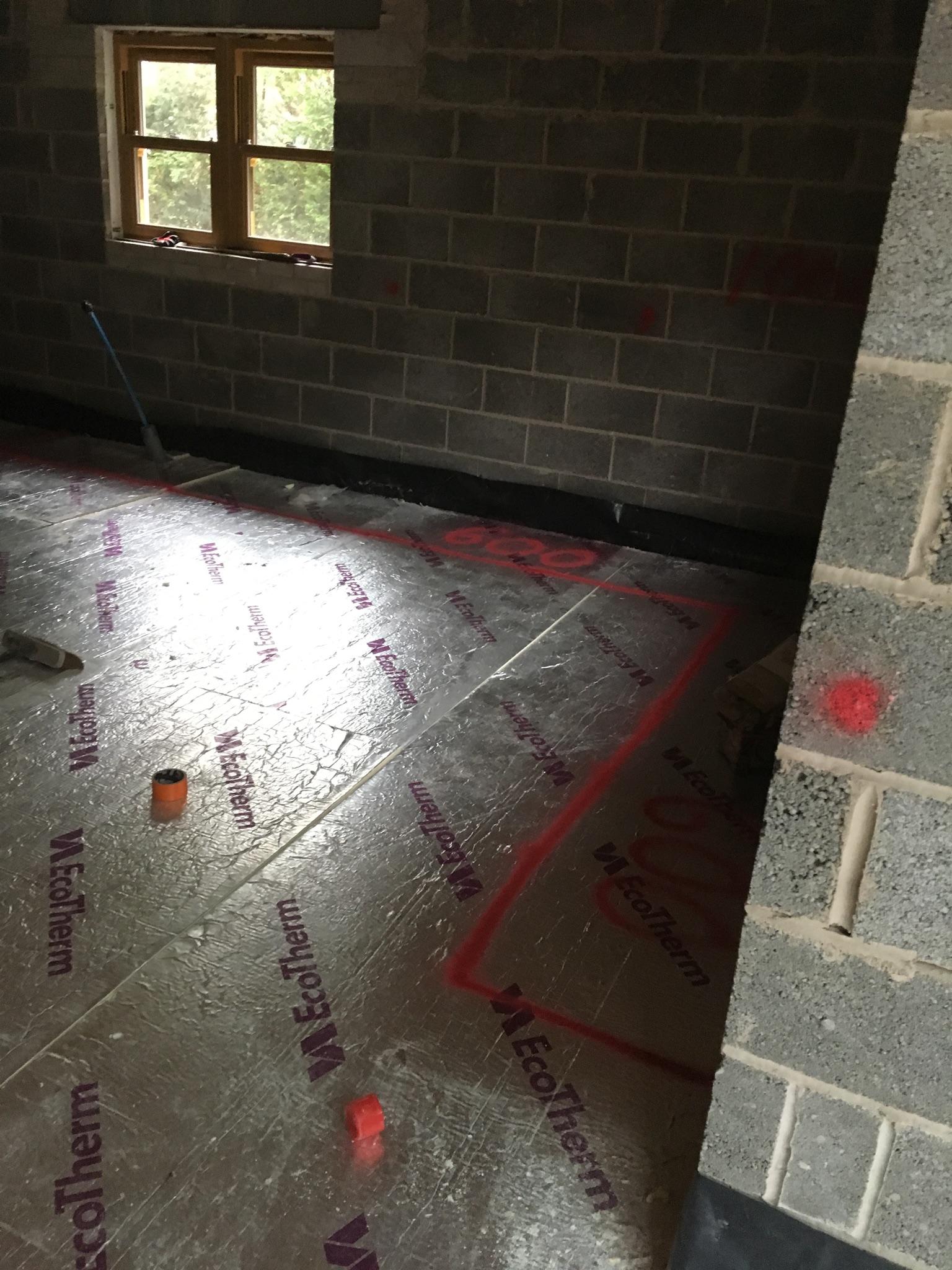

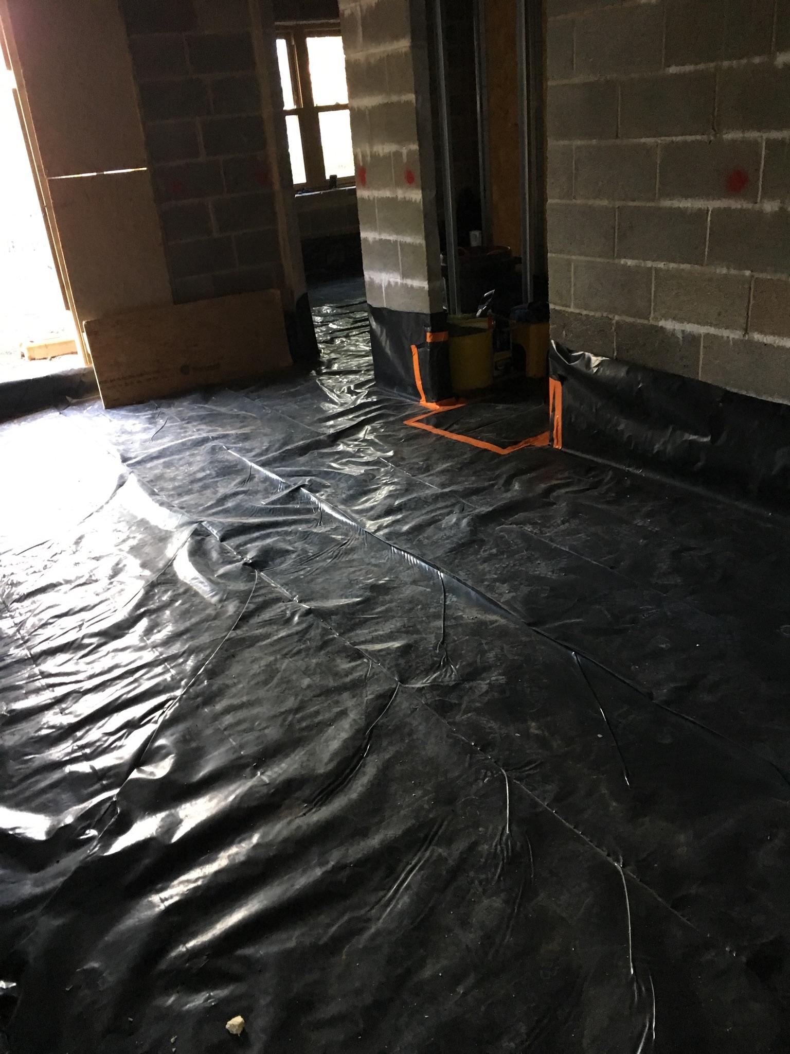

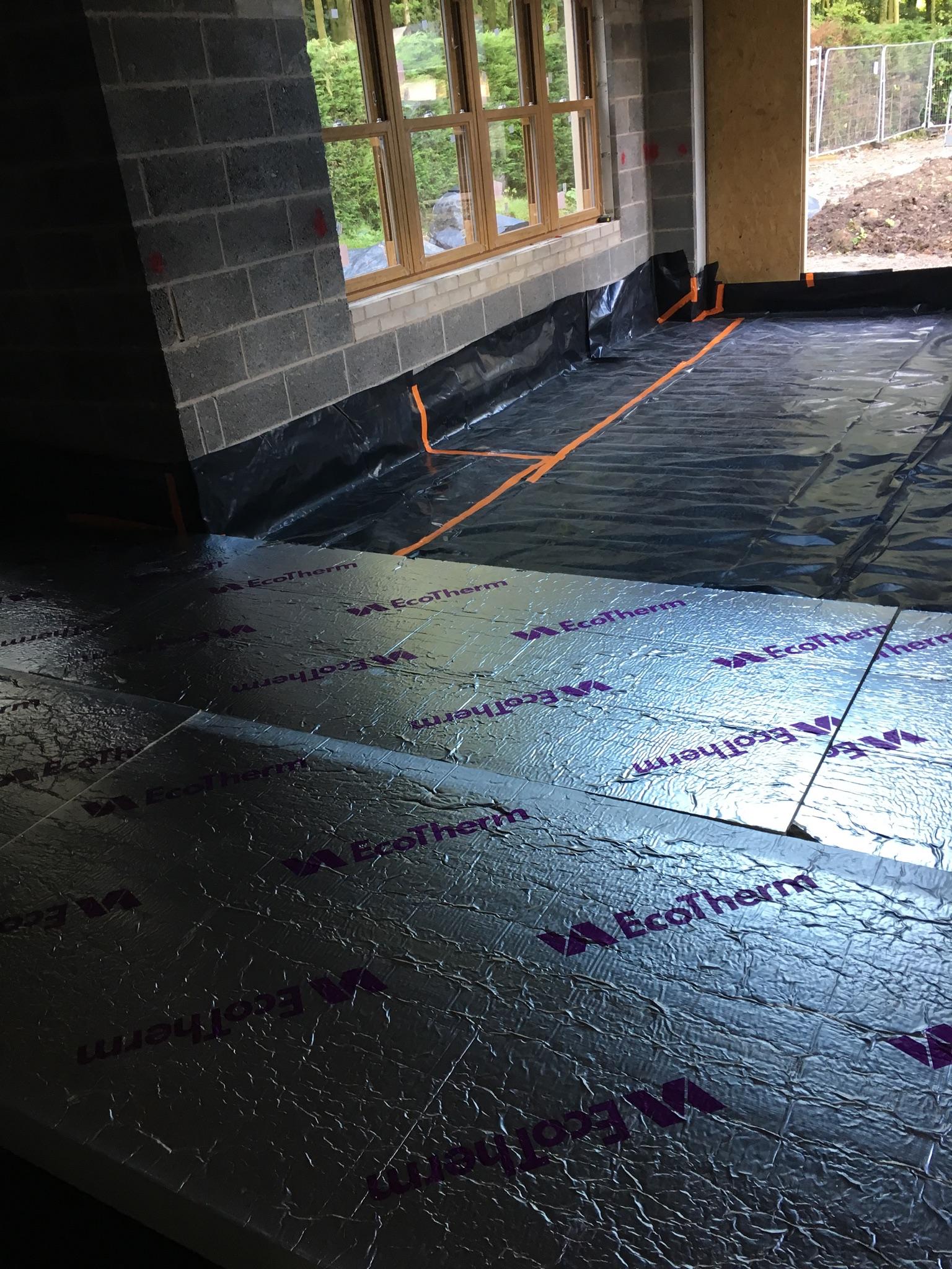

I used this stuff to stick the airtightness tape to my block work and the pir on the ceiling.
https://passivehousesystems.co.uk/product/gerband-fortax-6400-airtight-sealant/
A good bead along the edge then push the tape onto it. It's flexible so will move as the different materials move.
A word of warning though don't get it on your hair as it doesn't come off without a razor or scissors.
