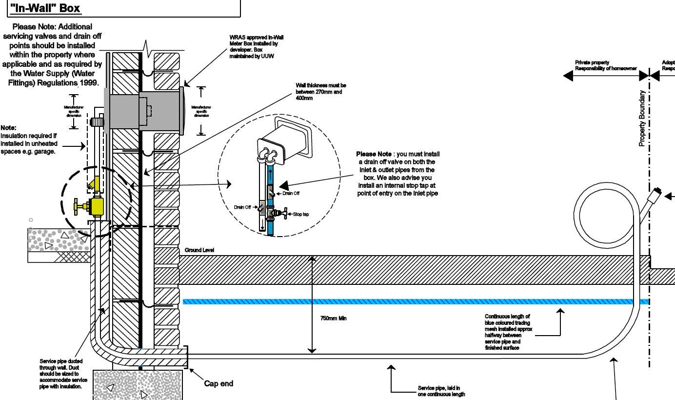

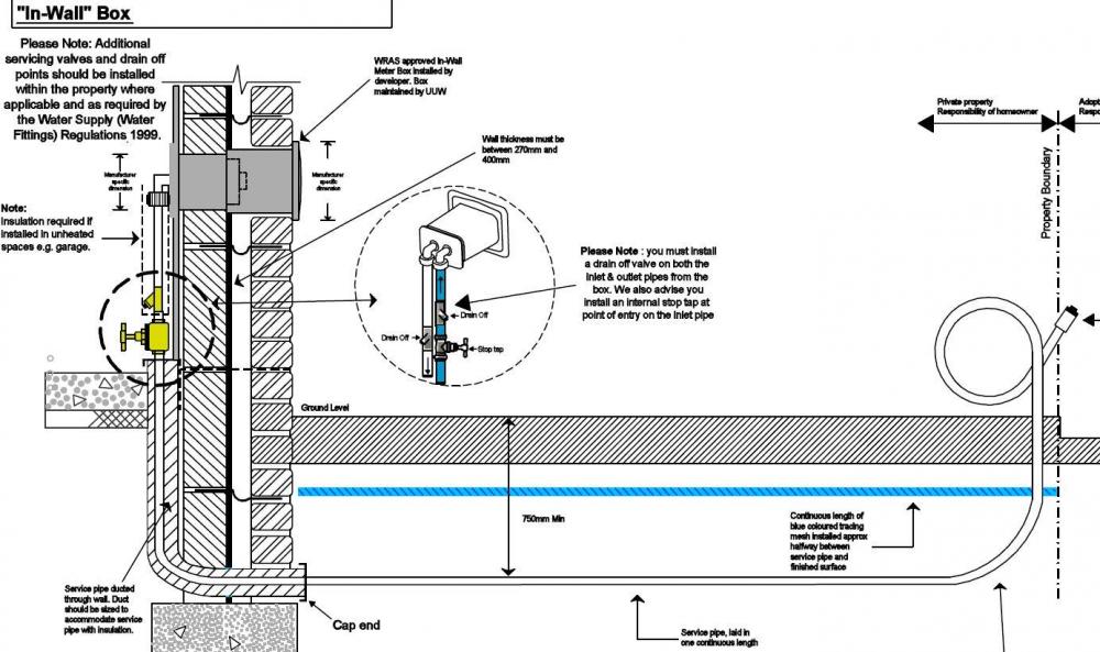

ToughButterCup Posted November 26, 2019 Posted November 26, 2019 The background to this thread is here. Long story short, I maintain their water connection design is incompetent. This thread is about the process of getting them to think about my point of view of view, ask them to re - consider their design and to install a stop tap outside our property. I have written an initial email asking them to make contact. Briefly, the design they insist upon does not include a stop tap outside our property. So, if as is the case here, I need to replace the first stop valve - which- they state should be INSIDE our property, then I need to do a significant amount of work to repair the valve. And that isn't fair, given that it is common practice to put a water stop valve outside new build houses. Heres the design
Jeremy Harris Posted November 26, 2019 Posted November 26, 2019 The design does include a shut off outside the property, although not one that can be easily accessed, as they seem to rely on the one built-in to the Talbot fitting on the main, which is now buried and far from easy to access I suspect. Seems bonkers for them not to have fitted a toby somewhere near your boundary to shut off the incoming supply. 1

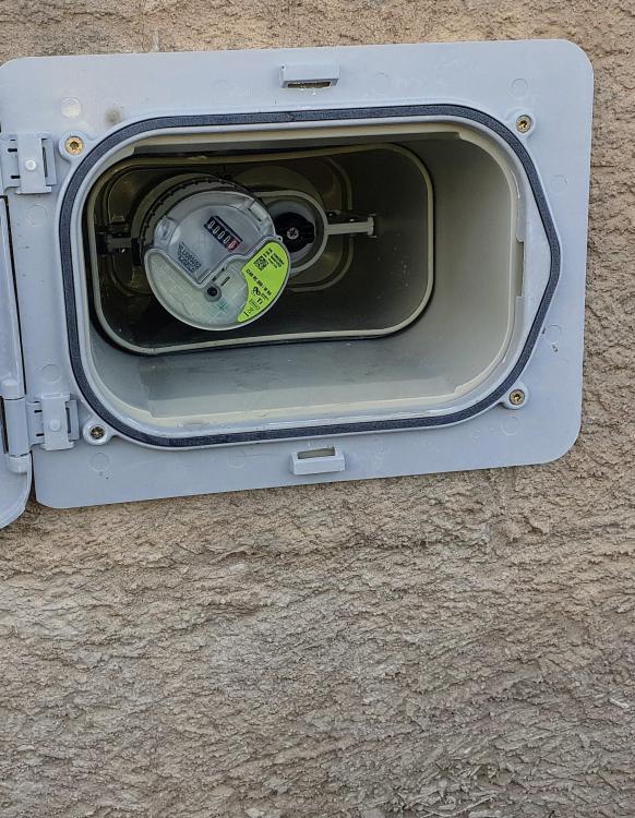

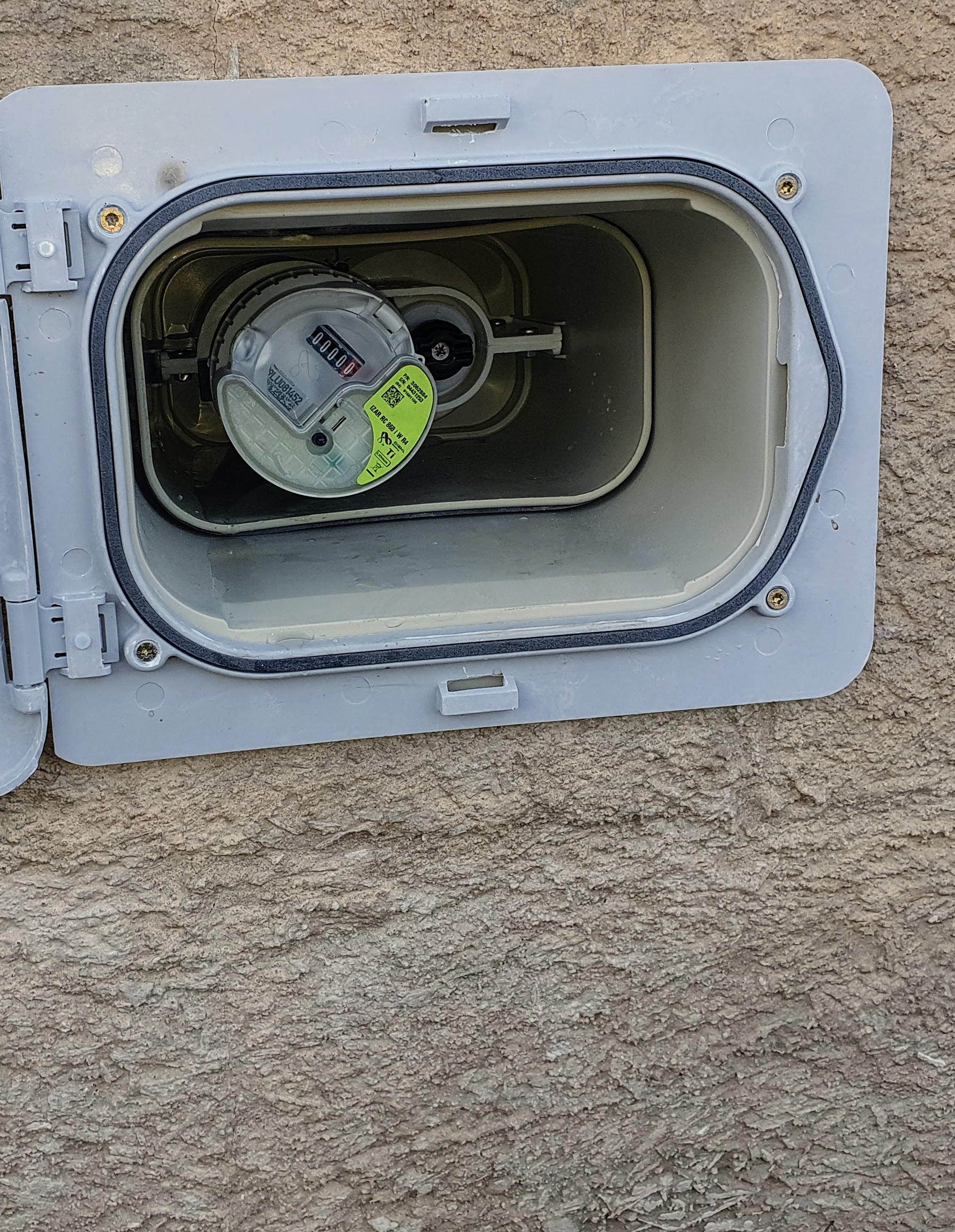

Big Jimbo Posted November 26, 2019 Posted November 26, 2019 If , you were to say "I want a water meter please" where would they put it ? Actually, i might have to take that back. When they did my daughters they stuck it in the corner of the back room, and i stuck a removable boxing over it. There is however a stop tap out in the street. No stoptap outside seems like utter madness. I went through an old lead main in an old kitchen, below the stoptap. If i hadn't been able to leg it outside, and shut it off in the street, i dont know what i would have done.... Madness, madness, they call it madness.
ToughButterCup Posted November 26, 2019 Author Posted November 26, 2019 1 hour ago, Big Jimbo said: If , you were to say "I want a water meter please" where would they put it ?[...] Here's where I put (the hole for) it, at their request... on our front wall.
ToughButterCup Posted November 26, 2019 Author Posted November 26, 2019 2 hours ago, Jeremy Harris said: [...] Seems bonkers for them not to have fitted a toby somewhere near your boundary to shut off the incoming supply. And that is what makes me suggets their design could be seen as incompetent.
Big Jimbo Posted November 26, 2019 Posted November 26, 2019 1 minute ago, AnonymousBosch said: Here's where I put (the hole for) it, at their request... on our front wall. Yep. I see it now. After your in house leaking stoptap. What a bloody nightmare. So the risk is Water pi$$ing out in your house, and nowhere outside to shut if off. That's crap,. I would defo be clamping that blue pipe off, within your land and fitting a stop tap of some sort. Should'nt be that hard.

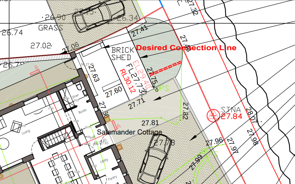

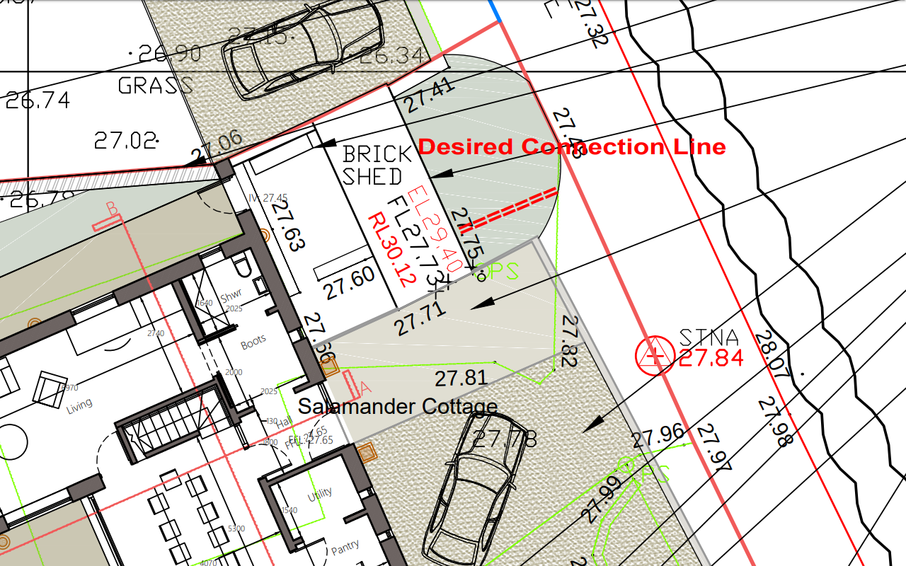

ToughButterCup Posted November 26, 2019 Author Posted November 26, 2019 Naaaah. The electricty, water come at The Piggery - not the house- precisely to avoid that issue. Called Brick shed in the image below. ( Because the Planners might have declared us a brown field site - Psst! need Some home cured bacon?) 1
JFDIY Posted November 27, 2019 Posted November 27, 2019 That drawing is s bit bonkers, you aren't actually required to fit a stop tap in your property, only the drain cock, it just recommends it ( text to the right of enlarged bubble) They might argue that if it wasn't fitted there would be no chance of a leak. That said my folks had a leak in the drive on the outgoing side of the meter and the water supplier did all the rectification and waived the £1k water bill caused by the leak, because they installed the meter and made the connection which 30yrs later leaked. Personally I'd fit a stop tap outside, just in case.......

ToughButterCup Posted December 4, 2019 Author Posted December 4, 2019 Well well, well. You'll never guess what happened next ................... 10 minutes ago a guy from United Utilites Water came out and weighed the job up. I can't (well, shouldn't) report the language used, but he thought that the design was somewhat lacking in common sense. He agreed that a leaking packing gland in a valve was a foreseeable failure and that therefore the design I was asked to follow was not competent. The site was surveyed, marked up on the ground and a job logged inside 5 minutes. A few moments later I had a text notification that the job to insert an external stop valve had been raised . Lively discussions followed about Head Office people - in a wide variety of disciplines - not knowing what they are doing . The job might well be finished inside 5 working days. Result !Top Bloke! Lets see what happens next. Why oh why did UU try it on? 1
