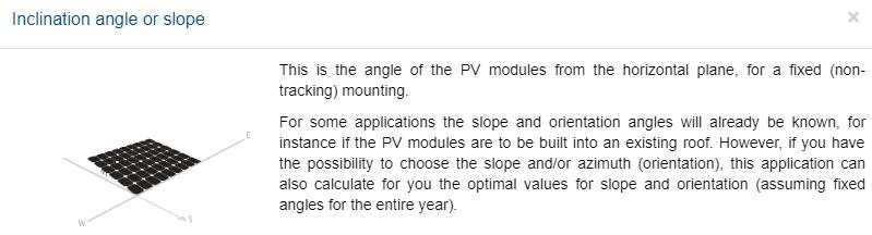

Ed Davies Posted December 15, 2019 Share Posted December 15, 2019 @Home Farm remind us, what orientation do your panels have? Did you mention in another thread that your ridge is north/south so the panels are likely east or west facing? I was a bit surprised by your comment that PVGIS shows the optimum angle for your panels to be 42° for autumn, I'd expect it to be steeper but perhaps it's because of the orientation. If so it might be worth going into a bit when you do your spring update. Link to comment Share on other sites More sharing options...
H F Posted December 15, 2019 Author Share Posted December 15, 2019 -20 degrees from south (SSE). With PVGIS I just kept increasing the degree incline one by one and seeing what the outcome for the November was. At 42 it peaked and declined again at 43. 1 Link to comment Share on other sites More sharing options...
diarmidR Posted March 13, 2024 Share Posted March 13, 2024 PVGIS is giving me an optimum panel tilt angle of 0 degrees. Is this because I live somewhere that is tragically cloudy? (Scottish Highlands) Even in January the output is higher at 15 degrees than 35 degrees. Link to comment Share on other sites More sharing options...
JohnMo Posted March 13, 2024 Share Posted March 13, 2024 26 minutes ago, diarmidR said: optimum panel tilt angle of 0 degrees. Are you reading from vertical or horizontal, from horizontal makes zero sense. 0 tilt i.e. horizontal/flat will give best part of nothing in winter. Link to comment Share on other sites More sharing options...
diarmidR Posted March 13, 2024 Share Posted March 13, 2024 Ah, I had the orientation set to North facing. What a plonker. Link to comment Share on other sites More sharing options...
JohnMo Posted March 13, 2024 Share Posted March 13, 2024 3 minutes ago, diarmidR said: Ah, I had the orientation set to North facing. What a plonker. Good for Australia, not so good here 1 Link to comment Share on other sites More sharing options...
ProDave Posted March 13, 2024 Share Posted March 13, 2024 There is a good argument in Scotland for having vertical or near vertical panels. That will give more generation in winter when you want all you can get. Link to comment Share on other sites More sharing options...
