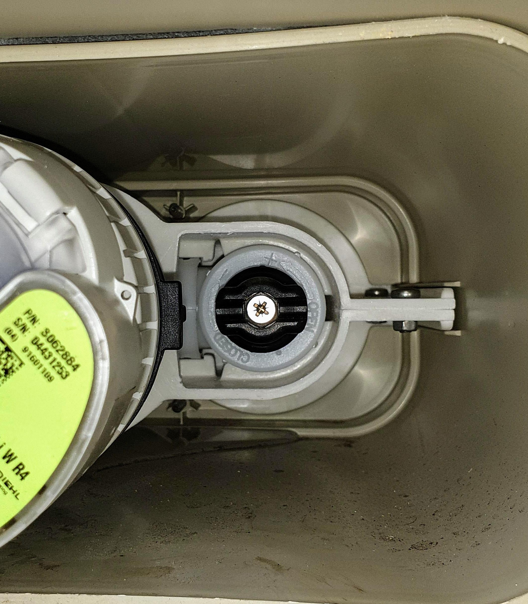

ToughButterCup Posted November 16, 2019 Share Posted November 16, 2019 Two very nice young men came to fit my water meter yesterday yesterday . Very very nice men. They even set the meter to 00000 . That was good of them wannit? But there was a hiccup They didn't have a stop-valve key for this meter : an Atlantic Plastics Intex 2 - the key fits this part of the assembly The key looks as if it fits in the groove on the black plastic. I've tried to source a spare key online, but can't find a supplier. The people I bought the meter from aren't interested (Berrys at Leyland ?) I have a feeling that a pair of mole grips will do the job, but with my extra-special hands I doubt I'd be able to turn a pair of grips in that confined space. Anyone know where to source Intex 2 spares online? The sharper eyed among you will notice a pond of water under the meter. Should I get the water Board back to fix that, or just ignore it? Thanks Ian Link to comment Share on other sites More sharing options...
scottishjohn Posted November 16, 2019 Share Posted November 16, 2019 isit not the same fitting as the std "toby key"looks vaguely like it https://www.toolstation.com/multi-purpose-stop-tap-key/p30620 Link to comment Share on other sites More sharing options...
ProDave Posted November 16, 2019 Share Posted November 16, 2019 Mine is very similar. The handle has a U shaped end with the two ends of the U fitting into the slot either side of the countersunk screw. Mine was this type https://www.ebay.co.uk/itm/atplas-boudary-water-meter-box-2mm-telesscopic-more-than-ono-07712477650/153723441736?hash=item23caa19248:g:gK0AAOSwq~BdzDYx Contact him and see if he has a spare key? Link to comment Share on other sites More sharing options...
ToughButterCup Posted November 16, 2019 Author Share Posted November 16, 2019 Toby: that's the one @scottishjohn : I'll try mine - but in doing so - because the key is so long, I'll need to cross the road , wait for the traffic to die down, and try fitting it from there. Or I suppose I could try cutting it down, and welding the handle back on . That should provide @Declan52 with a laugh.... Link to comment Share on other sites More sharing options...

Aldosarmy Posted June 28, 2023 Share Posted June 28, 2023 On 16/11/2019 at 13:00, ToughButterCup said: I did ask them.....? Looks like a call to Talis is on the cards then..... Thanks Pete. Sorry to jump on a very old thread but did a toby key work on this meter or did you have to source a spare key, i have recently run into a problem where i need to turn this particular meter off. Thanks Link to comment Share on other sites More sharing options...
Temp Posted June 28, 2023 Share Posted June 28, 2023 Ping @ToughButterCup see above. Link to comment Share on other sites More sharing options...
ToughButterCup Posted June 28, 2023 Author Share Posted June 28, 2023 I think I remember using a pair of long-nose pliers 🤔 but a Toby works. We installed a stop valve immediately after the meter. 1 Link to comment Share on other sites More sharing options...
