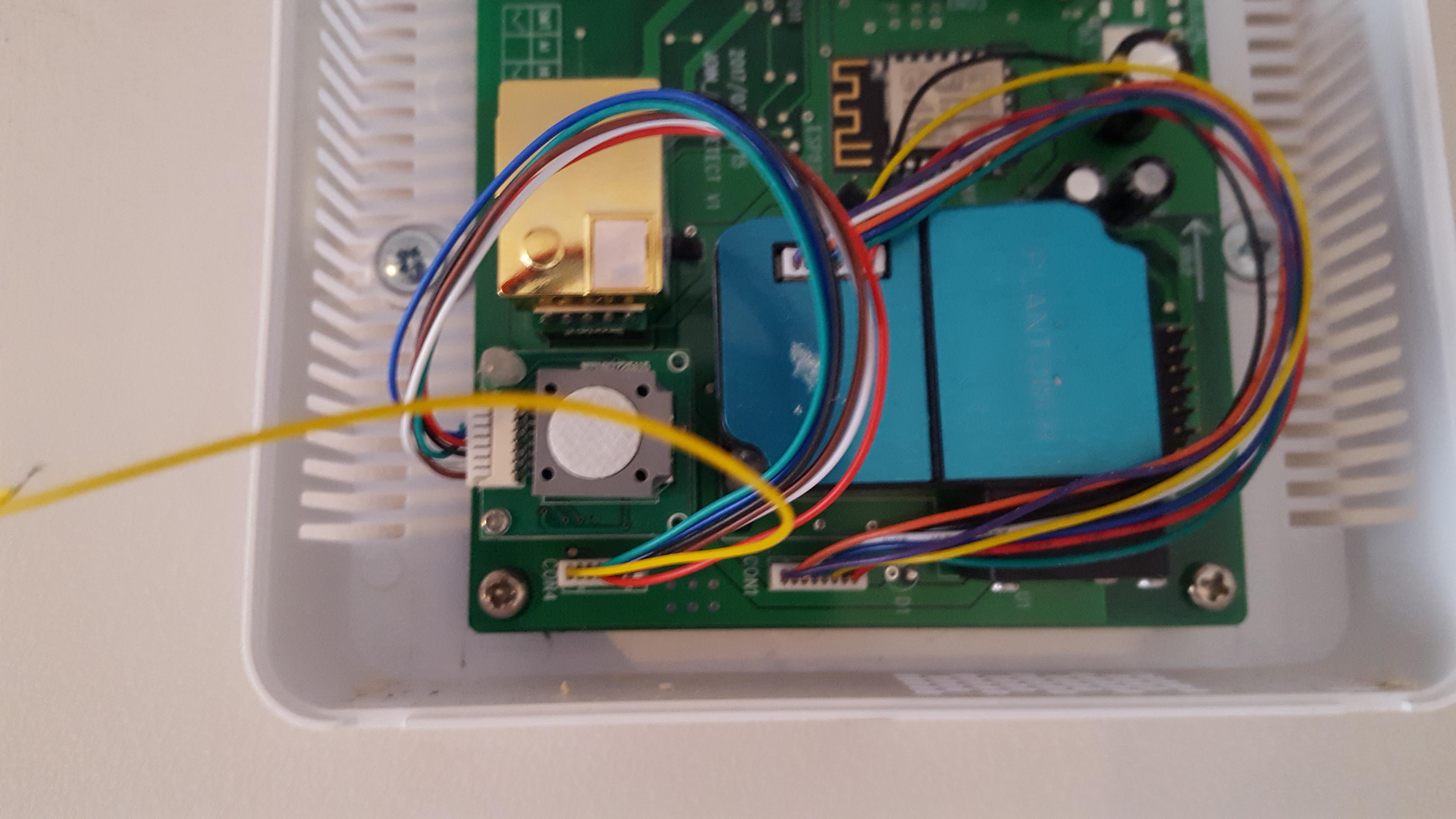

MJNewton Posted November 20, 2019 Share Posted November 20, 2019 (edited) 31 minutes ago, PeterW said: It was working before though ..? If it has worked then unlikely to be a wire as it wouldn’t have worked previously as you said. Loose connections can often only cause a problem when power is removed as arcing tarnishes the mating surfaces which increases the resistance of the connection (or disconnects them entirely). I'd suggest temporarily connecting the control panel directly to the MVHR unit as this would eliminate a variety of potential causes. Edited November 20, 2019 by MJNewton Link to comment Share on other sites More sharing options...
PeterW Posted November 20, 2019 Share Posted November 20, 2019 16 minutes ago, MJNewton said: Loose connections can often only cause a problem when power is removed as arcing tarnishes the mating surfaces which increases the resistance of the connection (or disconnects them entirely). I'd suggest temporarily connecting the control panel directly to the MVHR unit as this would eliminate a variety of potential causes. Agree however that’s on power connections - this is ModBUS so will be 3.3/5v and mA connections which are unlikely to cause a disconnection of this type. Assuming it is a 2 wire connection then just connecting and reconnecting should clear that. Link to comment Share on other sites More sharing options...

vivienz Posted November 29, 2019 Author Share Posted November 29, 2019 (edited) 1 hour ago, PeterStarck said: @vivienz Have you had a resolution to your problem? Sort of. It does seem to be some sort of electronics problem and the manufacturer is sending a load of spares out on Monday so that I can get my electrician to swap them around and see if this works. It has taken much longer than I would like but this is largely due to issues with the original installer, both for me and the unit manufacturer, which needed working around. Edited November 29, 2019 by vivienz sp. 1 1 Link to comment Share on other sites More sharing options...
vivienz Posted December 12, 2019 Author Share Posted December 12, 2019 (edited) Update My MVHR is fixed now, finally. Earthsave sent out a load of spare components and my electrician came out. We had already spotted a loose wire in the box that sniffs the air, situated between the control pad and the unit. Using the Occam's razor theory and rather than go through a lengthy replacement procedure we decided to try this multi-strand connection first. 5 minutes later, all was well and the humidity in the house is falling nicely. Here's a photo of the offending loose wire, it's the yellow one. I'm not at all sure that the fault was related to the power cut, but coincidental and vibration from the staircase caused something that was barely attached to finally pop out. Edited December 12, 2019 by vivienz photo 5 Link to comment Share on other sites More sharing options...
