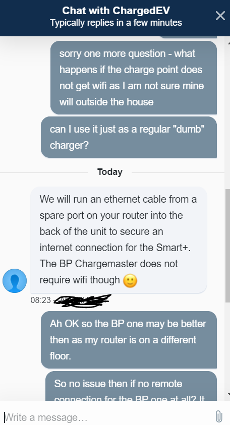

Adam2 Posted November 14, 2019 Author Posted November 14, 2019 OK - I'll ping a msg over to an installer co and see what they say when I tell them there is no wifi at the charge point location. I bet they will still like the money ?
Jeremy Harris Posted November 14, 2019 Posted November 14, 2019 Be interesting to find out how much functionality a smart charge point has with no connectivity. Hopefully there may be some ability for it to work as a basic charge point without any connectivity, but it could be a bit of a nuisance if it ends up being disabled if it cannot connect. Some of the more basic smart charge points may be a better bet than something more sophisticated, as I get the feeling that the basic models may have had the required smart functionality installed as an add-on to an existing design. If so, then it seems likely that they may well work with no connectivity without a hitch. One option is to just get a commando outlet installed, then use a portable charge point. Some can charge at 32A (the Tesla UMC allows this) and a portable charge point is a useful thing to have (although most EVs come with one, normally limited to 10 A maximum). You can buy a portable charge point that will deliver up to 32 A and plugs into a commando outlet, for about £250 or so (I've seen cheaper ones around, just can't find them right now). Wiring in a 32 A commando might not be a very costly job.

Adam2 Posted November 15, 2019 Author Posted November 15, 2019 OK so it looks like (from one supplier/installer at least) that you may not need a data connected charge point to qualify for the rebate. This is a transcript of the chat

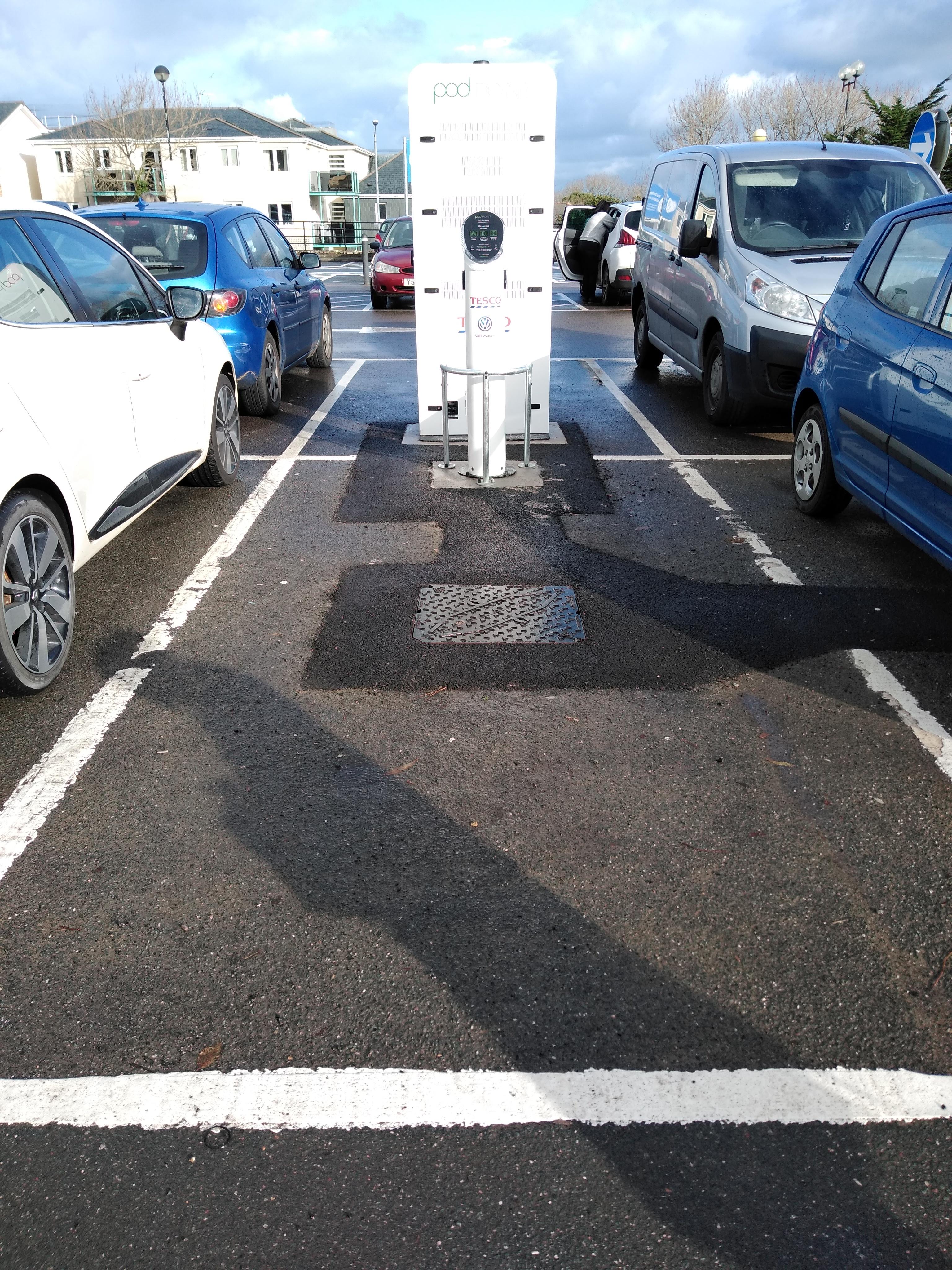

SteamyTea Posted November 15, 2019 Posted November 15, 2019 Spotted this new charging point today. Be ok for a very short car with a good turning circle.

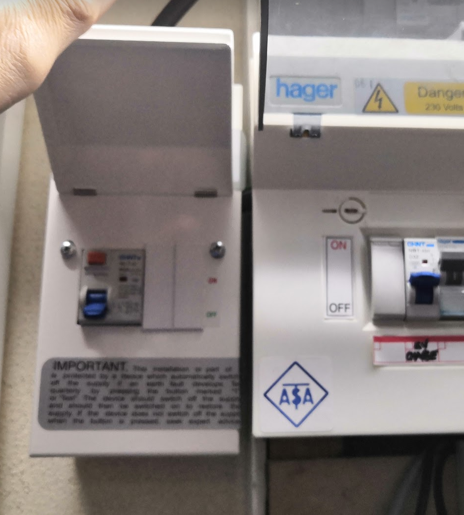

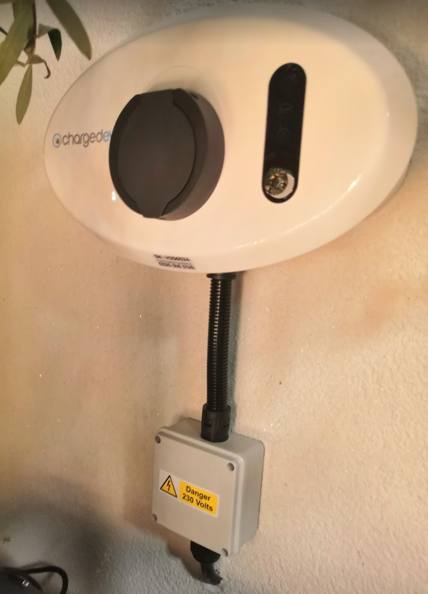

Adam2 Posted December 17, 2019 Author Posted December 17, 2019 So to continue the EV journey... buying used from Tesla is painful in the extreme, not enough people handling orders so 2 weeks after deposit paid only 1 email, no calls or emails answered and no delivery date of course. But, the price is great compared to alternatives so will have to be pleased with that for now! On the charger front some great news - that is installed. ChargedEv did it fast and cheap though to be honest would have preferred the secondary exterior box on the inside but the pre-attached cables were not long enough. As I have an electric metal door they couldn't use an earth rod so installed a box of tricks to deal with that somehow - no issue but it does buzz a bit. They installed a new switch in the consumer unit, an adjacent metal box with an RCD in side, the black box to deal with earthing due to door, exterior interconnection box and the main charger connection wall box. Some pics below in case of any use. All took about 3 hours and should cost £300 - though the billing system was not working so no invoice yet ? @Jeremy Harris FYI - this unit has no connection to house wifi so no capability for external interference. Well unless they have a 3/4G modem and SIM but I very much doubt that. Note metal bar is in fact part of a ladder
Jeremy Harris Posted December 17, 2019 Posted December 17, 2019 42 minutes ago, Adam2 said: So to continue the EV journey... buying used from Tesla is painful in the extreme, not enough people handling orders so 2 weeks after deposit paid only 1 email, no calls or emails answered and no delivery date of course. But, the price is great compared to alternatives so will have to be pleased with that for now ? Buying from Tesla is painful, whether it's new or used. The cars are incredible, but service from Tesla, especially communications, is simply appallingly bad. You have to really want one of their cars to put up with the atrocious way they behave as a company. 42 minutes ago, Adam2 said: On the charger front some great news - that is installed. ChargedEv did it fast and cheap though to be honest would have preferred the secondary exterior box on the inside but the pre-attached cables were not long enough. As I have an electric metal door they couldn't use an earth rod so installed a box of tricks to deal with that somehow - no issue but it does buzz a bit. They installed a new switch in the consumer unit, an adjacent metal box with an RCD in side, the black box to deal with earthing due to door, exterior interconnection box and the main charger connection wall box. Some pics below in case of any use. All took about 3 hours and should cost £300 - though the billing system was not working so no invoice yet? The box you have is almost certainly one of these units: https://matt-e.co.uk/wp-content/uploads/2019/10/SP-EVCP-Installation-Manual-v1.2-Oct-2019-A5-QCode.pdf or something similar. Questionable as to whether it really complies with Section 722 of BS7671:2018, but they do seem to be selling them as a compliant solution (hard to see how just monitoring L and N can comply, but no doubt they've managed to persuade someone within the IET). 42 minutes ago, Adam2 said: @Jeremy Harris FYI - this unit has no connection to house wifi so no capability for external interference. Well unless they have a 3/4G modem and SIM but I very much doubt that. The charge point does have an internal SIM card and LTE connection, to allow the mandatory control required by OLEV, to allow grid balancing etc.

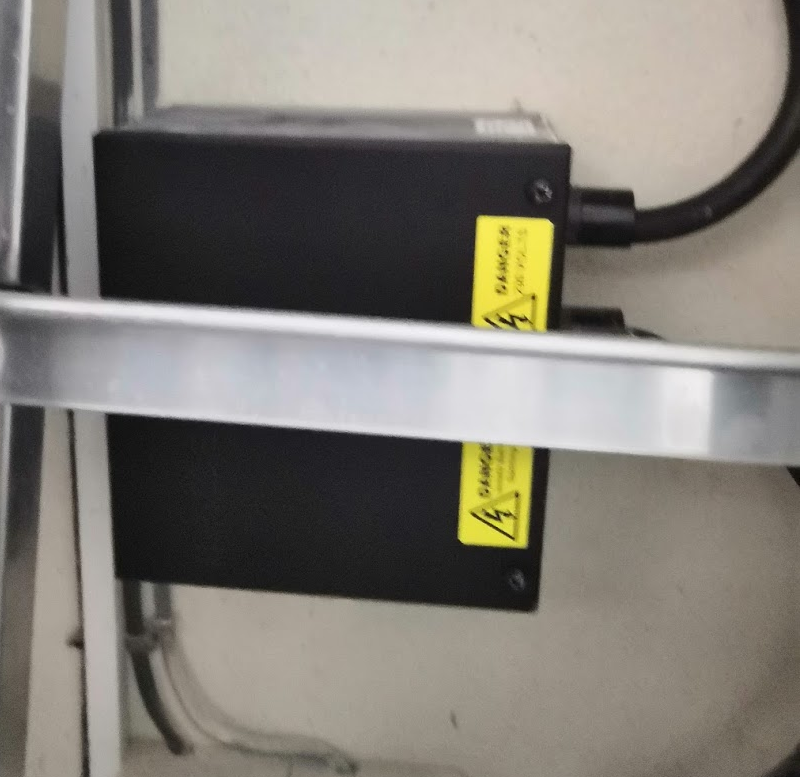

ProDave Posted December 17, 2019 Posted December 17, 2019 8 minutes ago, Jeremy Harris said: The box you have is almost certainly one of these units: https://matt-e.co.uk/wp-content/uploads/2019/10/SP-EVCP-Installation-Manual-v1.2-Oct-2019-A5-QCode.pdf or something similar. Questionable as to whether it really complies with Section 722 of BS7671:2018, but they do seem to be selling them as a compliant solution (hard to see how just monitoring L and N can comply, but no doubt they've managed to persuade someone within the IET). The usual fault with PME is a break in the PEN conductor, allowing the PME earth to rise almost to L potential. A better check would seem to be use a rod, just as a reference, and trip if the PME earth differs from local earth by a set amount (a bit like the old voltage operated earth leakage devices) I guess it might be doing a loop impedance test, which should also detect that condition?
Jeremy Harris Posted December 17, 2019 Posted December 17, 2019 45 minutes ago, ProDave said: The usual fault with PME is a break in the PEN conductor, allowing the PME earth to rise almost to L potential. A better check would seem to be use a rod, just as a reference, and trip if the PME earth differs from local earth by a set amount (a bit like the old voltage operated earth leakage devices) I guess it might be doing a loop impedance test, which should also detect that condition? That's exactly the scenario that the three protective options in Section 722 are intended to address. The unit I linked to has a contactor that disconnects L, N and PE when it detects a voltage change on the incoming L and N, making the assumption that a broken PEN will change the voltage between L & N. The reason for breaking all three conductors is to prevent the touch voltage on the car body (which will be at the potential of the PE connection) from rising above a safe limit relative to the local earth next to the car, where someone may be standing. The difficult case is where there is another bit of earthed metal within touching distance, like an electric door, or maybe a freezer inside a garage where a car is charged. You then have a problem where a PEN fault could result in there being a dangerous PD between the car body and another bit of metal connected to a different earth. The whole thing is made more complicated because the signalling system used by the charge point comms system puts up to ~ 6 mA of DC down the car CPC, and that's enough to blind a Type AC or Type A RCD/RCBO, preventing it from tripping in the event of an AC leakage. The fix I've used is to use a Type A RCBO (OK for AC and pulsed DC) plus a DC sensing leakage detector (one of these: http://www.stegen.com/en/ev-products/126-residual-current-sensor.html ) to disable the charge point. Not 100% compliant, though, as it will reset if the power goes off and on again. The expensive way to do it is to use a Type B RCD/RCBO and earth electrode, but that may need changing the earth arrangements for other nearby parts of the installation to TT, through the same RCD/RCBO, in order to get around any problem with being able to touch two differently earthed bits of metal.
Adam2 Posted December 18, 2019 Author Posted December 18, 2019 2 hours ago, Jeremy Harris said: The charge point does have an internal SIM card and LTE connection, to allow the mandatory control required by OLEV, to allow grid balancing etc. Ah yes can see that is an option. All I can find on digging into this is that past customers have had letters saying that they needed to start paying if they wanted to keep access to the app/data - sounds more like none is paying the SIM bills anymore ? Not sure how to tell if this is actually installed without opening it up, though for current location not so concerned.
Jeremy Harris Posted December 18, 2019 Posted December 18, 2019 1 minute ago, Adam2 said: Ah yes can see that is an option. All I can find on digging into this is that past customers have had letters saying that they needed to start paying if they wanted to keep access to the app/data - sounds more like none is paying the SIM bills anymore ? Not sure how to tell if this is actually installed without opening it up, though for current location not so concerned. If it was installed with an OLEV grant, then it's mandatory that the smart connectivity be fitted and working. If it was fitted without an OLEV grant, then no need for the smart connectivity, and arguably it will be a LOT better without it. On one of the Tesla forums there are many reports of flaky smart charge points, badly designed apps, unreliability, etc. Having read many of these I started a thread asking whether Tesla owners (who, as a subset of people, probably lean towards anything with a bit of tech in it) and the results were overwhelmingly in favour of dumb charge points: https://teslamotorsclub.com/tmc/threads/are-smart-charge-points-worth-having.177611/ 1
