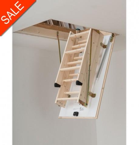

Ferdinand Posted November 9, 2019 Posted November 9, 2019 (edited) Perhaps weed suppression membrane? When you create your loft hatch, remember to get a properly sealed one, and take care with the type of ladder. I like these sort, but they are bloody heavy if you get them wrong and they open on your head. F Edited November 9, 2019 by Ferdinand

H F Posted November 9, 2019 Author Posted November 9, 2019 6 hours ago, Ferdinand said: Perhaps weed suppression membrane? When you create your loft hatch, remember to get a properly sealed one, and take care with the type of ladder. I like these sort, but they are bloody heavy if you get them wrong and they open on your head. F Not sure we’ll go that far F. No storage space in the loft, so we won’t be requiring regular access.
